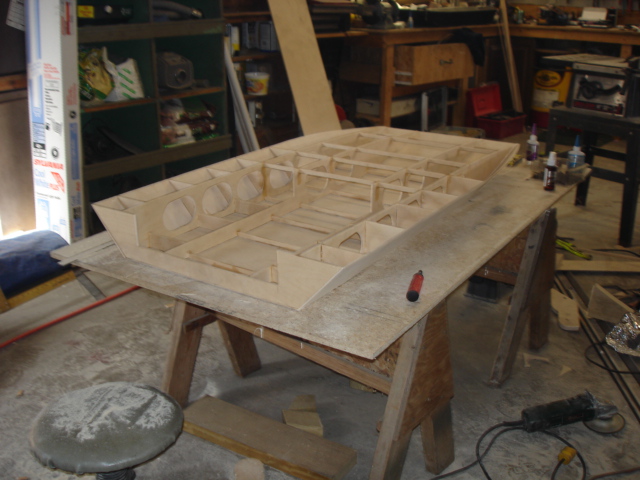

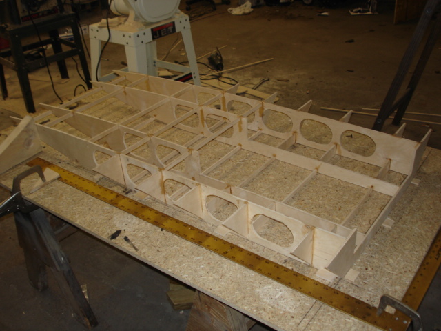

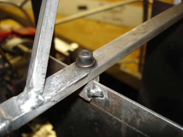

Started on a new project, whuddya' think?
I weighed it (including decking) it will be 13 Lbs. ??? oz. without servos ETC. ETC. I was thinking of another chainsaw engine, but a Nitro wouldn't be out of the question. What size nitro though? what prop? I like the pusher type so I would be limited on prop sizes wouldn't I ? The last pic is what it should look like when it's finished. (still deciding on color)

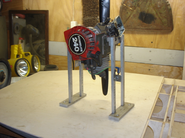

PHCM wrote:
Thank you .
The engine mount is aluminum along with the cage. I've decided to use the engine and cage from my last build. (the hull had issues)
G23 ?? is that a weedy or chainsaw? a weedy spins the opposite way that a chainsaw engine does, The advantage to using a chainsaw is that you can use tractor props with pusher set-up (giving a larger selection) . If you want a pusher with a weedy, you need to get pusher props. I like the pusher only because .....um..... uhh... I don't know why. I think it looks more "true to life"

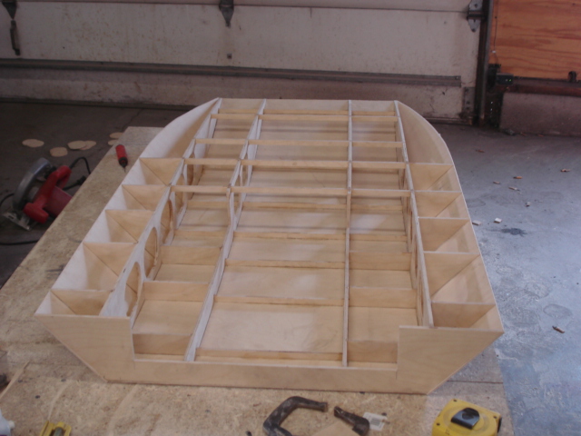

I think I might've gone a little wide on this build. The bottom is 20" the top is 28" which gives the sides a 35-40 (?) degree angle.
Didn't get very far today, I caught a bit of a nasty cold. You know, fever, cough... the whole bit.
Not wanting to hijack your thread, but to compliment it.

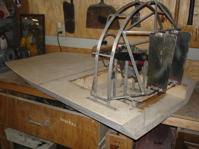

On your rudders , I noticed that the pivot is NOT at the end/beginning of the rudder blade . This will cause too much pressure against your pivot point , so , I hope they are strong ( did this before and ended up with broken rudder . not at first , it took a little time - bout 4 days )

Terbo, the rudders are 1/16 aluminum plate mounted on bearings. No worries there. I made her strong.
Mr. Cajun Gator, you are right about the prop walk, this one has no problems turning to the right.

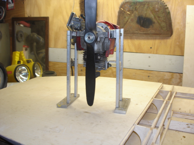

Pic of new Engine stand:

Terbo,
Not a pusher. The engine is a chainsaw, which runs opposite of a weedy, allowing me to use a normal prop in a pusher configuration.
bigger prop selection.
It (the engine) was made in 1986.
Cajun,
The only way I can think of to be able to put a muffler on is to move prop away from the engine, which would require machining of a shaft. I think that would be out of the budget. The local machine shop starts a $65 an hour, not including materials. [&o]
18 x 8 ??? Faster top speed ?? Hmmm. but wouldn't that sacrifice low end torque ( for land running)?
Correct me if I'm wrong: Lower pitch prop depends on higher RPM for more speed? This engine has a max rated RPM of 8000.
At only 8000, would a smaller pitch be less efficient?
Also I've tried an APC 18 x 12 , it didn't perform as well as the MAS 18 x 10.(although there was no discernable change in RPM) I think tip width had something to do with that.
It (the engine) was made in 1986.Cajun,

Machining of a shaft ? No ... contact Peter at WACKERENGINES and I'll be he either alreadys makes , or WILL make you a prop extension/adapter for it .
Peter F.
[email protected]
352 628 5810
( Florida )
EXCELLENT guy to deal with - VERY reasonable prices , AND excellent products .
( watch out though ... he LOVES to talk -
( oh and without sounding smart***** - a chainsaw does not run backwards , its output shaft is simply on the other side
) and with certain chainsaws , you COULD even use choice of sides
Anyway ... is there any chance of showing some close-ups of how you mounted the pull start so it stays on there ?
Oh and about the prop ---- a lower pitch will allow the engine to come up to R's , whereas the higher pitch strains the engine and does not allow it to max out ( in addition to that it probably also is over heating a little - if you have a temp gun , test it ) Also , burning more fuel than needed which might cause fouling )
One more thing ... might want to contact your local lawnmower repair shop and see about possibly some new ring(s) for it if its that old ( would give you better HP ) and they're fairly cheap - usually around $6.00
And dontcha just LOVE it about the options of "pusher" props ? (
) I thought about using a chainsaw from an old Husky I have , but never got around to it ... GREAT idea though ! Sounds more and more like you really put a lot of thought into this before you did anything . GREAT thoughts create great things . Hats off to ya .
