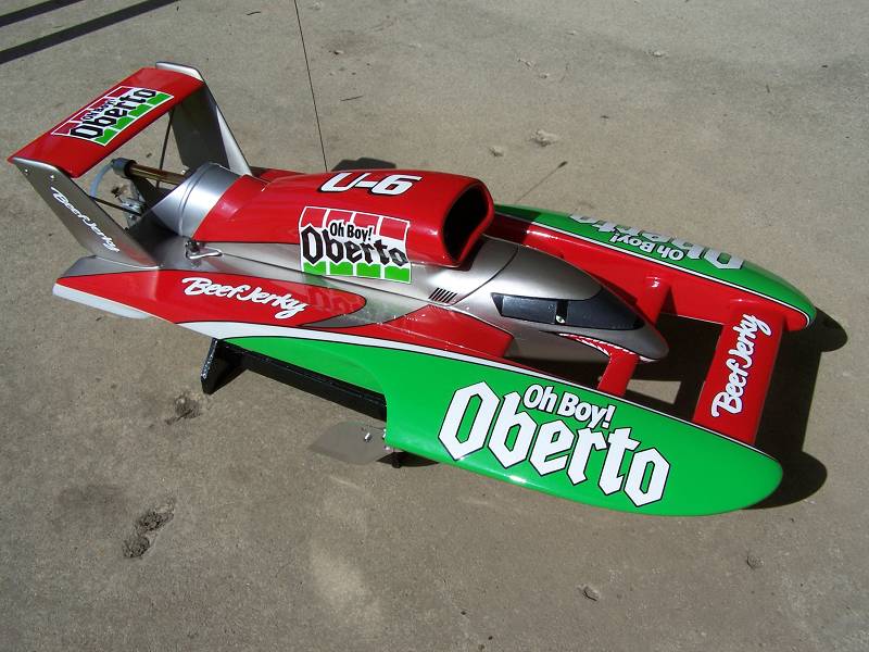

Here you go buddy. Heres a spray detail gun that I use for everything from gelcoat to clearcoat and everything in between. Think I paid only $30 at Home Depot. Don't need expensive equipment to do a really nice job on your boats.
I'll search around a little myself and see what I can find. If theres anything good, I see what I can do about making it a sticky. You guys find anything I'll take a look at it myself for sticky appeal

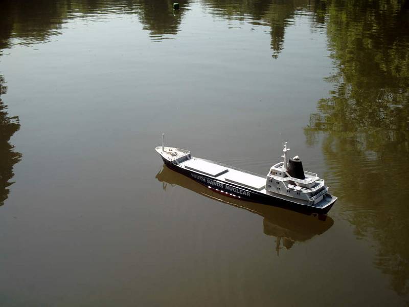

what kind of ships are they?
my themes are simple, for cargo ships, they run in "South Sands Nuclear" livery, with port of registry being "Heysham" or "westport" in the case of Gemini...

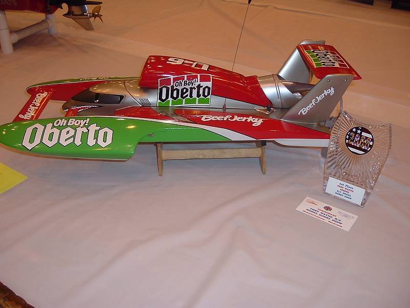

For finishing paint, I always use House of Kolor brand. I clearcoat that paint with a cheaper brand sold by NAPA.
Gelcoat is what is applied directly to the inside of a boat mold, that ends up being the outer layer of a hull once the glasswork is complete and removed from the mold. To learn more about gelcoat, and molds, even the paints you are asking about, I have a build thread currently going that demonstrates exactly how this process is done.

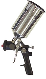

I'm using a 1.3 or 1.2 tip on my guns. most guys use a 1.4. Mine lays the paint out like glass. I got 4 guns.three are from TSC=tough s**t charlie.=tractor sale company. We call that place that name. But got the guns for 75.00 there close to christmass time.Its was a three pack,one small touch up gun and two full size guns,one has a 1.7 tip the other has a 1.4 tip.All three of them are gravity feed guns. My favert gun in my is my Accuspray Isaac Newton gravity feed HVLP gun. Payed 325 in 2000. Never has a proublem with it,the best spray gun that I'd ever used. Use devilbiss,Sharpe, Binks,SATA Jet.It beats them all in my book.Had an old boss who'd had a SATA JET.used my gun and he loved it.Likes how it lays the paint like glass. I havent rebuilt it yet. But will this year some time.HVLP Gravity feed guns are easy to take apart and clean.They use low presure=less paint over spray in the air=more paint spray on your car ,truck and so on.They use less paint to spray=saving you money!!! I will never ever use a pot feed gun ever again!!!![:'(] Been using gravity feed gun since 91 and never looked back. Here the pic of that gun,but mine is black.

anything bigger then a 1.4 tip is concitederd as a primer tip. I use a 1.4 tip for priming to lay it out smoother. Just found out accuspray makes a tip down to .7 for my gun,I'm going to order the 1.1 for my gun but will check into the other tips too.Plus want to buy the newer twist off lid gun cup. Also just found they was bought out by 3M! heres what my gun that I use looks like also here my TSC touchup gun too,works great too!!. just found my pic of my spray gun that have.

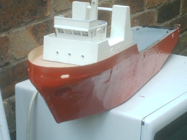

what I painted Nord Icelandia and the other boats in was Plasticote brand spray-enamel that comes in 500ml rattle cans.
first to go down was 3 coats of red-oxide colored primer, followed by 3 coats of gloss red, followed by 3 coats of clear acrylic of the same brand, this lasted well until Nord Icelandia developed a leak, so the affected area had to be sanded to the fibreglass base below the timber. this was then re-done with grey primer over the lower section, again 3 coats, and once the black trim line was put on, (using 10mm vinyl tape), the hull was again sprayed with clear acrylic.
her superstructure is hand painted..
