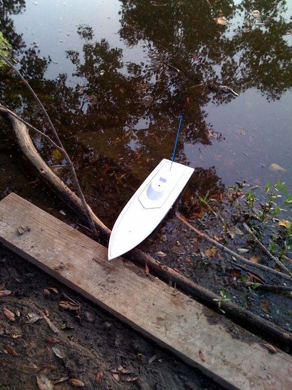

#61
Joined: Dec 2008
Posts: 109
From: Baton Rouge,
LA
ORIGINAL: misshydro
if the hull is clean with on paint defects..Just get a red scotch bright pad and scuff the boat with that..Oh what color is your blast?If its red or dark color then spray acouple of light coats of dupi-color prime on it..then wetsand that with 400 grit and your ready to paint..
I should probably clean it before doing anything first just to make sure. I dried it off after I took it out last time, but with the way that pond looked, it could probably use a nice scrub :P
Those are the pictures I took the last time I took it out for a little drive.
