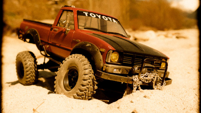

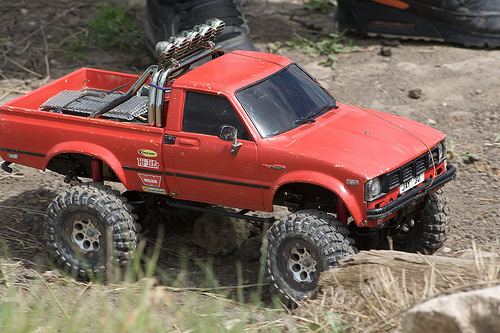

I like the 2 pics below. granted, they are hardbodies, but I like the colors used. I actually think I have a tamiya High lift light bar as well!
