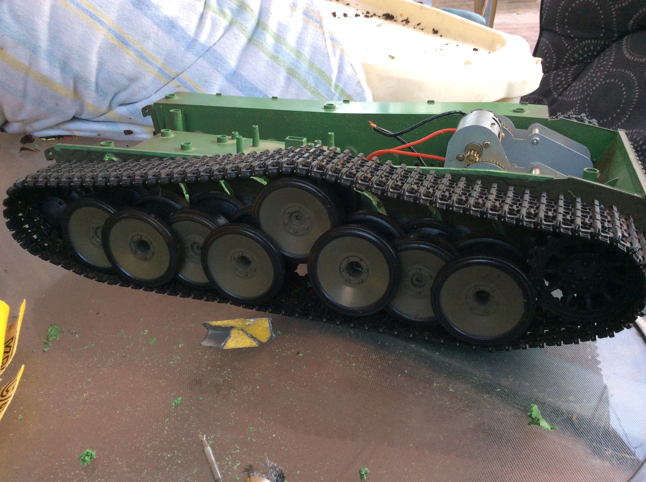

Hey guys, for a while I've had this Heng Long 1/16 German Tank, but unfortuntaly they mess up the front end its not a scale representation of any real German tanks. So I've decided to turn it into a 1/10 tracked vehicle thing.... Stay tuned for updates

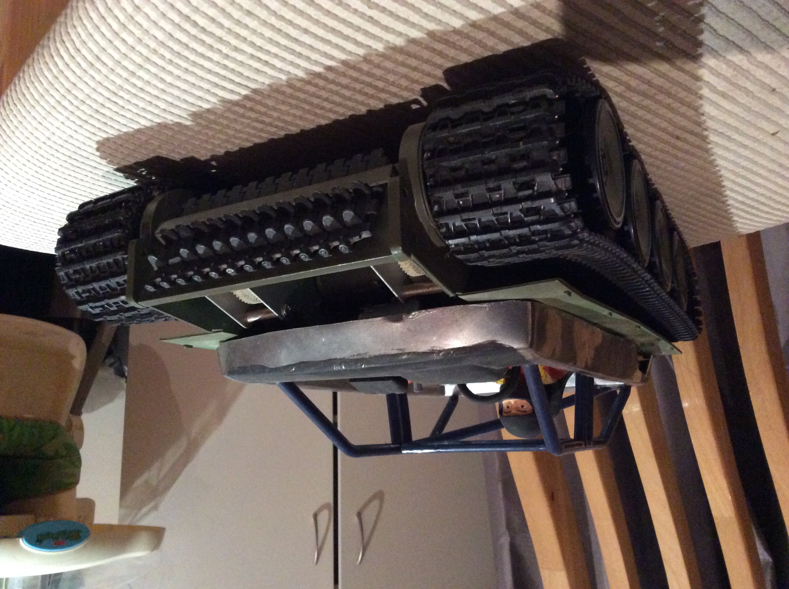

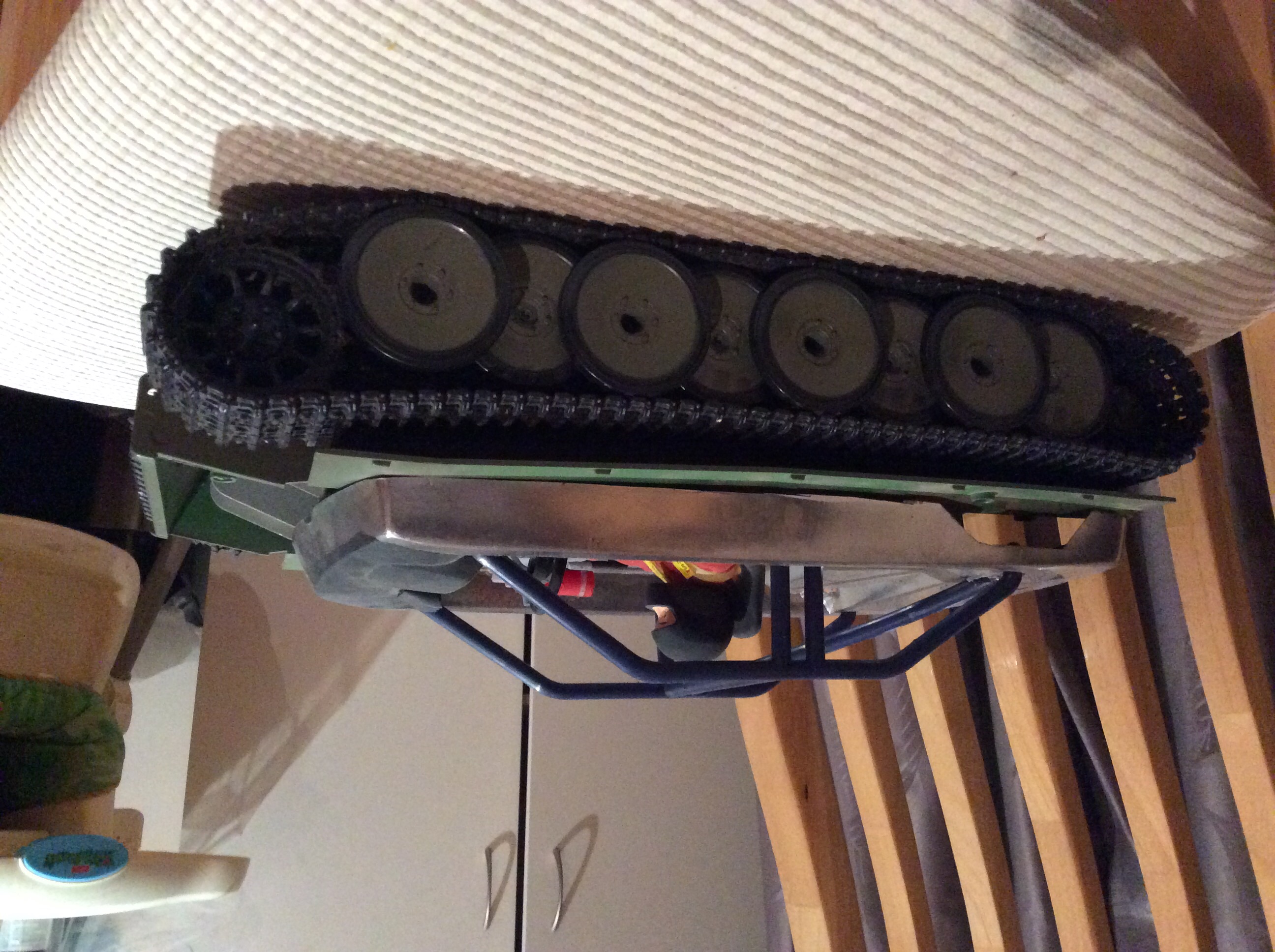

Here are some mock up pics to get a feel of how I'm going to do it...

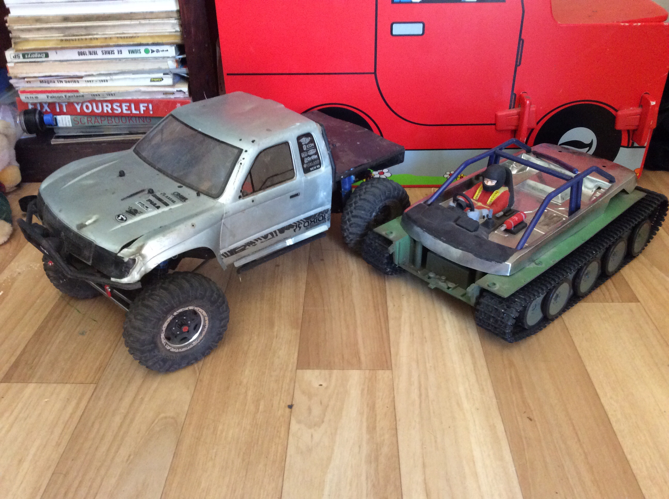

And one for size reference

So far I plan to change a few things around.... ATM it's front wheel drive with leading arm suspension.... IMO it's one of the worst setups for a tracked vehicle. So my plan to correct the chassis is to simply run it backwards and raise the idler wheel...... This will change the leading arms into trailing arms making the suspension a lot more useable and it will make it rear wheel drive.
aswell as that Im planing to run a single axle for the idler wheels to help keep them more true and I'm looking into doing the same thing with the trailigh arm mounts

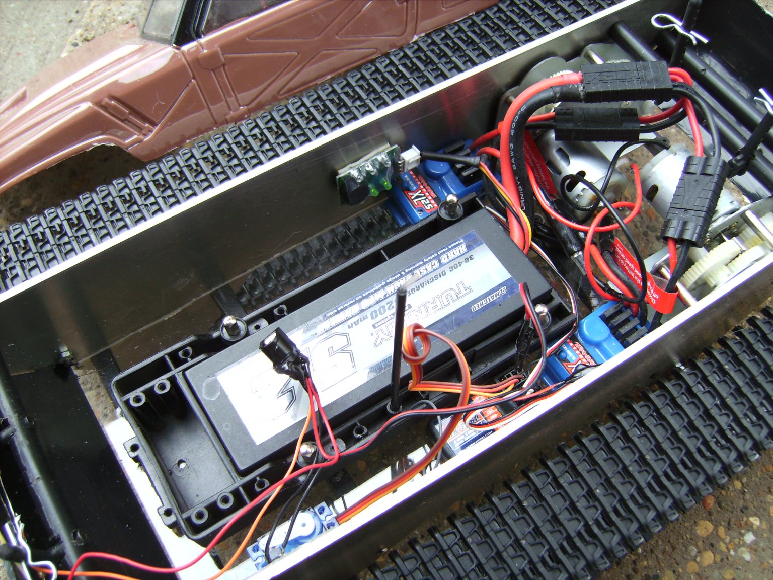

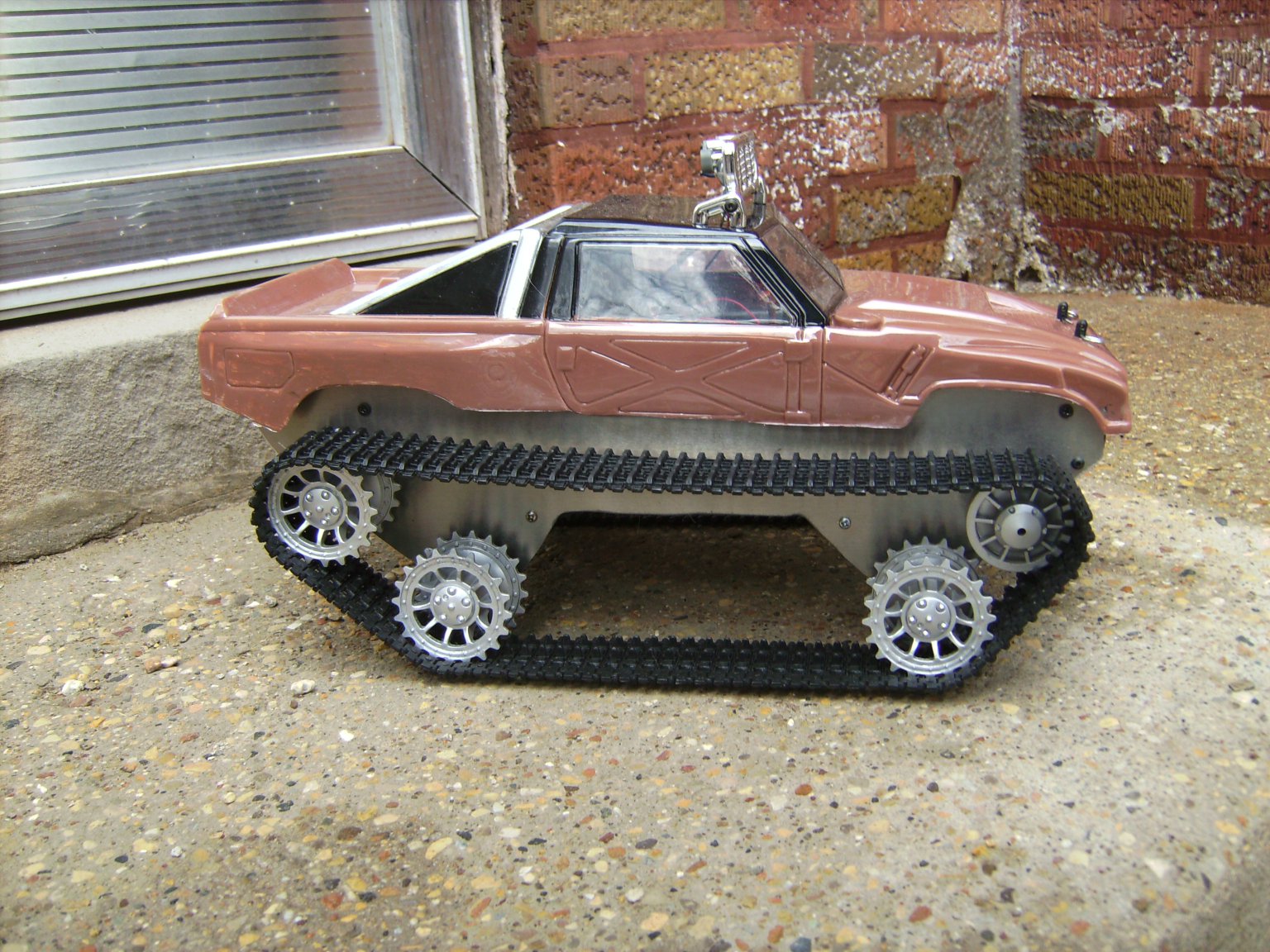

hmm I used a Flysky 6 channel radio when I did my tracked monstrosity that was made from HL tank parts with the throttle, and uhh right stick each controlling one side.
I started rebuilding my Tiger tank since I lost its controller with hobby grade electronics(reusing that controller), and would have finished if I didn't have some unexpected bills pop up(like the car I drove to works engine dying, and needing to buy another vehicle)
Dunno if you remember my tracked thing build
I scrapped it completely since as the things I was using for wheels shattered from the plastic being thinned out to get bearings in the bottom wheels

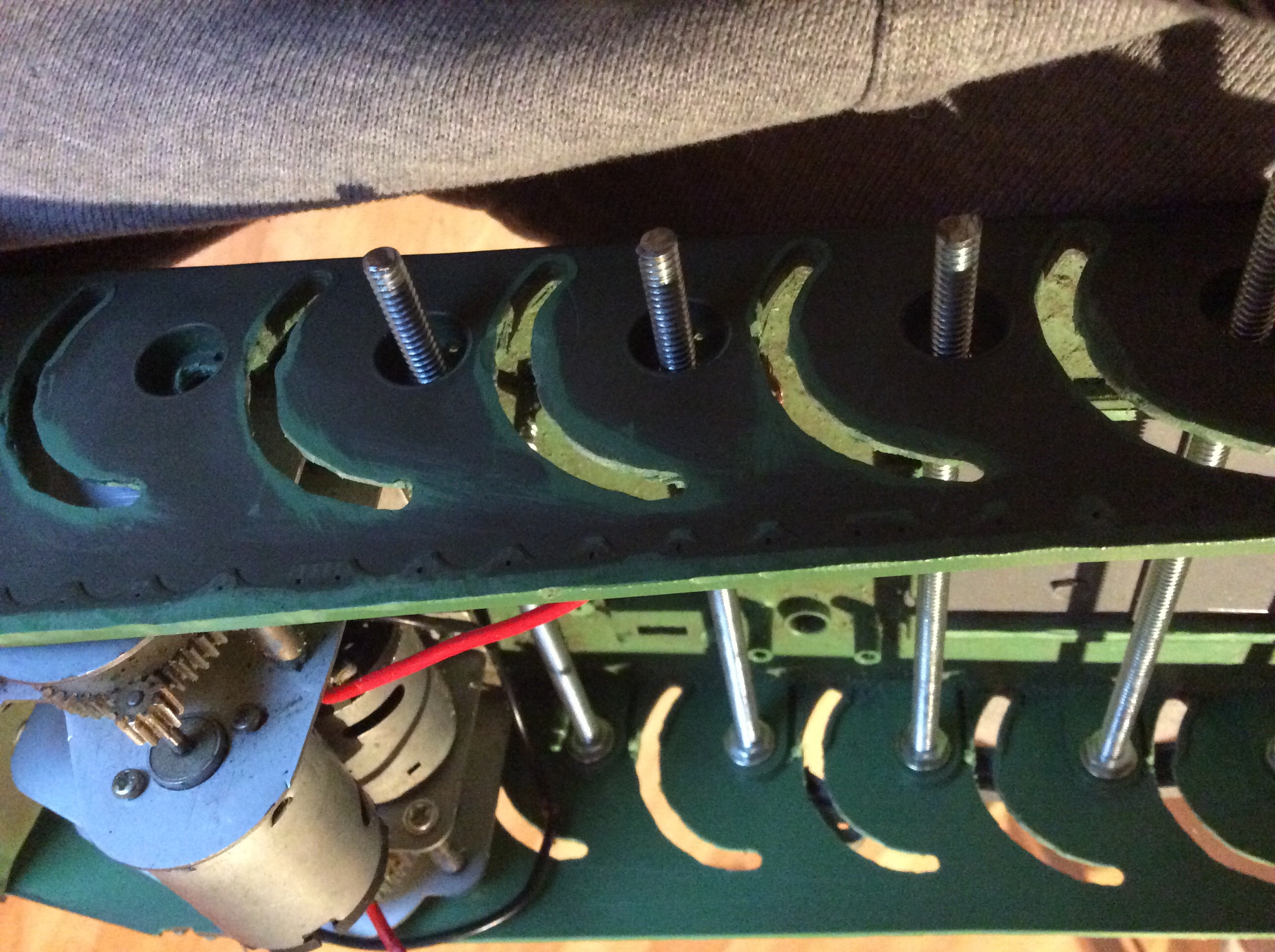

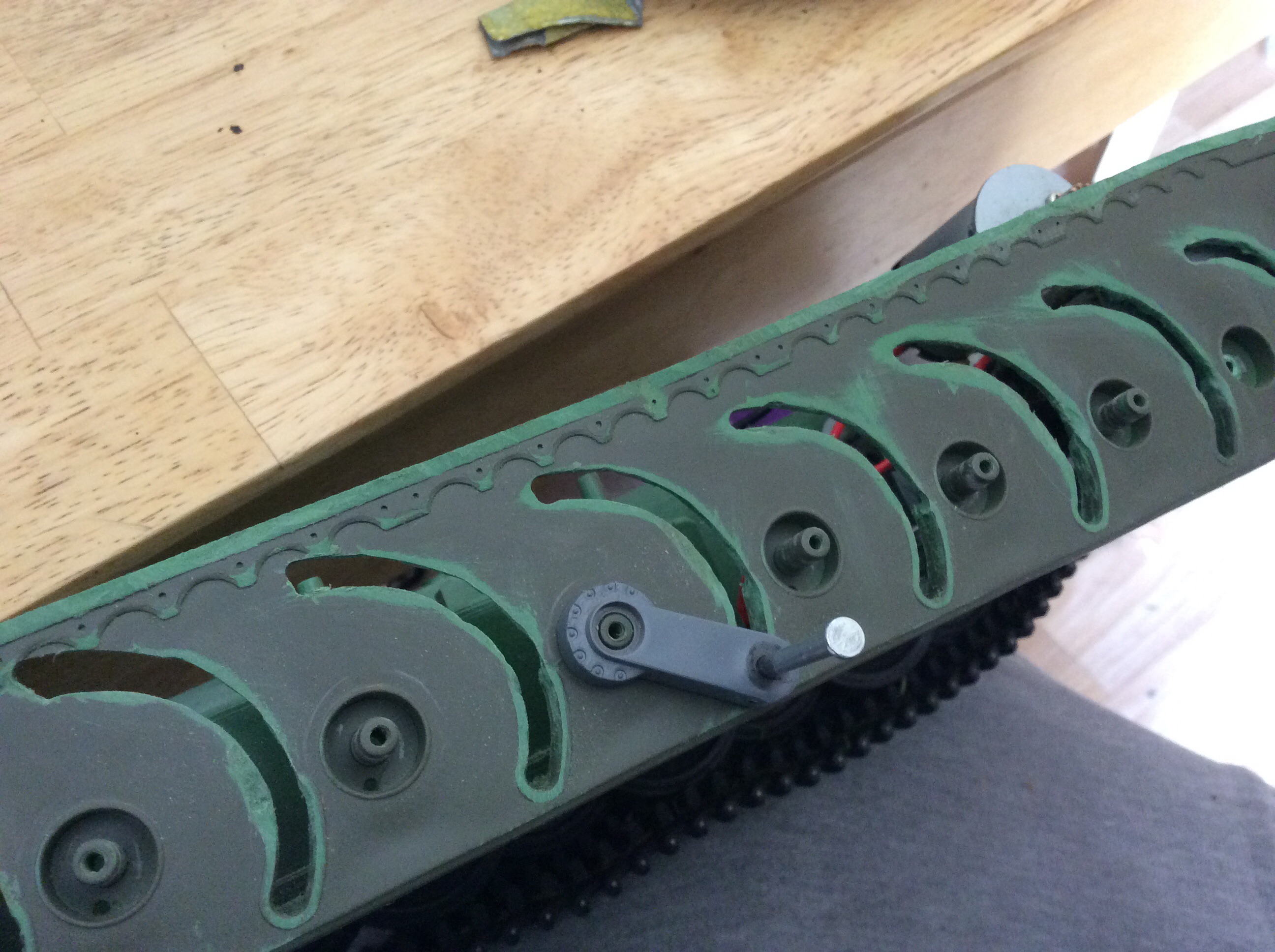

Here is a bit of an update..... I've dremeled the chassis to allow for more up suspension travel. It's basically doubled the travel.
but I've found with that amount of travel it needs longer tracks, so I dare say I will lengthen the tracks and add a tension wheel on the top
here is a pic.... See how high the wheels can now go

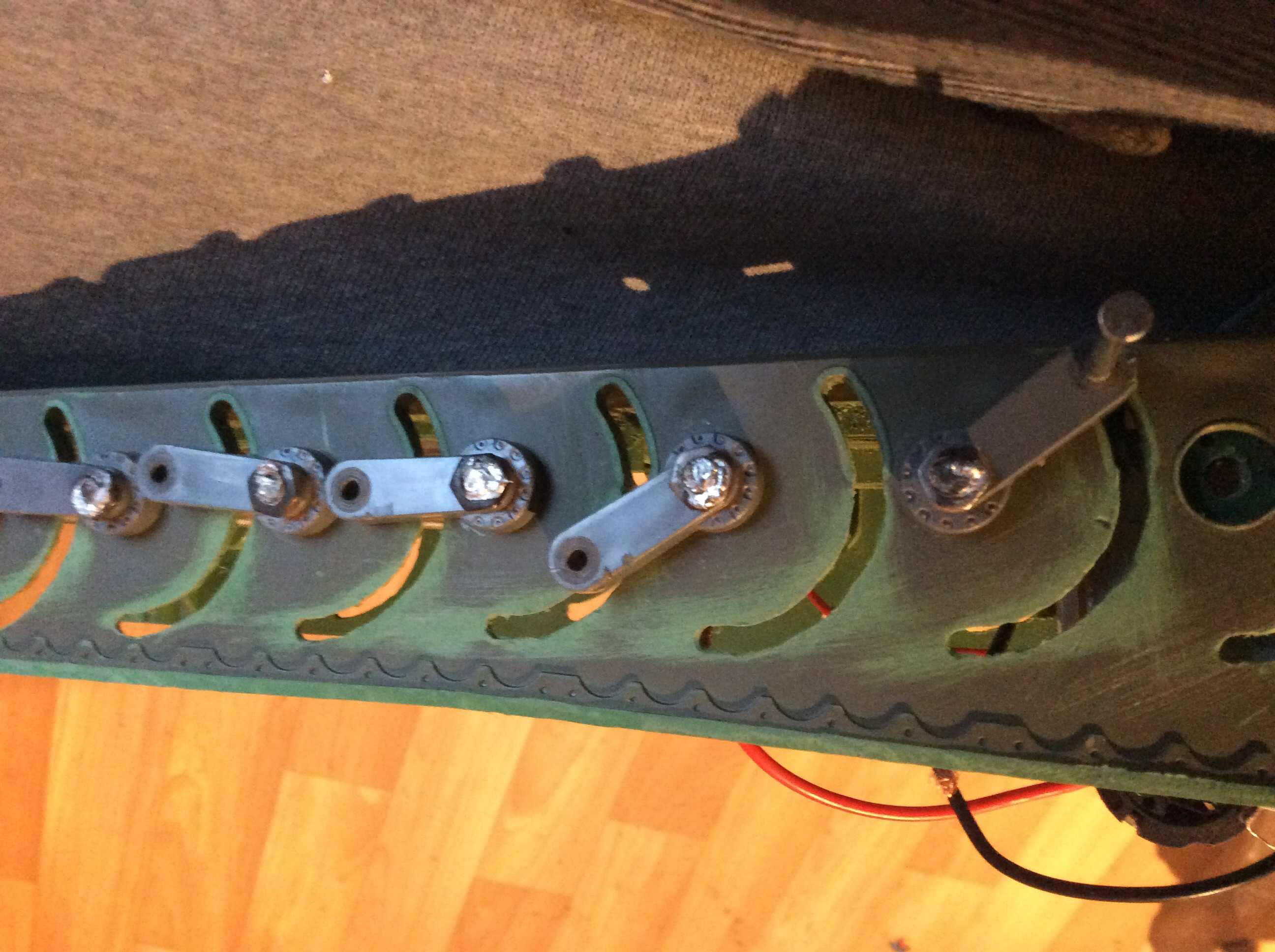

Ok, I've found out why the suspension arms flop around.... The only thing that stops them is this little plastic nipple that's hollowed out for the securing screw. So in short it's very fragile and bends easily, one of them was extreemly floppy and fell apart when I removed the screw.
so my solution will be to run m3 threaded rod from one side to the other side. And a sleeve where the arm pivots from and secure them with a nut. Because of the gearbox I cant do this with the end arms but I plan to use threaded rod that goes from the arm to the metal part of the gearbox...
next... looking at the springs they are running about 130deg preload. And looking at the nipple u can see the springs locating hole is in the bottom left, if drill a hole in the bottom right it will reduce that to about 90deg preload

Update... I've made up some axles for the suspension arms out of threaded rod And braised the nut on one end.... This should be considerably stronger and keep the suspension more true

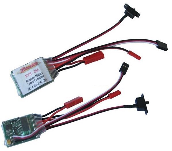

hope they ain't the ones I tried like a year ago(XYS-BL20A was what the crappy sticker said) as that was a 100% blatant lie on the ad.
I ended up going with the bigger ones that look like they were for a 1/10th that you recommended after that lol

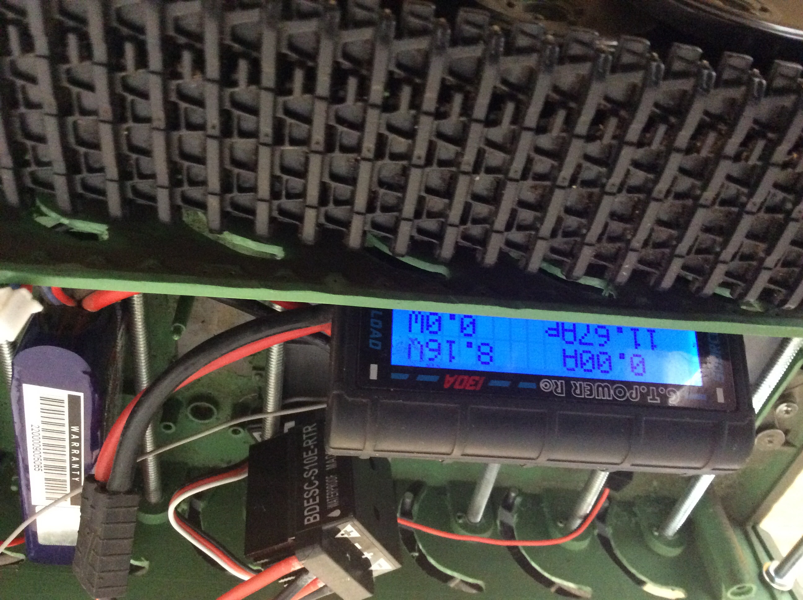

Ok, playing around with a 2s lipo today
freewheeling it draws 1amp, spikes to 2amp when accelerating.... Give or take 0.1amp
Anything around 3.3amp and the gears will slip.
dead stall managed 11.67amps, but that's only because I physically held the pinion. And the voltage droped from 8.16v to 7.97v
Oops early forgot... Here is a pic....I really did test it lol

Here is a pic of the ones im getting
Fingers crossed... In theroy they should be able to handle a dead stall with a 2s lipo all day
