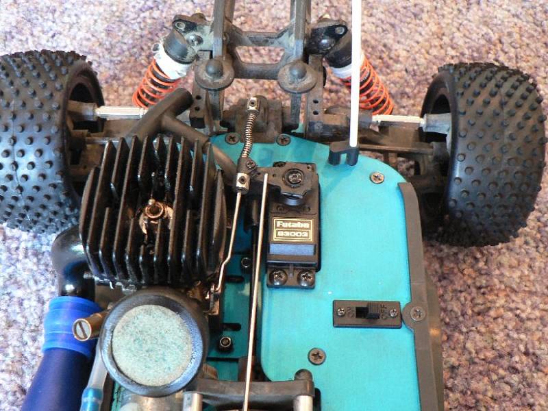

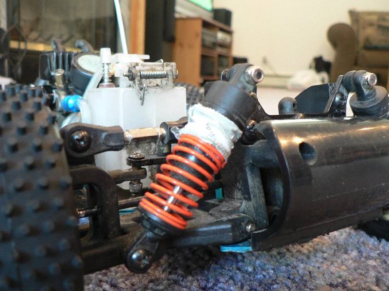

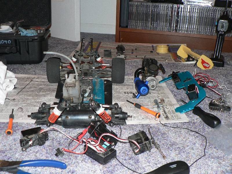

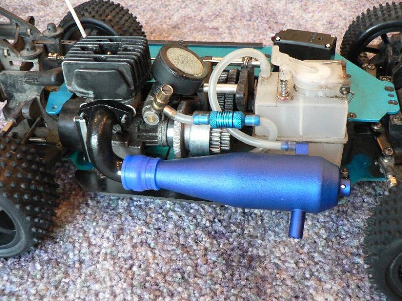

All RIGHT my friends! I am BACK in action! After destroying my buggy in a horrific crash (and after getting married and going on my honeymoon), I rebuilt my winner sport. Better, faster, stronger......... Here is my list of parts I ordered through Tower Hobby and Excel Hobby (recieved both orders within one week).
Full set of bearings - WOW!!!!!! what a difference!!!
Traxxas High Performance Tuned Pipe T-Maxx - #4942 - direct fit
Traxxas Pipe Coupler T-Maxx 2.5 - #5246 - direct fit
HPI Aluminum Exhaust Header Nitro 3 - #86037 - direct fit + boosted exhaust flow with some dremmeling
Futaba 2 PL controller - channel 83
Futaba S3003 - servos for throttle and steering
DuraTrax Micro Fail Safe Unit
SMT wheels and tires
Also check out the picture of my "no cost" mod to the shocks. I stole and idea from NASCAR's use of spring rubbers and I added some rolled duct tape and a twist tie to the top of the spring which effectly stiffens the spring. Much less bottoming out, and leaning through the corners.
Needless to say this thing SCREAMS NOW!!!!! My neighbors could not believe how fast it was going. I could only hold WOT for a second before it was down to the end of the street. I could not believe how well it rolls after letting off the gas. Those bearing make all the difference!!! Enjoy the pics......

Sweet! have you got any pics after the crash, see how mangled it was :P I might crash mine for a reason to get more, better parts hehe.
Ryan.
Ryan.
#1263
Join Date: Feb 2006
Location: Poughkeepsie,
NY
Posts: 1,785
RE: official smartech buggy thread
Amazingly, there was no real damage to the chassis or suspension. It was body and elctronics damage. So pictures wouldn't be that great. I ordered a new body and I am working on a custom flame job now. I'll post pics when I finish.

Hey docphysics
What bearings did you order? Do they reduce the play at each wheel? Lots of guys in this forum talk about the bearings, but I'm not sure what kit to buy etc. Are they universal? I have a winner sport buggy.
Your performance pipe is sweet btw.

Hey rjd,
Yea, the bearings totally reduce the slop in the wheel caused by egging in the bushings. These bearings will fit your buggy, $20 shipped to the door from Hong Kong. So worth it..........

rjd,
Here is my experience. I replaced the bearings, header, and pipe all in one shot. My buggy is NOTICEABLY FASTER! MUCH FASTER!!!! I don't know how much the tuned pipe helped, but everyone else says it helps. I think the biggest improvement is definitely with the bearings though.....
Yes, alloy clutch shoes WILL wear away the clutch bell. I have been running my alloy shoes about 4 months and there is noticeable wear on the clutch bell. I probably have about 2-4 months left on the bell. How long it will last depends on how much and how hard you drive. I run about 2-3 hours per week. Regardless of whether you run alloy or nylon shoes, you will be replaceing either the shoes or the bell eventually. So just keep a spare on hand. I got my extra bell waiting. I like the alloy shoes cuz it makes the buggy explode off the line...... Hope that helps.......
