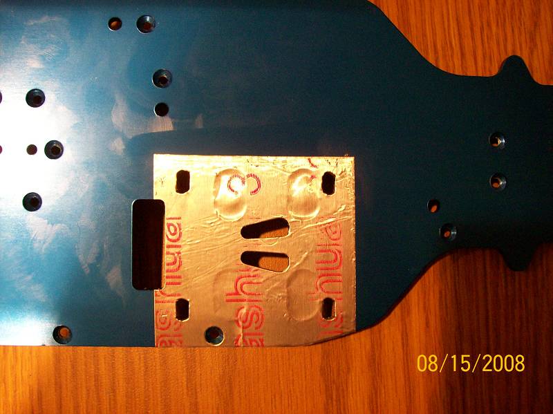

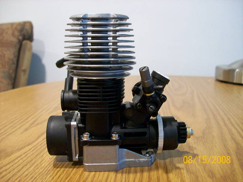

Hi ALL. I've finnished redrilling the new engine mount holes. First I fitted the clutch and bell (a 16 teeth one) onto the engine.. and fitted it (temp) to the mount..

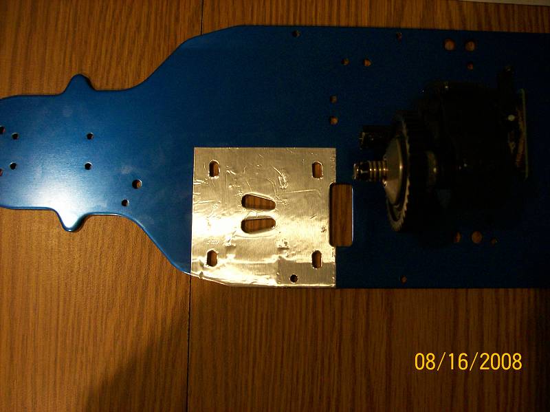

Then I put masking tape into the chassie (for marking) I lined up the engine to the spur gear and using very small pieces of wood I glued the them around the mount (onto the tape). Once the glue dryed I then removed the engine and mount and without the engine fitted I put mount back onto the chassie into the woodie bits so that they will hold the engine mount in place, and I can use the mounts screw holes as guides (I used my bench drill) and drilled right through the mounts holes and into chassie. then drilled another hole right next to each other ones that I did and then filed out the middle and the engine mount holes are now elongated..
I filled up the old holes with J.B Weld (to add strength) and put a piece of metal tape other the whole thing and VOLLA IT'S DONE!! . All I have to do now is put the truck back together then I'll fit all the upgrades. I had to strip the truck down cos it would be easier going the job..
Damn I lost a few parts from the servo saver (bushes) so I've ordered them from Eddie..

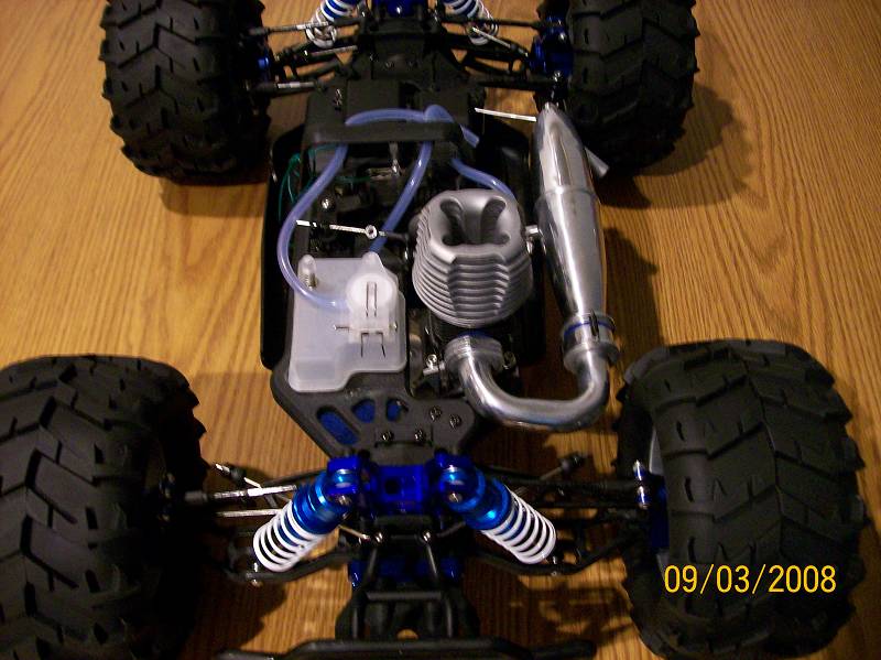

Hi, Guys well I have finnished the big block conversion and it was really easy to to, but I did have a problem IE: the back wheel was rubbing against the Manifold, so for now I had to put a spacer on the axial so the wheel is out a bit more so it'll clear the Manifold. I removed the metal tape and J.B Welded 2 peices of aluminum and riveted them to the chassie.
However the shocks are too soft for the extra weight and they will bottom out. Anyway to fix that??
Oh I was able to custom fit a 100cc tank instead of the 75cc one (looks good eh??).

nice job brother, get the wheel extensions, you can offset the rims by an inch or inch and a half on each side. I am amazed the shocks are too soft, there is not that big of a difference in the engine weights. Did you run it yet?

No Edddie I havn't run the truck yet. But I am sure with the power the shocks will bottom out cos there is a difference in the engine weights the .21 is more heavy (I can tell) . as for the wheel extensions which one do I need??

you need the 1in x 12mm hex for the megap if your using the stock rims.

Thanks, the conversion was easy (Just get a one piece engine mount for the engine) as for the wheel rubbing on the Manifold I'M getting another Manifold/ tuned pipe. The Manifold that I'm getting doesn't bend so far out, so I'll try that before I get those wheel extensions..
The pull start had to be removed cos there was no room, so I fitted a roto start backplate (cos it was thinner).. and in case your gonna ask I uped the gearing a bit instead of using the 15 tooth clutch bell I'm using a 16 tooth and maybe I'll have to go up to 17 teeth. I'll see how the truck runs first (don't want a wheelie machine eh?? LOL)
