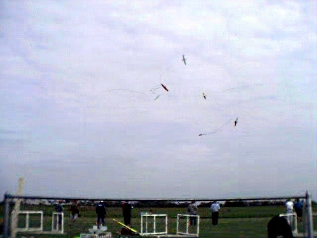

Here is the way things looked at the Jetero meet on Sat. 11/08.
Flying, (sorry about that fence top bar in the way), more flying, the flight-line, and taking a break over Sloppy Joe sandwiches, Hot Dogs, Coffee, Sodas, and freshly fried French fries, with the game on TV. Little cool for Houston, but low wind and lots of good fliers. Thanks, guys, for sharing your day with us. You put on one Heck of a Show.
Edited to say, Thanks to CD Pat Wilcox for bringing SSC to Jetero.
