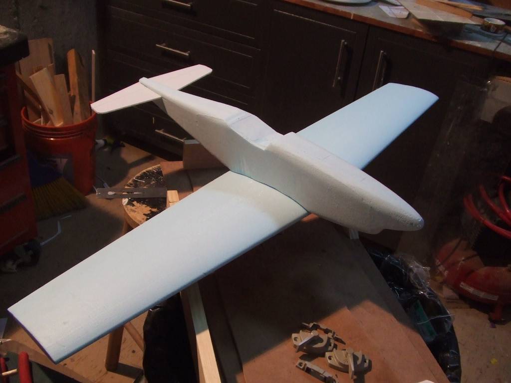

I'm building an SSC plane based on photos I've downloaded.
60" wingspan, my 1st attempt at cutting wings!
24" long aluminum rails holding an OS .15LA
My question is how do I position the wing saddle, fore and aft?
Then where will the CG be?
Lacking any further information I'll be going with the " looks about right " method....

My eye says that the LE of the wingtip will be really far forward, but it's hard to tell from the picture.
What you want is also going to depend on the airfoil a little, and don't forget to adjust the aileron reflex during flight testing.
For a starting CG, I'd shoot for something close to 25-30% MAC, which you can easily calculate.
Is this your first SSC plane or just your first own-design? If it's your first SSC plane, get someone to throw it for you, and give it a good shove, and be prepared for the plane to possibly loop over or nose-dive, it doesn't take much of the elevator trim to be way out on a new design.
What's the wing area?

Once in the air it was fun to fly.
I decided coroplast was not the way to go so this is my 1st attempt with cutting foam wings.
I'm trying to copy a SSC Battle Axe from pictures.
My wing is 9" root with 6" tip by 30" long.. NOT including the 1.5" alieron. I think wing area is around 450"
The fuse rails are 24" long with the OS .15 at one end and the tail feathers at the other end.
WHAT I DONT KNOW! is where to mount the wing saddle? 1/2" forward or backward will make a big difference? and I cant be that accurate from the pictures. THEN, WITH THE SADDLE IN POSTION, I can further adjust the CG with the battery position...
The CG calculators look good but will they work with this design?
Anybody out there got a battle axe?
Steve

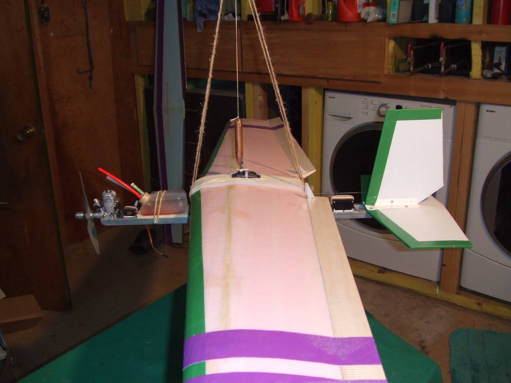

OOOO, Just hit me! Clamp the saddle in the position that puts the CG where I want it!!!
Sooo, put the battery and everything else on the plane, position the saddle&wing so the CG is 2' behind the LE, 15" out on the wing.
That sounds like as good a place as any to try???!!!!

Yep, that sounds like a plan. If you can, set things with the battery in "the middle", put everything else together, using tape or zipties to hold things in place, and figure out where the box would go to get the CG at the right point, and mark it.
Then assemble everything, double check, use the battery or anything moveable for fine tuning, and more fine tuning during test flights.

I havent figured out how to mount something for the wing rubber bands..
RE: How do I balance this thing?
A couple of 3/16" birch dowels that pass through the wing saddle to hold the rubberbands......or sew the dowels to the front and back of the saddle.
It looks like the CG will be just in front of the spar and I'm guessing you might have to move the engine back......just guessing from appearances.

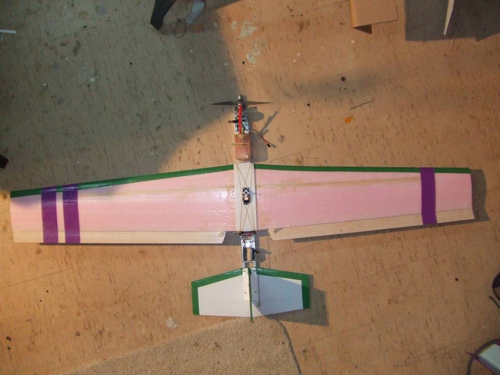

I try to do something each night to keep things moving... I'm hoping to maiden it this weekend. should be in the 40s, a heat wave!
Here is a shot from above it it tells you anything?
alot of firsts in this build...couldnt do it without all your help.
wing half:
root is 8.5" tip is 5.25" length is 29.5" plus 1.5" ailerons using a clark Y airfoil.
This is a little smaller than I had estimated in earlier posts. Someone had indicated that was a little small for a .15 engine???
Fuselage length:
from the prop to the LE is 8"
wing is 8.5"
From TE to elevator hingeline is 9"
Stll a few loose ends but almost there.
Fuselage length:
wing is 8.5"

Notice my right wing LE. It has a curve to it because I came around the LE of the template to fast and didnt let the wire catch up before I went around the LE...
I cut 12 half wings and got 6 usable half wings. trial and error.
This pink one is my "worst" good one.
The other two are bigger as I moved my pivot point out when cutting them
I'm looking at an all foam P51 next. 32" wingspan... Dying to take a crack at that fuse in foam....
Steve

For wing rubber band dowels, I've gone to using 1/4" solid fiberglass rods. You can get them at kite supply places like kitebuilder.com or your favorite source for composites. The fiberglass rods won't break for nothing, which helps keep the wing on in hard mid-airs. I used to use 1/4" hardwood, but the dowels broke way too often.
I like the sliding bracket. Is that just for setup, or do you want to fly with it that way? If you fly with it that way, I'd put the wing rods under the metal rails. That does mean you'll be landing on them, but they can take it. Or use a metal hook system like a lot of guys use on that type of fuse. But I'm not sure I'd rely on that metal bracket to hold shape in very high-Gs, and especially not in a mid-air. So I'd make sure that the wing is holding directly to the rails, and the bracket is just there to keep the box from moving.
Also, you might think about a way to keep the box from flying forward on a nose-first arrival. I've seen a number of Axe-style planes punch holes in the fuel tank as the box comes forward, pushing the tank and throttle servo together and into the engine. Often times, the plywood wing saddle box dies in the process as well, but it kind of depends on exactly what hits what. In any event, look at what will happen should the fuse do a lawn dart, and see if you can reduce damage.
about the size of your plane, it's not small over all for a .15, but I think your wing area is a little small for a competitive SSC design based on what I've seen. The problem comes from the SSC rules requirement of a minimum weight of 2.5lbs (40oz). At that weight, and the intentionally limited power, SSC planes need to have a light wing loading to perform well.
Speaking of which, I can't tell from your pictures what your wing saddle looks like. If you have a flat bottom on the airfoil, make sure you aren't setting the flat part of the airfoil down parallel to the metal rails. Doing that gives you a ton of positive incidence, which you probably don't want. You'll probably want a little negative, maybe a degree or two.
The good news is that the Clark Y has fairly nice stall handling.
btw, I meant to ask earlier, you said you used the Clark Y, was that the actual Clark Y template from an airfoil library, or do you just mean a generic flat-bottom airfoil? A lot of folks in RC models seem to call anything with a flat bottom (like on many trainers) "Clark Y", even though it isn't actually the Clark Y airfoil.
ORIGINAL: Montague
****I have the same concerns. this was setup for first flight adjustments. I'm thinking it will hold for the first few trimming flights. The redesign saddles will screw into the rails?? ****
**** good point! With my concerns about the CG being right, A lawn dart could happen. Maybe for now I'll pop a couple of screws up through the rail in front of the saddle. I'd rather destroy the saddle than the servo and tank..*****
*****I have 3 good sets of wings to play with. The pinks are my first attempt at finishing. The others are larger. 10" root with 5.25 tip and 32" long each. On one, instead of cutting in a 1/4" x 1/4" spar I cut the whole front of the wing off lengthwise and spliced in a 1/4" piece of pine. This wing is solid as a rock and weighs about the same!
I;m waiting to finish the 3rd wing. I'm not sure how strong I have to make it by adding a spar??
My pink wing has some flex to it but I stopped the spar about 7-8" from the wingtip and think that will be a weak point when the wing flexes.*****
****** I used the same file for the saddle and the clark Y template. I kept the centerline of the airfoil parallel with the fuse rails so I would think its at 0 incedence?? This is what I mean about that 1st toss, so many factors involved.*****
btw, I meant to ask earlier, you said you used the Clark Y, was that the actual Clark Y template from an airfoil library, or do you just mean a generic flat-bottom airfoil? A lot of folks in RC models seem to call anything with a flat bottom (like on many trainers) ''Clark Y'', even though it isn't actually the Clark Y airfoil.
******I actually used illustrator to trace a pic I got off the web labeled as a clark Y so I'm not 100% sure.. I now have profili And I'm trying to gather some common profiles and create templates out of them for a friend to laser cut out of formica.******

I couldnt wait and did this today. Start of the P51 mustang.
The wings I cut with the double taper are kinda like a mustang.
I found metalic duct tape that will look good..
I'm seeing variations in wing thickness I want to address next cutting..
