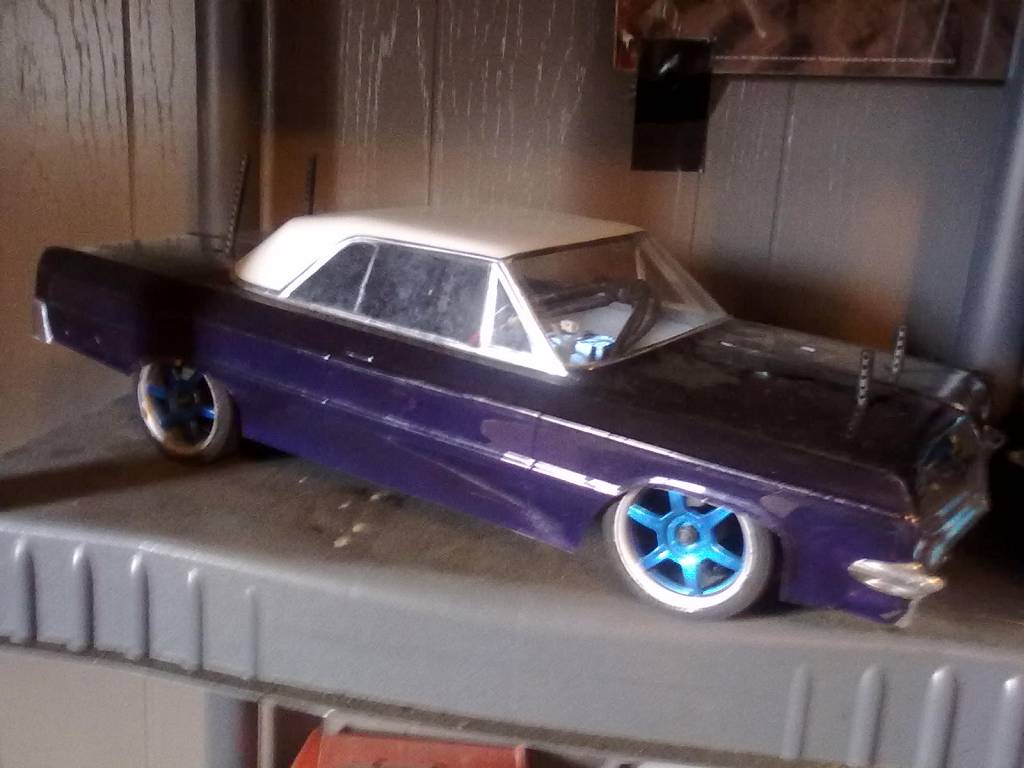

i get the basics. i know that some have setup the rear tires to spin faster than the front. and that that usually involves a belt driven 4wd with a smaller spur in the rear.
so, hear is my issue. i have an exceed mad speed. now IMO, its not a bad little car for the money. it drift pretty well as-is, but not like in vids i have seen of counter steer setups.
now, the exceed is a shaft driven car. i dont think i can have any way to gear up the rear end by itself.
however, i do have a nice mustang body....and i have 2 different sets of drift tires. one set is just flat smooth plastic over a rim, and the other set is a profiled smooth rubber tire on a rim. in other words, on set has a slightly larger diameter.
now, what i need to know is will it be enough? for a counter steer setup, how much faster does the rear have to spin in relation to the front?
lastly, do i have to find some way to increase the steering angle as well?

In order to counter steer you need the rear tires to turn a minimum of half a rotation more than the front. So for every one rotation of the front the rear does one and one half. You cannot achieve that much rotation with a larger diameter tire. I saw an exceed madspeed with 2.0 counter using a team associated gear.
With 1.5 CS ratio, don't worry too much about steering angle, see if you can shave off the steer stops on the steer knuckles this should give you the angle you will need.

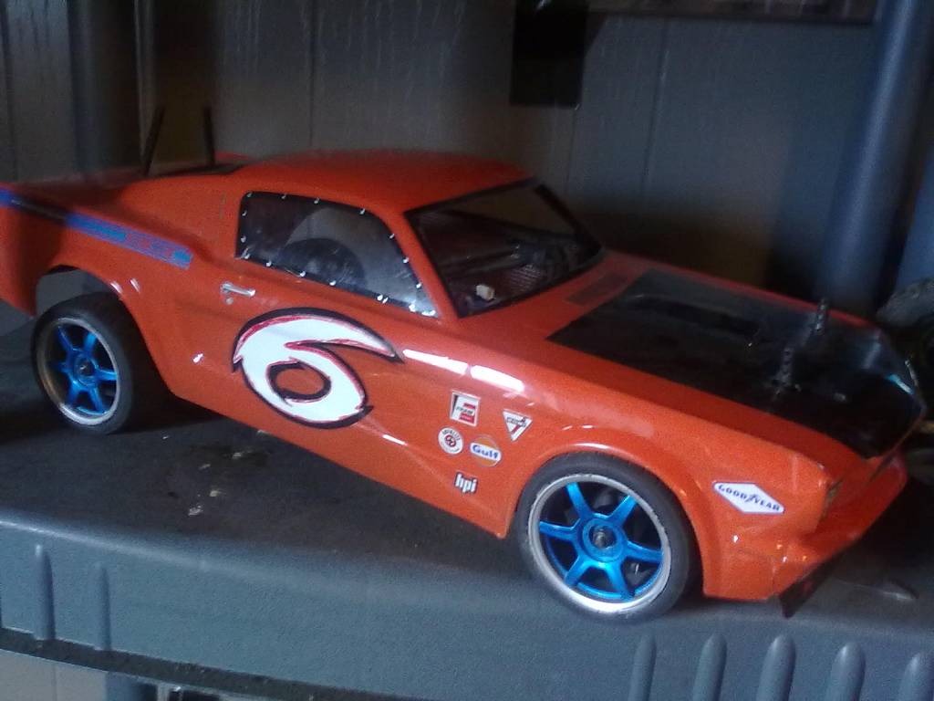

here is one other shell i have for her
