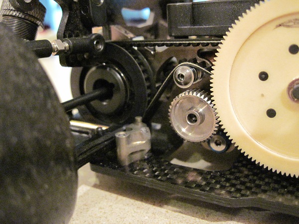

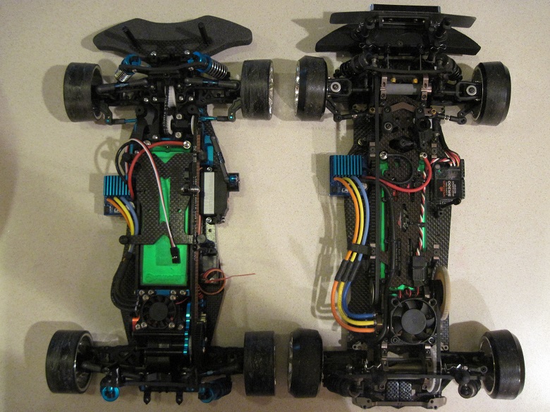

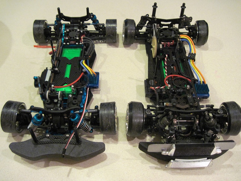

Here's a couple of pics, to show you the similarities between the TA06, and the Losi JRXS Type "R", and the CS mod I did. As far as I'm concerned, the two are "kissing cousins." They are also, in my judgement, the best on-road chassis for multi-purpose on-road use.
Tensioners can be made with a couple of 630 bearings, and a 2mm screw and nut. The tensioner in the pic is just a stainless screw, two 630 bearings, three proper-sized washers, and a nut to fit the screw. That's it!
Yah, if you ever decide to outfit the TA06 for grip driving, use the anti-roll bars then. They definitely help in grip driving!

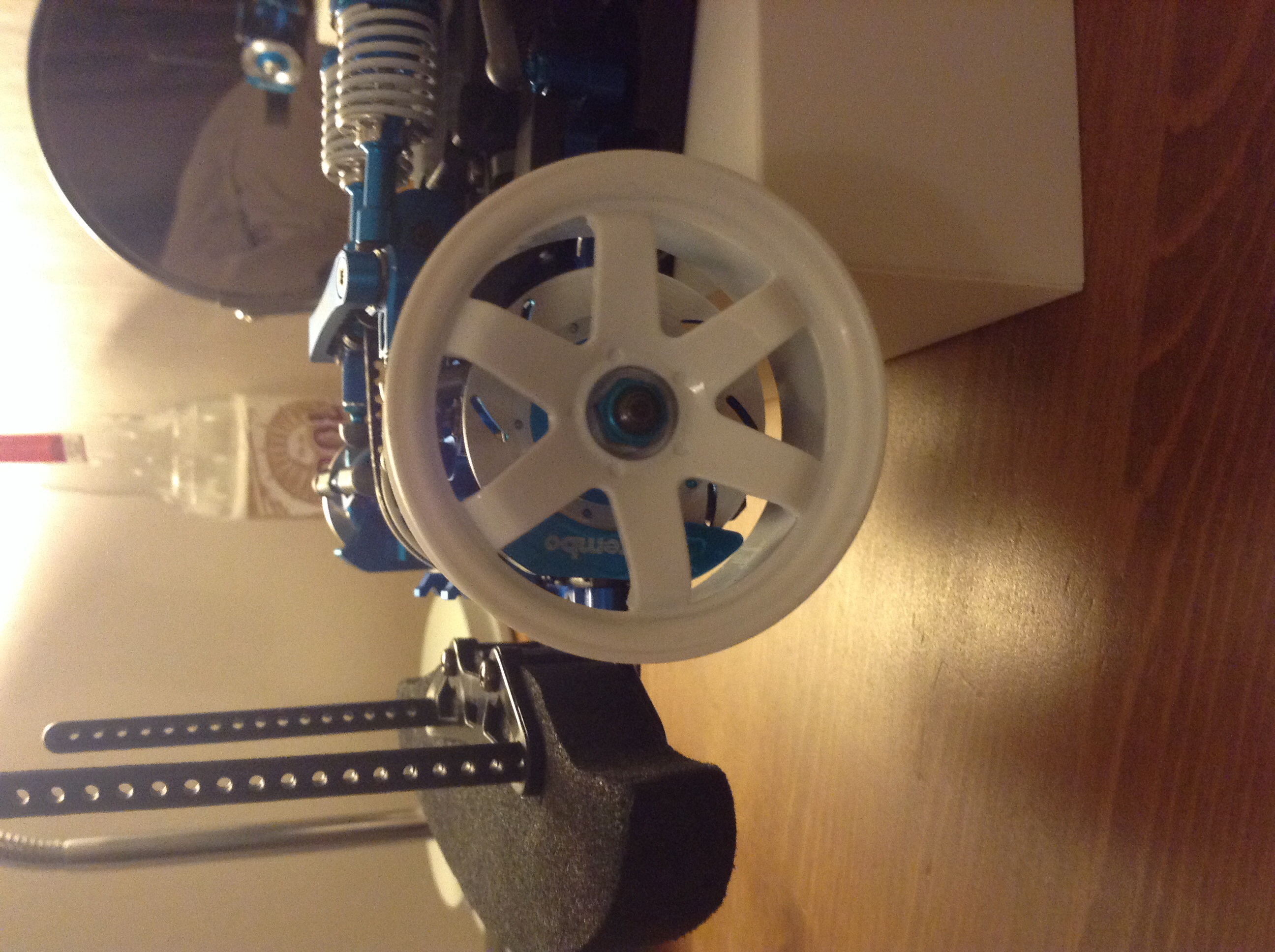

I've managed to upload two, my wifi speed might be interfering, but this is a glimpse of what it's like just now

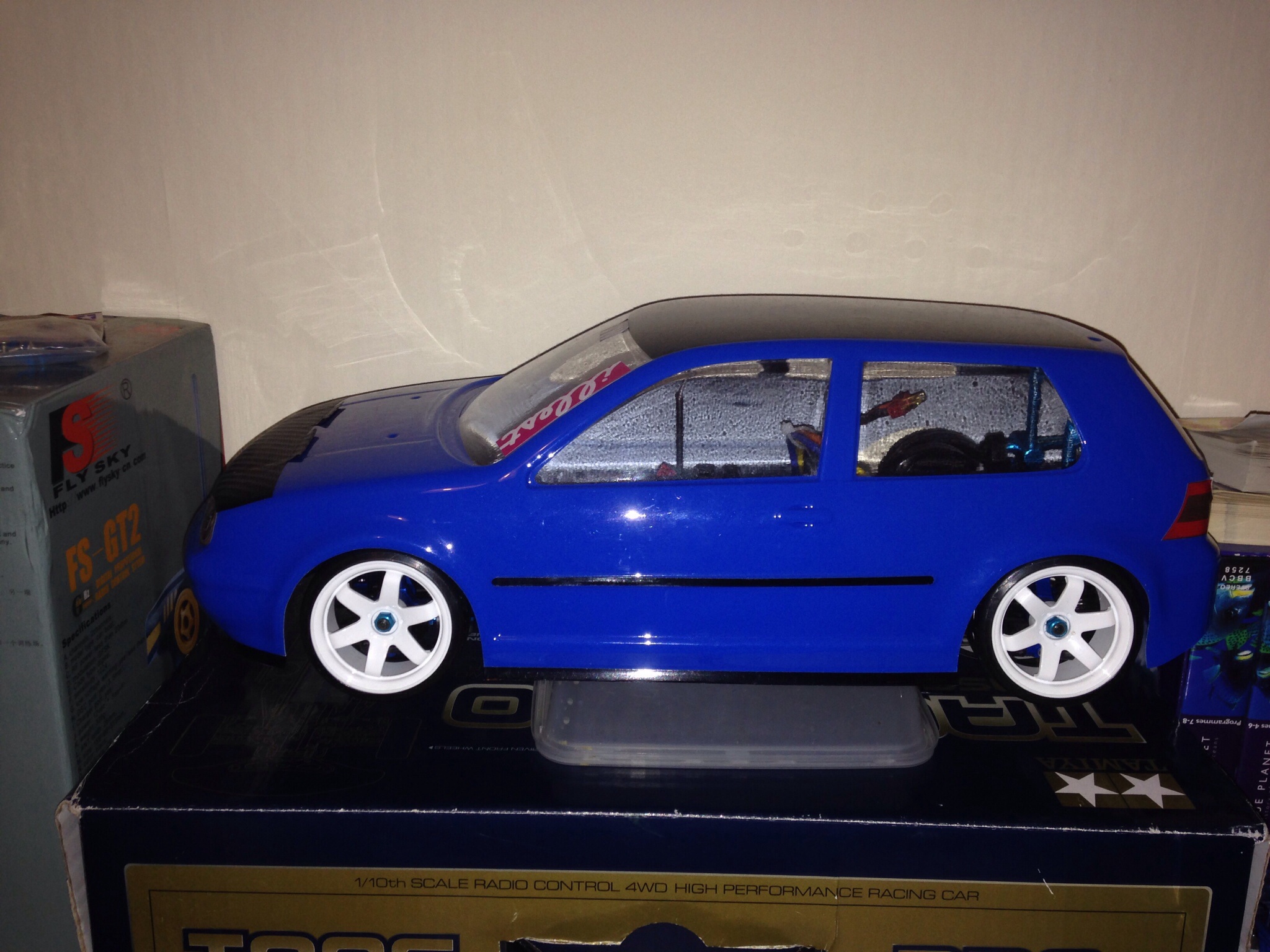

This is a glance of what it was like last year, I'm very pleased with how the shell turned out and I've done my best to look after it, it's almost two years old, and not a mark on it
I see you went with the IFS set-up. Difficult, that, to set-up precisely. I also see the center one-way tucked in there.
You said you CS'ed that chassis? How did you do it, and can we see pics of the parts involved? I have a friend who is considering a TA06, and wants to CS his, when he gets it.
Nice and clean! I like the black roof and bra.

O.K., then you haven't. You need more than just a one-way to CS. The one-way doesn't CS. You need to alter the ratio at which the rear wheels spin, as opposed to the fronts. It's also called "Rear Overdriving," meaning the rear wheels spin at a faster rate than the fronts. CS is delineated by a "ratio," or the amount of added wheel travel the rears spin, than the fronts.
Now take the pic of the rear pulley and belt arrangement I posted. That is CS (though a very mild one). The pulley is smaller than the one it originally came with. That effectively altered the rear wheel speed by one-third of a revolution, or 1.33. That means that the rear wheels spin at a rate of 33% more than the fronts. This is what allows you to "steer" into the drift, like a CS chassis is known for.
To mechanically CS a chassis, you need to swap out pulleys, and more than likely, a tensioner will have to be made, as well. The TA06 doesn't lend itself to CS easily, though I have seen examples of guys doing it to a TA06.
Check out "CS Junkies" online, to see some examples.
