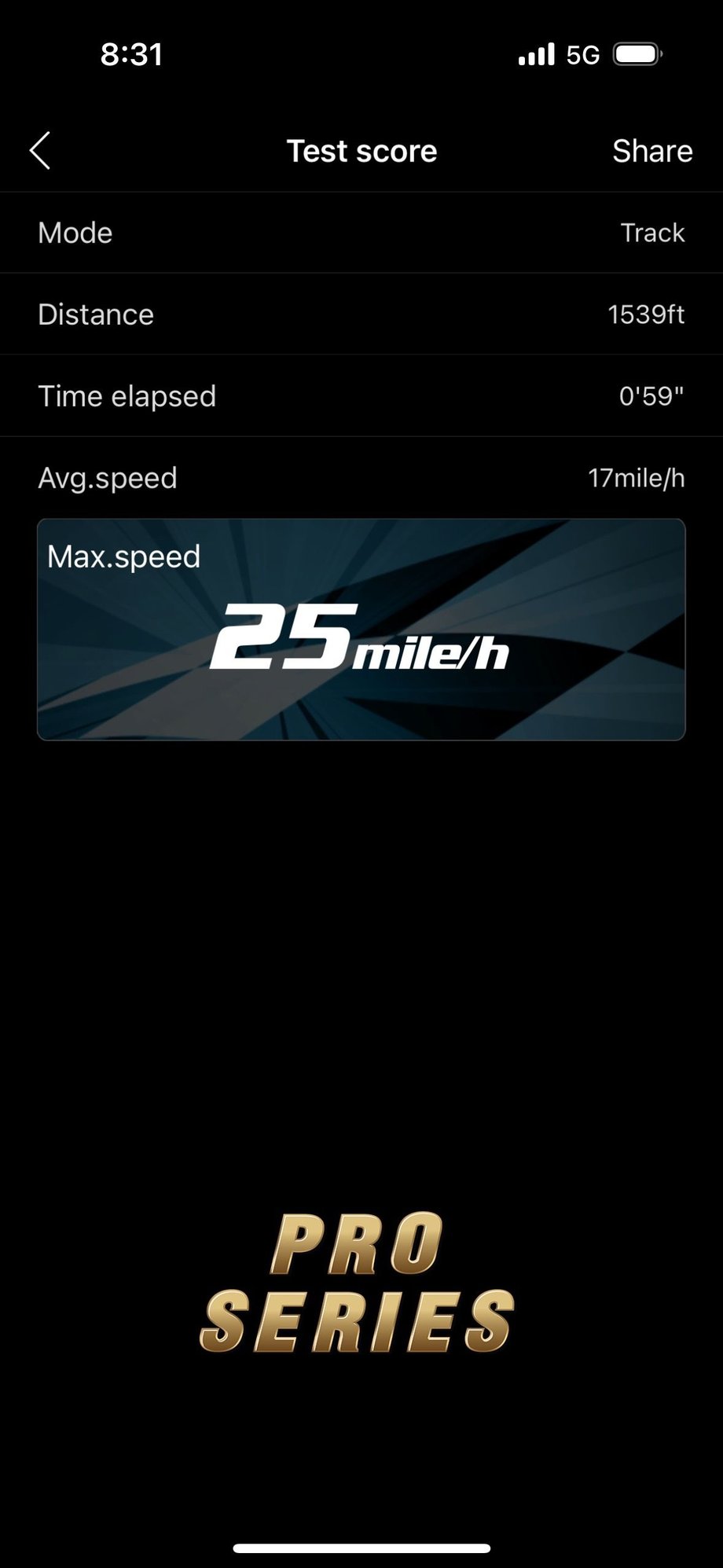

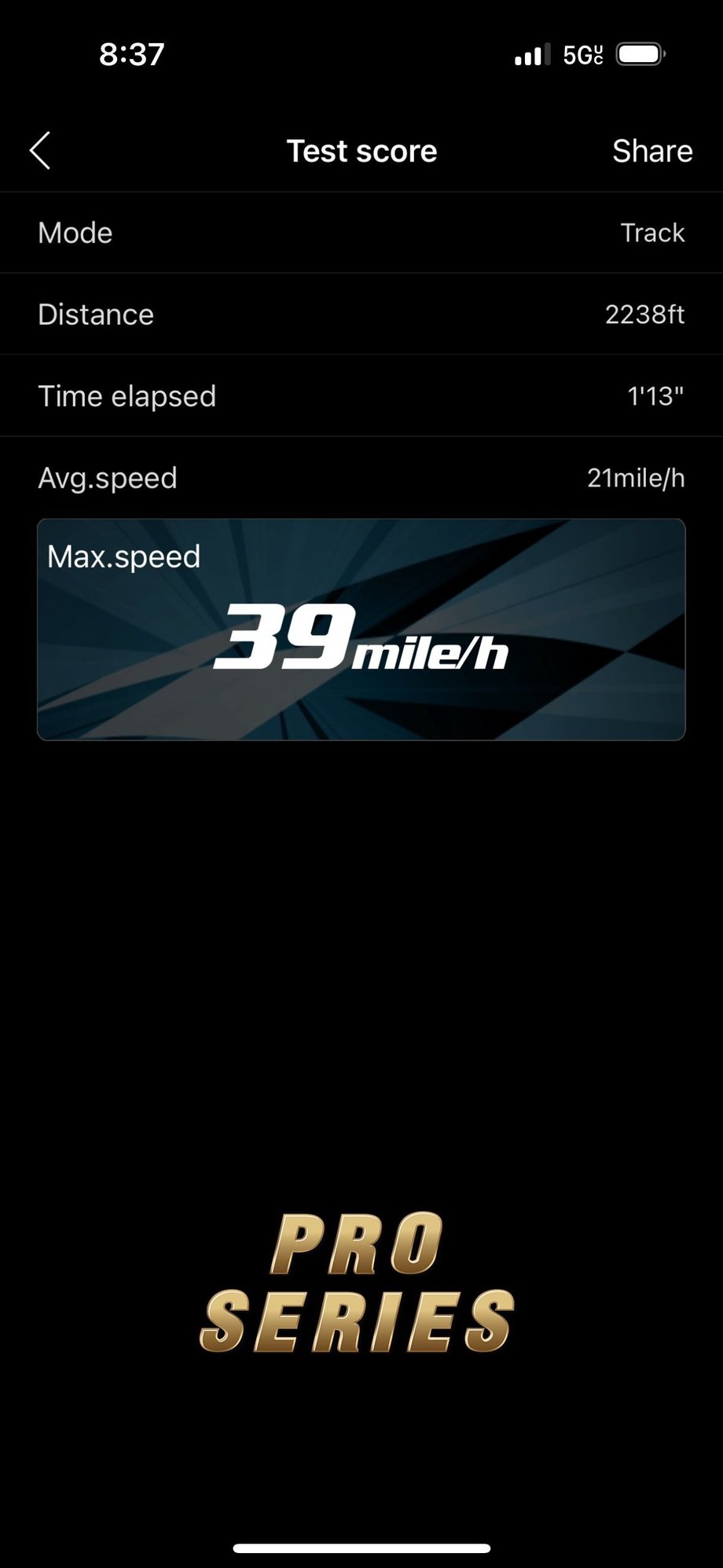

I finally caved and picked up a GPS from SkyRC to see how fast this build is. On-road, that answer is 37mph on 2s, 55mph on 3s. I think a fun game will be to see how close I can now get to these numbers off-road!
I took the rig out for a bash at my local public park this morning. It wasn't a dedicated off-road speed run session, but I did keep the GPS on the whole time I was on dirt and gravel. Looks like my max off-road pull on 2s was 29mph (compared to 37mph on-road). I need to find something bigger than a baseball diamond to try 3s.
This is my first GPS-monitored 3s run off-road. The run was on the same baseball diamond as the 29mph 2s run from my previous post, and so while I know it didn't have enough room to get fully up to speed, it's a starting point. I'm thinking I might need to take it to a beach in order to get an area large and flat enough to beat this, but my hope is that I can find a nice, wide dirt or gravel path somewhere in my area soon for testing purposes.

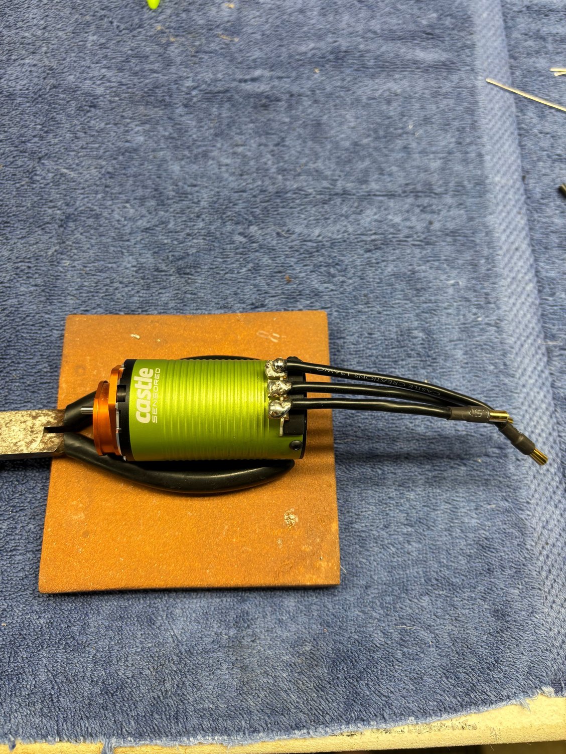

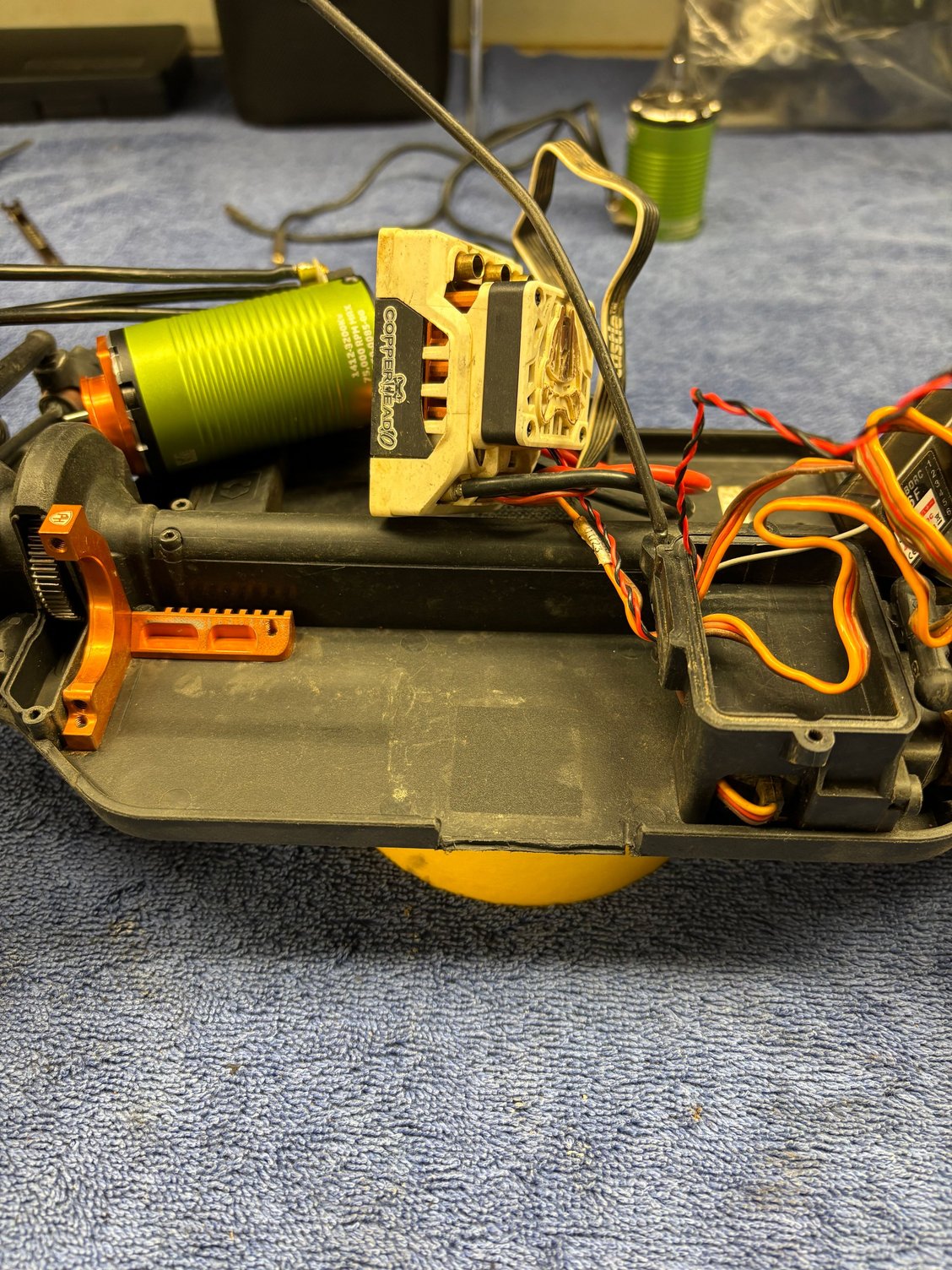

This is one of the bigger, milestone changes to my custom rally build since its inception. In its long-standing configuration I've had over the past two years, the rig was simply running too hot much of the time, and the impetus for change is that I effectively burnt out my second Castle 1410 3800kv motor. As with the original 1410--it still technically runs, but performance has degraded, and it was too hot to touch at the end of my last bash, which is a bad sign for magnet depolarization. I normally would have kept the same setup but geared-down for motor #3. My issue is that I have only ever been able to source a 66t hardened steel spur gear for this rig, which limits the amount of gearing down I can do to the pinion. I'm dropping from 31t to 28t on the pinion, which helps, but is not significant enough of a decrease to solve the heat issues entirely. HPI and several aftermarket manufacturers make a 75t spur gear, which would be much better, but I have not been able to find one in steel or even aluminum. The last time I ran the rig with one of the plastic 75t spurs, it didn't even survive a full battery pack, which is only slightly worse than what happened the preceding two times I ran a plastic spur, and is a no-go for me. The brushless setup really wants metal gears.

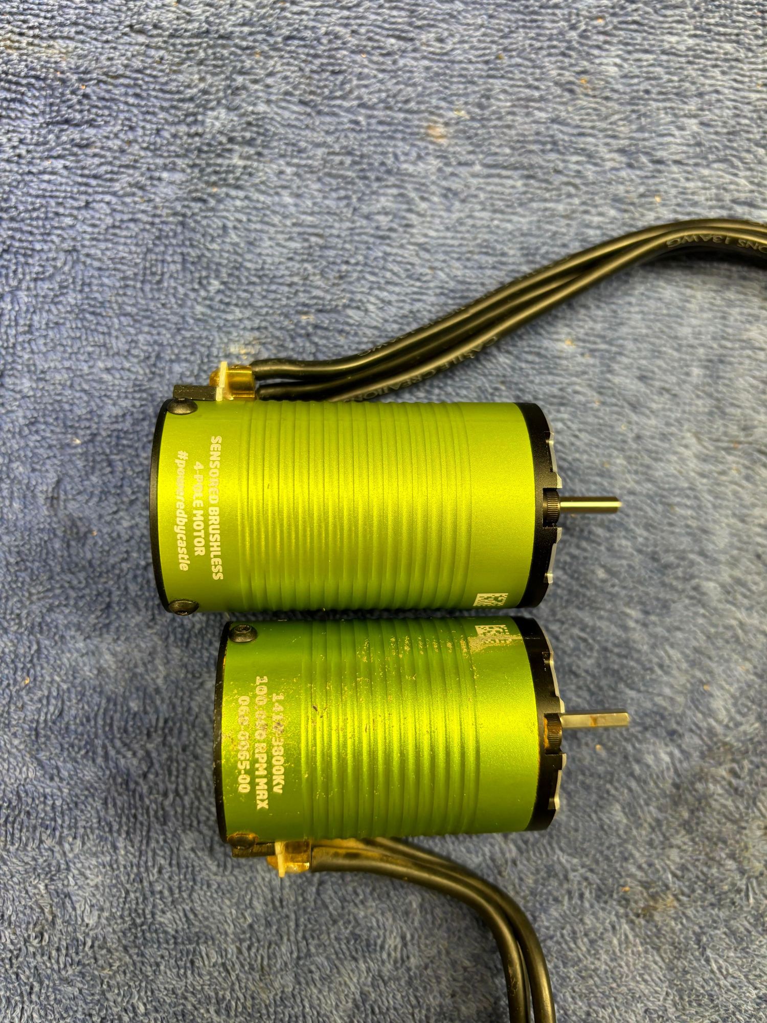

With gearing limitations like these, my next best choice was to look at a cooler-running, lower-top-speed-but-more-torque-motor. Enter the Castle 1412 3200kv. As you can see by the photos, it's considerably larger of a can compared to the 1410. This required me to rotate my ESC by 90 degrees, hence the chassis side-wall delete, as it doesn't fit in the sideways orientation. Since I was already doing all this work, I also took the opportunity to shorten the motor leads and re-solder them to point 'backwards' towards the ESC as shown. This is so much neater, and I regret not doing it sooner. FYI--I learned in the process that Castle uses a solder mix of 96.5% tin, 3% gold, and 0.5% copper, which needs at least 400C temps to melt. I had to buy a new soldering station in order to complete this work, as my plug-and-play irons couldn't melt the solder on the motor terminals.
With the chassis modified, new motor reconfigured, and drop to a 28t pinion, I can confidently say this has been an improvement. We're slower-running*, but with cooler temps, and I think this new setup will last longer than my previous two motors did.
*For comparison, regarding speeds:
On the old 1410 3800kv motor with a 31t pinion
2s: 37mph
3s: 55mph
Test conducted on a 100F degree day
On the new 1412 3200kv motor with a 28t pinion
2s: 25mph
3s: 39mph
Test conducted on a 24F degree day
Honestly the original 1410 setup was waaaay faster than necessary for something designed to run on mixed surfaces. With this being a narrow little 1/10th scale touring car chassis at heart, you really can't control something this small and light moving that fast off-road.
With temp issues under control, it's not lost on me that I've swapped to a power plant with more torque and may be shifting my issues to elsewhere in the rig. I will be keeping a close eye on the drivetrain to see if the increase in torque starts to wear out components that were previously doing fine. Ultimately I'd rather be faced with replacing bearings and diff gears from time to time as opposed to motors, which was much more costly.

Comparison between the new motor (top), and old motor (bottom).

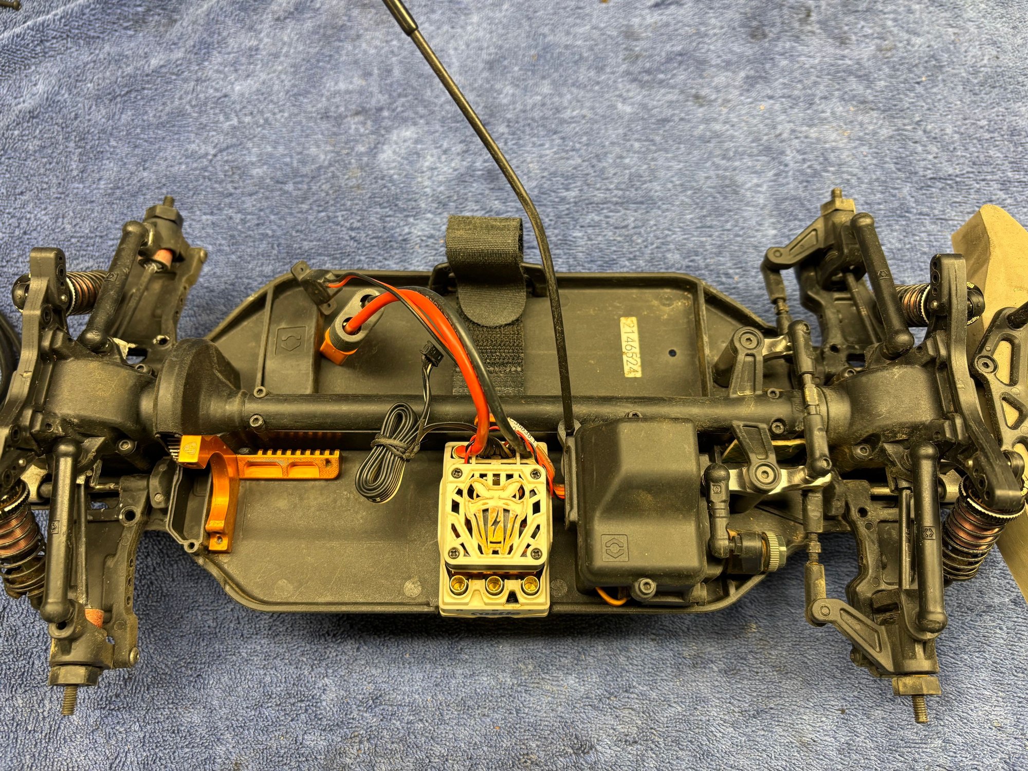

Deleting the chassis side-wall so that the ESC can be turned 90 degrees, to allow for the larger (longer) motor can.
ESC now fits in sideways.

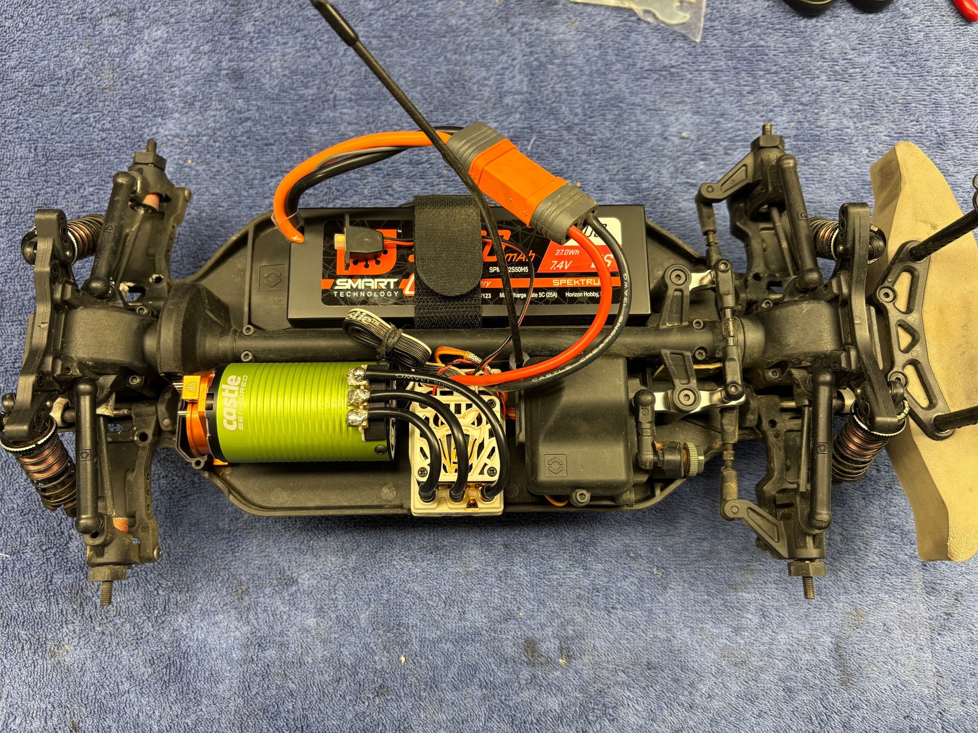

This is what it looks like with the new motor in, and ESC rotated. Just barely enough room, but it works.

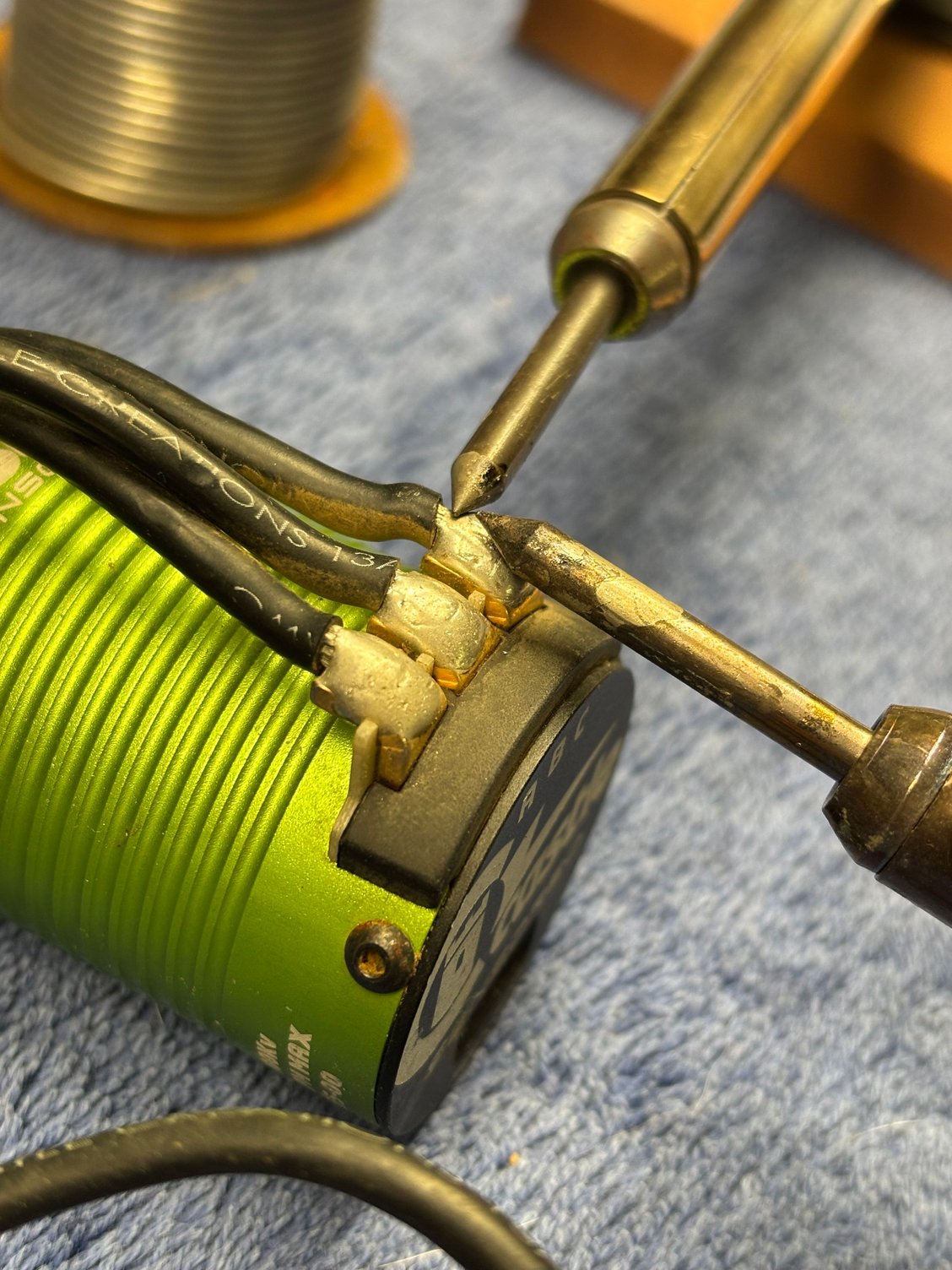

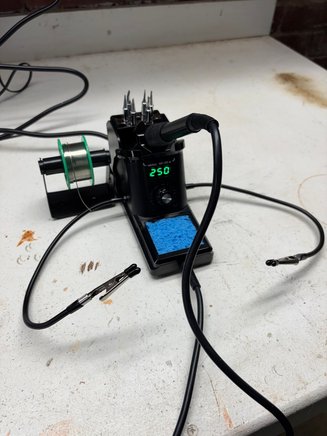

Two plug-and-play irons not hot enough to melt Castle factory solder.
Bought this new beast which can get the solder job done.
Leads on the new motor shortened, and now pointing backwards towards the ESC.

New motor speed run on 3s.

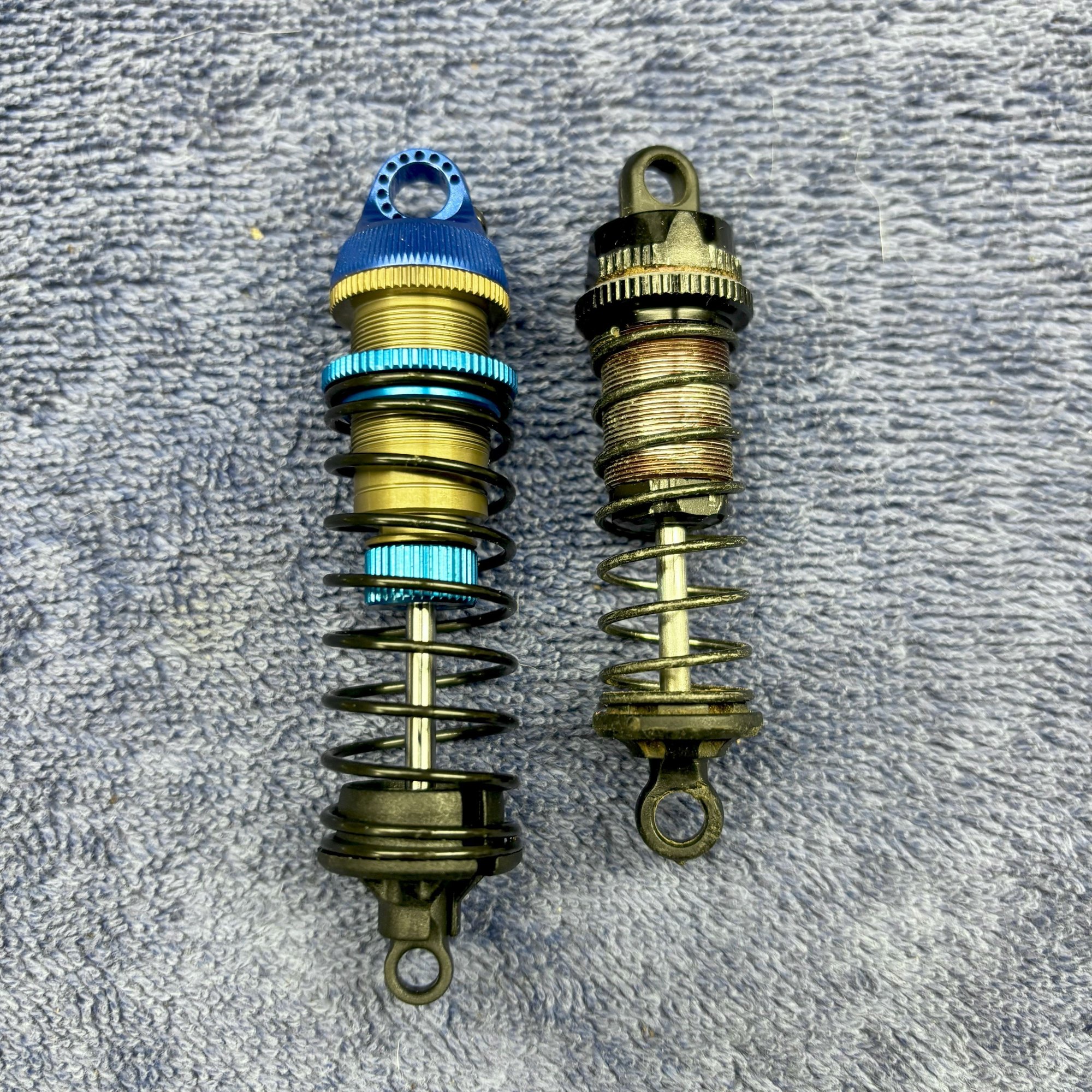

Today's post brings another significant update to the custom rally RS4 build, this time in the realm of suspension.
The 65mm Yeah Racing shocks I've had on the chassis for a number of years now have worked out really well overall, but have started to show some serious wear and tear. They don't seem to hold their oil for as long as they used to between servicing. To be clear this is through no fault of their own, and nothing is wrong with their design-- running off-road and at-speed is a harsh existence. While I'd generally be happy to pick up a new set and move along, I wanted to take this opportunity to give the suspension setup a little love. Ultimately I made a post on Reddit asking which aftermarket shocks the RC community likes, and of the many answers, Associated 12mm dampers were mentioned pretty consistently across the board. I liked that they sell all the shock components and internals separately, so that I could not only learn how to assemble a shock from scratch myself (the Yeah Racing ones I've previously used are factory-assembled), but also, this would allow me to replace individual components that fail or experience wear, as opposed to buying all new shocks.
New Associated shocks (left); old Yeah Racing shocks (right)
The one thing I'll say about these Associated shocks is that, for as nice as the finished product is, the company sure didn't make anything easy on me. I found it harder than I expected to simply create a shopping list of all the parts needed to build four complete, working shocks. I even emailed customer service, and they couldn't tell me either. I ended up having to pick one of their RTR models (I used the SR10), download the manual, and use that as a sort of 'guide' for what components are needed. The number of parts that go into these shocks that have literally zero specifications or measurements listed on the Associated website was baffling. In many cases the Amain product page for the same part had more information than the Associated website. Why does Associated have a 'specifications' tab on every product, but most of the time there's no info listed? I had no fewer than three email chains going with Associated customer support, and they couldn't tell me almost anything about their parts...for example, what sized pivot balls to get for a specific shock rod eyelet, or how long the overall shock is once assembled if I use xyz sized shaft and body. I also found more than one product manual where the graphic had mislabeled parts-- the image would be correct, but the part number listed for the part in the image was wrong, or mixed up with a different part in the diagram.

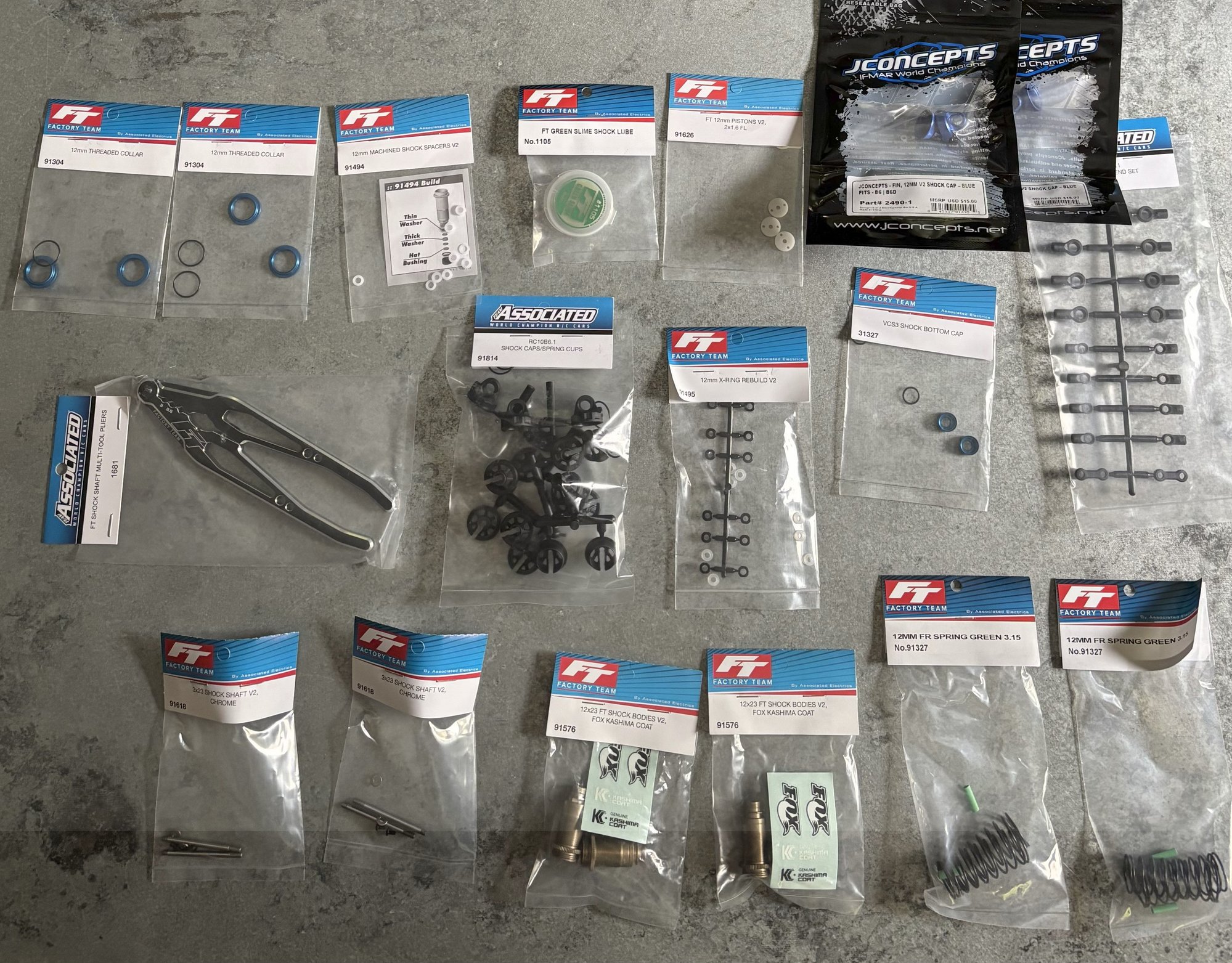

Anyway, after way too many emails and lots of research, I finally was able to assemble four complete "12mm" (diameter) shocks. I splurged and went with the Fox "genuine kashima coat" shock bodies, as well as some aluminum caps from J Concepts. They went together nicely, and feel great in the hand. The build quality almost made me forget how much trouble it was to figure out what I needed to buy in the first place lol
This then brought me to my next challenge, which was mounting hardware and overall fitment.
The assembled Associated shocks, using 23mm shock shafts and 23mm shock bodies, are roughly 78mm eye-to-eye, as compared to the 65mm eye-to-eye Yeah Racing shocks I had been using. Technically you can mount the Associated shocks to the stock RS4 chassis, but they are basically fully compressed when at rest with only 1-2mm of travel, which obviously was not going to work. So, I either needed the lower suspension arms to be able to drop lower than they do stock, or have a taller shock tower.

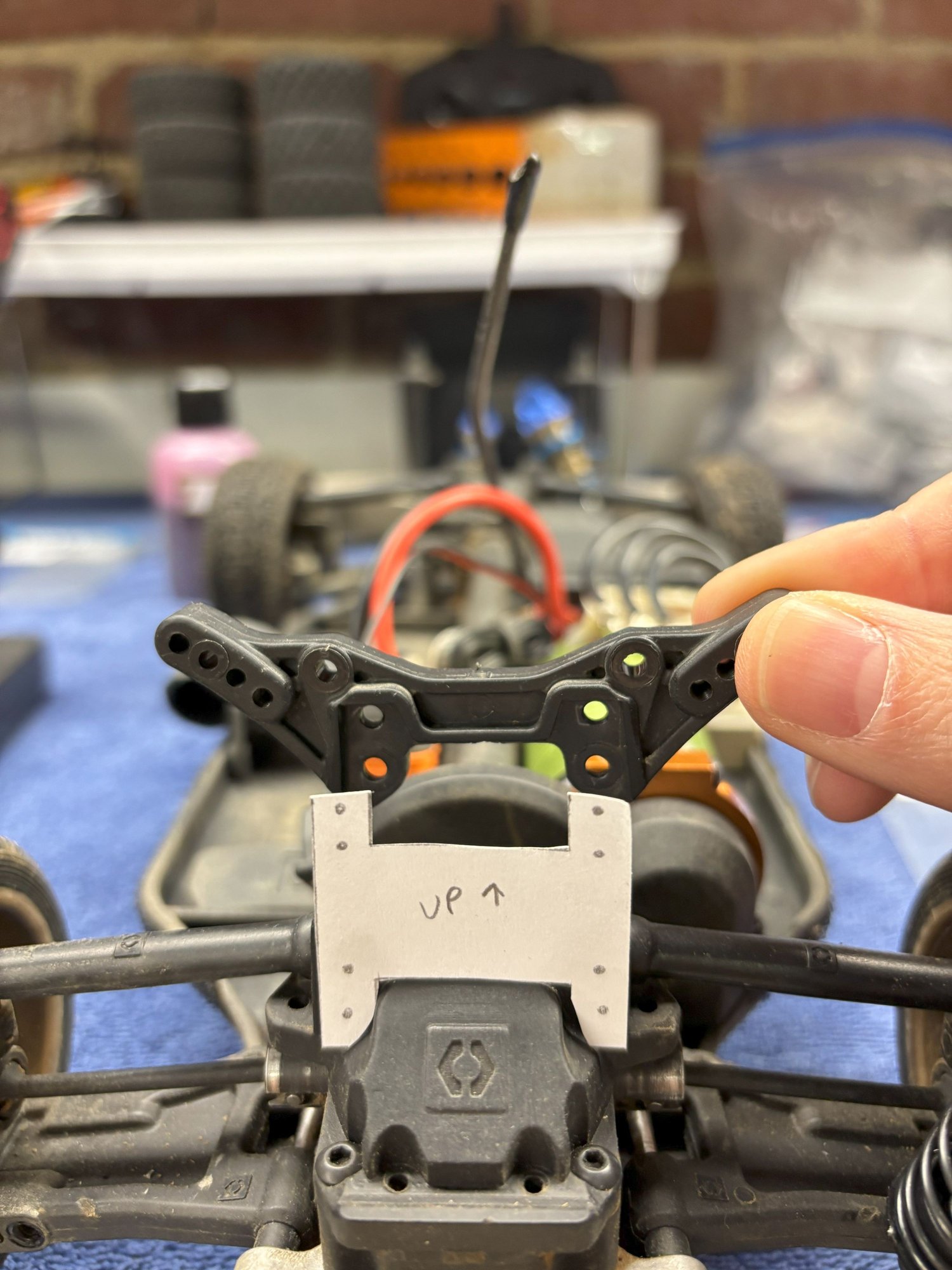

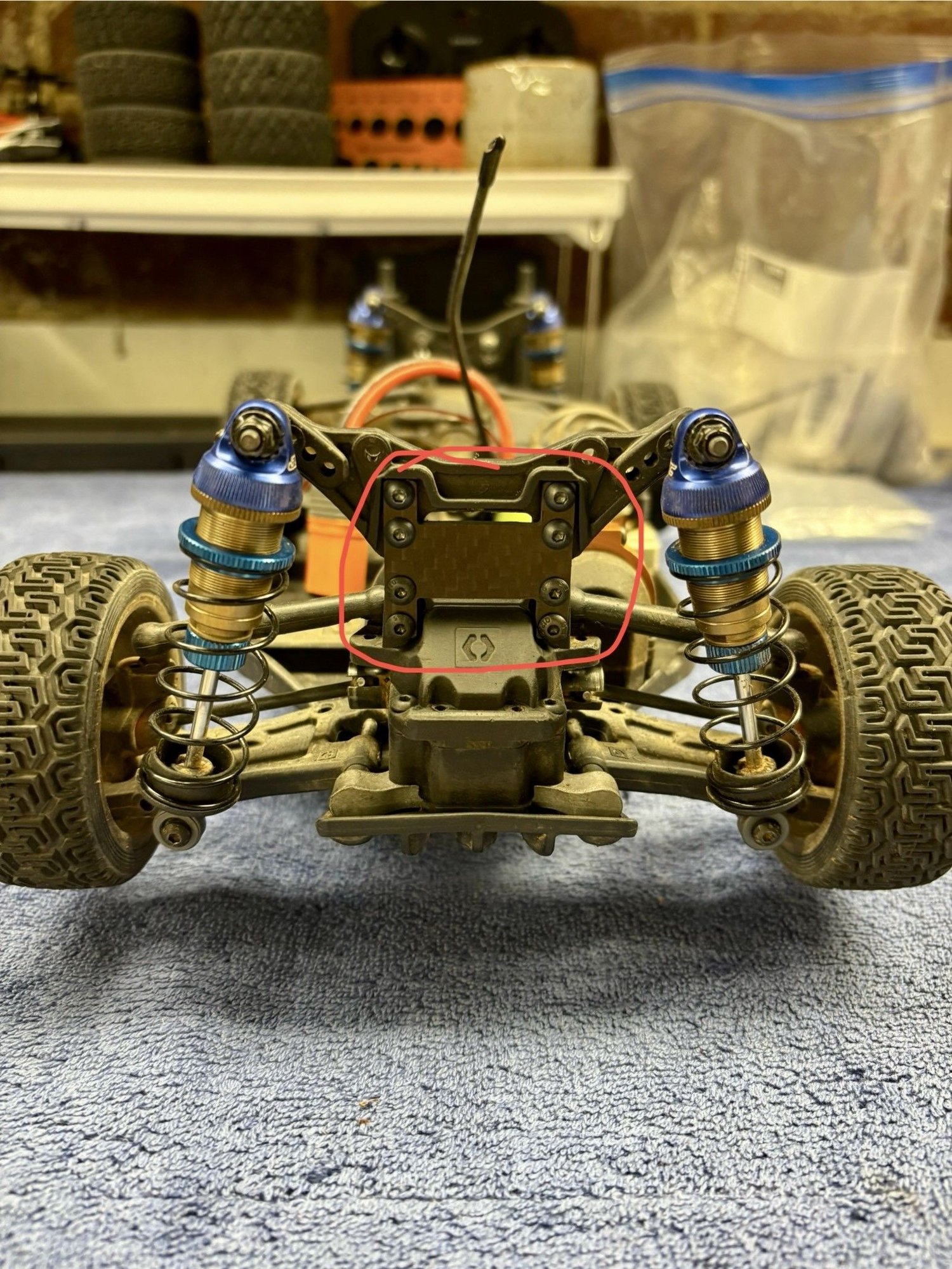

I first tried to modify the lower suspension arms and bottom chassis plate to allow them to extend/ angle down further than they do stock. The work itself was easy enough and took a single afternoon of measuring and removing material with the circular saw and sanding attachments on my Dremel. The finished product, however, was not viable. The angle of the universal shafts going from the diff cups to the wheels was too extreme. Under power, the car damn near rattled itself apart, and the shafts popped out of the diff cups almost immediately during the one and only on-road test I performed, which was on perfectly smooth asphalt too-- not a promising design if I'm meant to be running on rough terrain befitting of a rally car. Also, the suspension geometry got altered in the process, such that the toe of the wheels would change over the course of the shock compressing. It was worth a try, but clearly not a good final solution.
I then went the route of trying to hand-fabricate a taller shock tower design. I picked up some 3mm thick carbon fiber plate on amazon, and simply cut four bars (two for the front, two for the rear) that I could use as extension brackets to raise the stock arms taller than they normally sit. I did this free-hand using the Dremel, and while they aren't exactly perfect, the design is sound and the fitment was actually quite sturdy.
I tried a few other designs too (see below), but the simple bars shown above were about the level of DIY design I was able to successfully implement with the tools I have available.
One of the failed designs-- way too complicated to cut and drill free-hand.

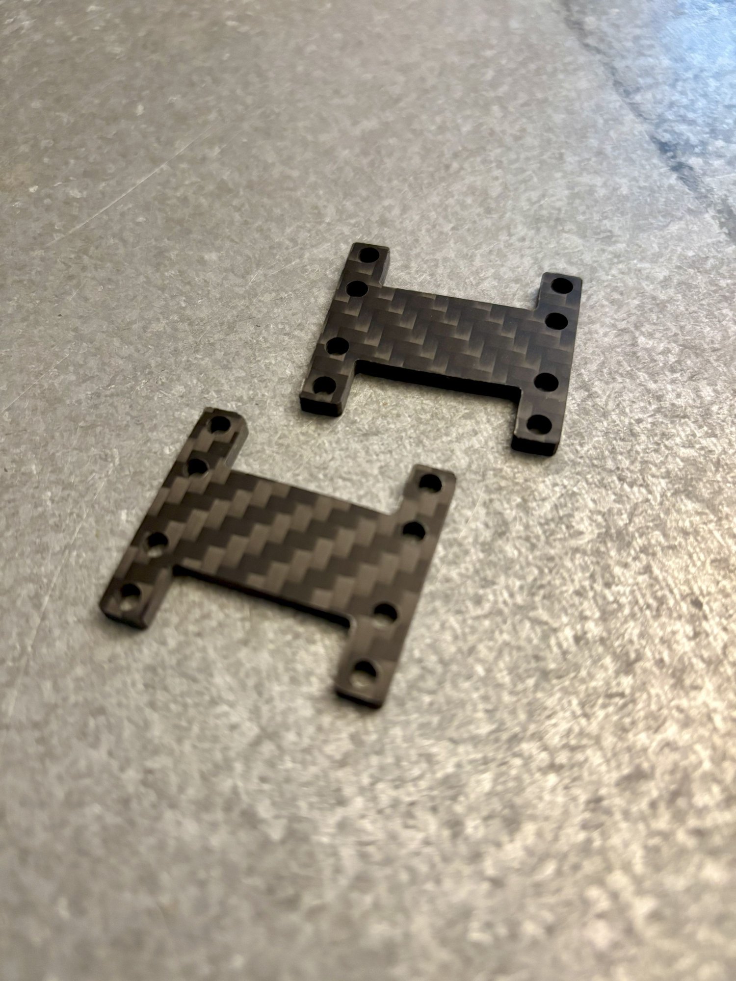

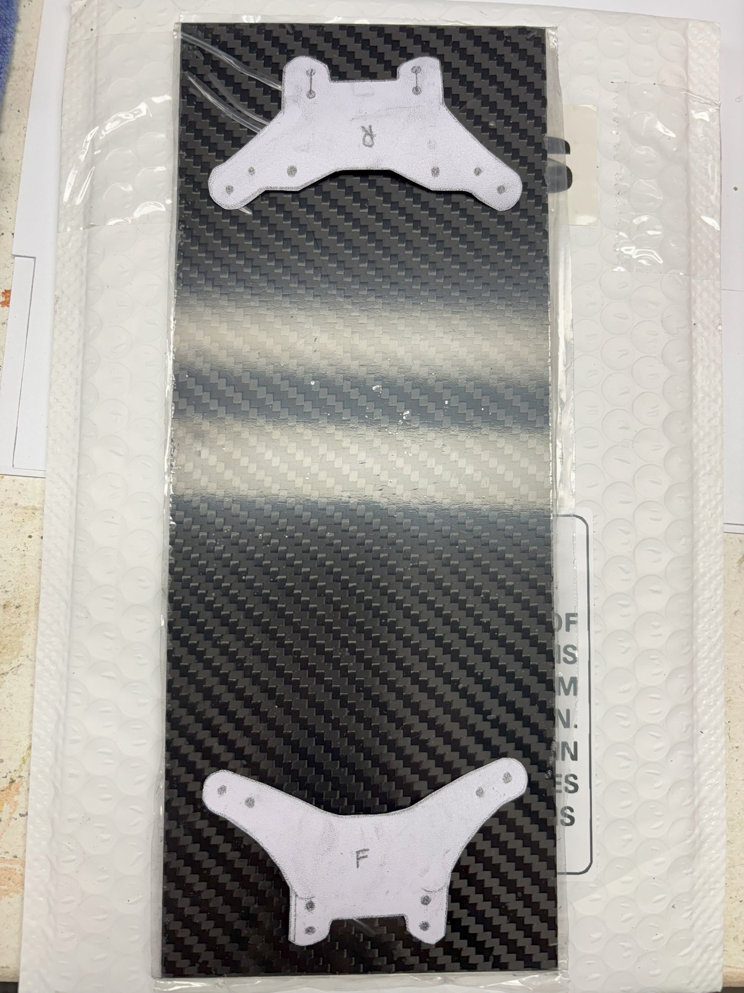

I then designed a more complex and durable H-shape bracket which I was not successful at making myself, but I sent a technical sketch to a buddy who drew it in CAD, and sent it off to PCBWay to have it professionally cut using CNC/ lasers. Having that CAD file, I can now also order spares/ replacements easily if anything breaks.
Mock-up stencil of H shape, pre-production
Finished product from PCBWay

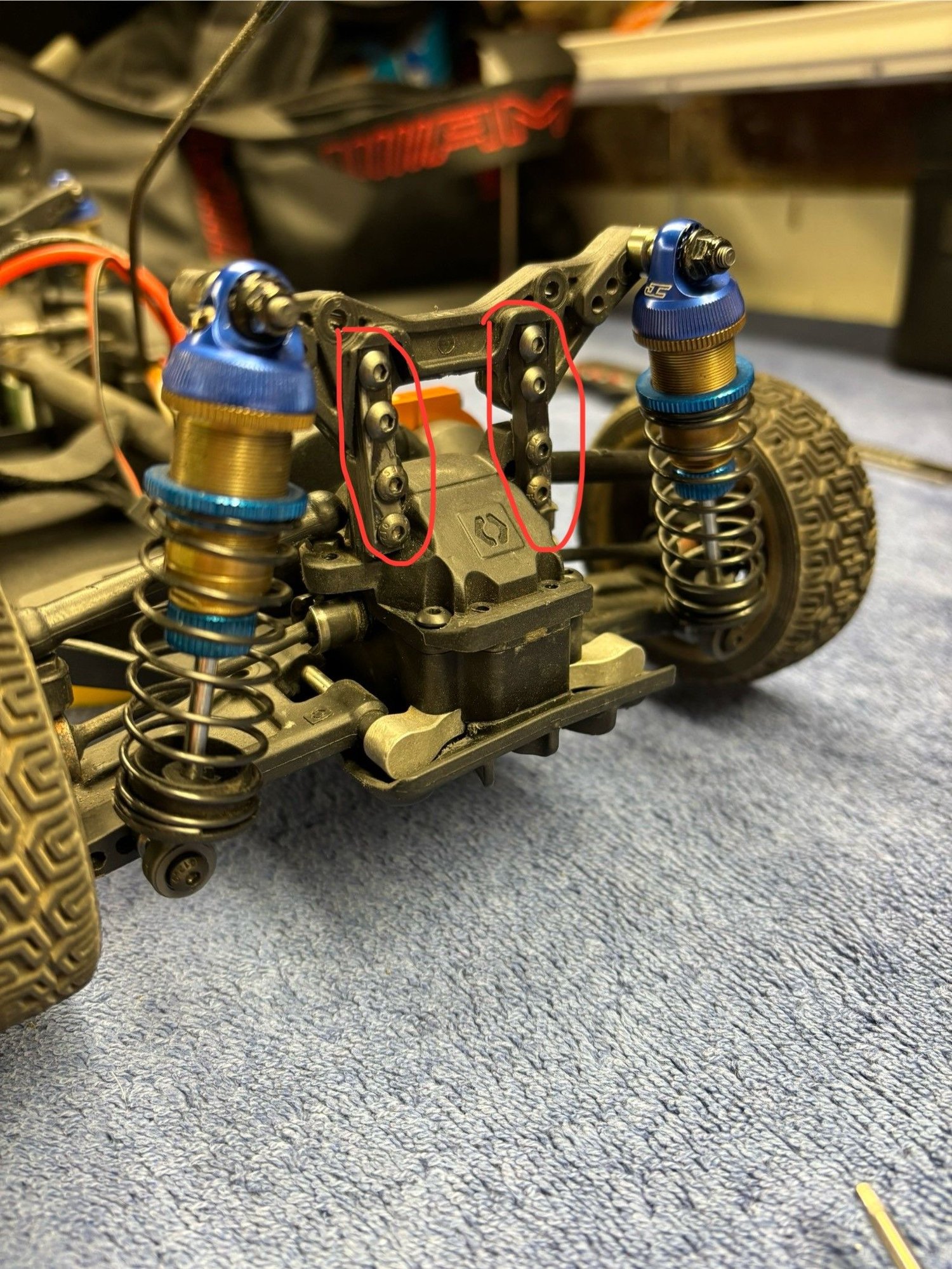

Final production design, mounted to the car
The final piece of the puzzle was that, with the beefier shock bodies and stand-off bushings, I had to mess with the body posts a bit.

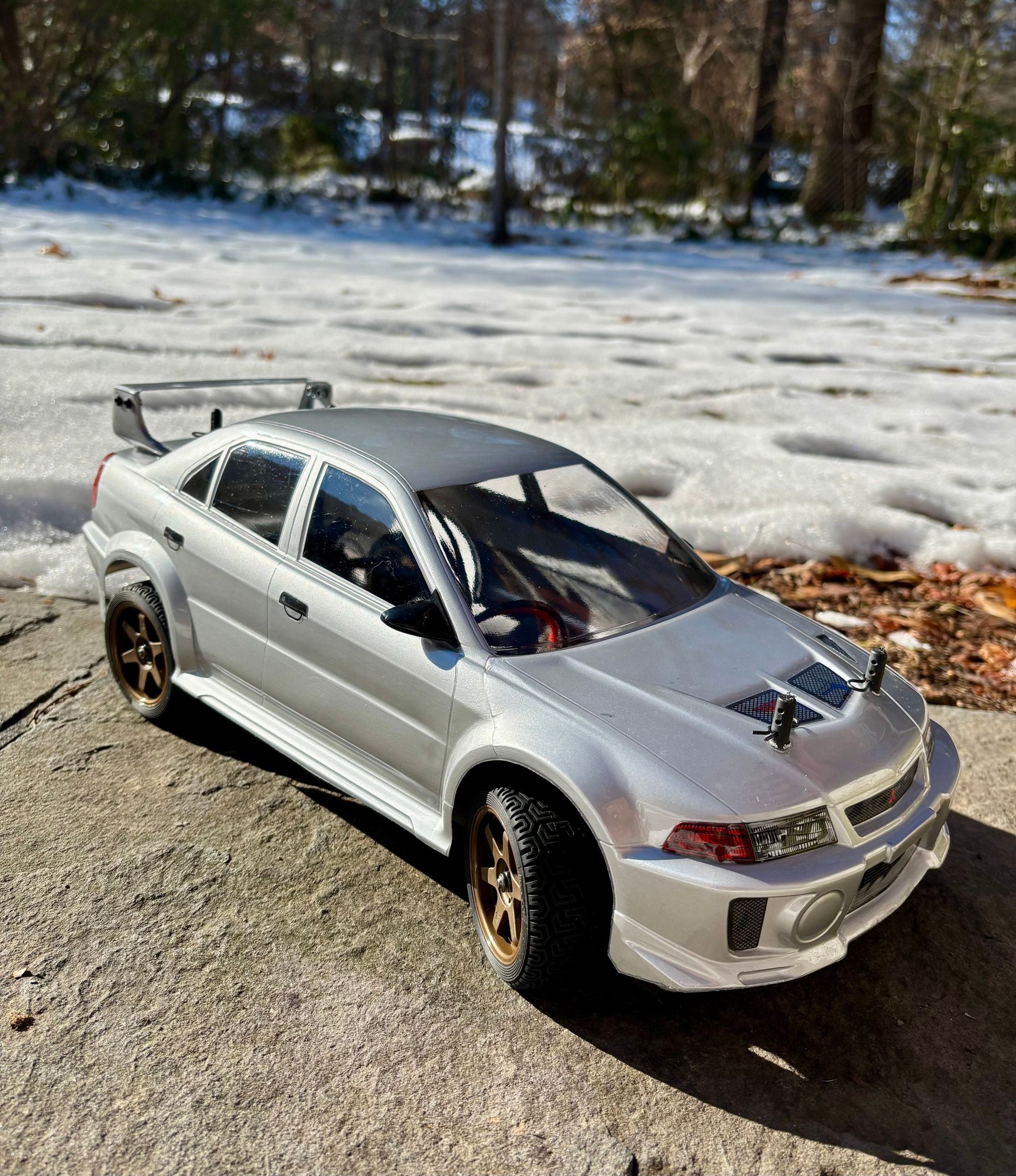

Finally picked up the rally headlamp cluster and roof scoop set from Killerbody (part 48058). Really pleased with how this looks, at least given how bad my skills are when it comes to painting clear lexan bodies. I'm way better at the mechanical tinkering side of the hobby, but practice makes perfect as they say, so maybe one day I'll get better at this. For now, this is as good as it's going to get
the painting looks fine IMO not like anyone will notice it from 1-2 feet away.
