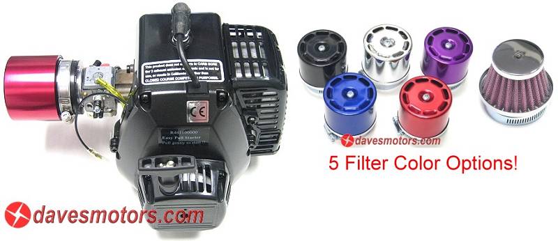

anyone knows if theses engines are good ?
The brand-new GP460 engine is a 45.7cc (42mm bore, 33mm stroke) performance machine. Designed after the high-revving Zenoah RC style motors, it features a 4 transfer port 42mm cylinder, high-performance case pulsed Walbro carburetor (19mm bore, 15mm venturi, independent high and low jets) "hemi"-style combustion chamber, and full-circle crankshaft. The combustion chamber clearances have been improved for better thermal control, resulting in more uniform thermal expansion characteristics and reduced dynamic stress at high operating RPMs! Includes 78mm three-shoe inner clutch assembly preinstalled.
For Scooters: Stock engine on Trail Ripper GTR46, Super Go-Quad 46, SGSR46R, Trail Ripper Quad, and RIOT. Also fits GSR25, GSR26R, GSR29R, Go-Quad 25, and Super Go-Quad 30 when used with 78mm motor mount (DDM part hh551).
For R/C: Fits 78mm clutches used on many RC cars, boats, and airplanes.
Engine Stats: Displacement: 45.7cc. Power: 4.2+HP @11,000 RPM, 2.35 lb/ft torque @8,000 RPM. Fuel: 91 octane or higher mixed 25:1 with 2-stroke oil.

Will that engine actually fit on an rc car?

In one of Kenazzo's monster cars, for sure. [&:]

lol but is it good to go fast ? ive seen them on videos they go good with a person on board

It has the power, if you gear it properly I'm sure it can do the job. Anything that can move a 160+ lb person can be geared to move an RC car pretty fast.

Those are the engines thay use on gopeds. They are basicly a scaled up version of the g260rc engines, and produce ALOT of power. Beware of the pullstarts though [:@]

Yes, that engine will be perfect for your dragster [8D] The guys that use them on gopeds with a decent pipe have a hard time keeping the front wheel on the ground.

thanks mate i think they are 4 stroke not 2 stroke ? is it better to have a 2 stroke or 4 stroke engine ? thanks guys for all of your help

Nope they are 2-smoke.
