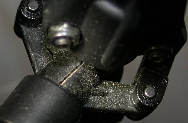

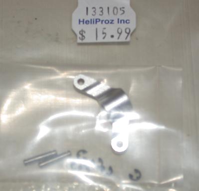

OK, I have now fixed the tail drifting problem, but now have another. About every 2 flights, the tail loses control, and starts to spin around. After I land the heli, I check the gyro (Futaba 401), and the light is steady red. I throttle her back up, and everything is fine again (staying low, in case it happend again). After about two perfect flights, it happens again. Anyone have any ideas? I have the gyro set at 95 percent, at the transmitter. I thought about getting carbon fiber tail rotor blades, I've heard that the gyro does'nt have to work as hard with them, could the gyro be getting overloaded and just quit for a couple of seconds?
sounds like the tail fork is cracked and slipping, this is a very common problem with the plastic version. my R60 has a JR extreme heading lock gyro G5000T with the 8700g servo and it breaks the plastics regularly, just snapped 2 of them this weekend, I've got the aluminum to replace it with this time. I've been pretty lucky, I've broke at least a dozen or so of them and every time I'm able to give hard right tail and it'll shove it back on the brass and auto in, last one didn't make it to the runway and had to put it down in the grass, which for those who know me is an insult and I'd rather be hung then sit my bird in the grass [:@]
kc
EDIT: Better Pic added
kc

I checked out the tail assembly, and could not find anything cracked. I have a direct tail drive on the airskipper, which I think is different than the R60. If it was the tail fork, why would I be able to fly a couple more flights before it happened again?
