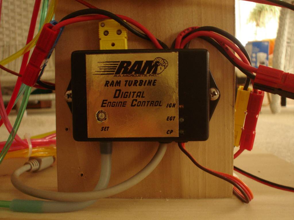

Having a problem setting transmitter throttle settings to ECU. Trim settings don't seem to be getting set properly to ECU. Can't get past EGT light. This is an older airstart turbine. Ser#750059. My manual is for ser#750388F. Here is what manual says.
A. High throttle setup:
1. Turn on transmitter
2. Push and hold "set" button while turning the Rx power ON. Turn on transmitter
The Start box display reads:
Setup throttle
High >xxxx
At this time the "Ign" LED flashes
3. Release the SET button.
4. Move throttle stick and Trim lever to Full throttle'
5. Adjust the ATV(if required) until the "Ign" LED stops.
6. Push the "SET" button to memorize.
B. Low throttle setup'
The start box display reads:
Setup throttle
Low>xxxx
At this time the "EGT" LED is flashing.
1. Move the throttle stick to LOW throttle, High trim.
2. Adjust the ATV (if required) until the "EGT" LED stops.
3. Push the "SET" button to memorize.
C. Idle cutoff setup:
Setup throttle
SHUTDN >xxxx
At this time the "CP" LED is flashing
1. With throttle stick to Low throttle,Mid trim
2. Adjust the ATV (if required) until the "EGT" LED stops flashing.
ECU is now programmed. Turn the Rx power off.
Just can't seem to program right. Maybe I have the wrong manual? Any help would be appreciated. This turbine is new and has never been run.

reverse your throttle channel on your transmitter.
if the throttle is not reversed (i.e idle command has a higher pulse width than full throttle), the ECU cant calculate the dynamic range between the two values.

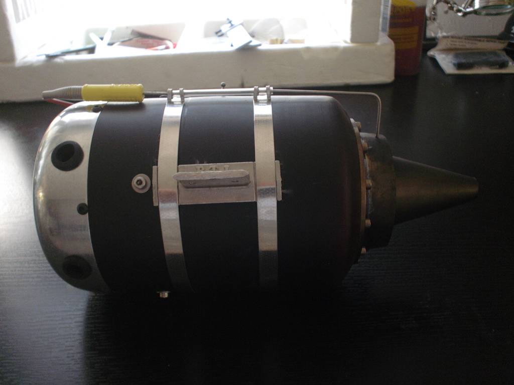

Here are some pics of the turbine on the test stand,GSU and ECU. Only set button and leds on ECU. GSU has switch for air,propane and ignition button. No parameter button. Turbine is going inside a Century Jet F-105F Thunderchief. Posting build pics on RCU. Kit came with carbon fiber bypass but not going to use because it puts turbine too far back.

the parameter button is an Autostart RAM thing. With the airstart, you do all the programming with the SET button on the actual ECU

Based on the serial # you listed, your engine was one of the first Rams that required
a separate oil tank, pressurized from the compressor port, or "T" to the line going
to the ECU. The F desination came when Ram modified the fuel rail and mixed
the fuel and oil. To teach the ECU, first set your ATV's (end point adjustment)
to 100 up and 100 down. Turn transmitter on, push and hold the set button on
the ECU while turning power to the reciever. The GSU will say set throttle HIGH.
Move throttle stick full up, and trim lever full up. Look at value displayed on
GSU (should be 1900-2000 this is the pulse width), if 1000 or less, reverse throttle
channell, then push set button on ECU. GSU will say, set throttle low. Move
throttle to bottom, and check GSU value, should be 1100 - 1000, push set button.
GSU will say, set throttle shutoff, move trim to full down and push set button.
Value must be below 1000 for ECU to set (adjust ATV if needed), GSU will
indicate throttle low, and at this time the ignition but will now act as a primer
button for the fuel pump. This same button is used to decrease your idle
after the engine is started. Hope this helps.

I thought it was an auto start. My mistake. As Johnny stated, that's one of the first
RAMs produced. Everything is done as he says..

Many thanks for all the help. If I can will send video of test run. The turbine did indeed come with a separate oil tank. Has been T off from ECU. Using Exxon 2380 turbine oil I bought at local airport. So since turbine has it's own oil tank should I mix the oil with the fuel? Heard Ram made an uprated version that put out 20-22lbs of thrust. How do you tell what version that I have? Will resume sending pics of F-105F build soon so keep eyes out for it.

If you have a separate oil system you have a very early RAM750. I don't even think they were designated with a letter afterwards, I know there was then a 750F and a 750P producing I believe 18lbs and 20lbs respectively. There was a 750+ as well. It's been a long time since I had RAM's so I don't remember for sure.
Your engine will produce between 15 and 17lbs. I don't think the thrust values were all that consistent in the early RAM's, I've heard many people state between 15 and 17lbs. I had 750F's and they were 17 and 18lb engines.
Very poor thrust to weight ratio compared to today's engines, especially when you are dealing with a completely separate oil system, but, they were a fantastic engine back in the day, I cut my teeth on them. I just wish I had all the money that I spent on Ram's and repairing Ram's to buy todays engines with LOL!!!!!!

Mine was a 750+, and it had approx. 22lbs. thrust. Very reliable turbine in its days when

I saw Carlos replace the short tail cone and install the long cone bringing the power up from 16# to about 22# of thrust. Also putting a (T) festo connector between the oil and fuel line and get rid of oil pump.
