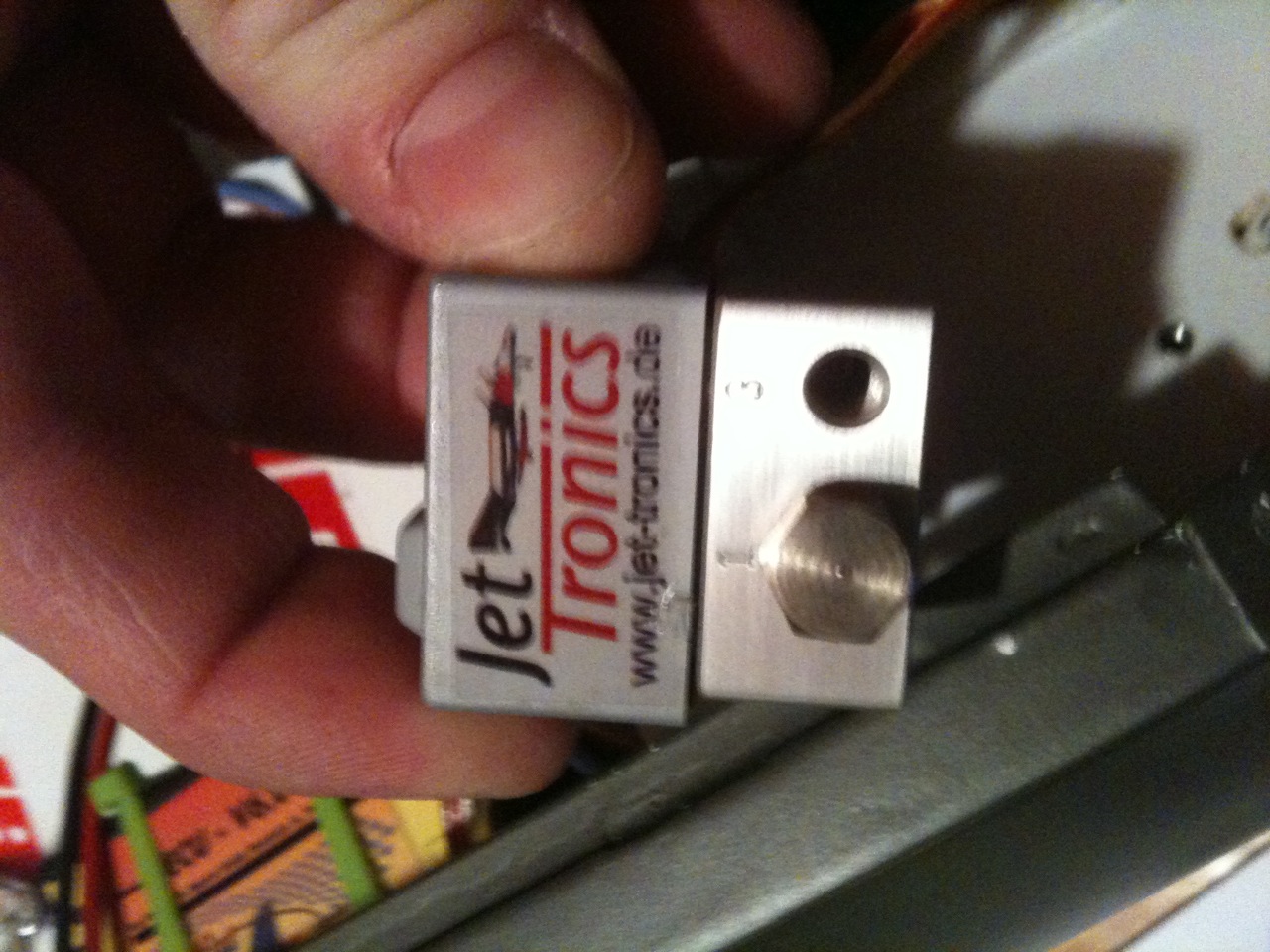

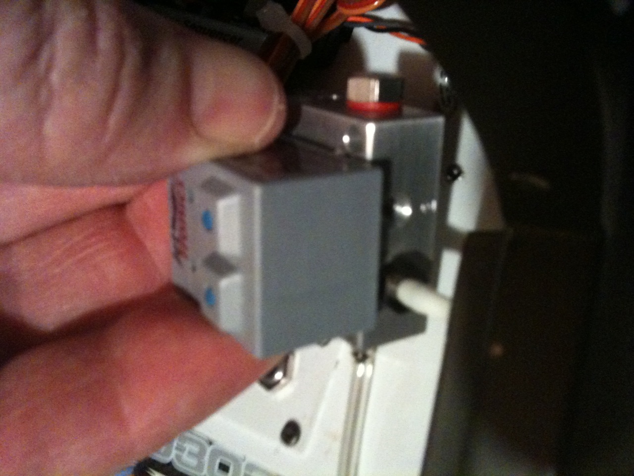

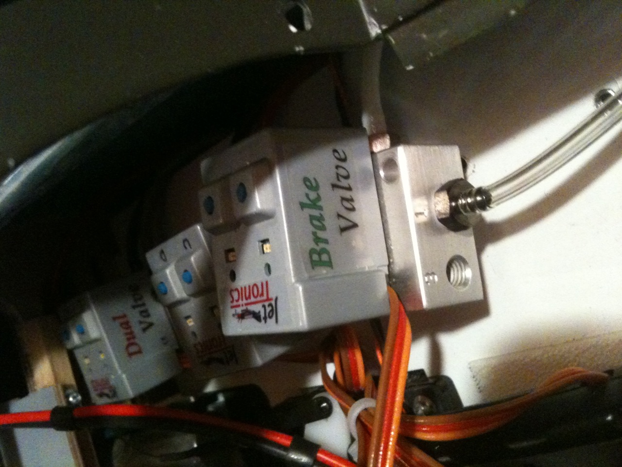

Hello,
I have a new turnkey FeiBao L-39 and I am having problems setting up the Jet-Tronic brake valve. When I attempt to fill the system with air, all of the air leaks out of the other holes on the valve. (See pictures). Any idea as to what I am doing wrong? The open and close function seems to work correctly based on the red / green lights and movement of the slider on my transmitter. Any help is greatly appreciated!

I have reversed the airlines per the instructions and that has solved the problem with the system not holding air. A new problem has developed. When I apply the brake lever, the valve pulsates for a few seconds and the wheels brake for about 2 seconds and then the air is released and the wheels spin freely even though the brakes are still on. Turning the brakes off also releases a lot of air as the valve pulsates.

Ok. I have confirmed that the brake valve is in proportional mode. When I apply the brake, it holds for about 2 seconds and then the air is released through the brake valve. Air is release through two air outlets labeled "3". Even though this is a brake valve, it looks more like the dual-valve due to the extra ports along the bottom. Only one port is blocked via a cap.

I have gone through the documentation and I believe the valve is bad. It always releases the air out of the (3) ports after applying the brake. Brakes hold for 2 seconds. I purchased this jet from Wayne McCosker, who purchased the valves from you about 2 years ago. The jet is new and finished, however, the air setup needed to be completed. If I order a Jet-Tronic single brake valve from you, will that work ok? The jet is a FeiBao and the landing gear / brakes are stock FeiBao as well. The gears and doors are using the dual Jet-Tronic valves with a Jet-Tronic sequencer.

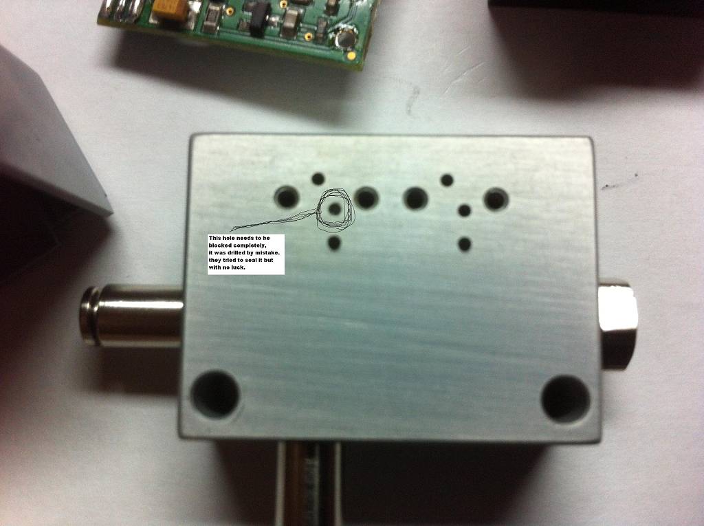

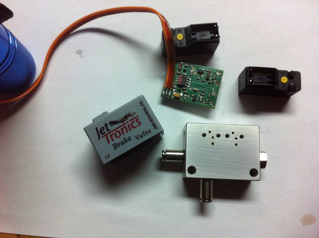

hey guys, for those that may want to know and maybe still have some of these that are leaking and not working correctly.
I figured out the problem, they are connected properly but the problem is a decfect in the base from the manufacture.
They drilled a extra hole in which they tried to recover it with bad material with no luck causing the leak and non functioning valve.
I have two pictures here showing the problem and where the hole is to repair.
you can use JB weld or just use CA to close it up.
very easy fix, little soldering skills needed to remove the board and reapply it.
