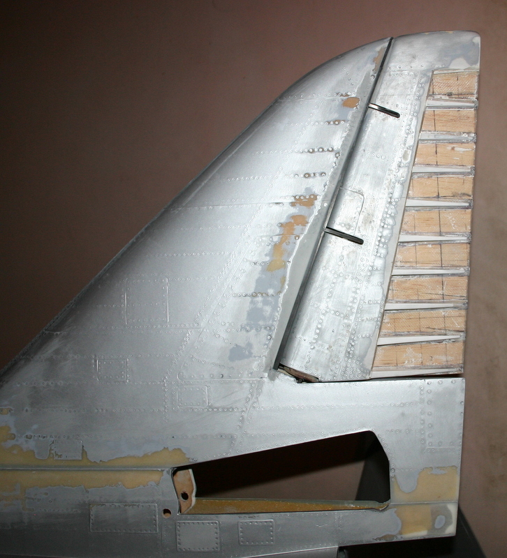

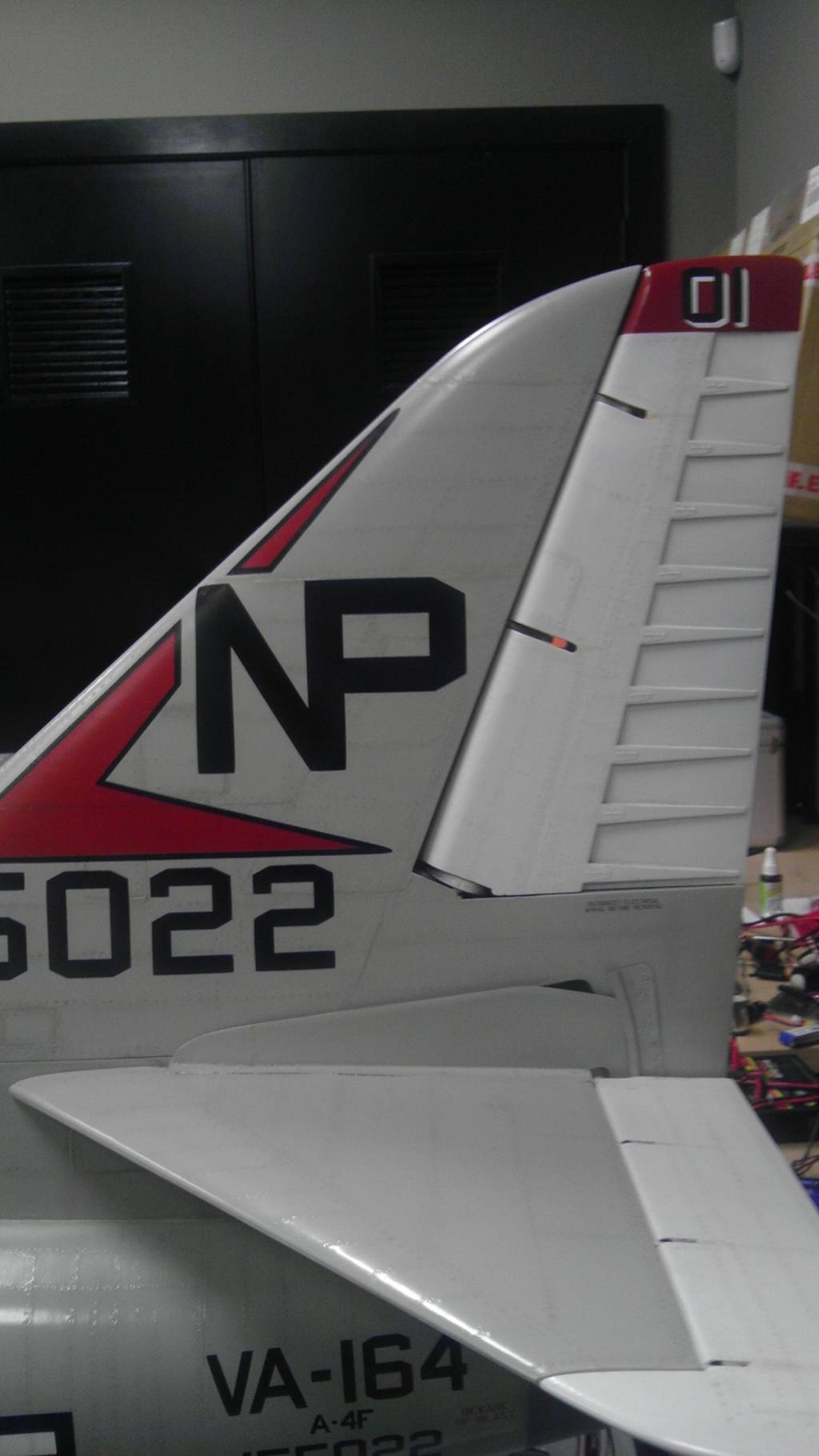

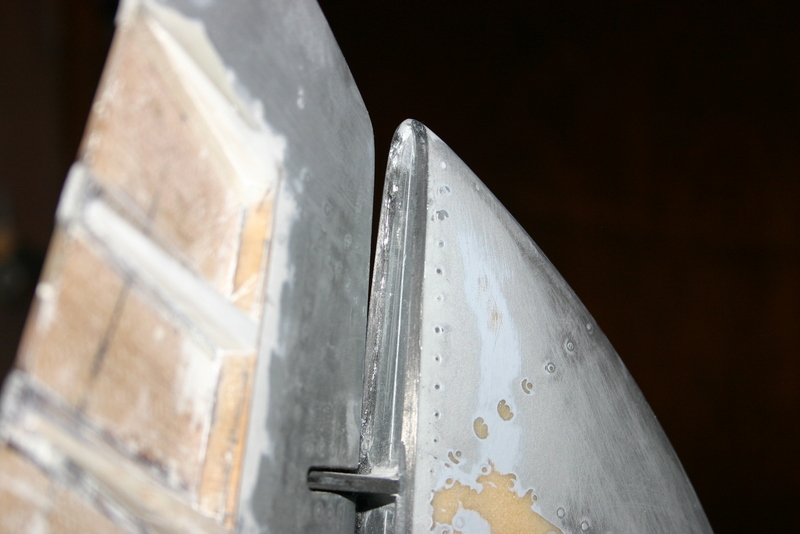

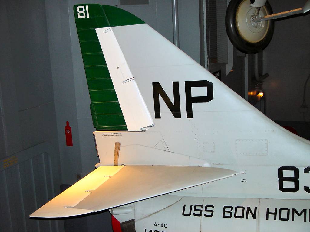

Here is an update on our build. We (Bill White is my builder) decided that the rudder was not to scale so we have made these modifications. We are also changing the location of the hinges on the elevators to more closely reflect the full scale bird.

What did you change?
Scott

straightened out the fins?

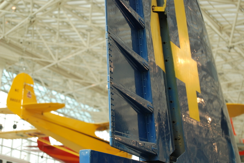

ORIGINAL: jetpilot
scott
If you look at the full scale verses the model, the model rudder tapers from the front to the back (it's hollow, being thicker at the leading edge toward the front of the aircraft and then tapers back to a point). The full scale bird uses a steel plate (solid plate) with ribs. Its not tapered at all. I'll post some pics for comparison.
Andy

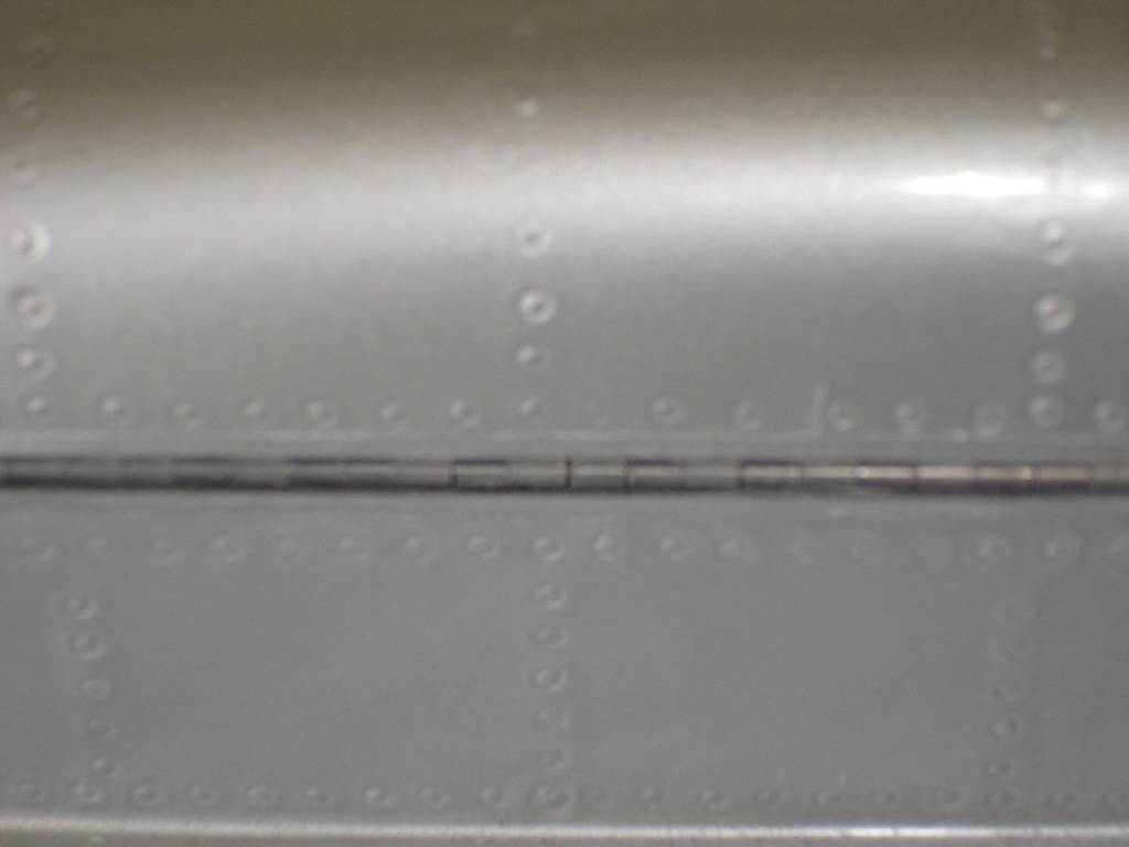

l/g installed
doors working
have replaced the "live hinge" of the main gear door for a proper hinge made of several small du-bro dinges running through a single piano wire(looks great and works perfectly

someone can tell me what is the black round thing on the white portion of the rudder? any better picture?

hello Skyhawknut, here“s the picture: http://images.rcuniverse.com/forum/u...26/To43261.jpg it“s the balck round spot on the white portion, between hinges
thanks!

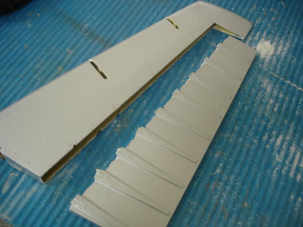

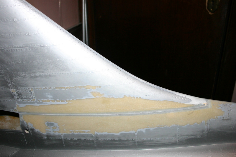

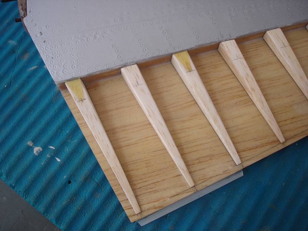

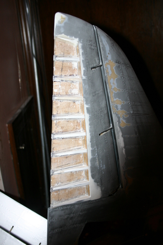

i have done the fin mod as well, plenty work but great looks!

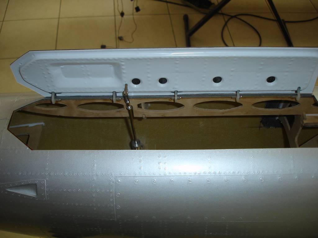

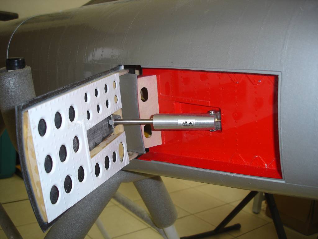

Default RE: COMP-ARF A-4 BUILD

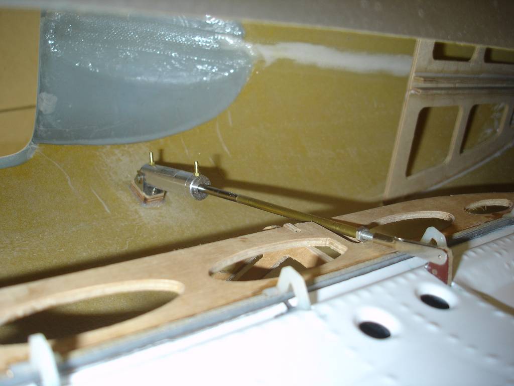

main gear door hinges and air rams done as well

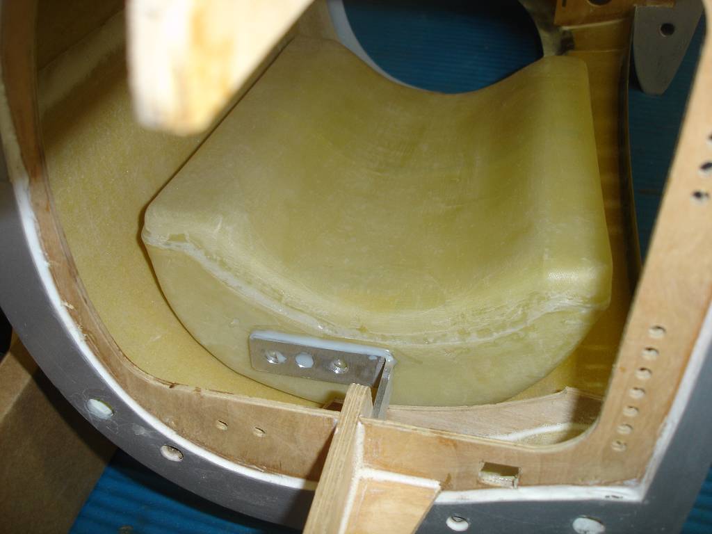

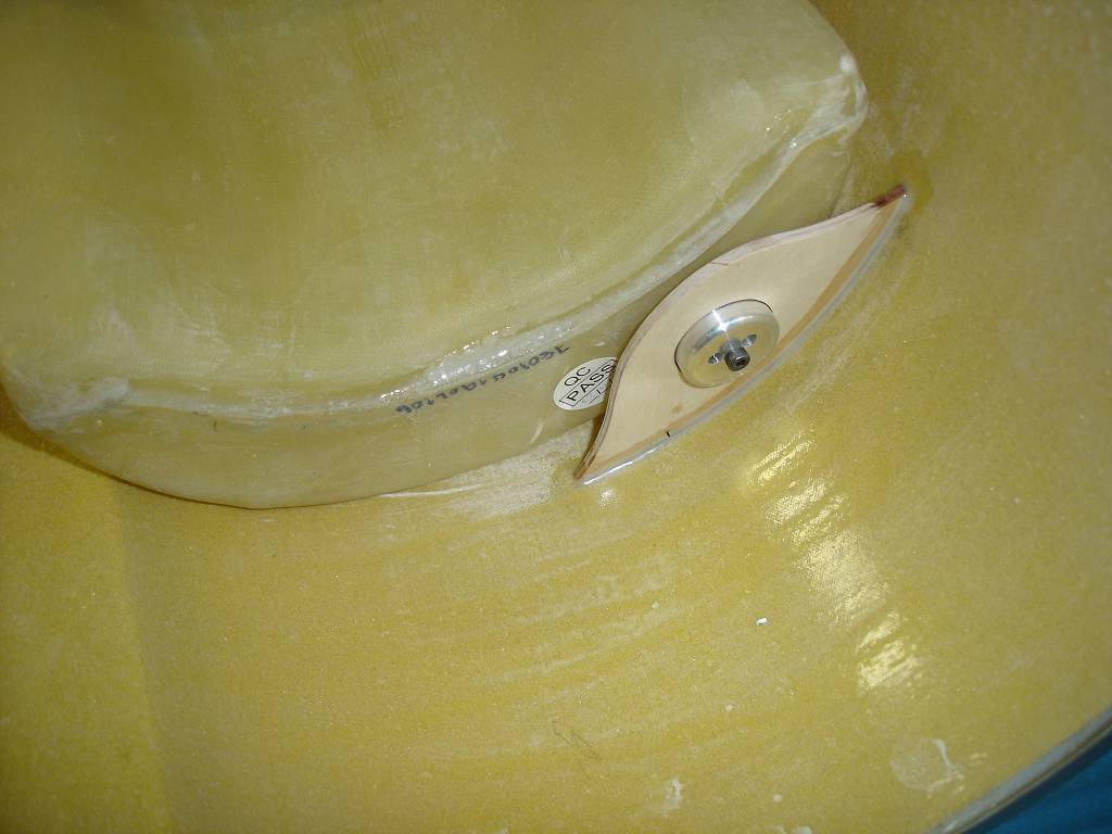

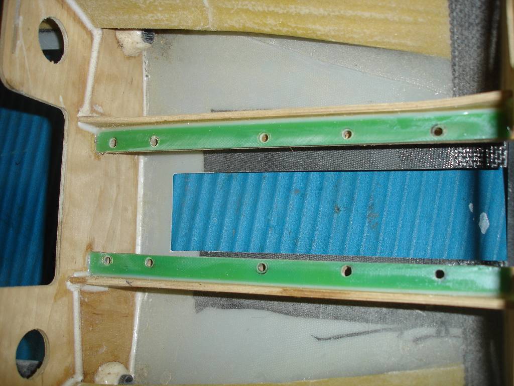

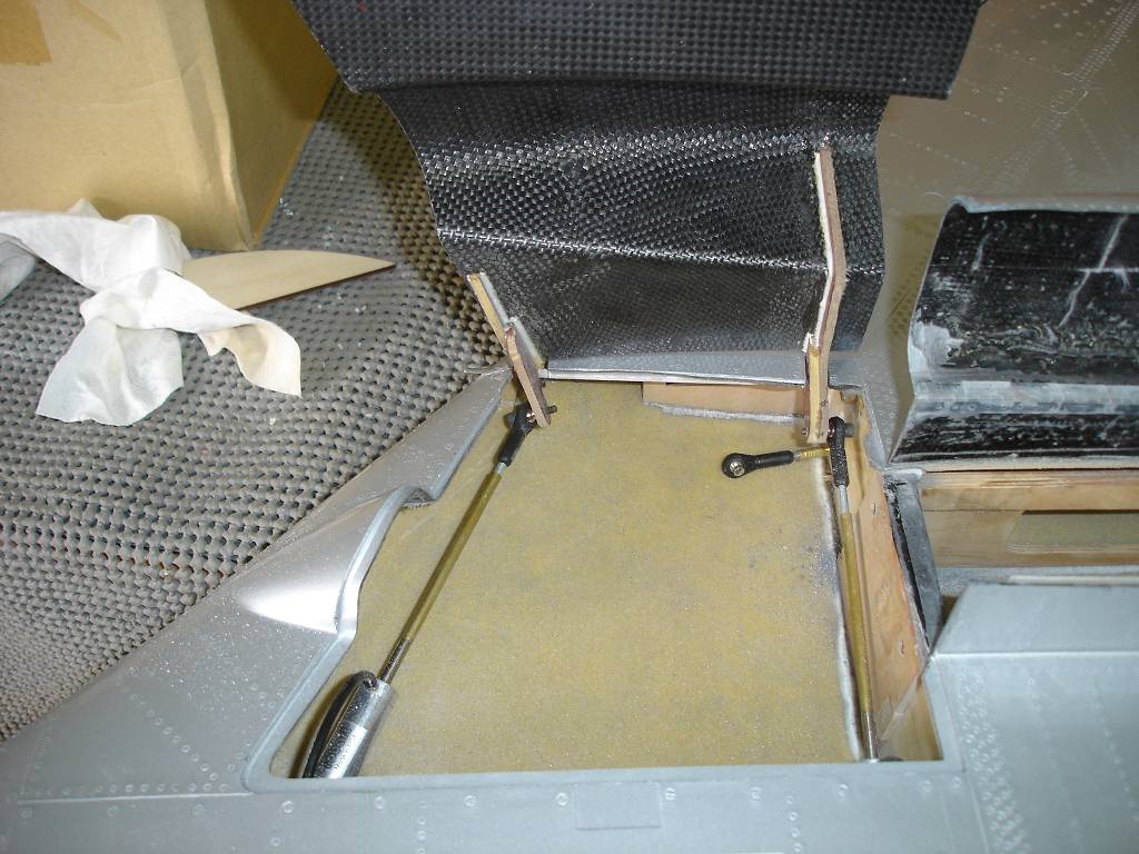

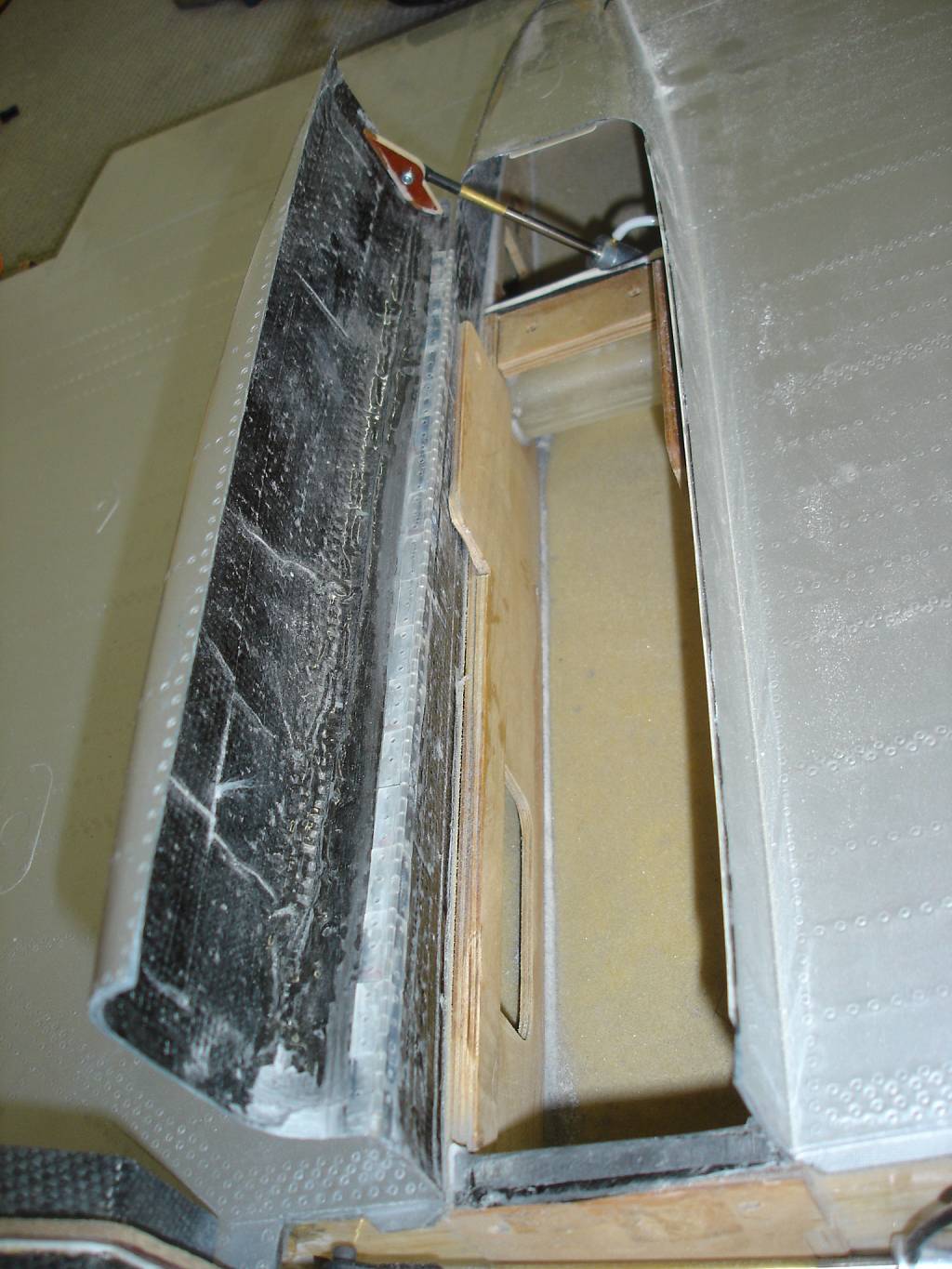

nose gear rails holes came wrong from C-arf. i have glued dowels on the wrong holes, added a 3,5 mm pc board on the top for reinforcement made new matching holes.
gear door assembled and ram installed.
small back door came cut undersized, we had to cut more form the fuse (approx 1" to the back) to allow the gear ram exit without fuselage interference.
