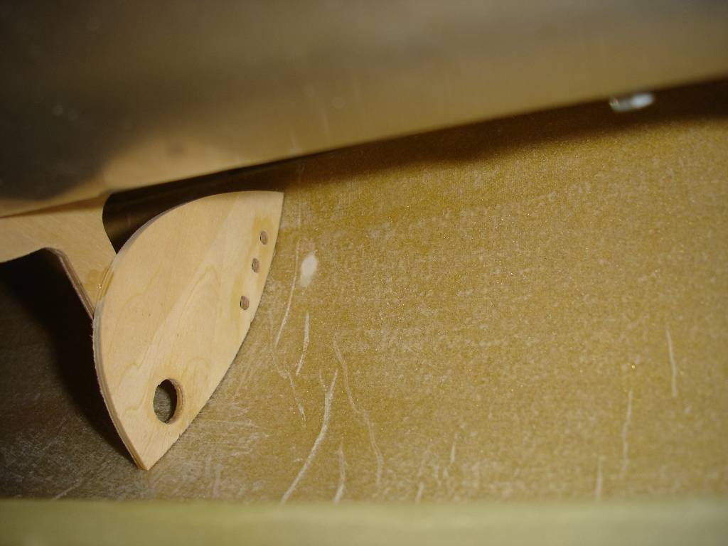

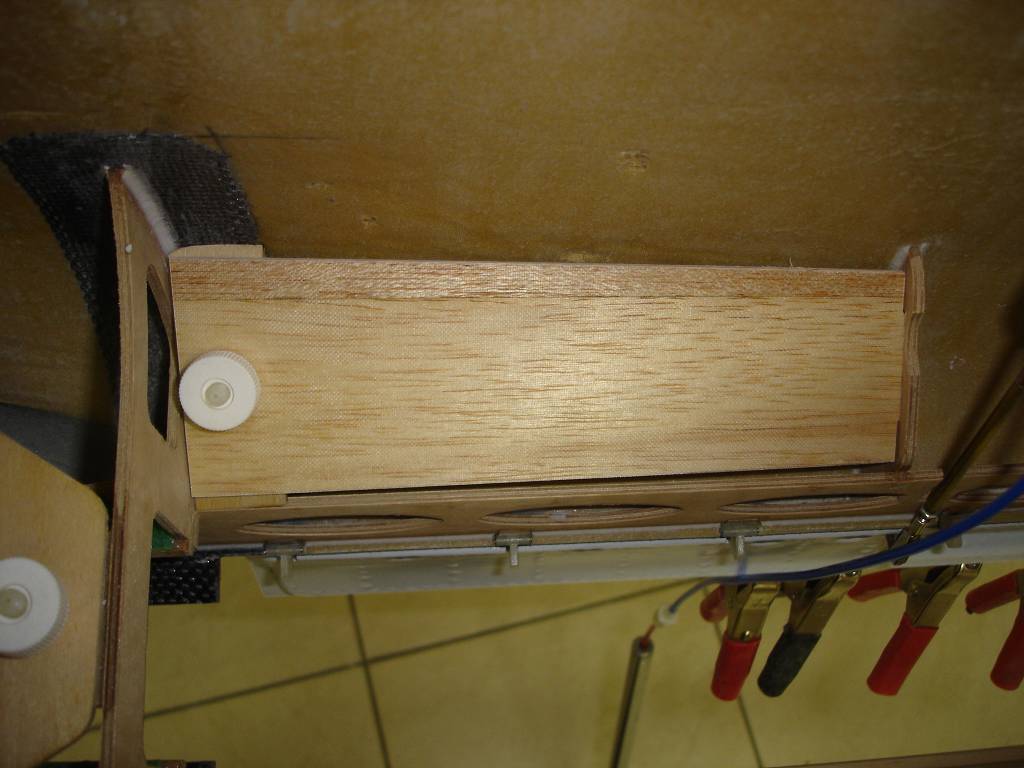

cosmetics started! cut off the embossed air louvers and have done new ones with plastic stock (4 have to be done)
equipament tray done as well

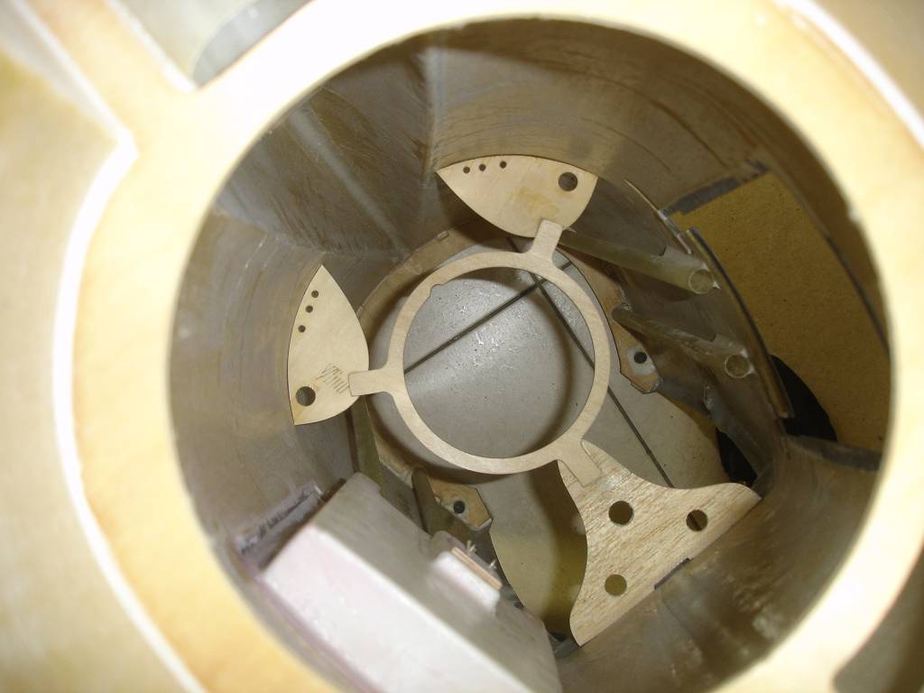

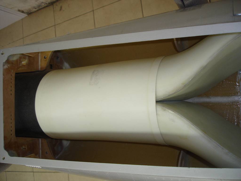

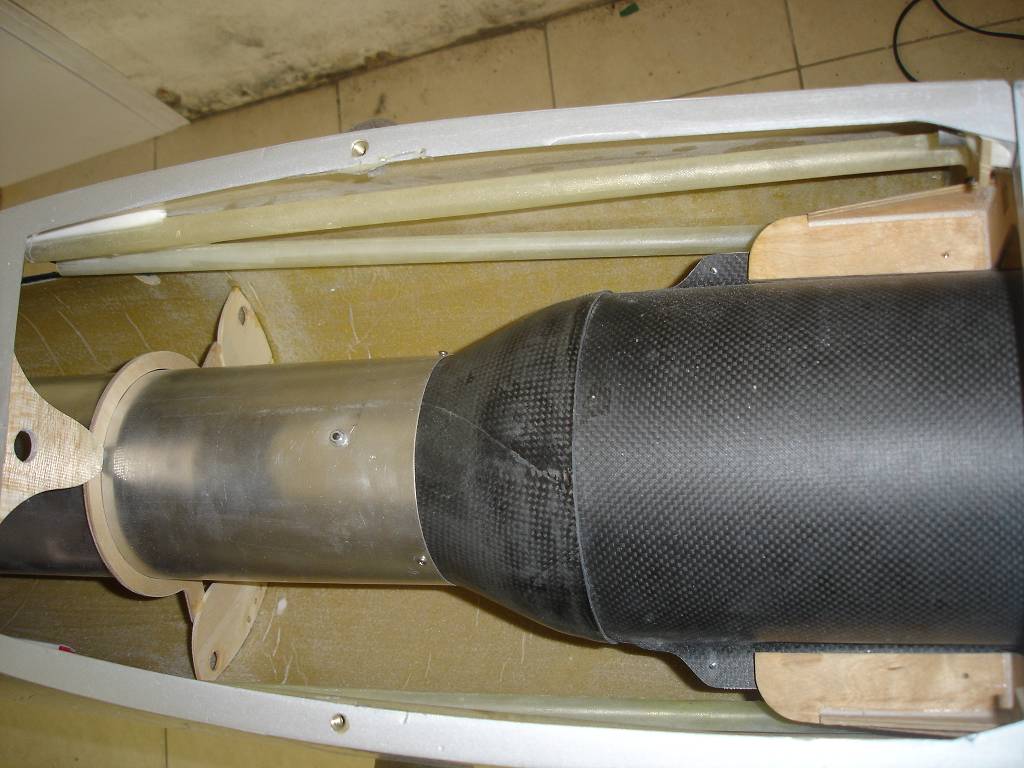

by pass and tailpiped done.
had to work a little on the back of air intakes(came misaligned)
made custom wood support for the tailpipe to hold it on the back fuselage on 2 points, later will attacj it to the bypass as well via 2 x 4 mm bolts on the underside of the bypass cover

a few more pictures od the main equipment tray and tailpipe supports

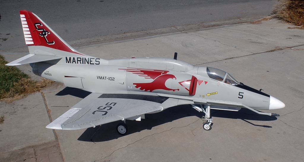

Today started out to be a great day. Install completed, everything functioning properly. Now is the time for the turbine run-up and taxi testing prior to first flights at BITW in 3 weeks.
Turbine and fuel systems test: A-OK
Radio Range Check: Static A-OK; Turbine running: A-OK
Control Surfaces Check: All surfaces functioning, proper directions, no binding: A-OK
Taxi test: What an absolute, abject, POS FAIL![:'(]
The weakness in this jet, and the primary reason Comp ARF factory are still the only people to successfully fly one of these, is that their nose steering system simply doesn't work! I can't tell you how many hours I have put into trying to get this system to function properly. Finally when I hit upon a combination that worked well on the test bench, I find it simply doesn't have enough power to move the nose wheel under load![:@][:@][:'(]
So now I've got a beautiful jet that looks like it should fly very well, but which I can't get safely off the ground! And other than to blame Intairco for faulty cylinders, Comp ARF has been less than useful in providing a solution to the problem.[:'(]
So now with three weeks left before BITW, my 2 year sojourn into the abyss, has to start over at square one, with the messy job of trying to develop an hydraulic steering set-up that will work under load. I know it can be done, I've seen Andreas fly theirs at Buttonwillow on numerous occasions, but when I've asked Andreas to send me photos of exactly how they accomplished it, my response from him is: "I don't have pictures of the steering. I just know that it indeed is critical and we have not gotten the manufacturer (Intairco) of the gear to admit that something needs to be done about the cylinders he is providing. "
BOLLOX!

That is my next plan of action. I'll make the nose gear completely castoring and then use two proportional brake valves, one for each wheel, mixed with rudder for steering and combined for brake application. In theory it should work, my fear is if one of them locks up, ugly things will happen.
I do find it thoroughly annoying though, that Comp ARF has found a method to make this steering work, as evidenced by the multiple successful flights I have witnessed at CA JETS, and yet Andreas refuses to make the effort to share their method with the rest of us who have invested thousands in his product![:@][:'(]
