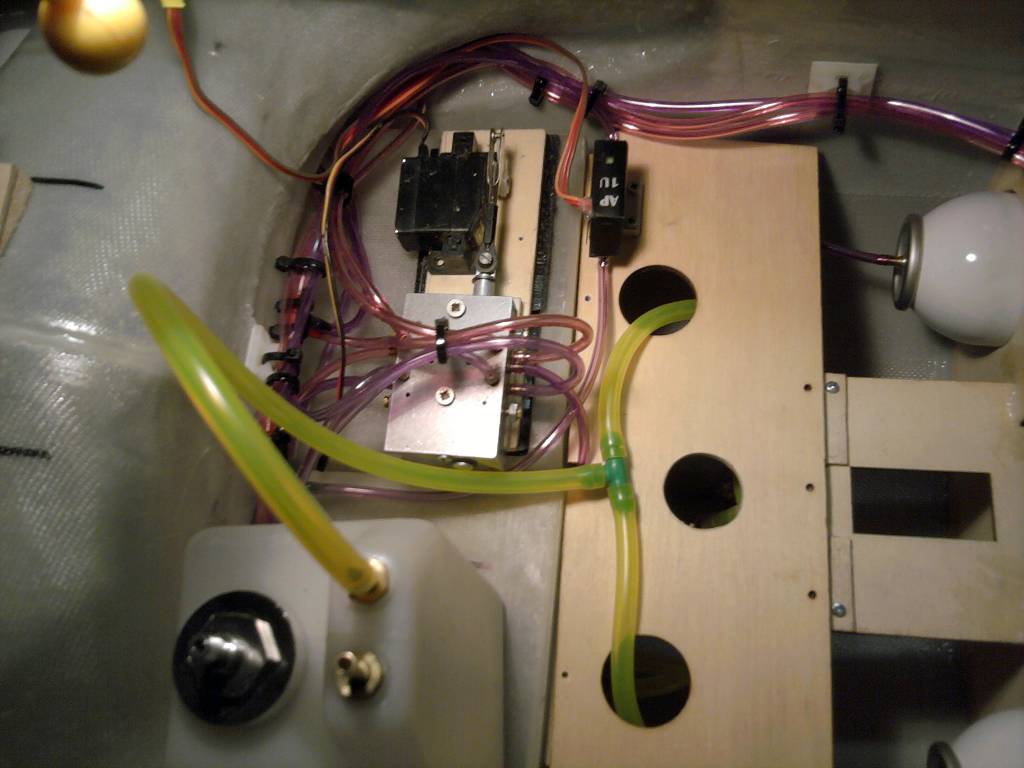

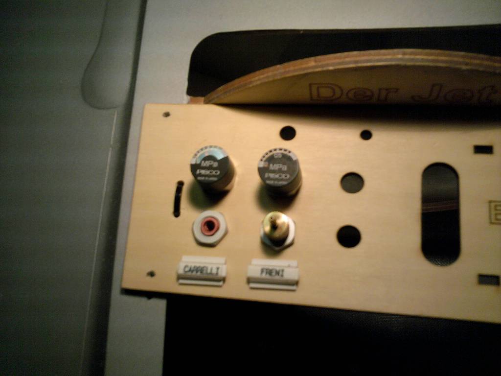

Pneumatic system for gear and brake done..
now i will finish radio set

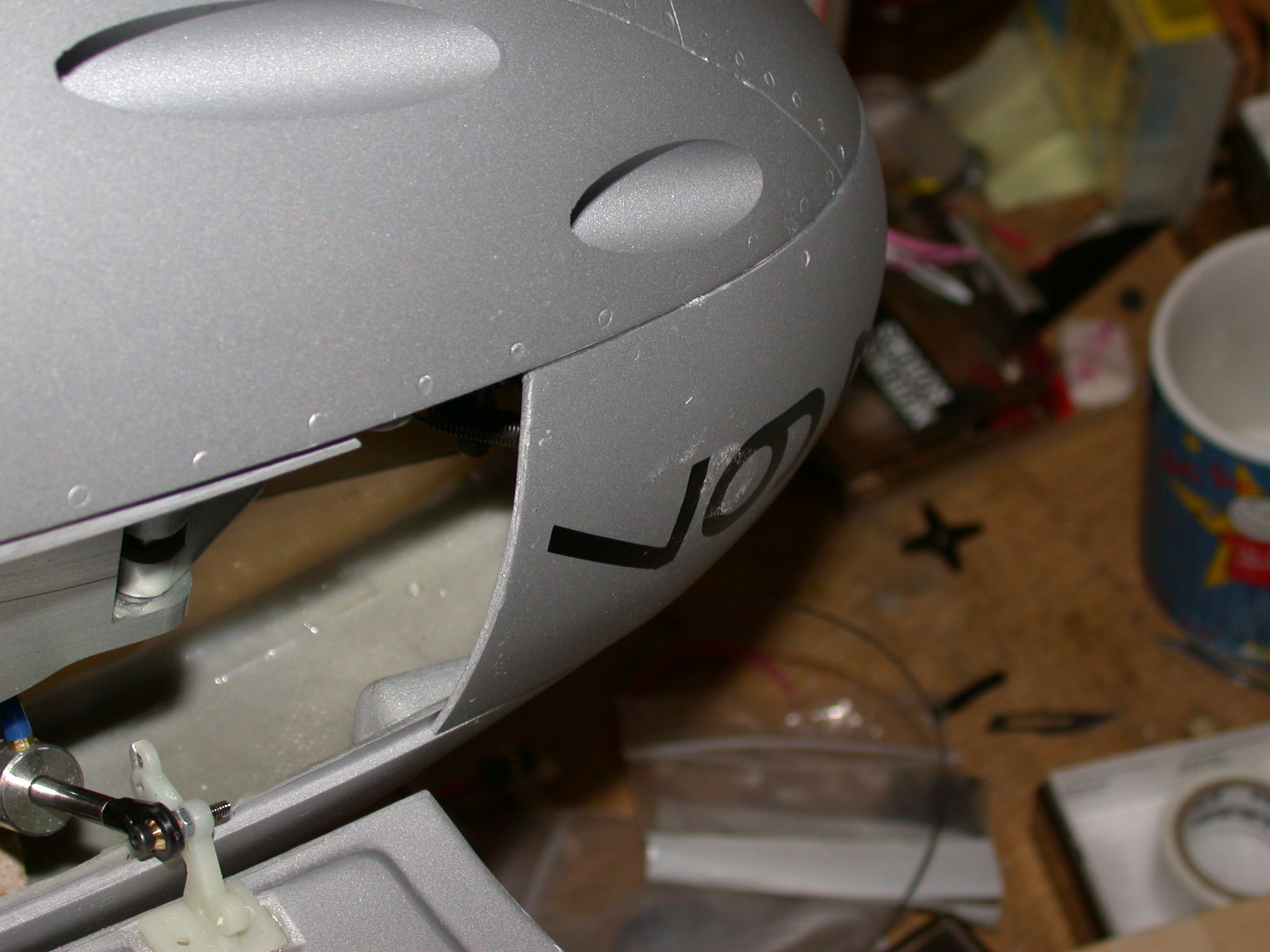

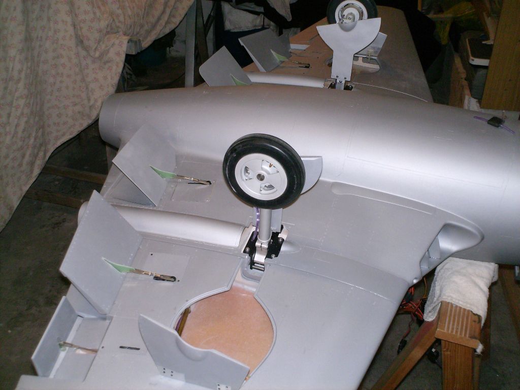

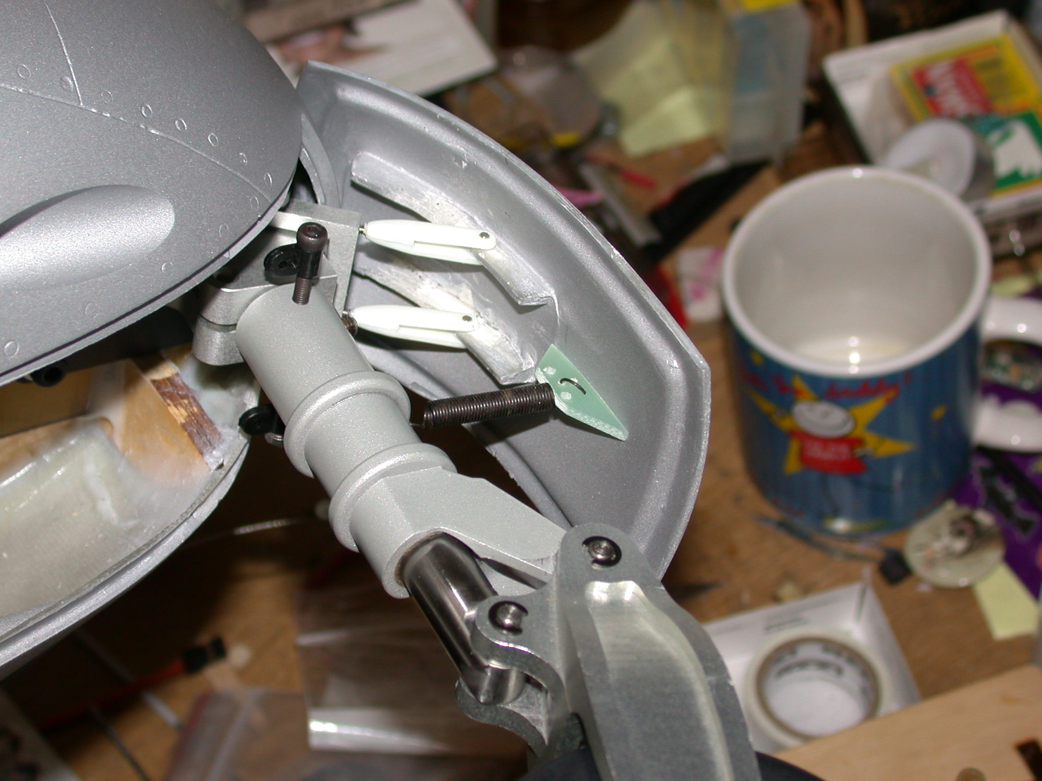

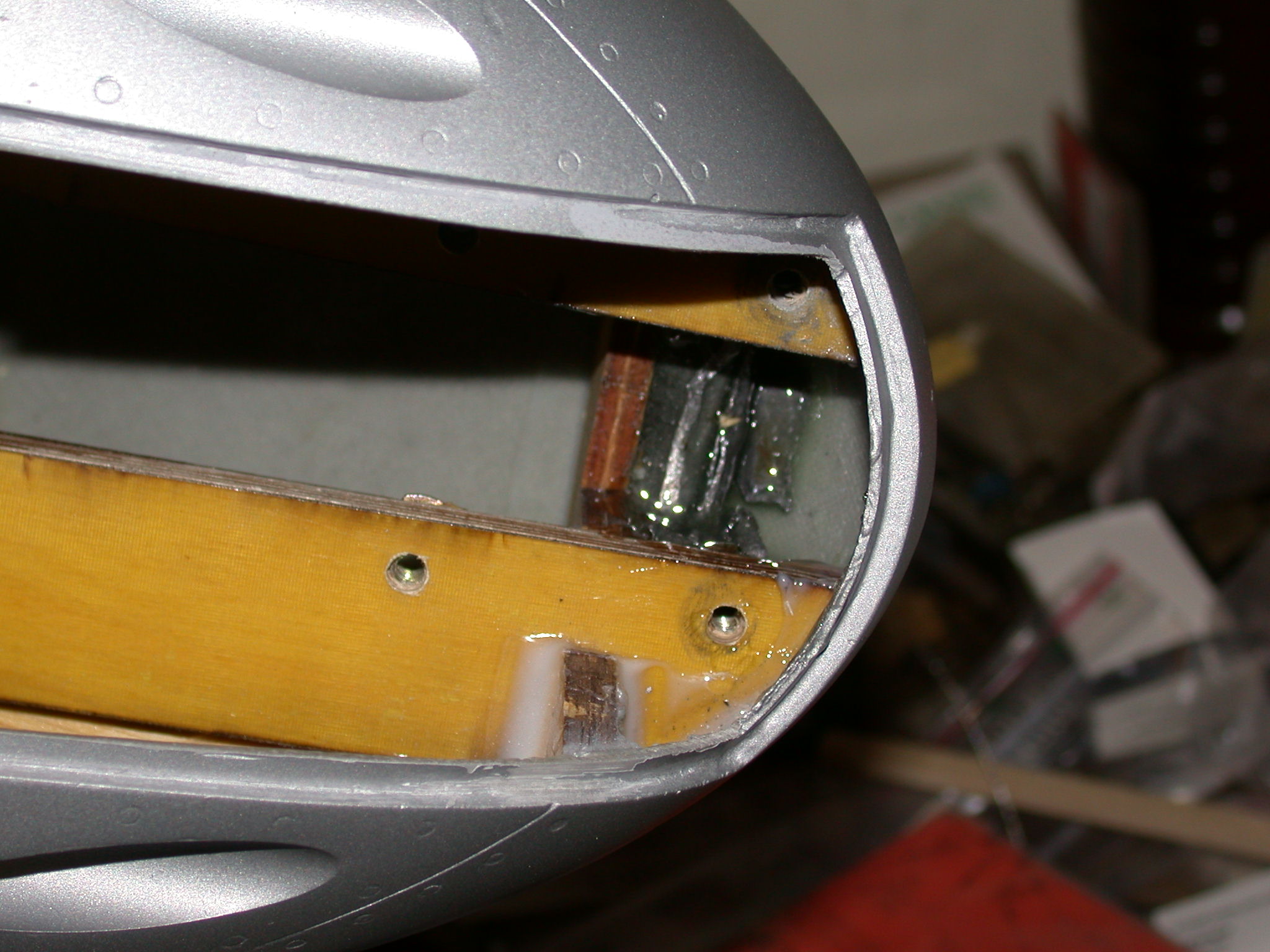

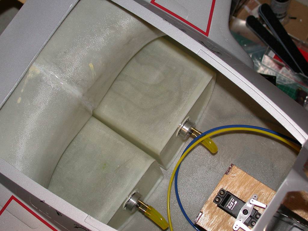

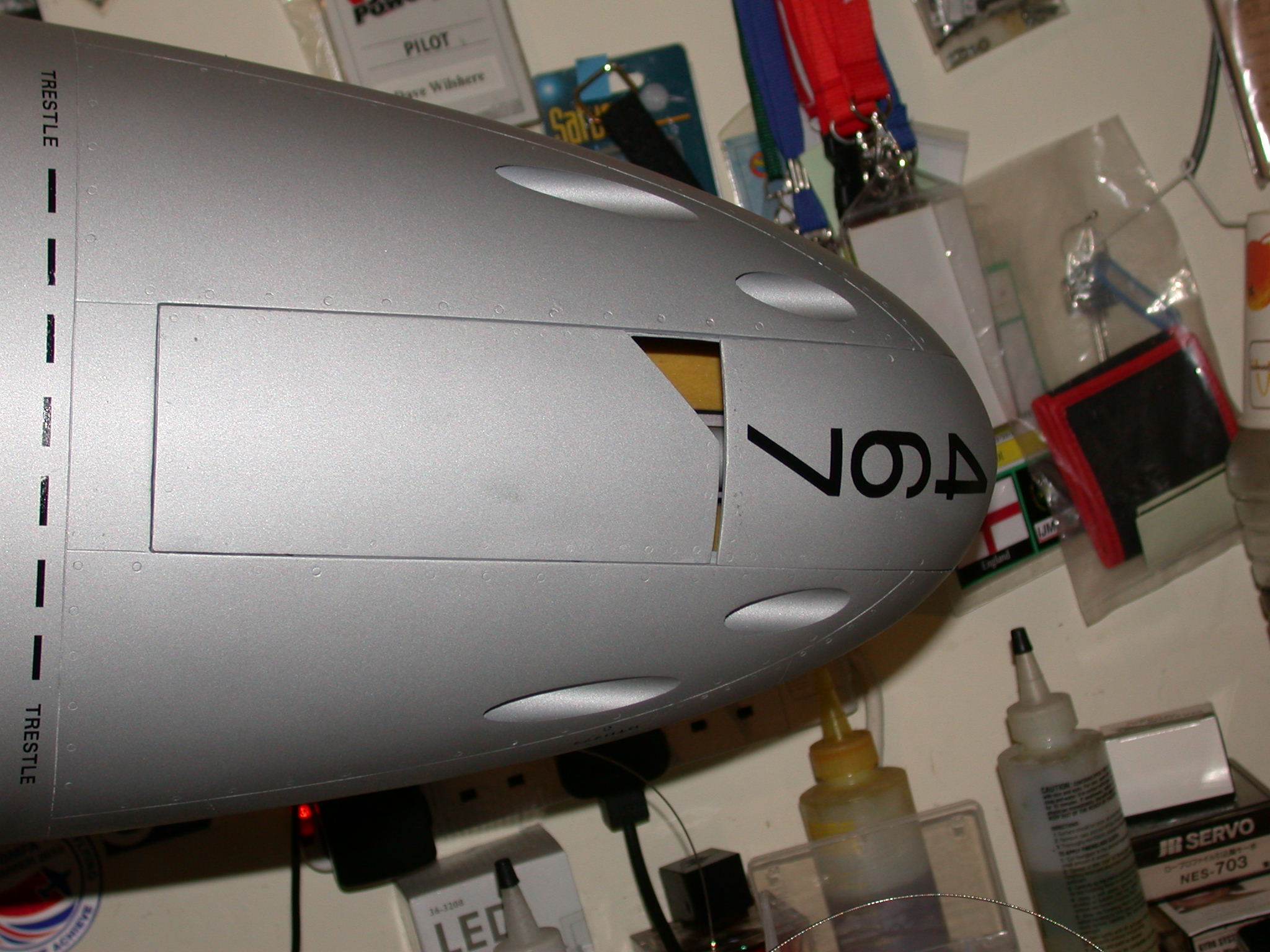

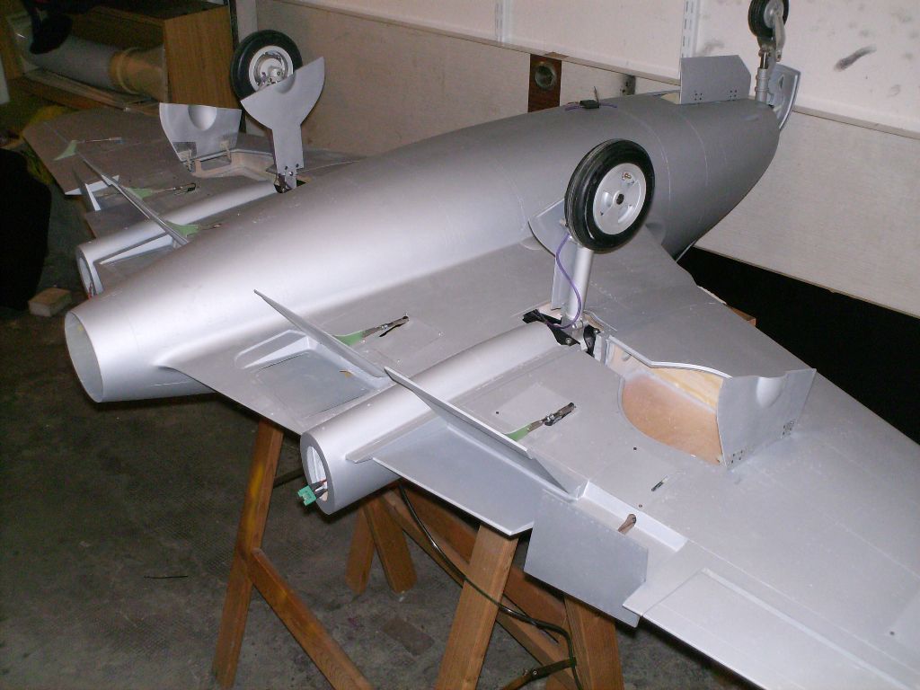

Back on the Vampire.
I managed to get 5 1/2 oz of lead in the nose void, all helps. I will also place the UP3 valve in the nose next to the nose unit 2.4oz! I knew from the start that a lot of weight would be needed but jetmodeler has made me think even more radical.
Typical DerJet door shut lines!
Nose steering servo.

Old 03-15-2011 | 05:14 AM
  #113
Joined: Mar 2004
Posts: 1,567
From: ferrara, ITALY
Default RE: DerJet DH Vampire build thread-
why Dave?
Old 03-15-2011 | 11:16 AM
  #114
Joined: Jun 2002
Posts: 13,258
Received 788 Likes on 571 Posts
From: Watford, UNITED KINGDOM
Christian
You have lost me! Why what??
The door shut is normal on most models with gear doors.
Dave

From: Perth, AUSTRALIA
I think he means the packers under the retract?
Gregg
Old 03-15-2011 | 11:35 AM
  #116
Joined: Mar 2004
Posts: 1,567
yes..the wood spacers under the front gear base

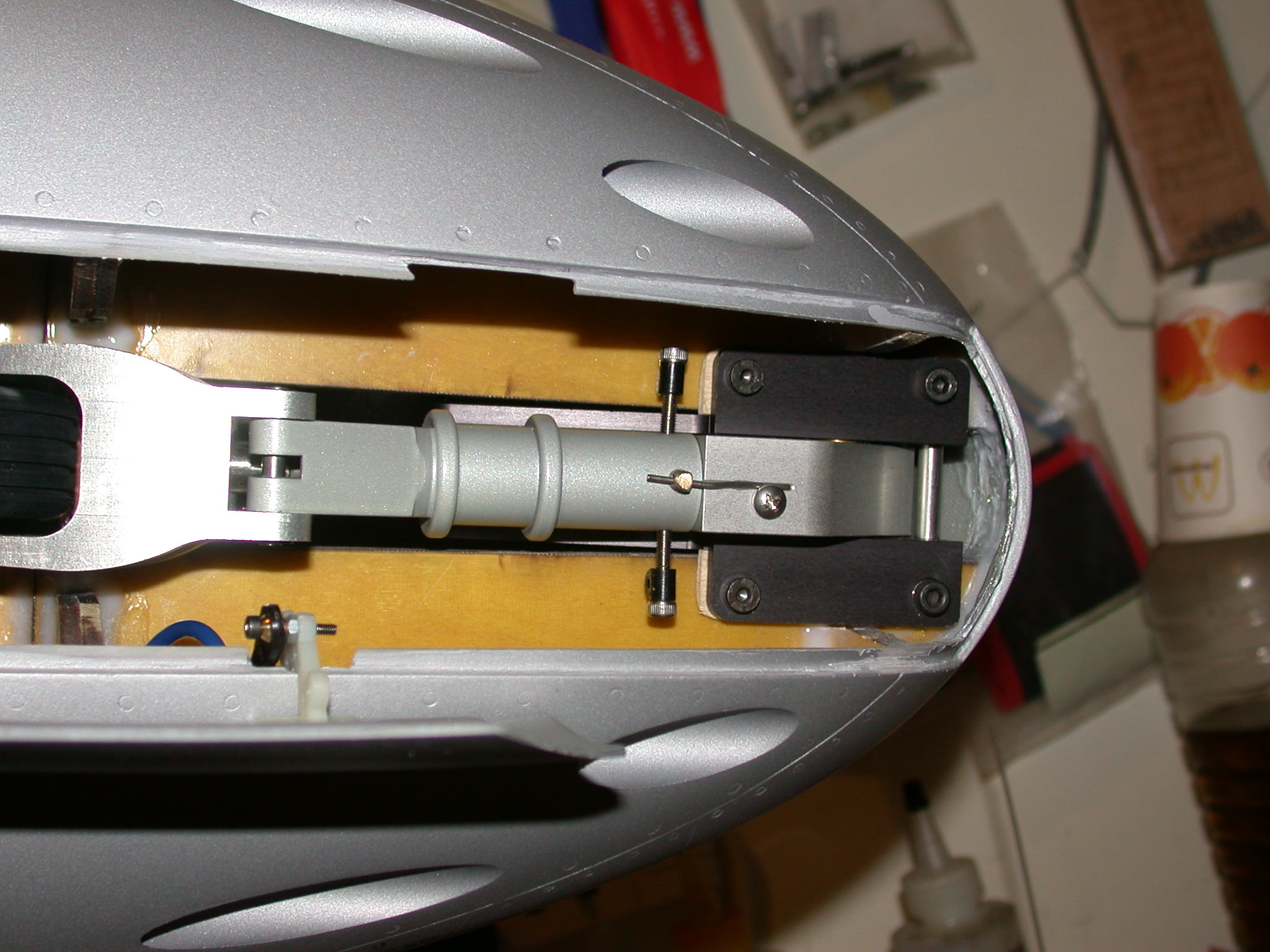

chriqui:
Retracts worked perfectly at FJ. . . .UNTIL the sand and loam reached the side plates. This collection of sand prevented the gear from working correctly. Until this collected, gear worked purrfect !
Eric Clapp

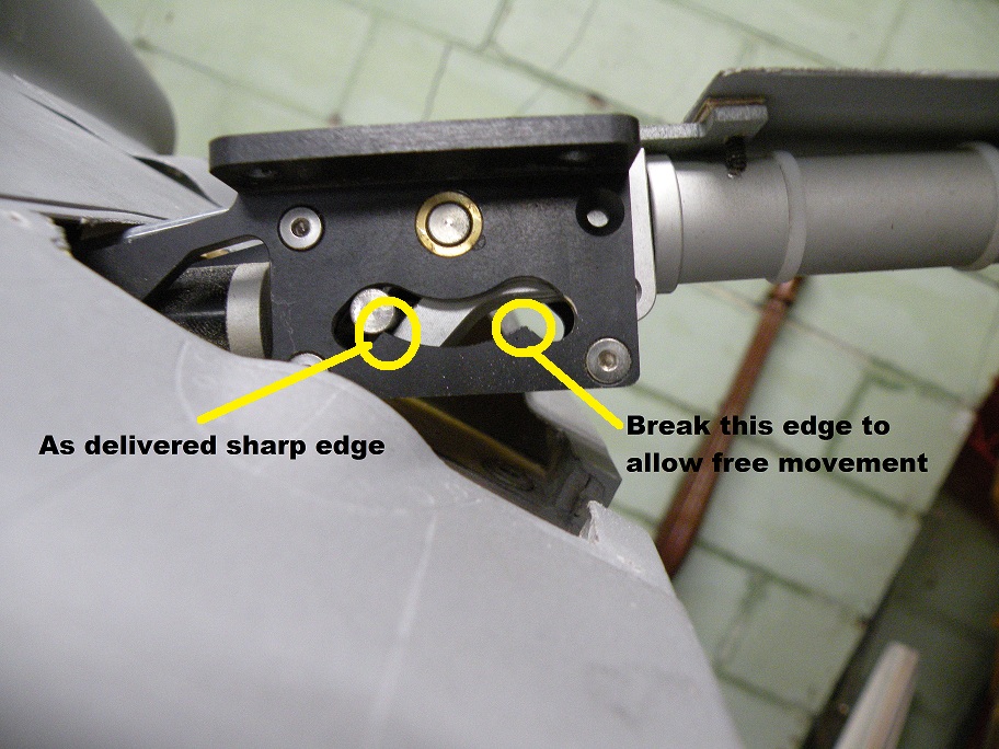

Old 03-15-2011 | 01:36 PM
  #118
Joined: Jun 2002
Posts: 13,258
The packers are something I always do. They are light ply. There is no 100% guarantee that the mount is flat, it only has to be twisted a little and it loads the retract frame up. By using light ply, this will give slightly if there is more pressure from one corner than the others. This reduces any chance of binding.
Dave.
Old 03-15-2011 | 10:40 PM
  #119
Joined: Mar 2004
Posts: 1,567
OK....thx to all
yesterday i finished to made cable servo connection...now ready to connect to emcotec
n.1 channel for n.2 rudder + steering
n.1 channel for n.4 flap with jr magicbox
Old 03-17-2011 | 08:30 AM
  #120
Posts: 289
From: Mount Washington, KY OH
Yes I did have some issues with the retract units at Florida Jets, they worked good here at home on our paved field, but then lesson learned at Florida Jets, newly machined fits don't work well when the sand kicks up and gets in the workings. I have broken the edge on the slot as the retract pin travels over the sharp edge coming off the lock position, up and down. I expect this should solve my problem, it has worked before for me when flying off grass fields. This photo shows the sharp edge, and just how little is removed to free up the travel, do both edges coming off up lock and down lock positions.
Jim
Old 03-17-2011 | 08:51 AM
  #121
Joined: Jun 2002
Posts: 13,258
Jim
Already did that on my units, std practice for me to de burr and de-sharpen everything. This is such a sharp change in direction I spotted that early. Its in my build manual notes.
We don't get the extreme temps or dry grit like you guys though!
Dave

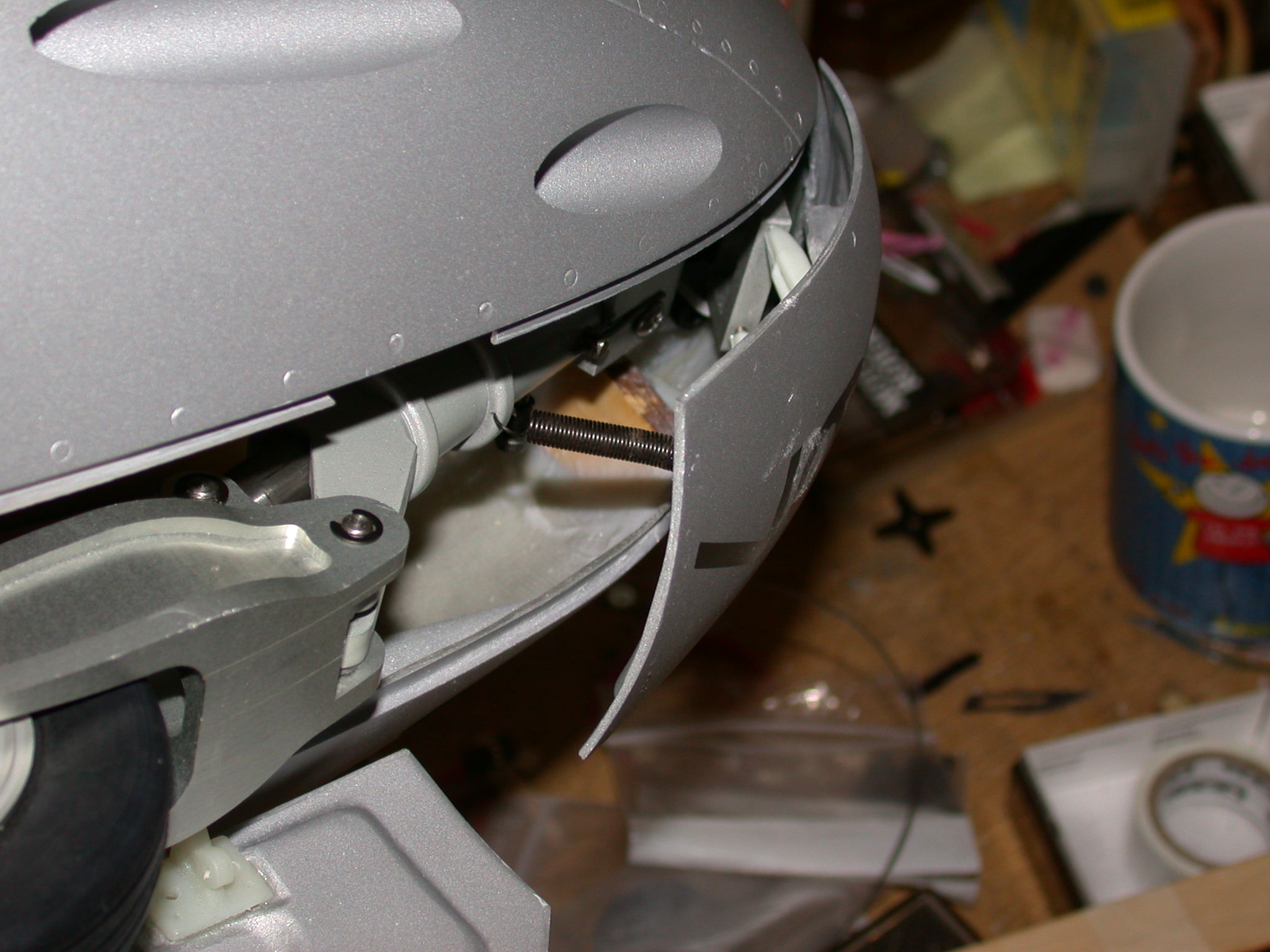

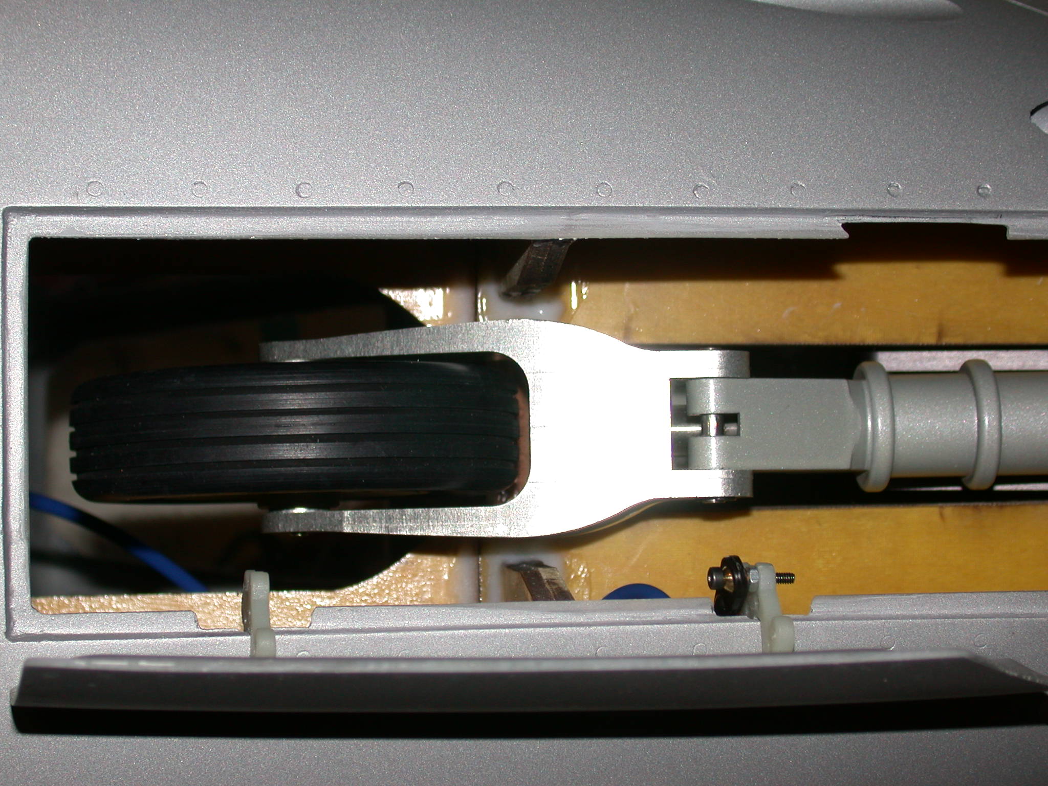

After a surprisingly busy week, I've finally completed the nose door. The two ribs were a little wide for the clevis provided, so I used a Dremel to thin them in the area they swing through. I had to fill in the air holes with Aeropoxy. System works well, fiddly job though
Dw
Pixs if it worked

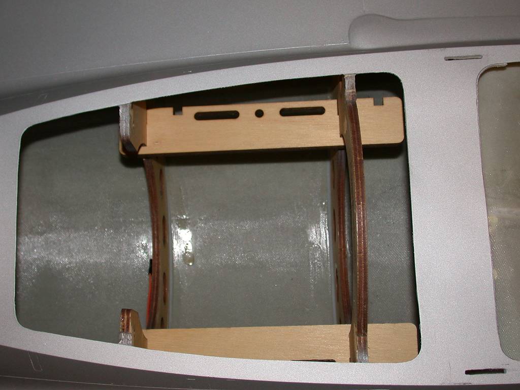

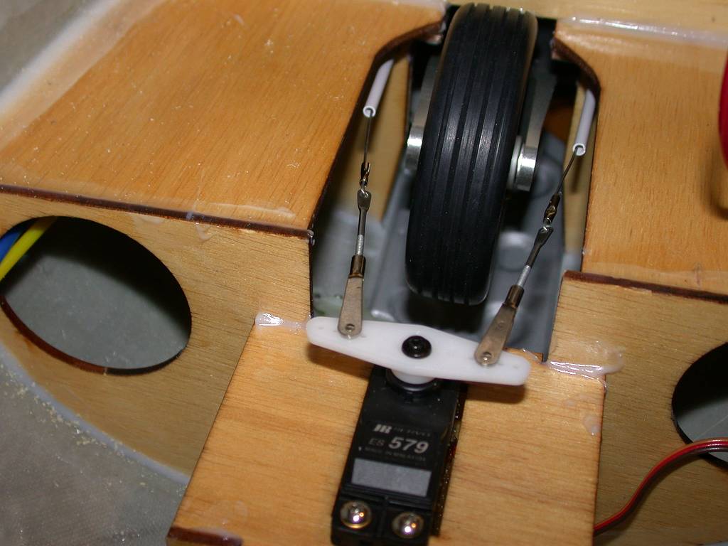

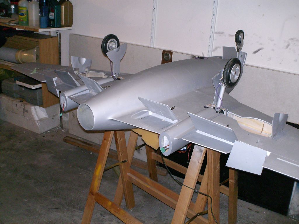

So, started looking at the install now the mechanics are done. The nose steering servo works the same way as the rudders, so a single channel could be used.
Tanks dropped in.
Turbine mounts are dual notched to allow for a range of turbine diameters and length.
Dw

like me... 1 ch for rudders and steering
