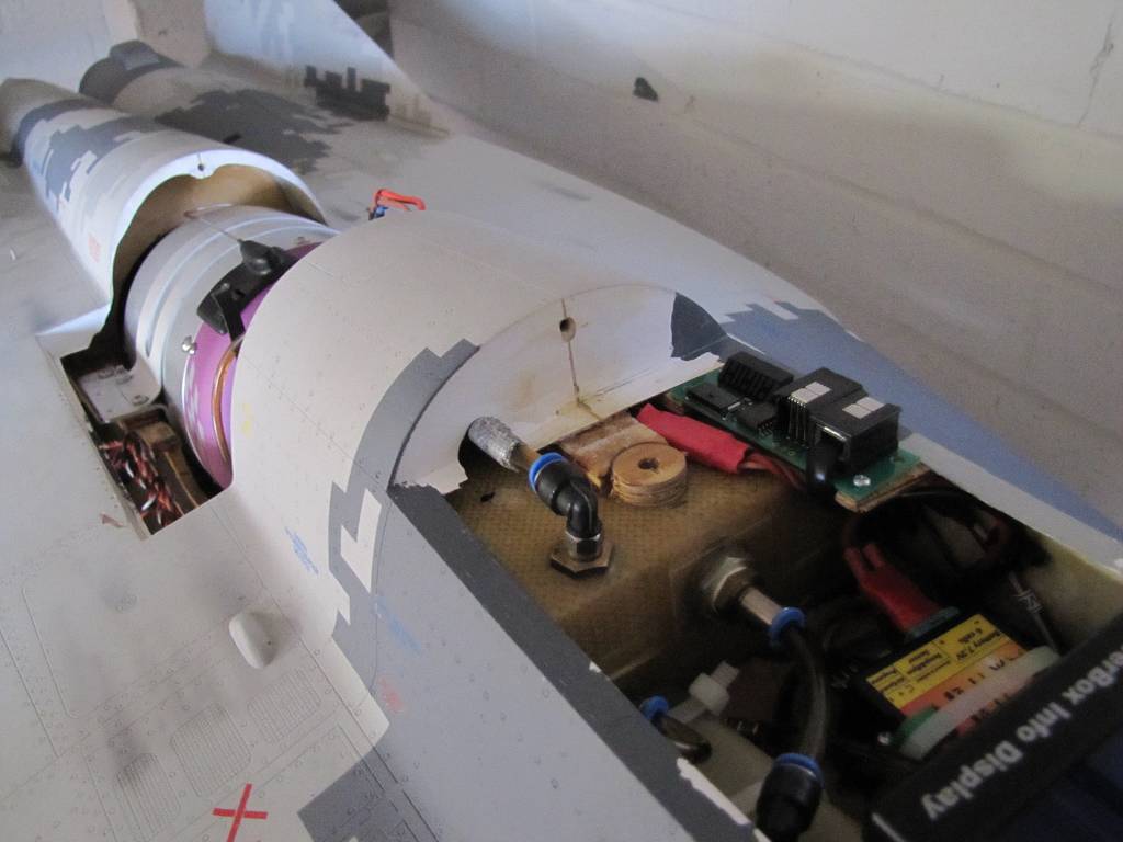

Old 08-07-2011 | 05:28 PM

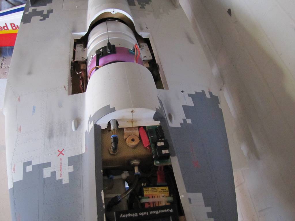

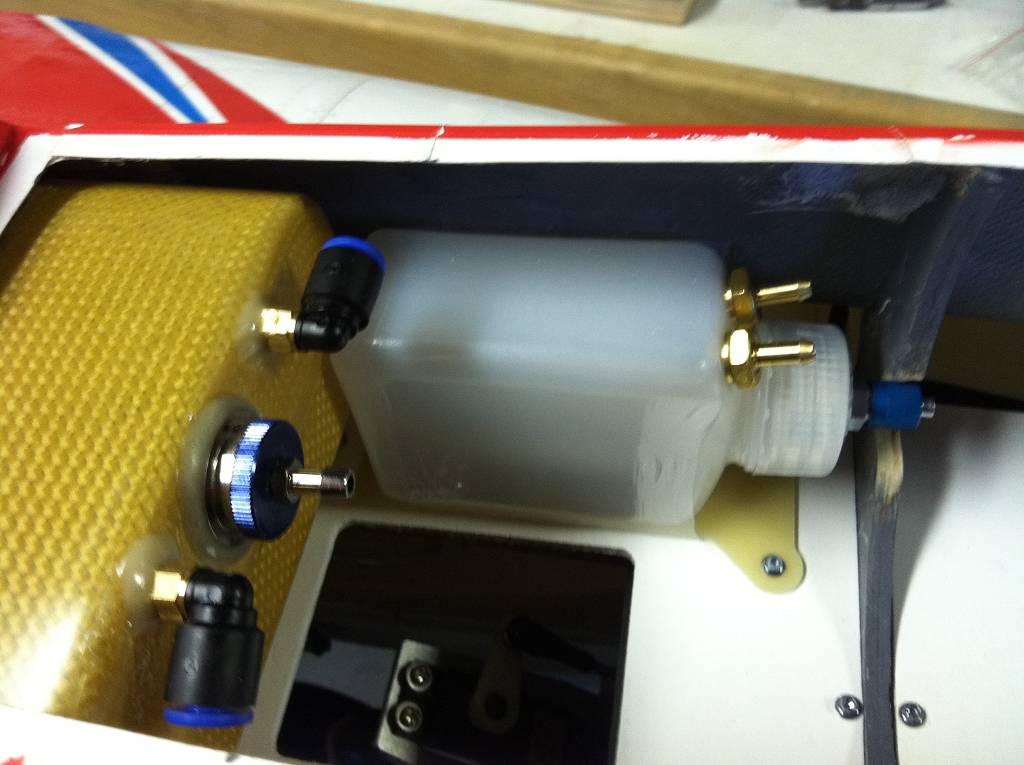

Here is a few pics of my install.
ID:	1645886   Click image for larger version
Old 08-08-2011 | 03:28 AM
  #41
Levi Wags's Avatar
Joined: Jun 2008
Posts: 415
Received 5 Likes on 4 Posts
From: Sydney, AUSTRALIA
Default RE: Skymaster Mig29 with P200
Couple more. Not much room but it works.

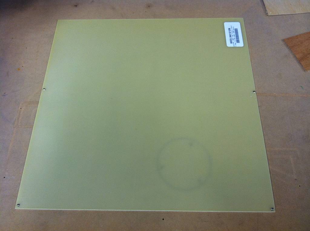

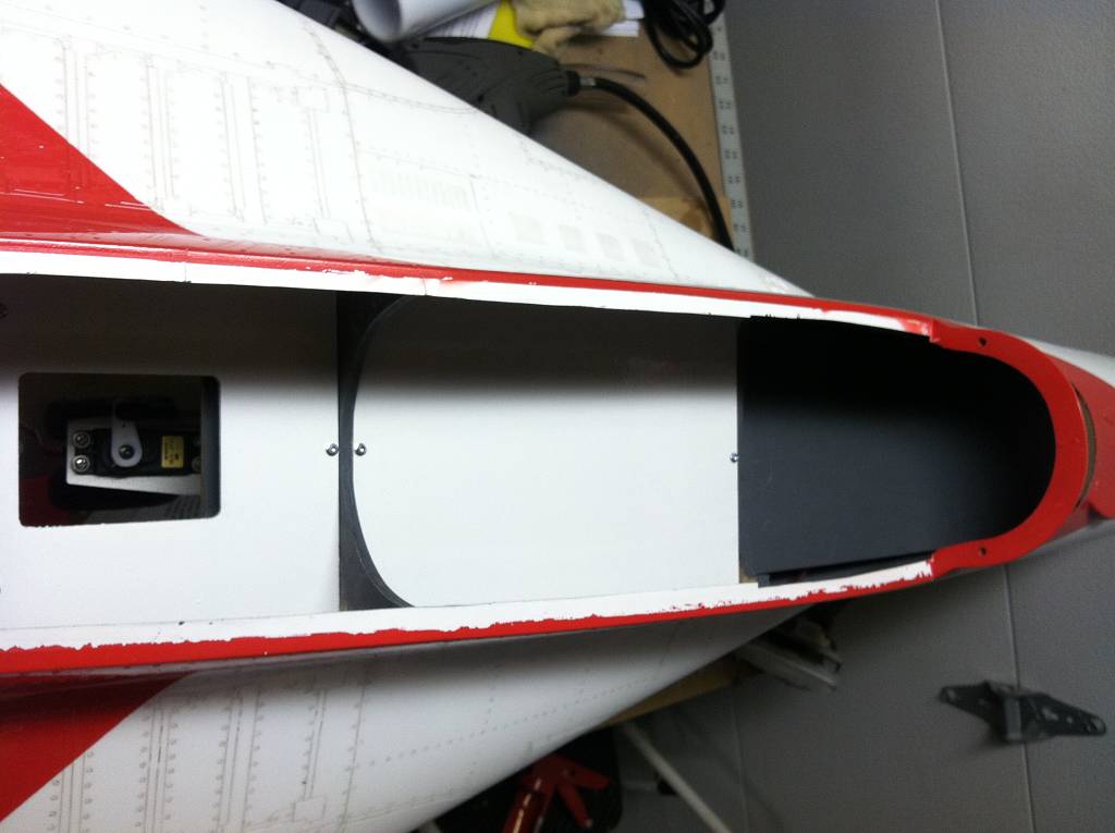

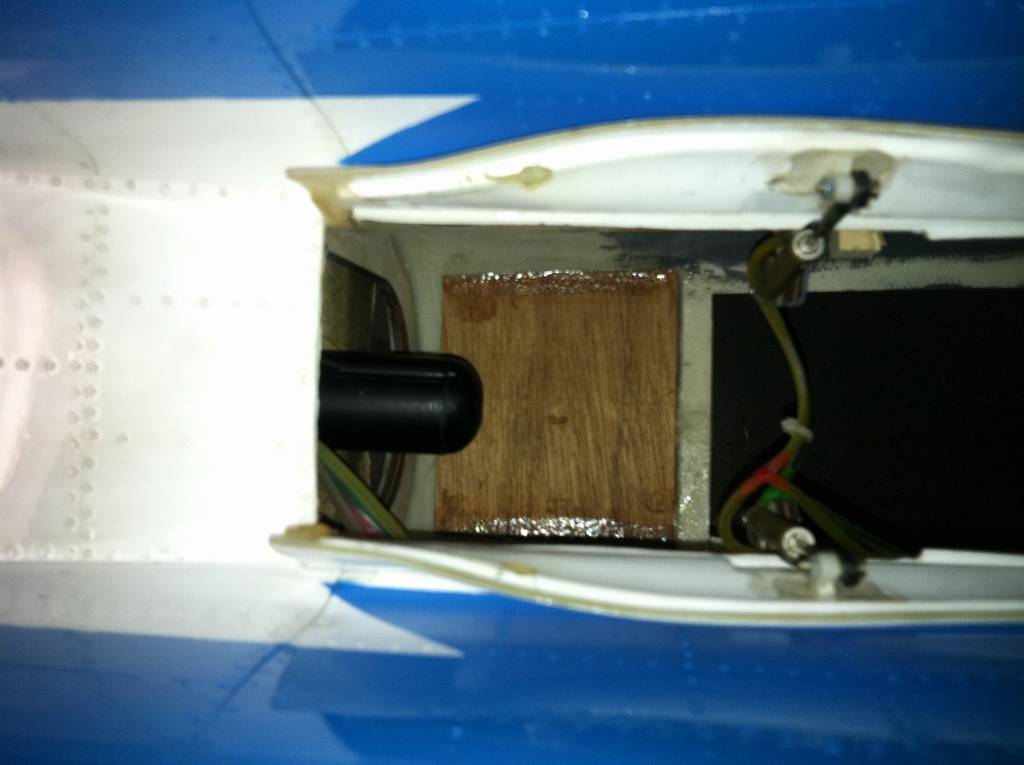

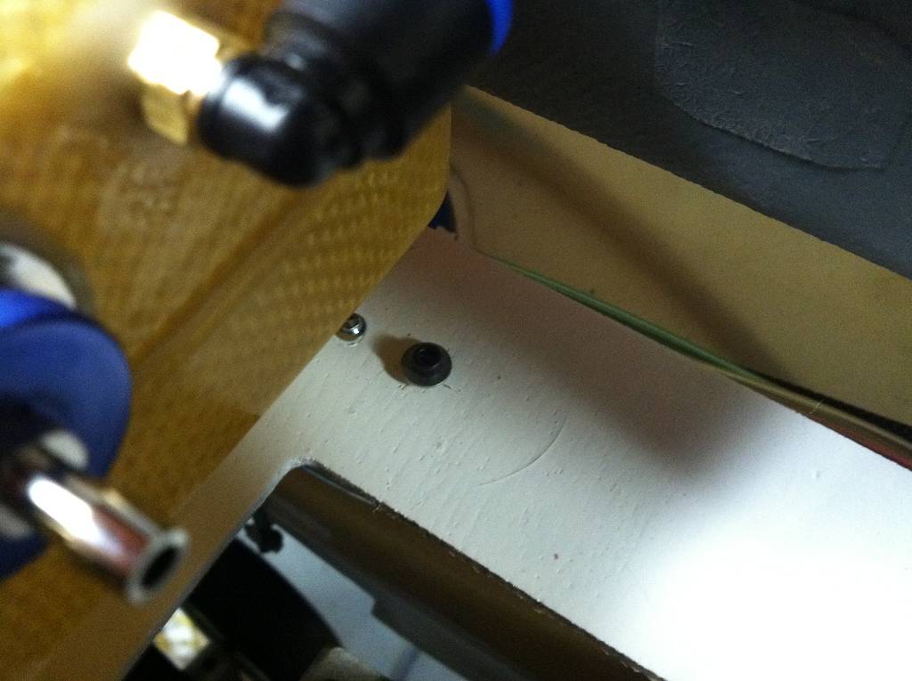

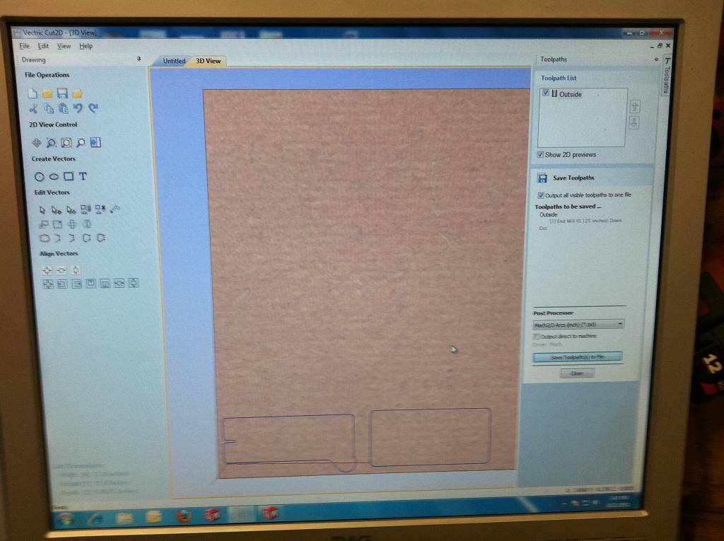

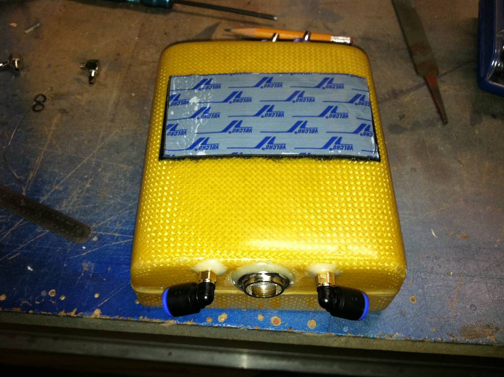

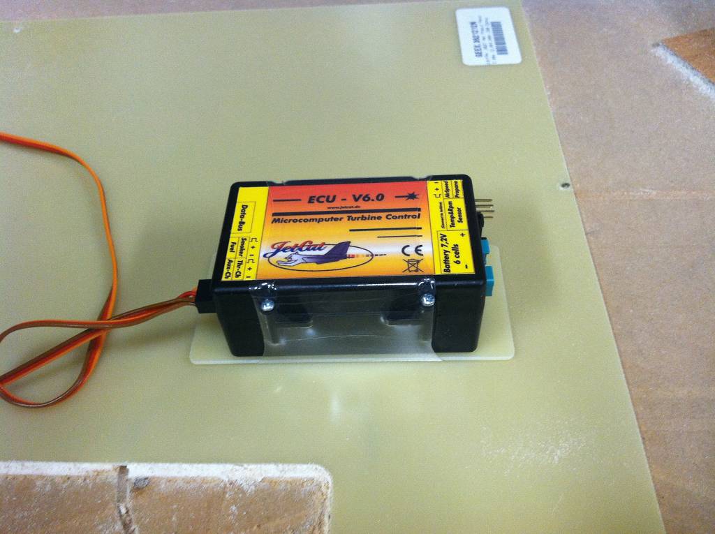

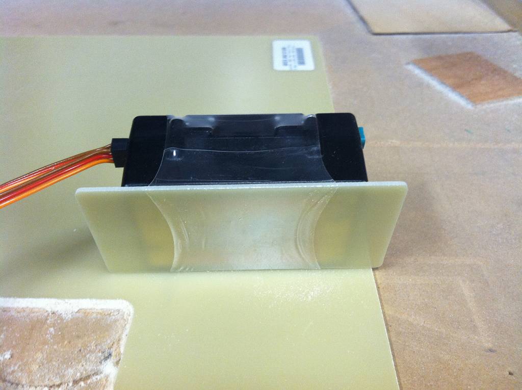

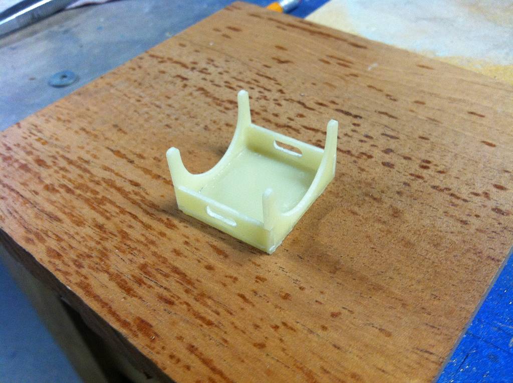

Ok, time for a quick update. I have been focusing on doing the equipment install lately. I am waiting on some shrink wrap currently but have gotten some things done. I drew up some mounts for the ECU and UAT in Vectric and cut them out on the CNC machine with a new roughing bit I got from McMaster. Man it cuts that G10 great!! I also drew up a fuel pump mount and glued it together and seems to fit just perfect.
The ECU mount is just a plate of G10 that has been shrunk wrapped to the ECU using some battery shrink wrap and it holds it solid. This will be bolted to one of the floors I put in the nose section. The UAT will be mounted the same way but with a little different way of securing it to the board and I will go into detail more on that when I am ready to mount it.
I also got the small fuel tank mounted with some industrial velcro which should hold it solid even when full. I had to add a little "floor" to hold it though, just epoxied some ply to the top of the turtldeck above the nose wheel when retracted.

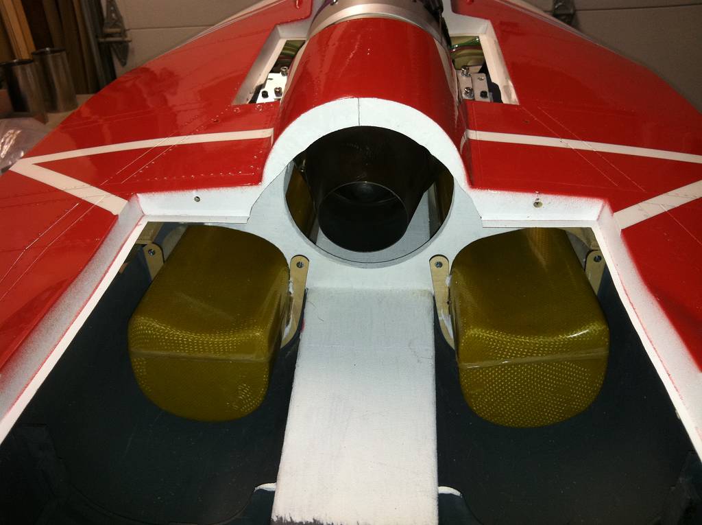

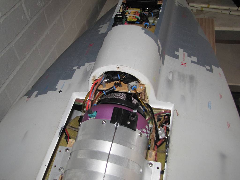

would you mind sending some picks on the tailcone side of the turbine? Is that a former right over the cone? Man that thing looks tight.
Andy

Yeah, that's a former Andy, but a bad angle. There is enough room there to fit on a FOD guard if you can believe that.

ORIGINAL: ianober
I'm talking about the opposite end. Yeah, the front is tight too. I've seen airflow problems with the FEJ version of this jet. Does Skymaster do anything different?

The opposite end is actually pretty good. There is a good half inch between the tail cone and the former. Let me see if I can dig up a photo, I might have one.
Here you go, is that what you are looking for?

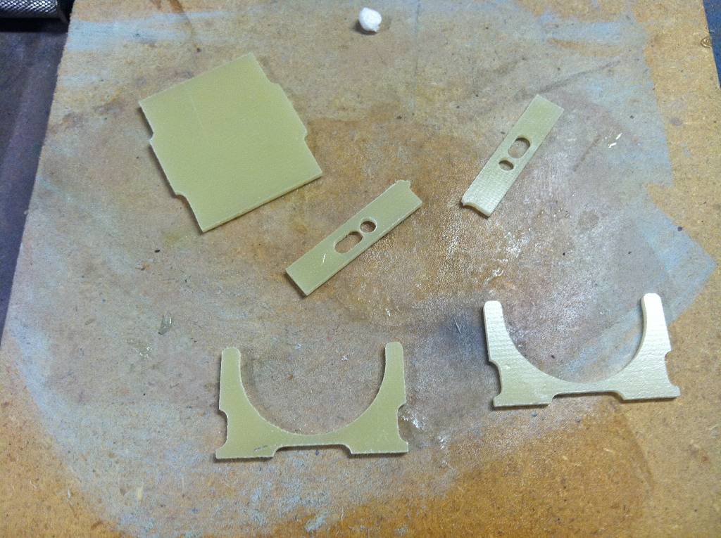

More done, I got the shrink wrap in to secure the UAT to its mounting board and got that secured down in its place. I also was able to start gluing in the canopy glass while I was waiting for the shrink wrap. Here are some pics to show:
