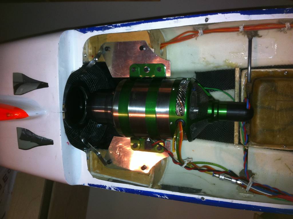

Hi Jame,
I don't know if a picture says a thousand words or not but here is the installation of my Wren Supersport in the CARF Flash with Single wall wren 620mm pipe and trick engine mount.
I have had two flights so far power is good and large loops and avalanches from level flight are possible it also point rolls and cubans no problems as well with the Supersport.
I got the airframe from a guy in Twickenham (Skywarrior on RCU, i think). He modded the fuz tank to remove the flat bottom and put in a small sump. With the engine mounted this way and all three li-pos right up front i did not need any nose weight to obtain the recommended c of g.
I don't use a wing tank and have the timer set for about 6 minutes.
I bought the Dreamworksrc flash gear which is Bomb proof! The trunnions are wider than the standard set-up and a bit of Dremelling is required.....any questions just ask?
I have to say my mate (flying scotsman on RCu) has a p120SE in his and that really does set the heather on fire, the superport is fine however.

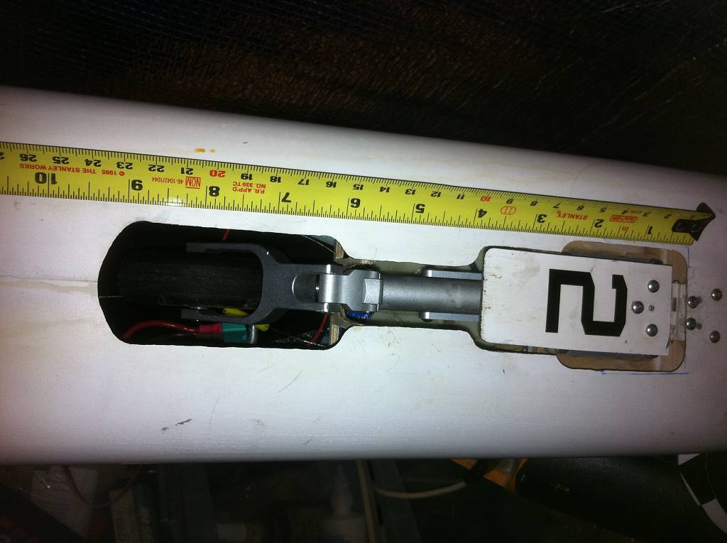

Hi Mike,
I bought the model 2nd hand, so the nose gear bay was already cut out. I think i did extend the opening
slightly. Here is a photo (the previous owner cutout the nose gear door and i did not want problems with
air resistance preventing the nose gear extending fully so i kept the original nose door figuring it worked for
the previous owner so why change it?)
The photo shows the new aperture at approx 2.125" diameter and 9.25" long. I refinished the model at the start of the year
but was unwell for a few months and so i only have logged two flights since my health returned.
One problem my friend and i have both had with the Intairco wheels is either tyres coming of the rims on his flash or on my flash with the latest
improved split hub intairco's i have had flat spots on the tyre develop quite quickly. I use the Behotec dual landing gear/ brake valve and have
employed a collet as a restrictor to slow down brake application but it still seems to be a problem (maybe firther restriction required)
when flying off anything other than grass.
