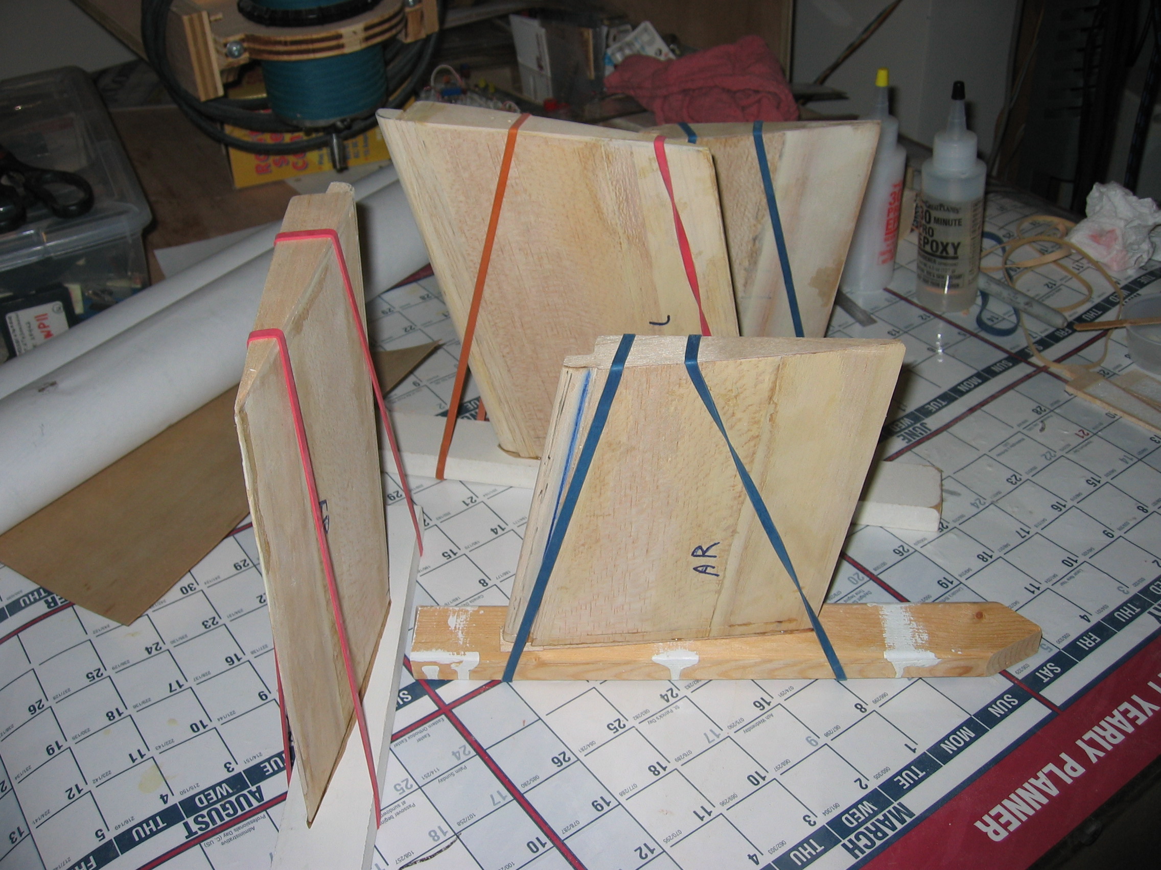

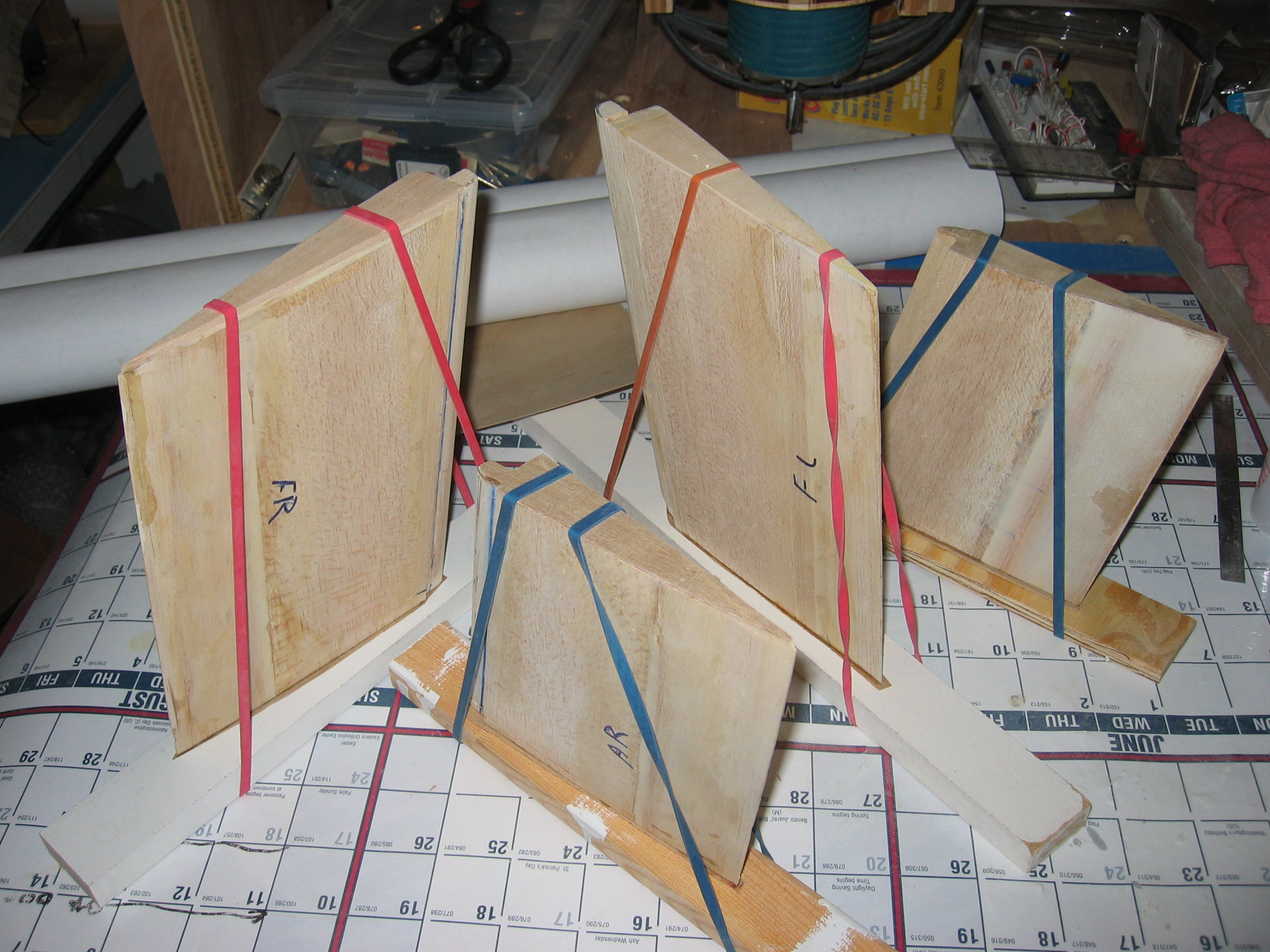

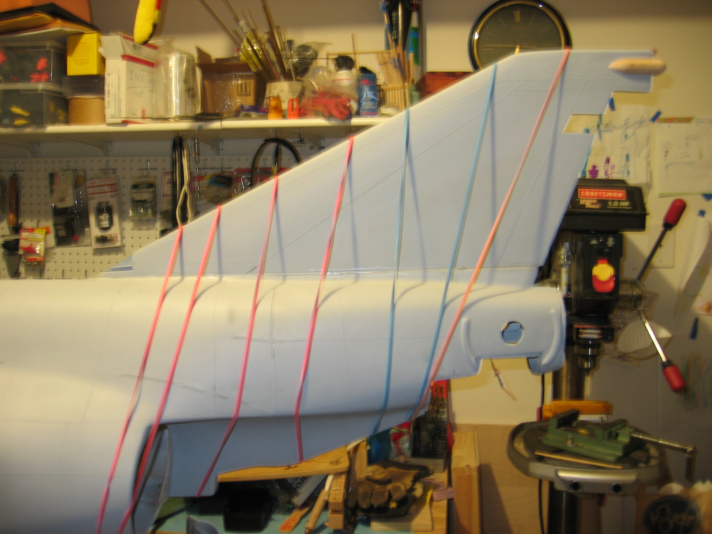

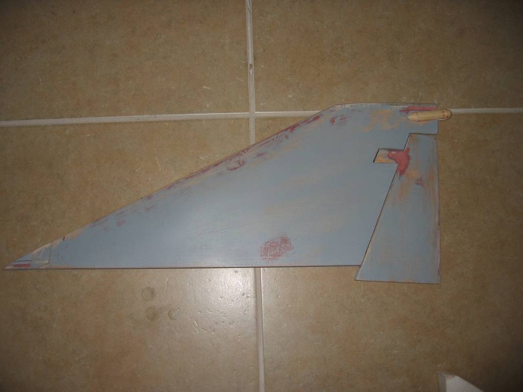

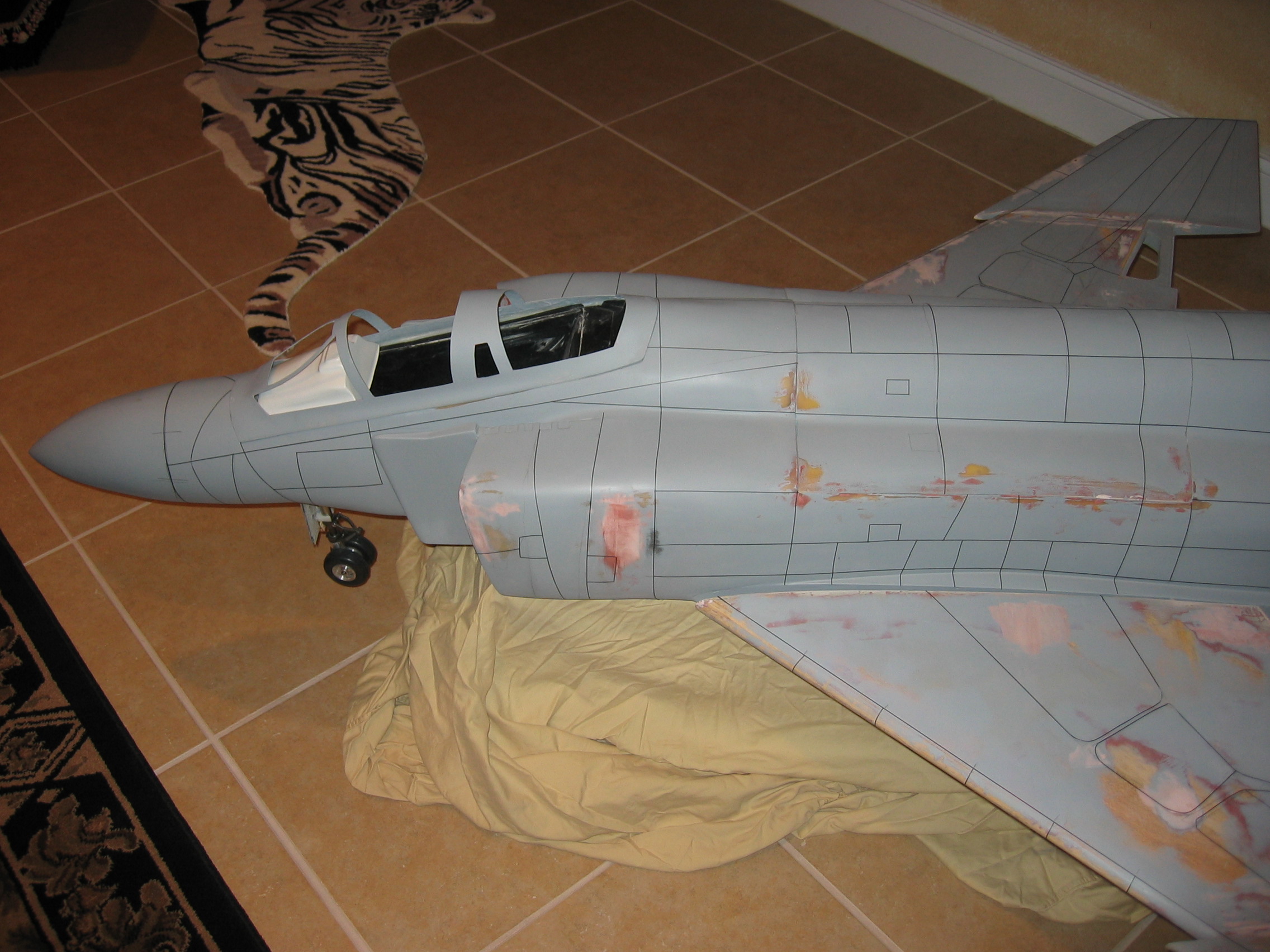

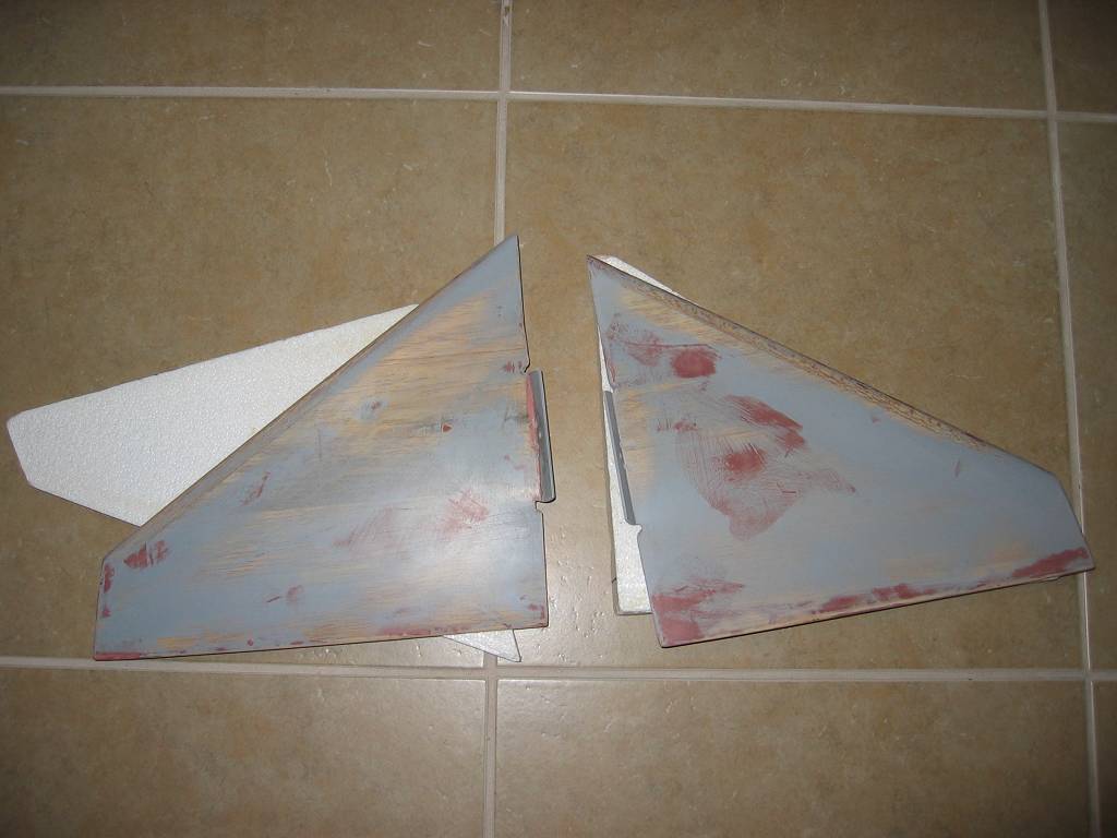

The Stabs, vertical fin and rudder has been primed and ready for final sanding.
ID:	1888012   Click image for larger version

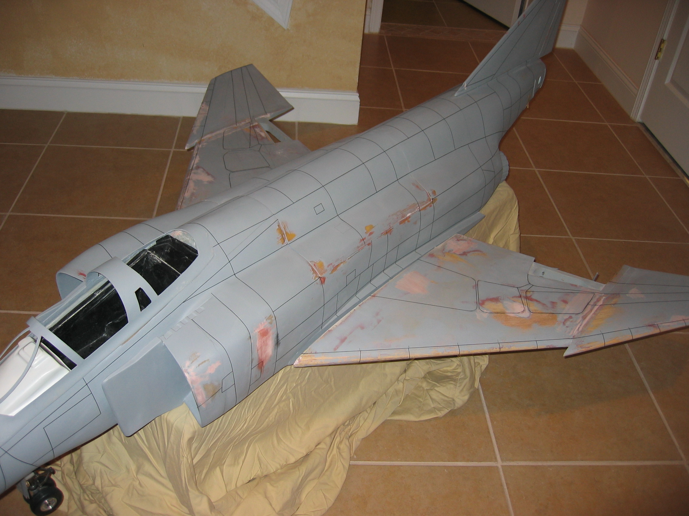

A few updates, the wing is done and fits pretty good, I have primed them and ready for sanding and filling, here is a few photos...

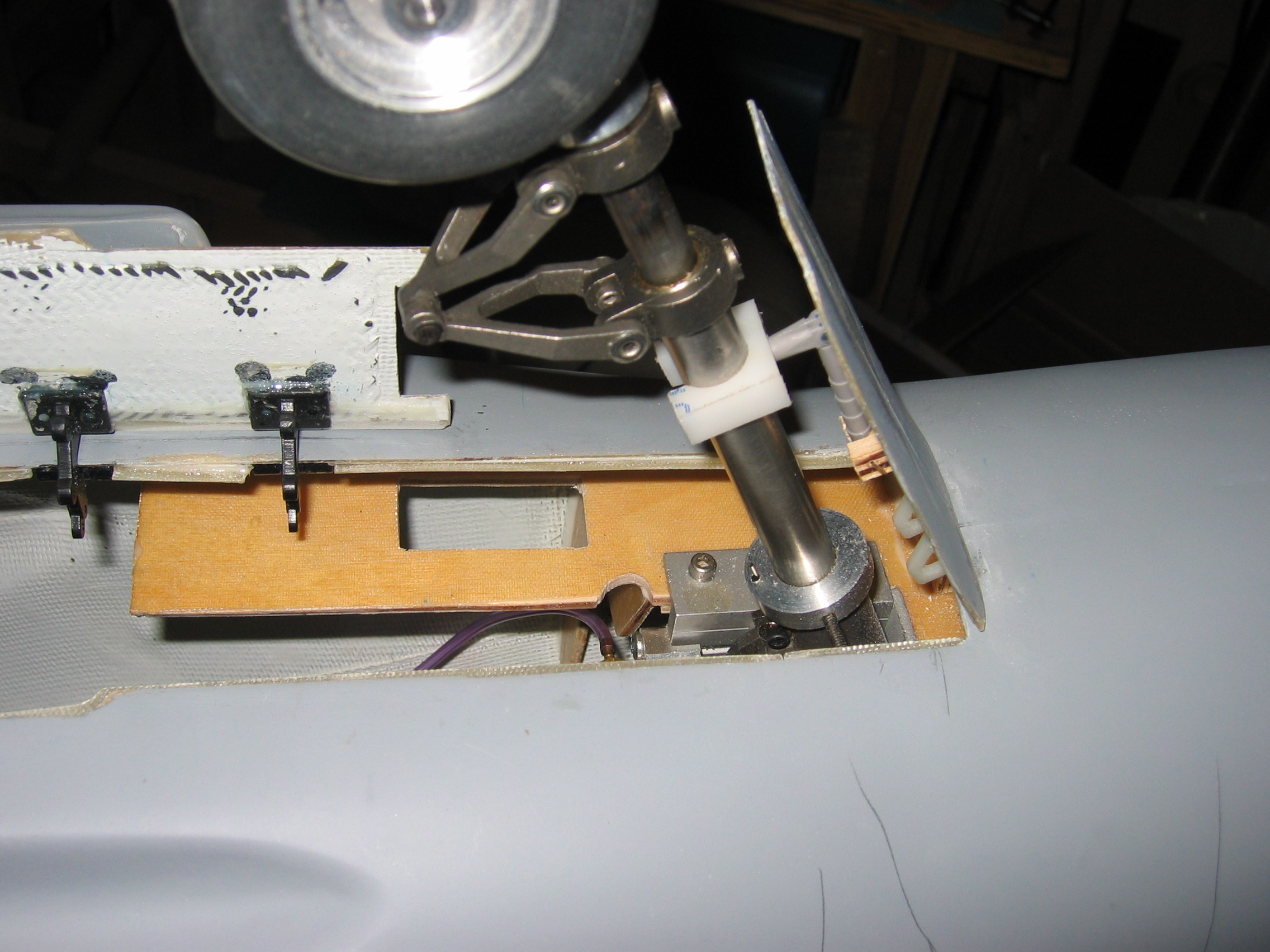

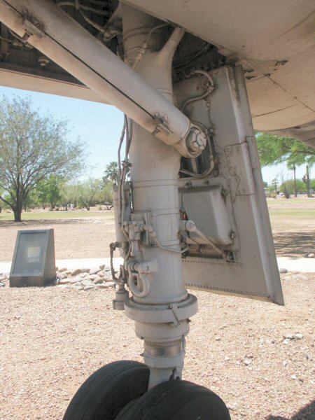

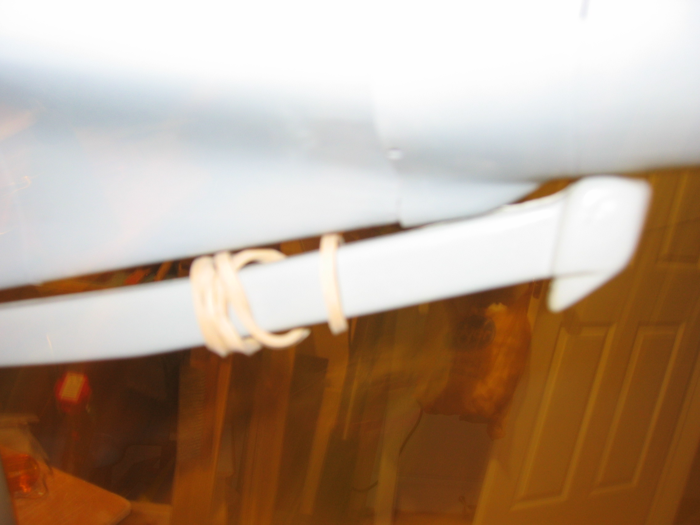

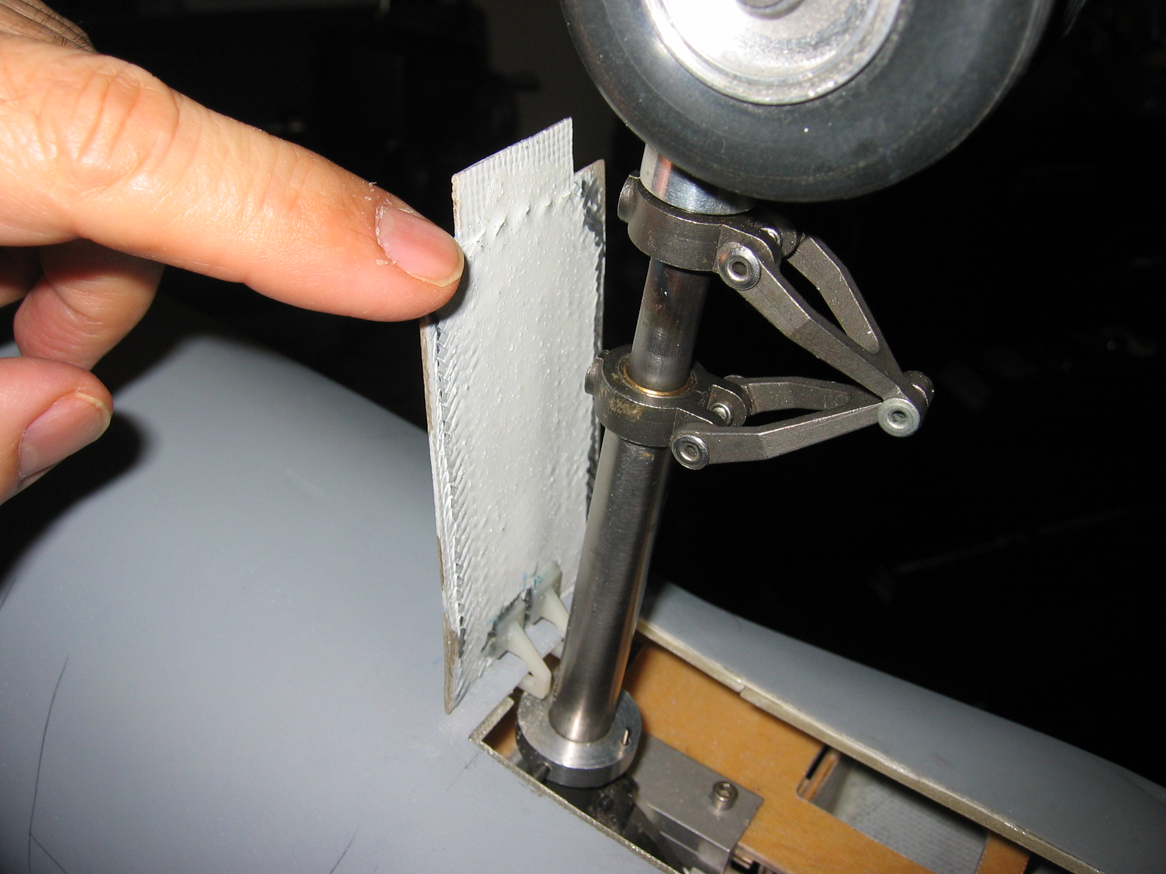

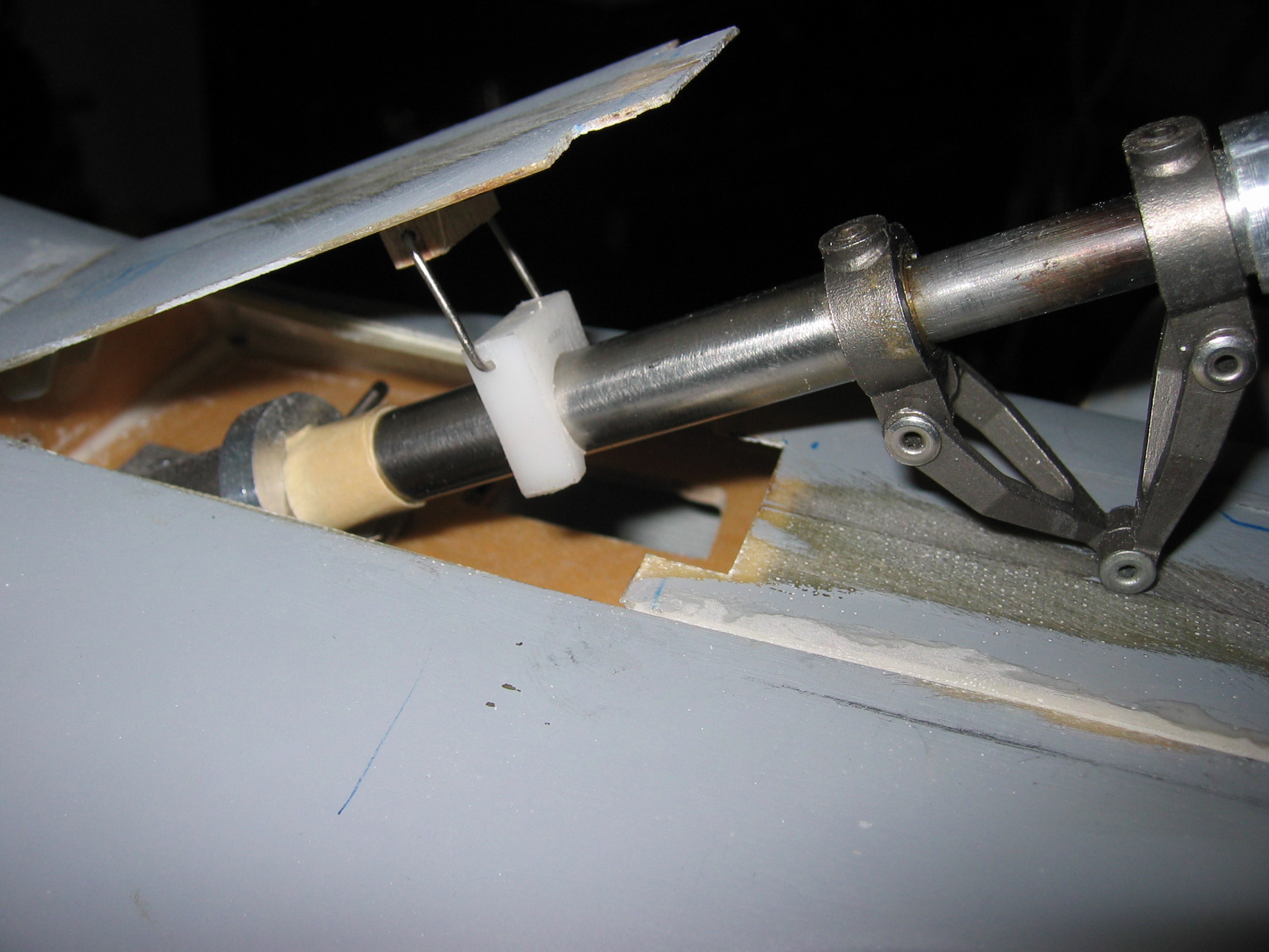

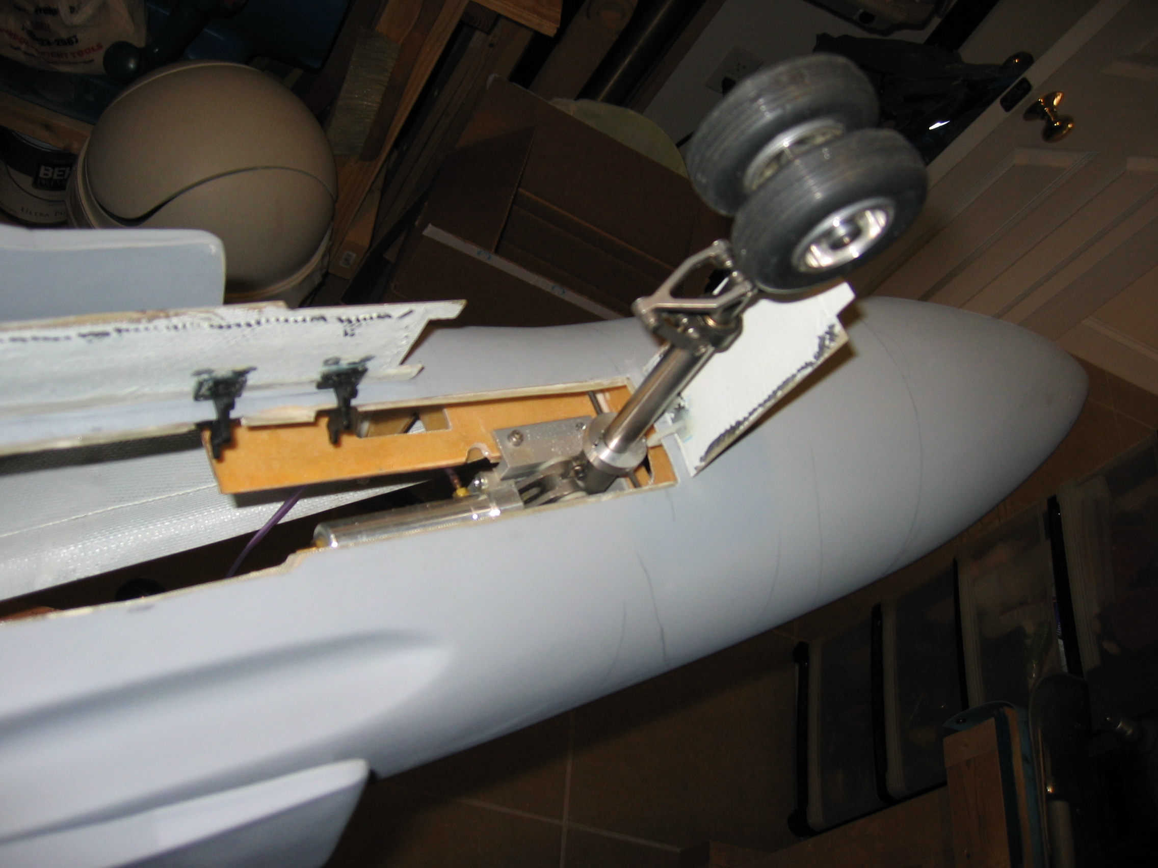

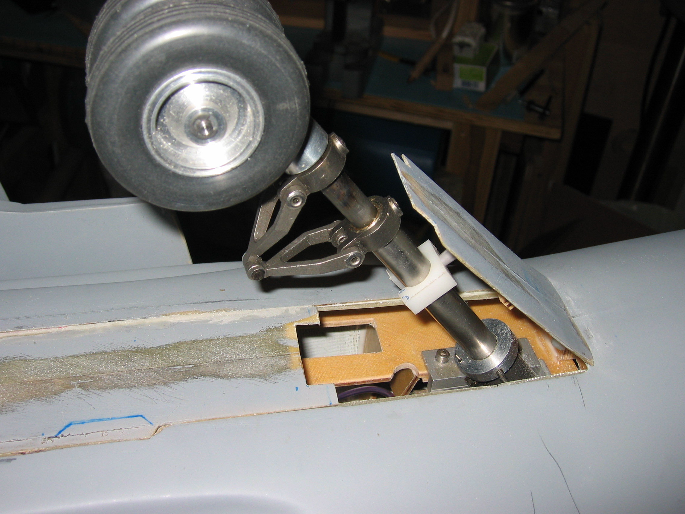

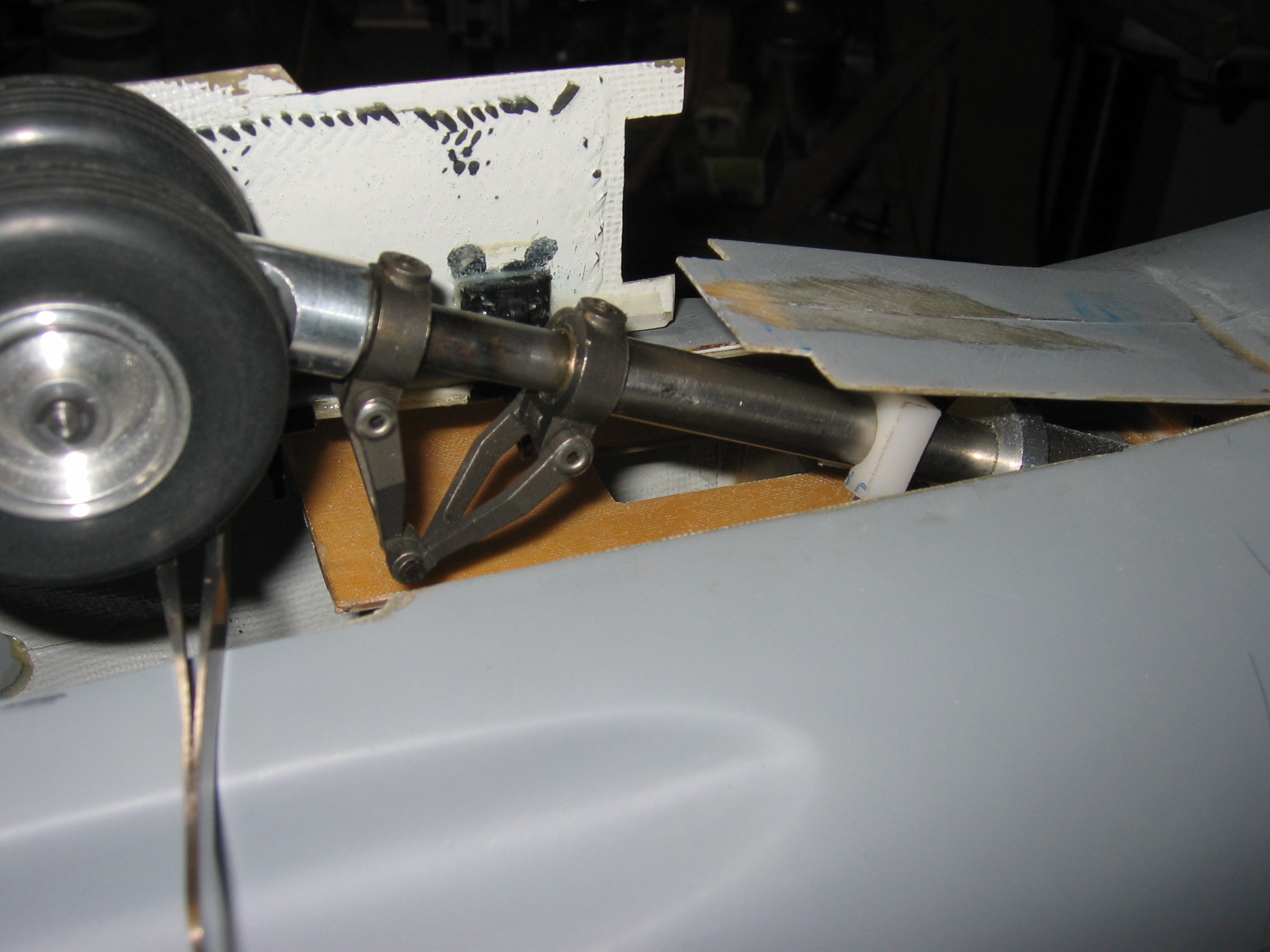

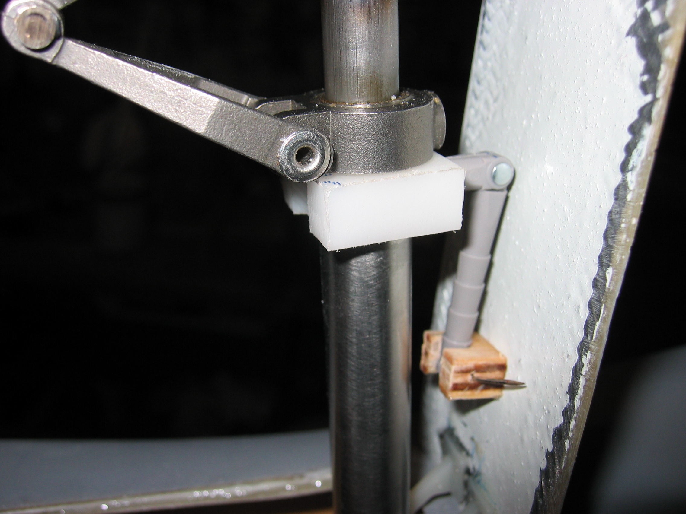

I am working on he nose wheel and doors, frankly I need some advise as how to attache the front nose wheel door to the retract. I remember seeing a few posts about that but can not find them. Here is a few photos, I have installed the hinges, the doors will come off later to install a layer of white styrene for looks. Any help and tip is appreciated.
ID:	1951765   Click image for larger version
ID:	1951766   Click image for larger version
ID:	1951767   Click image for larger version
How about a rounded hard wood piece on the front door that the strut pushes away and won't catch on the oleo mechanism.
I had the one piece wing CJ F-4. I flew it with an airstart Olympus. It was a beast!

Hi Ravill,
Yes that would work when you deploy the gear but when it is retracted, the door needs to be pulled in. I could use a spring to pull the door in. Your F4 looks great, do you still fly it?

A spring would work as well, however air pressure will push that door closed.
Springs will make it easier to transport as you won't worry about breaking that door.

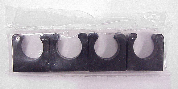

Mike,
CJM has a nylon door attachment that clips around the strut. A combination of one of these and a short piece of brass tube attached to the door span wise with a U shaped wire going through the brass tube and attached to the nylon block should work. Lets you hook up the door mechanically and still have steering. Just a thought.
Old 12-28-2013 | 09:06 PM
  #83
USSCAT's Avatar
Joined: Nov 2005
Posts: 393
From: Woodstock, GA
Hi Ronnie,
I think this is what you are referring to.....
This should work, the problem is that since the door and the retract are on different planes, when nose wheel is retracted the cord may rip off the brass tubing and if it is adjusted just right then the the door may not get pushed out in the open position properly.
It may have to be a swivel arm which would scissor (collapse) when the gear is extended out and then straighten when the gear is pulled in. I am pretty sure i will still need the mounts that you mentioned above. Thank you....

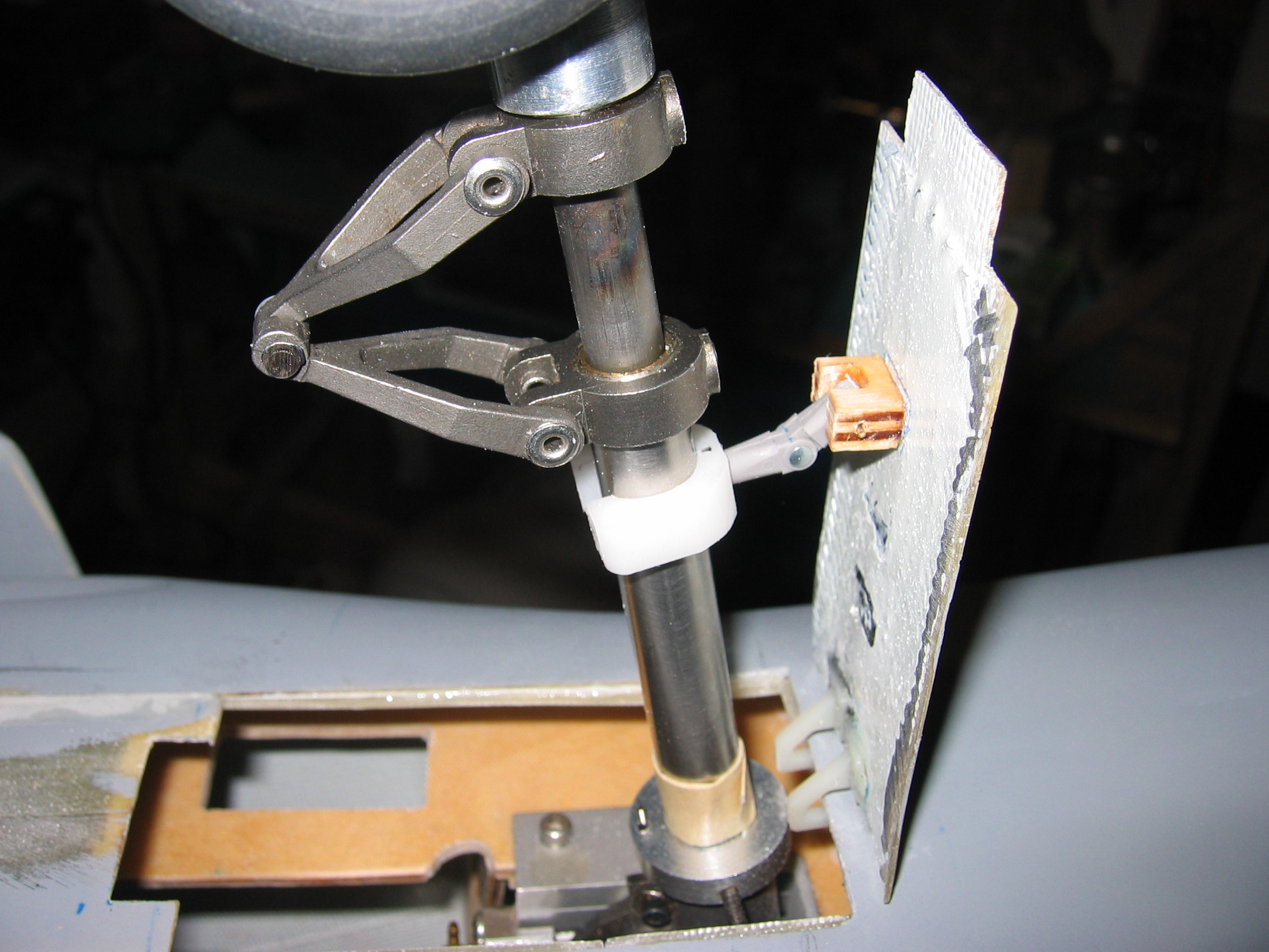

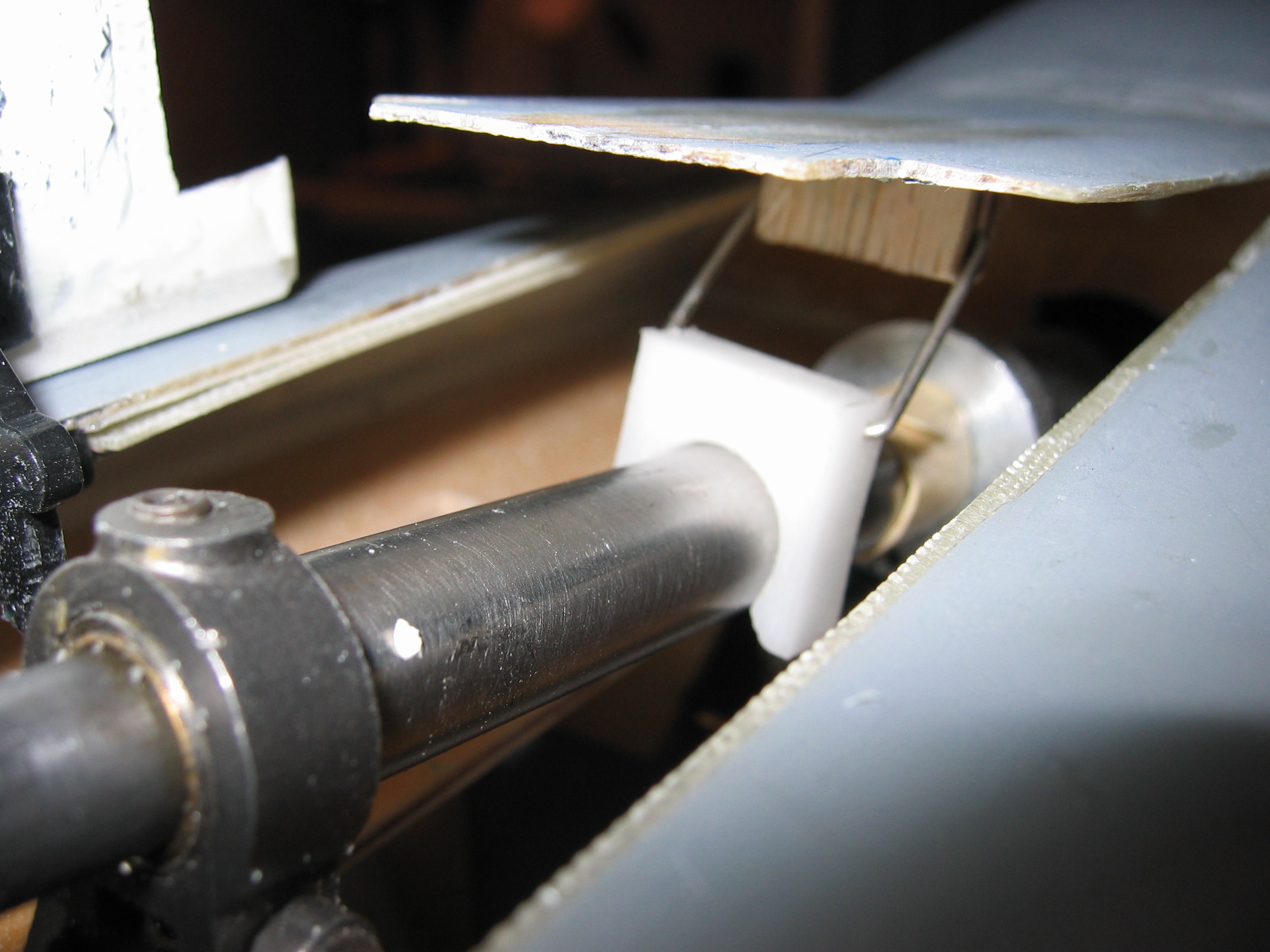

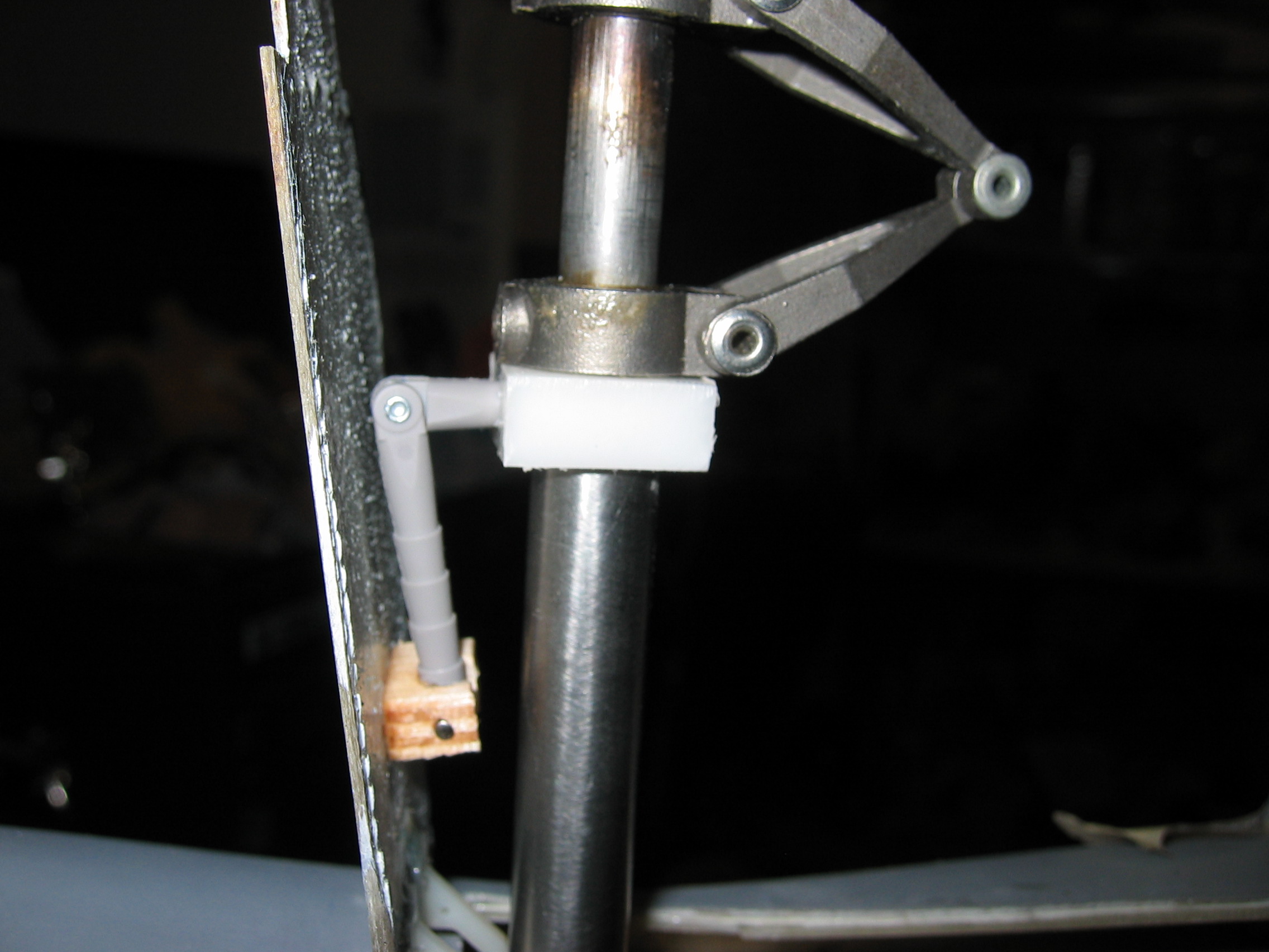

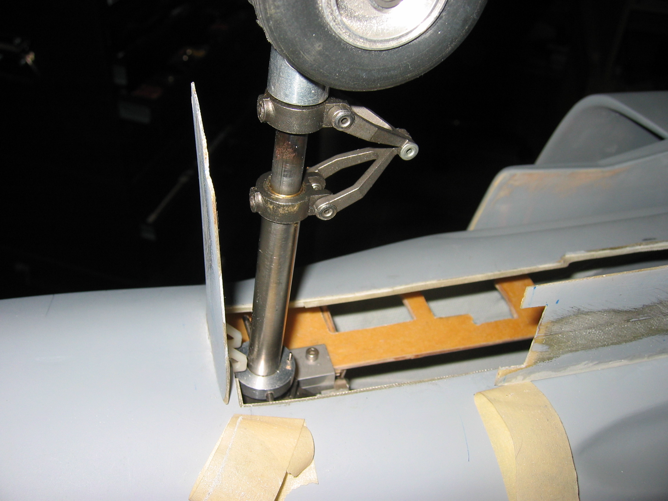

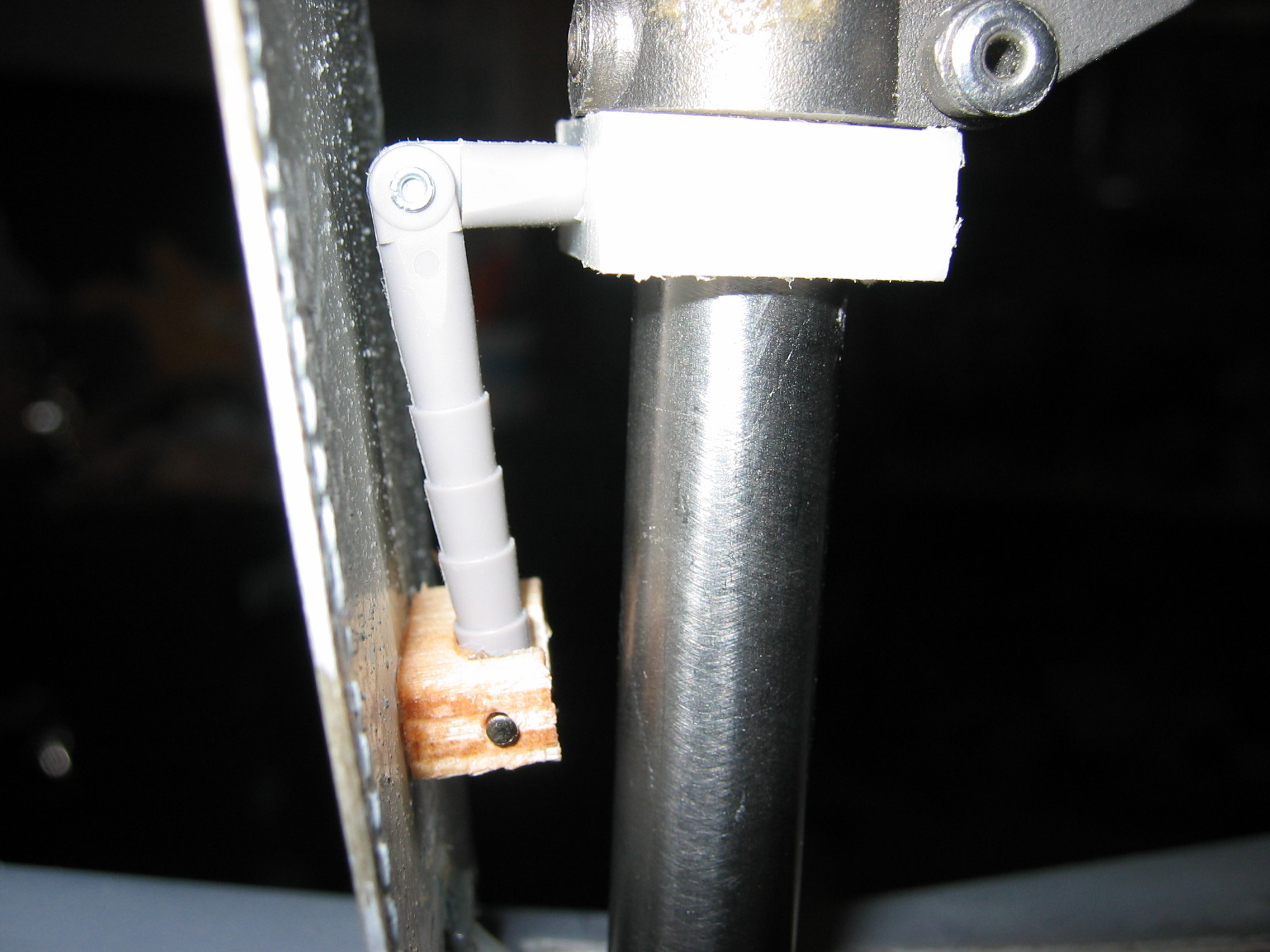

Ok, taking Ronnie's and Ravill's suggestions, i think I have the problem licked. I used a piece of Teflon stock and drilled to the ole diameter with a slight opening to get it in and out. Then modified a robart large hinge by cutting it to size on one side and drilling a small hole on the other side for pivot. the teflon block rides freely on the ole shaft. Here are a few pictures.....
ID:	1952307   Click image for larger version

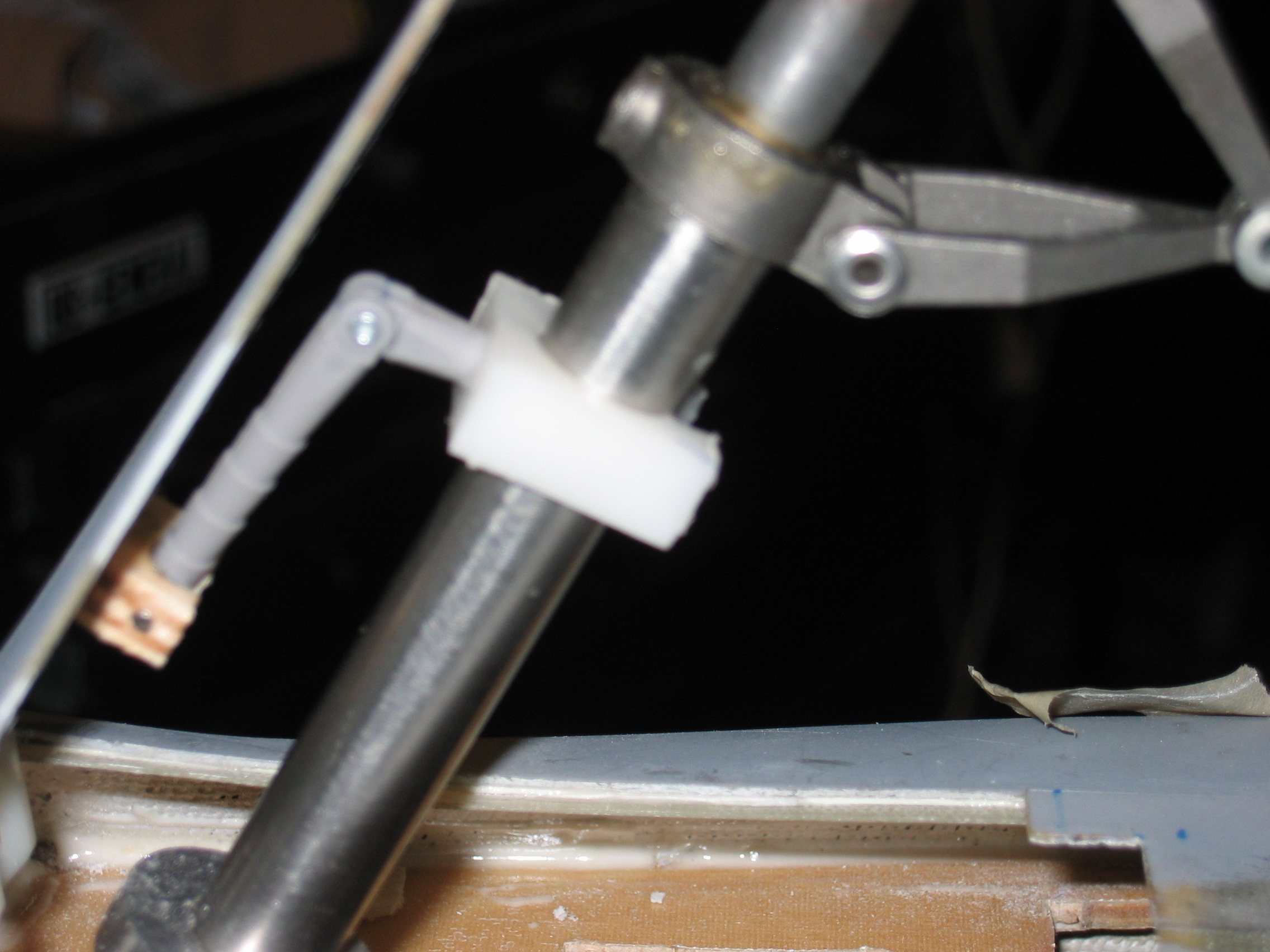

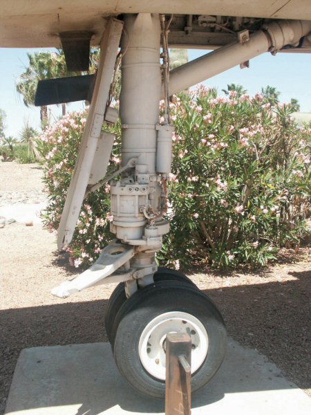

Mike,
Not exactly what I had in mind with my suggestion. The nylon block is doing just what I expected, changing position on the strut as the gear retracts. However, on the door side I was thinking along the lines of a simplified version of the links that attach from the strut to the door as in this photo using the brass tube and U shaped wire I spoke of. This should accomplish the same thing and be more scale looking. Noticed the position of your scissor links. Is there anyway to turn the strut so that the links are at a scale angle and still be low enough when the gear is retracted for the door to fully close ?
ID:	1952463   Click image for larger version

Hi Ronnie,
I had to cut the other end of the hinge down to a stub to fit it so that the door would close and not pop open when the retract is pulled in. I see your point, the pictures are good, let me try that and see how it works. Thanks.
Old 12-30-2013 | 09:24 AM

1ricasrdo,
Thank you, this is work in progress
Ronnie,
The first two pictures are from the original approach, the later ones are per your suggestion, I used a piece of paperclip wire to attache the new block to the plywood on the door. I like the later......
Bingo Mike. Much improved look.

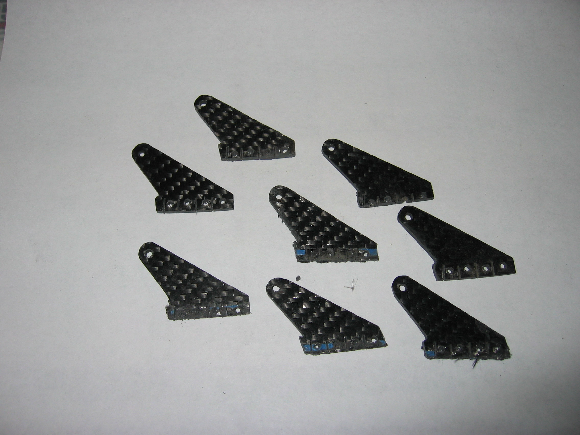

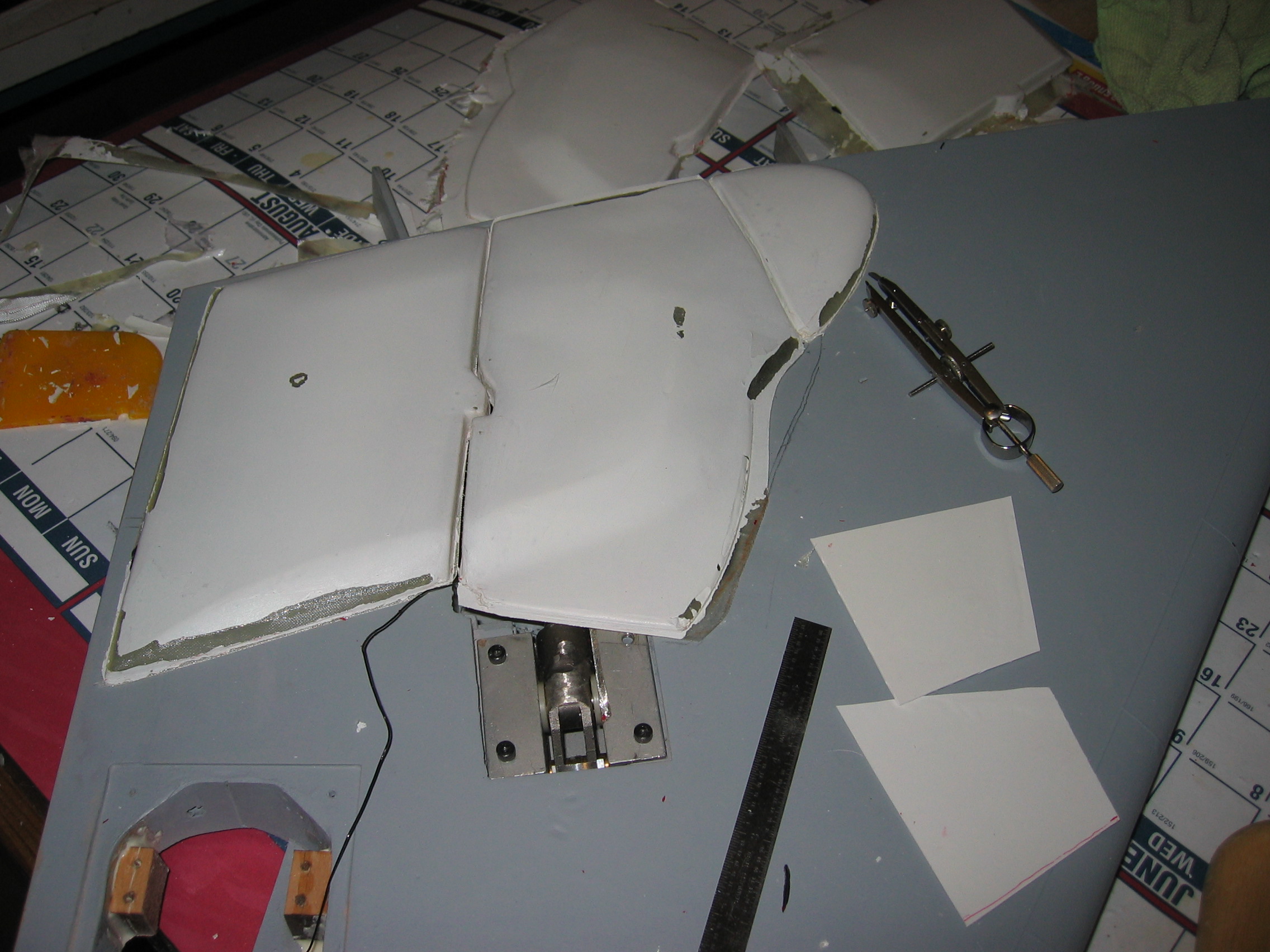

I know it has been a while sine my last post..... I have been working on and off for a while ....
The Ailerons and Flaps have been capped. Made a few carbon Fiber control horns.

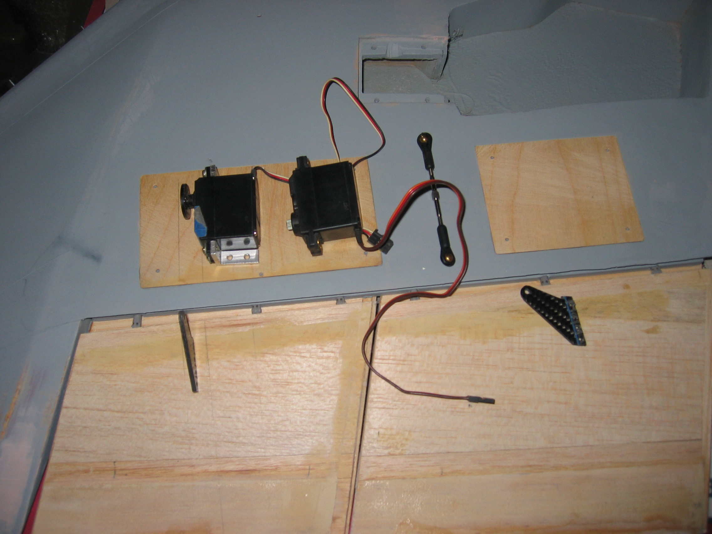

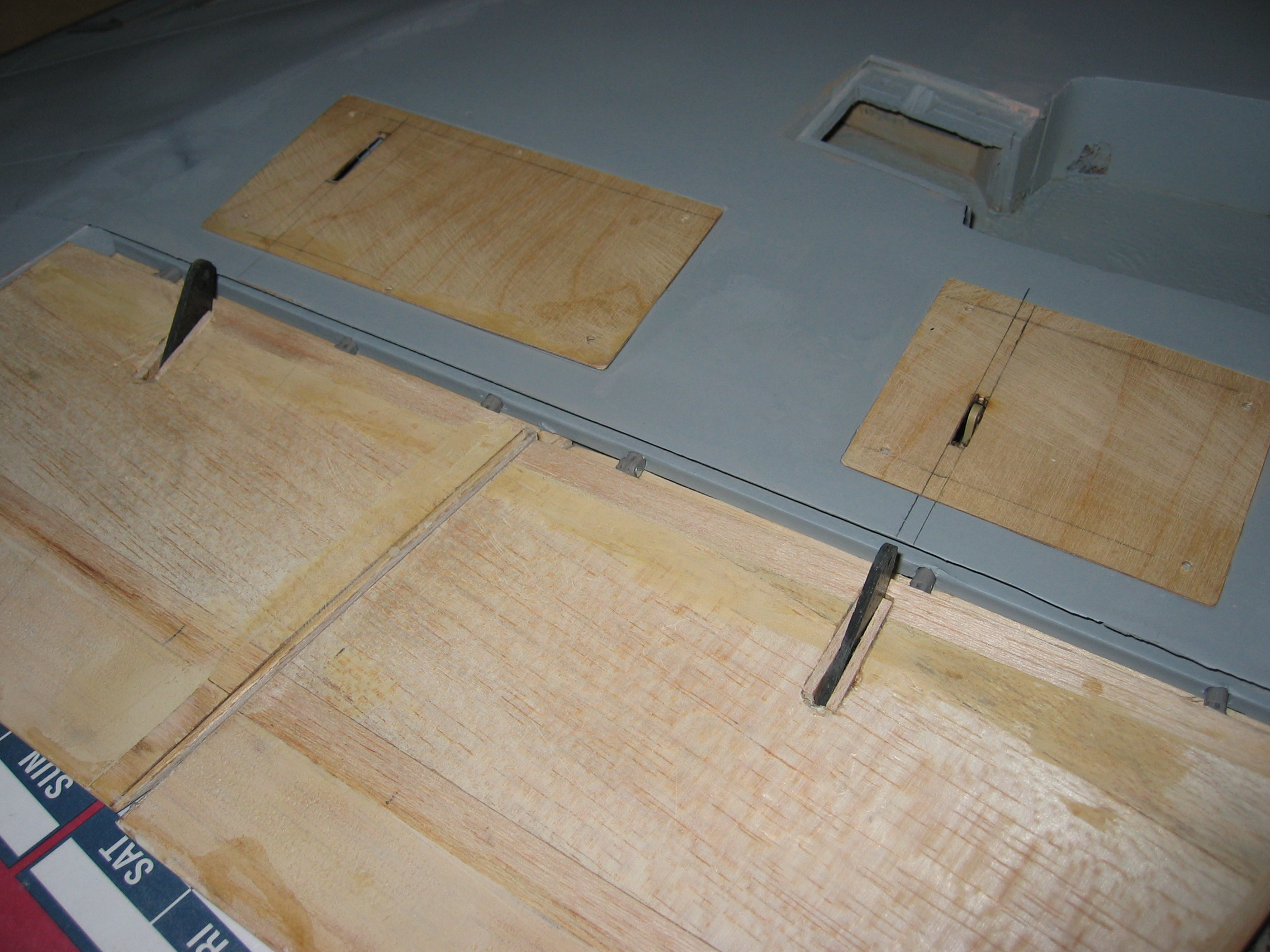

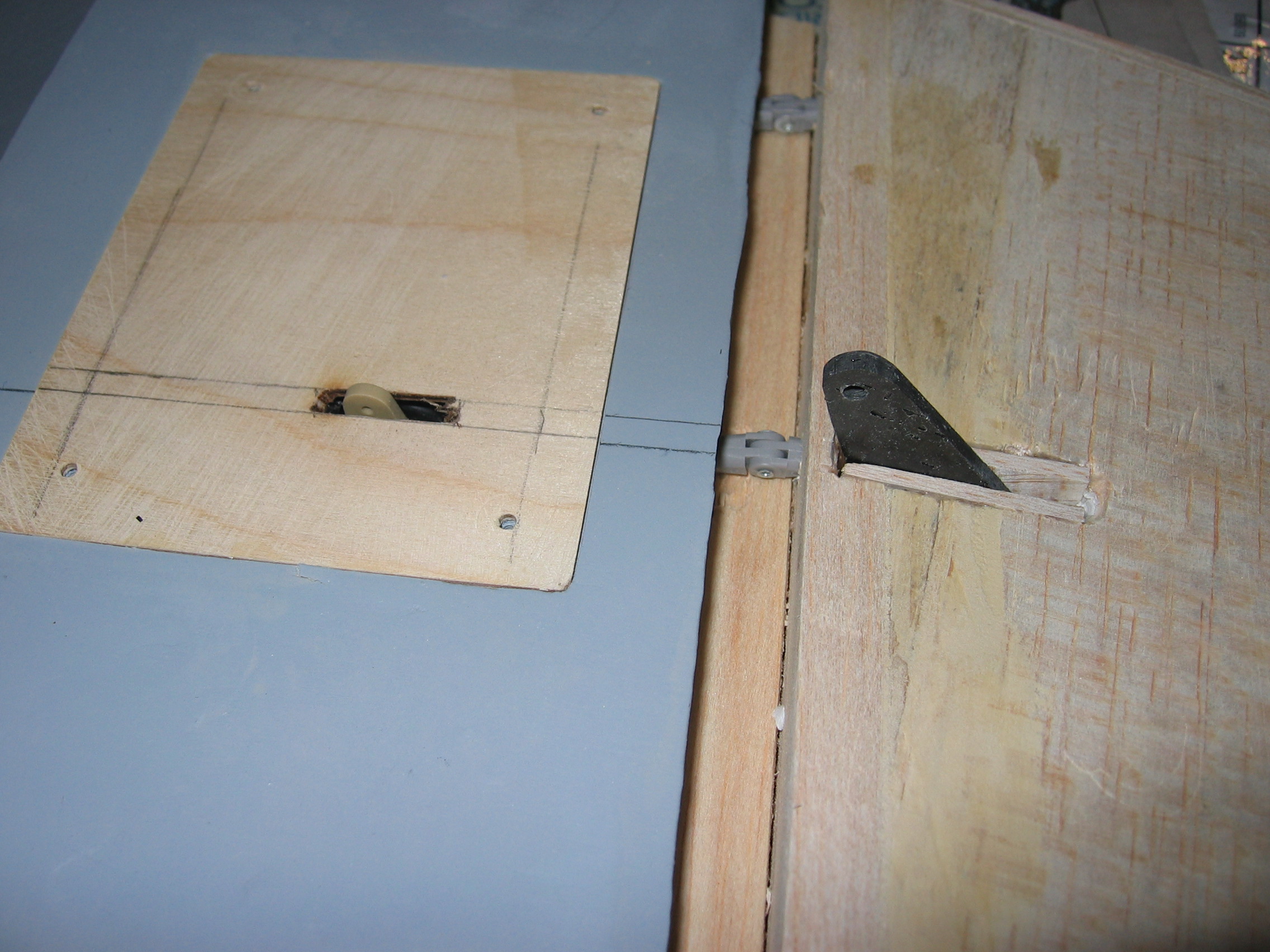

setting up control holes......

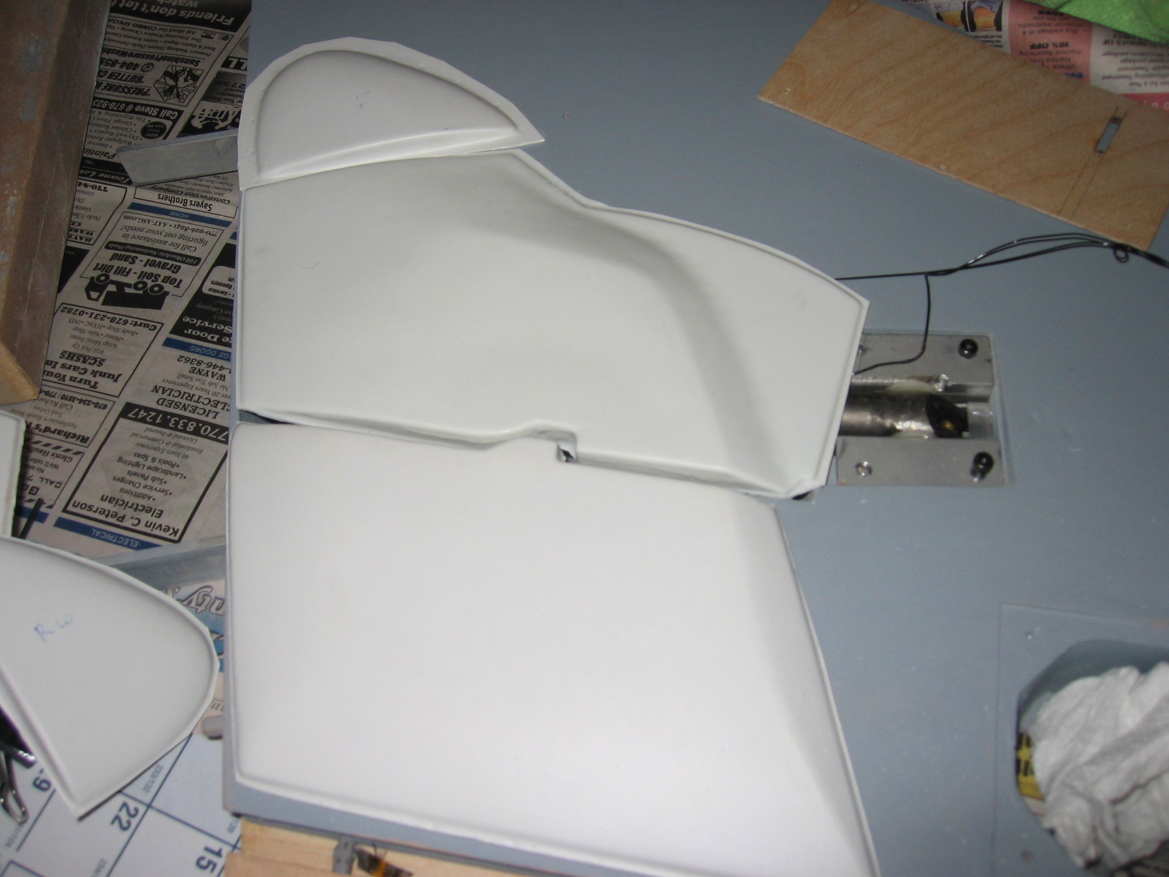

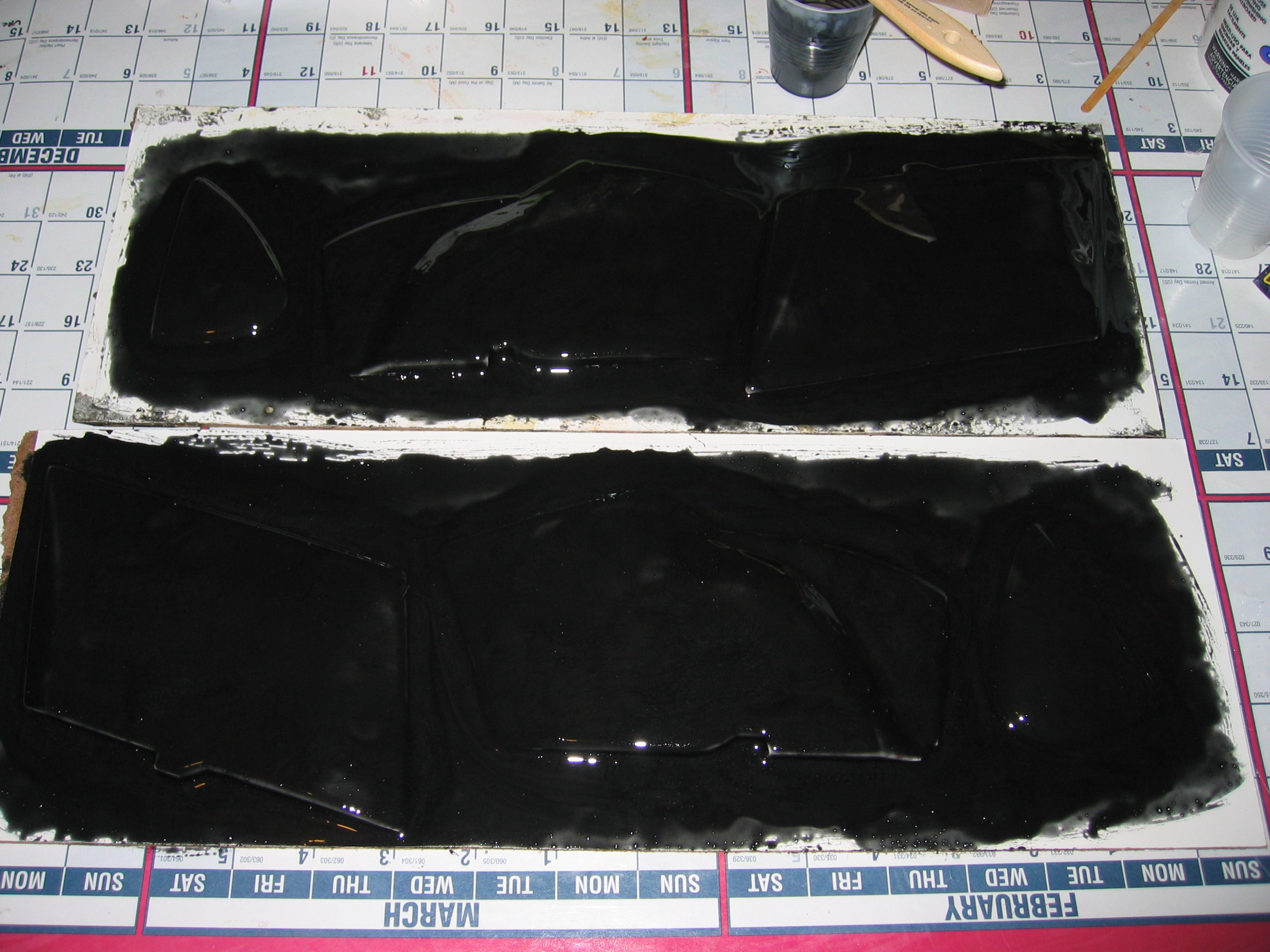

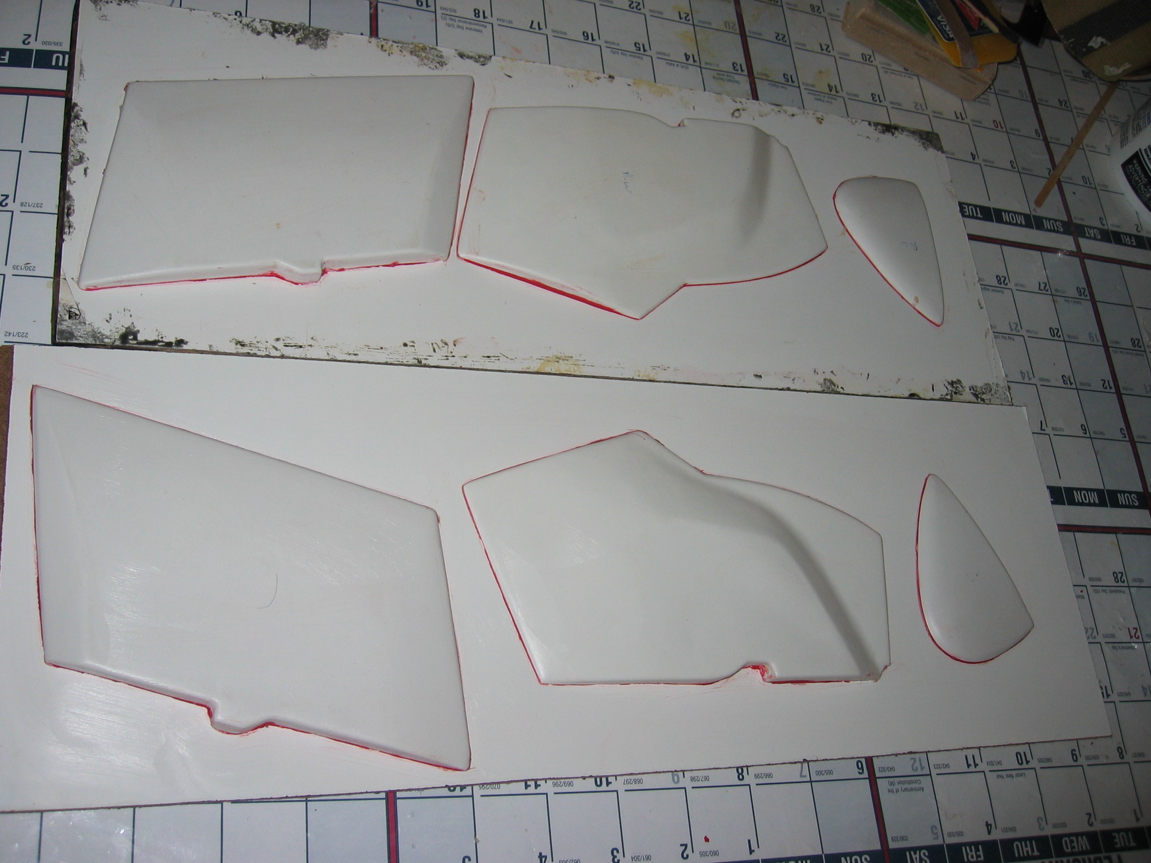

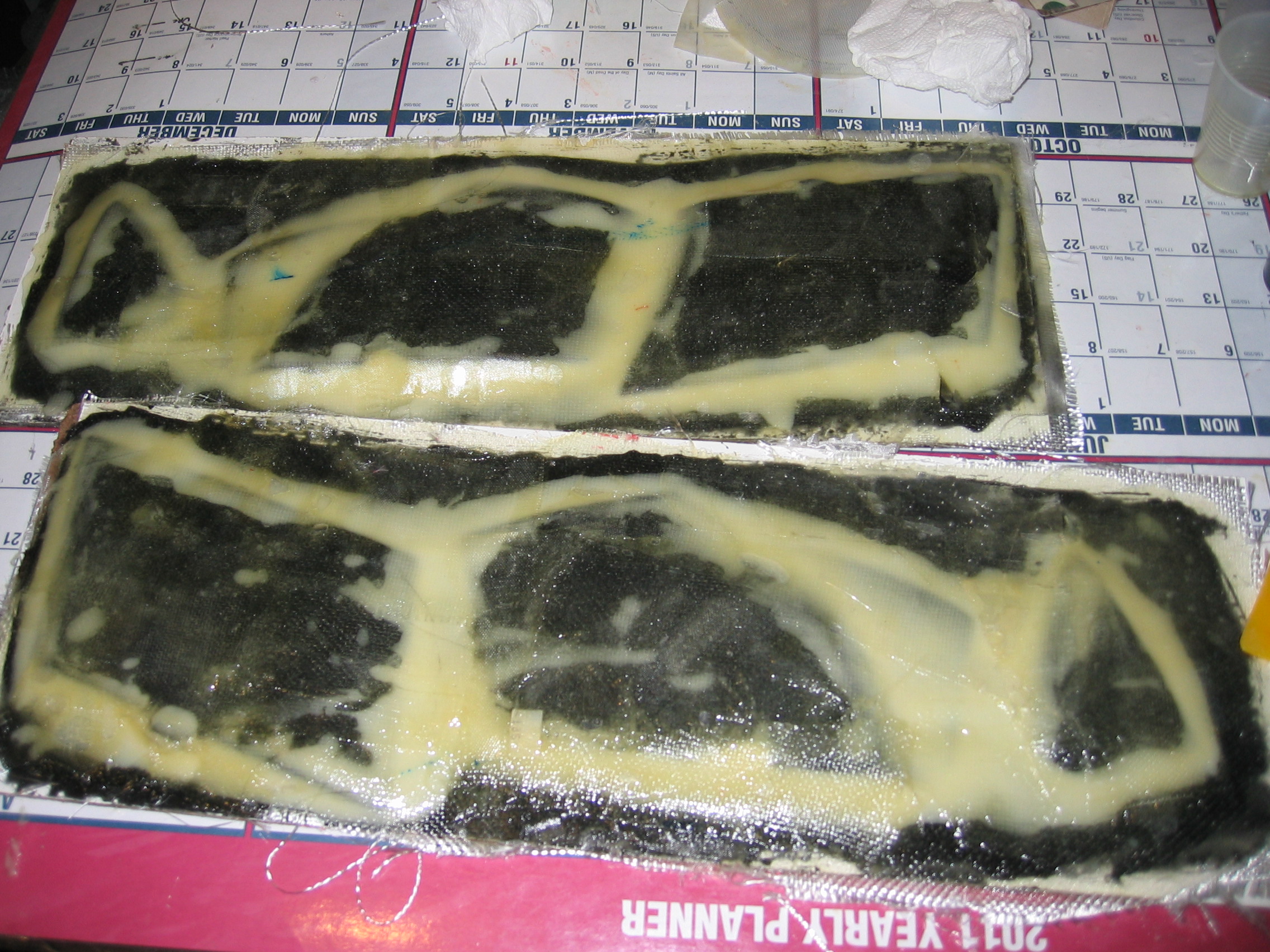

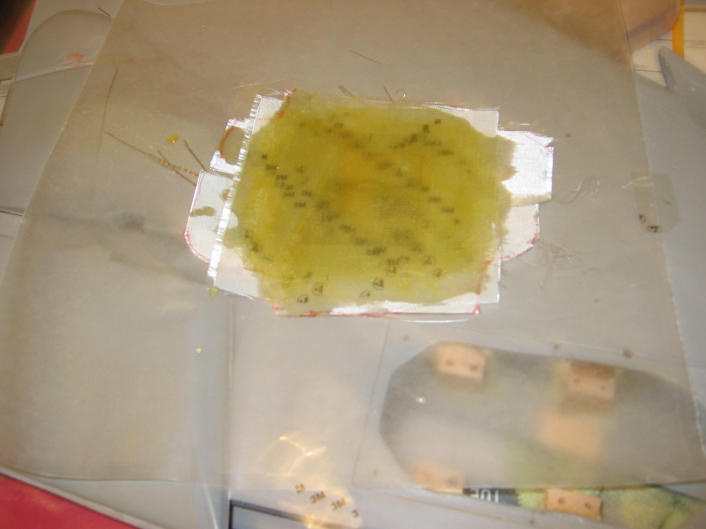

The Gear doors material is ABS.....
so here goes some molding pulling parts....
The smaller Gear door had to be made on the wing, did not have the ABS version....
ID:	2198086   Click image for larger version
ID:	2198087   Click image for larger version
ID:	2198088   Click image for larger version
ID:	2198089   Click image for larger version

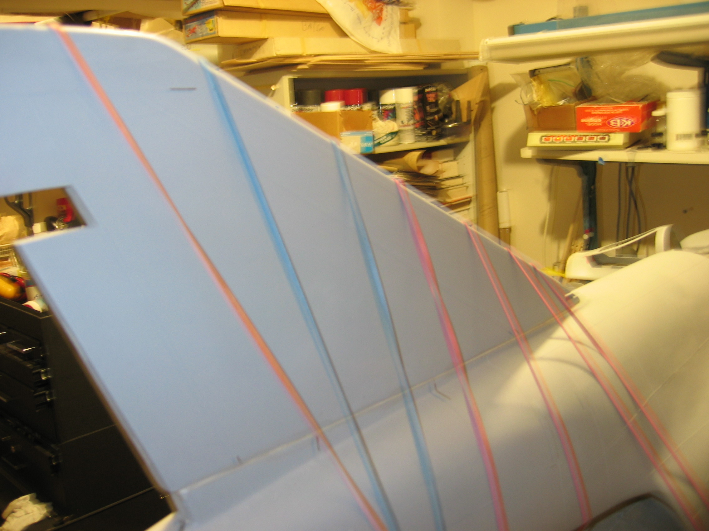

Attaching the vertical stabilizer...

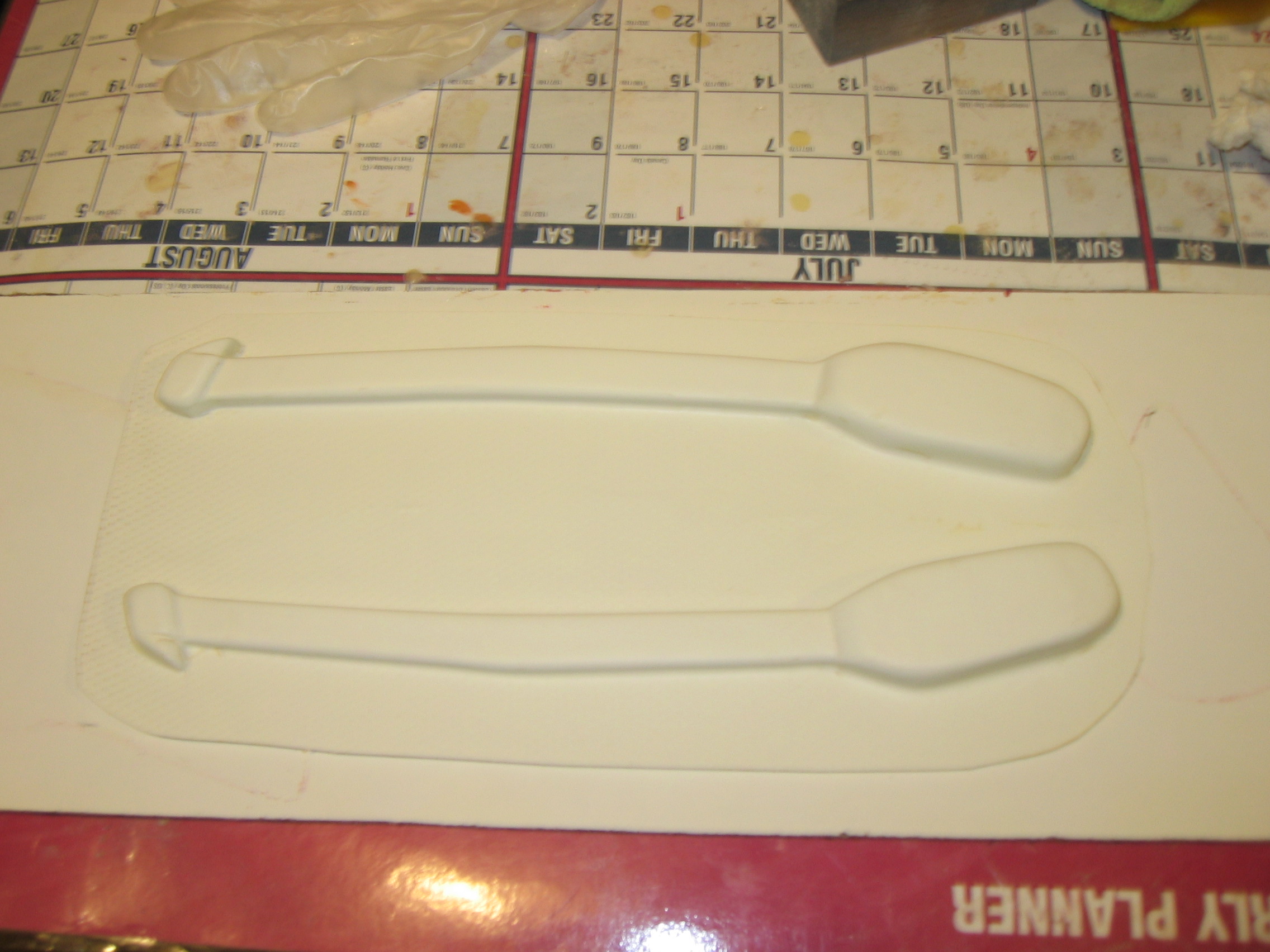

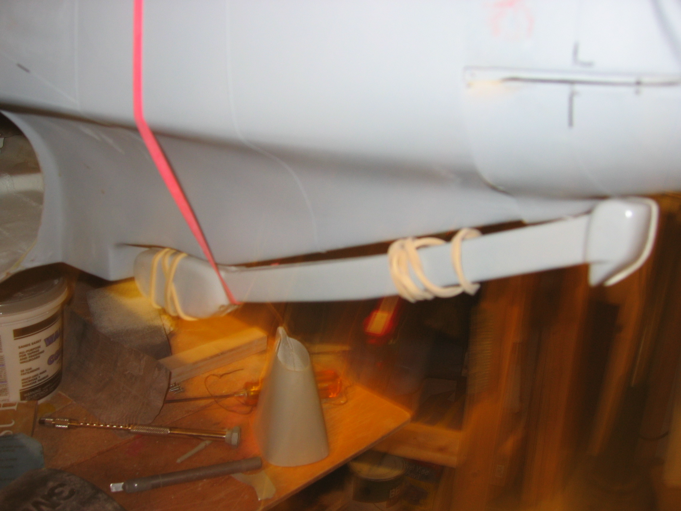

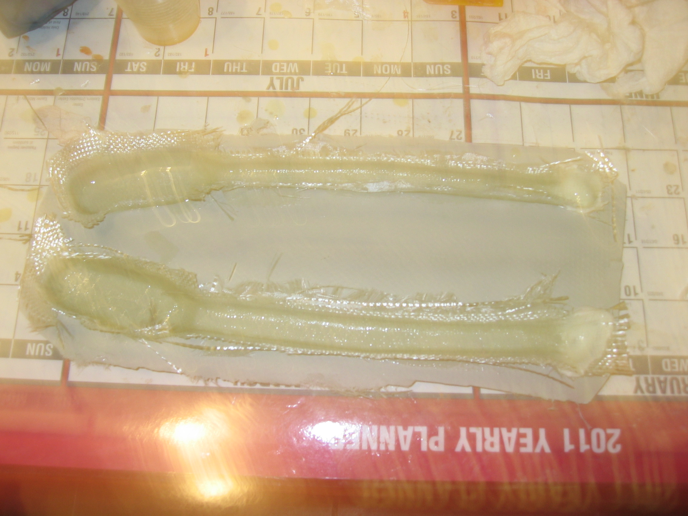

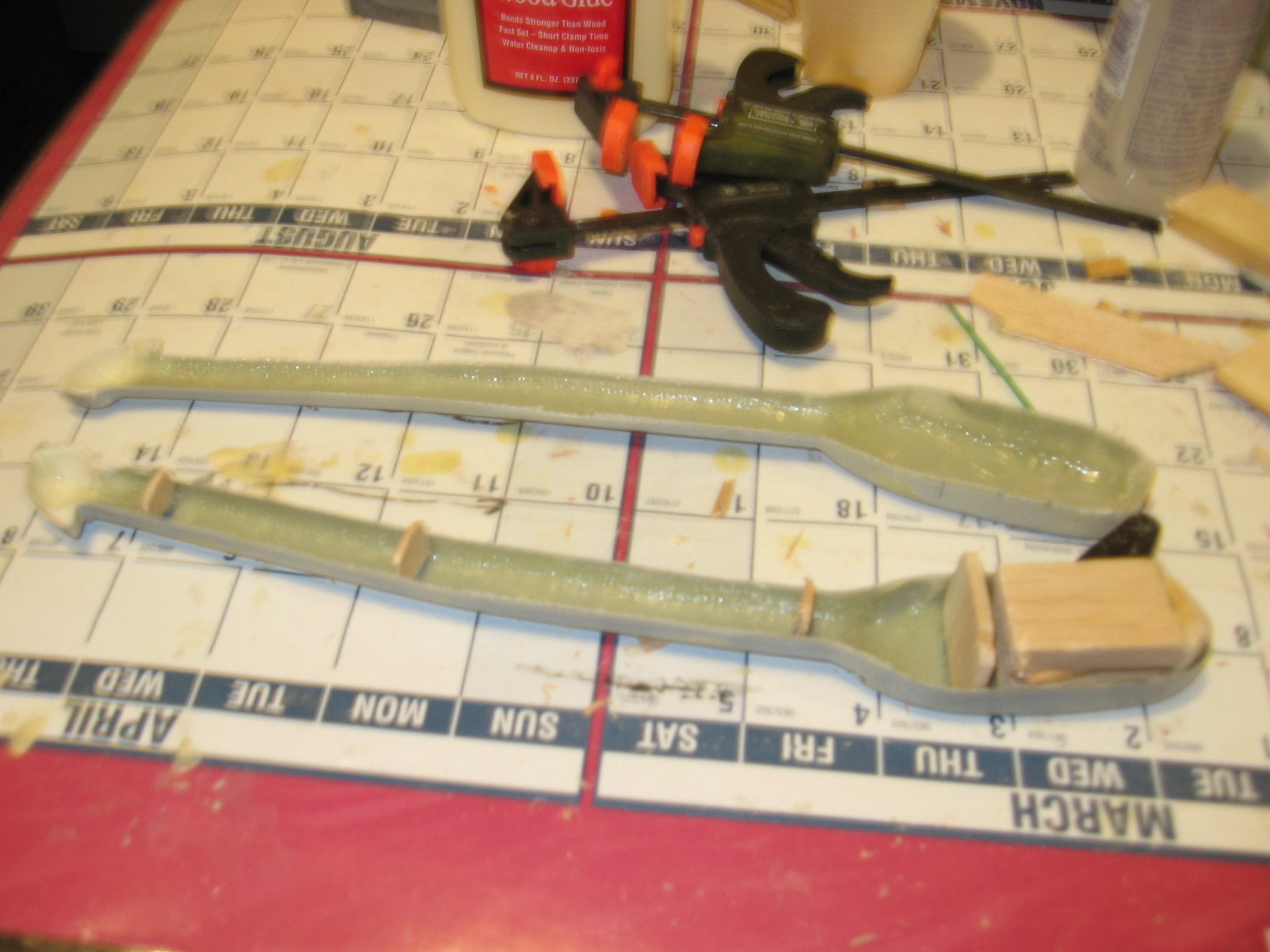

tail hook would look cool so i made molds from the ABS part
