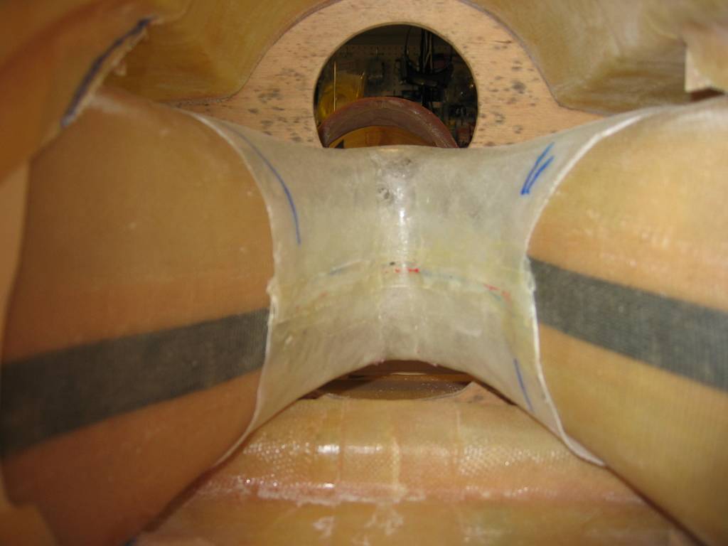

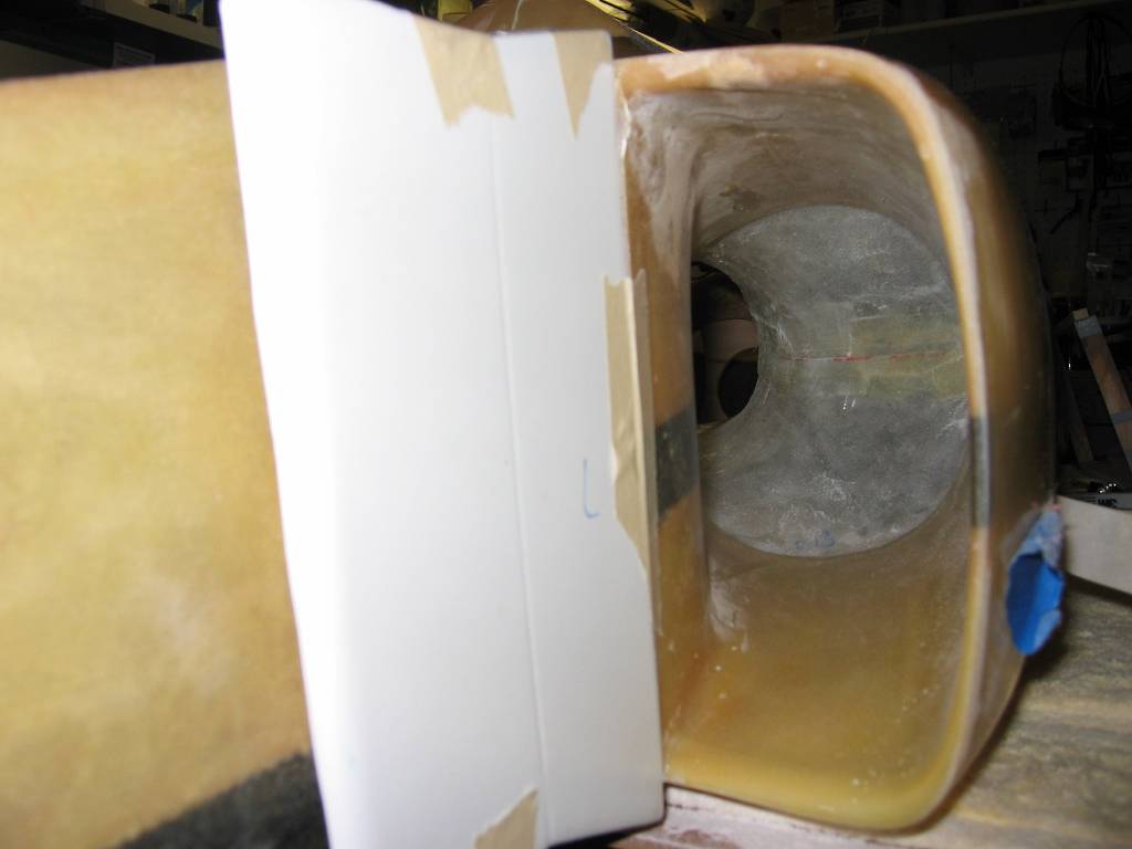

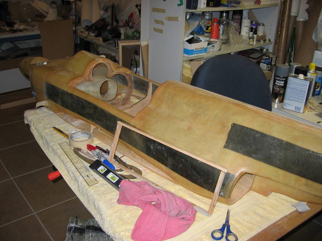

Ok, next I had to cut the thrust tube to size and reconfigure for single turbine intake. The good old pink foam comes handy. cheap and plenty at the local HD. So I built a plug and made a mold to lay the thrust tube.

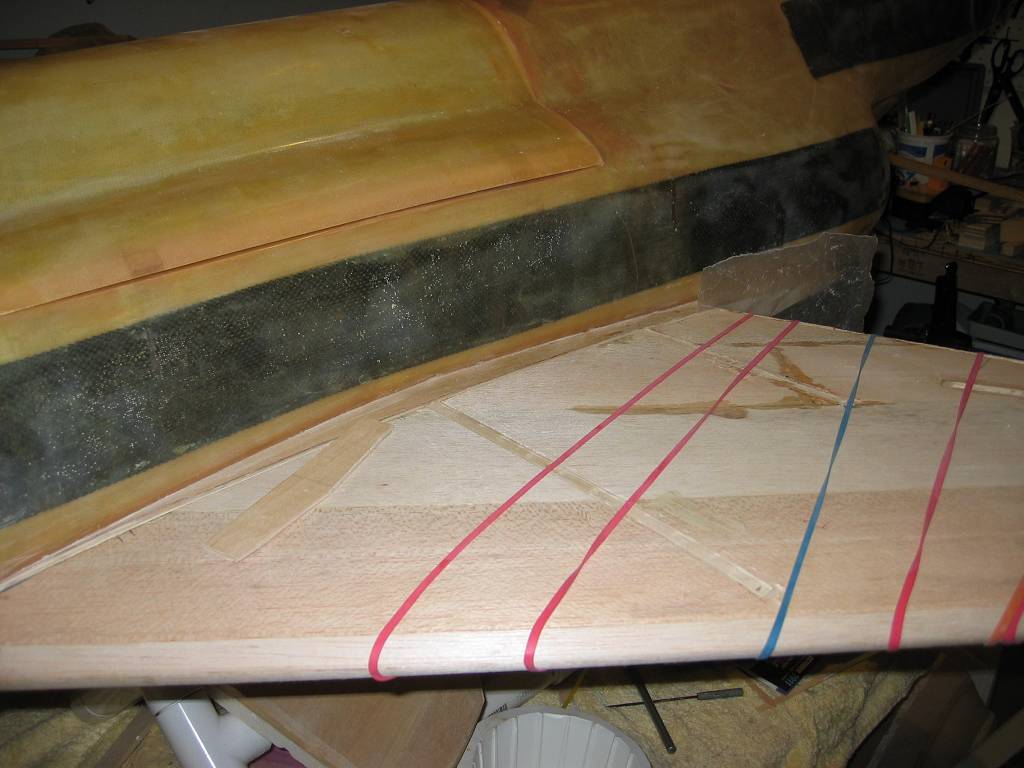

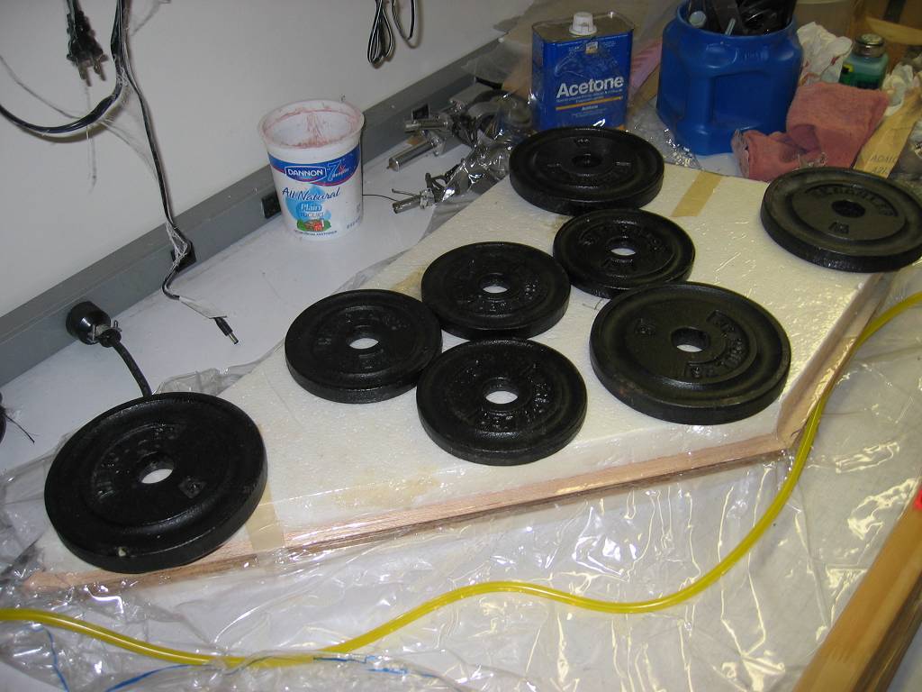

Now, it is time for putting the wing skin on using nothing but Gorilla Power, this stuff really works, the only problem was that the bottle would dry up after a couple of times till someone here on RCU had a genius idea to store the bottle upside down so the top portion of the glue (bottom side) would dry but the top would stay fresh and usable.... Thankyou whoever you were.
I wet both surfaces and applied the glue to both side and then pulled vacuum about 18 In Hg. worked like a charm.

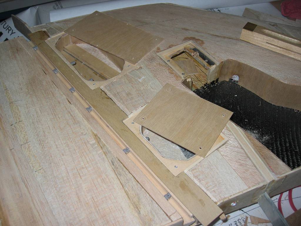

I marked the Pylon screw holes and drilled for later insert installation. Now it is time for the outer wing, I put a bit more CF to avoid any deflection, call me crazy but I think that is just what the doctor ordered

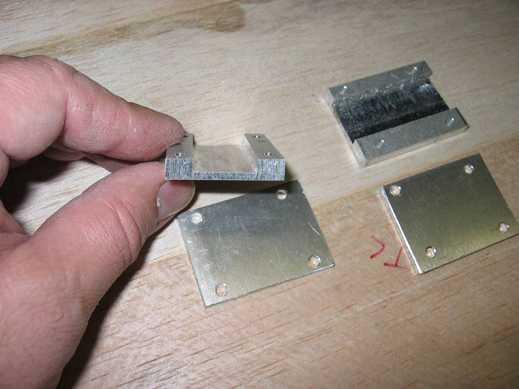

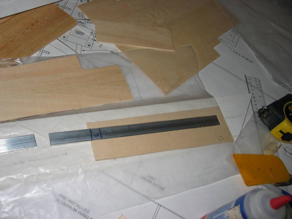

Time for machining the plug in wing parts. Used T6061 MTL and machine to fit the wing aluminum spar. No I am not a machinist as you can tell, but I know enough to be dangerous
While I was working on metal pieces, I was thinking about the SS pipes, so I made my own welding station and bought some SS sheets to attempt making my own tube, most probably I will have to order one , but we will see if I can pull it off.

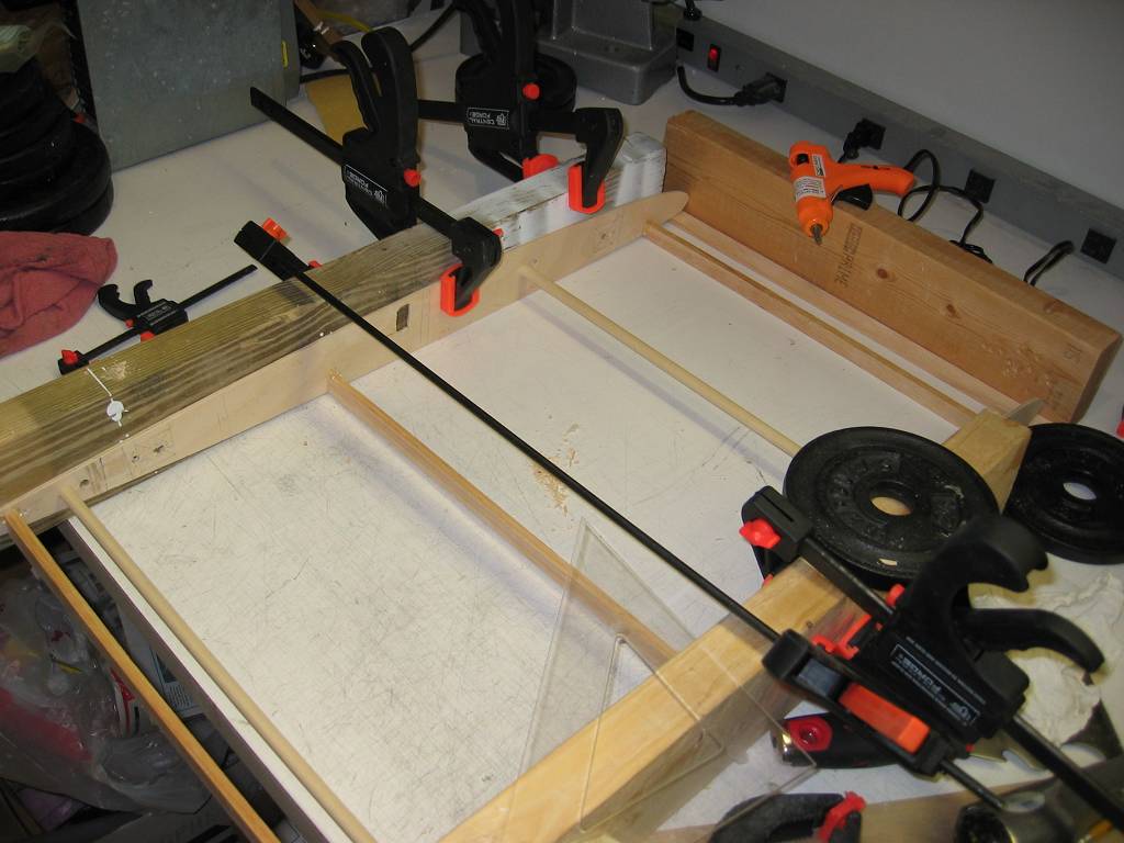

It is time for setting the wing box for the fuse. I used the plan and cut two Ribs, similar to the one on the end of the wing and squared them with respect to each other and installed it in to fuse and attached to the main formers. The main formers had to be modified a bit, added an extension to the ends to accommodate attachment to the wing box.

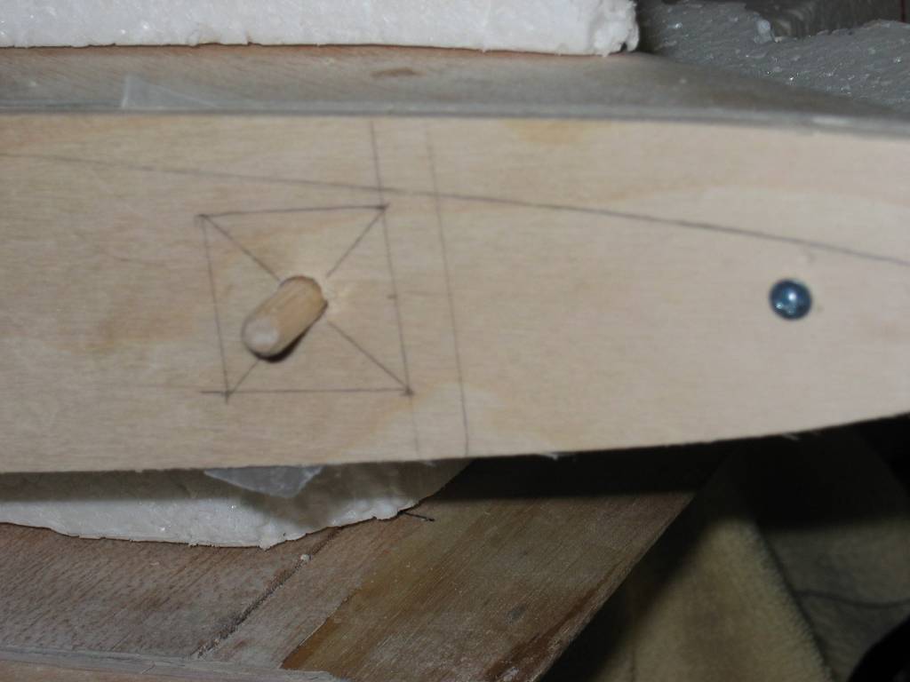

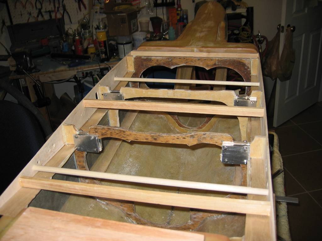

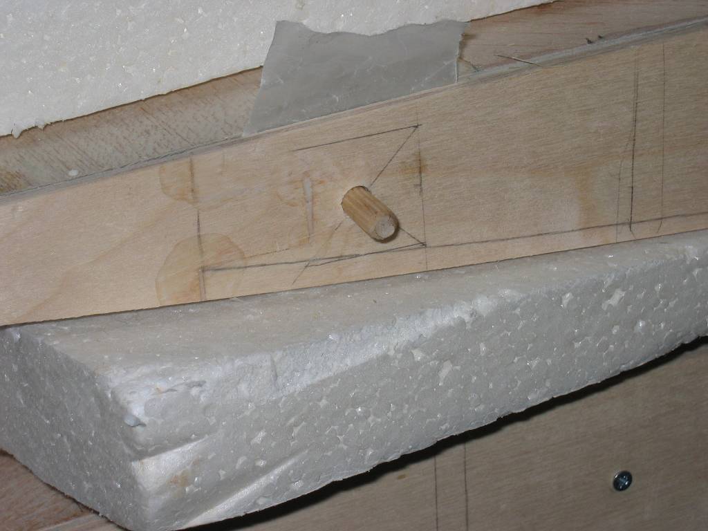

Next I capped the wings and installed two dowel rods, one on each end. I had made the same exact hole in the matching wing box rib.

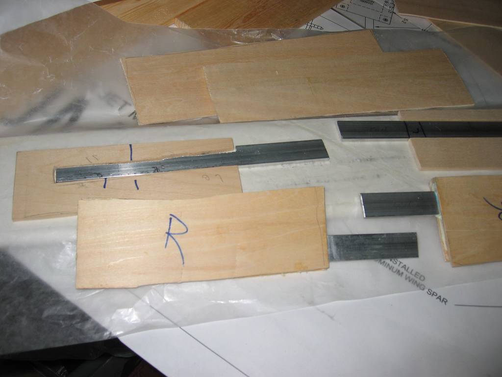

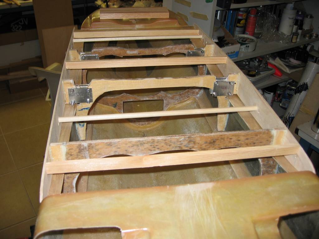

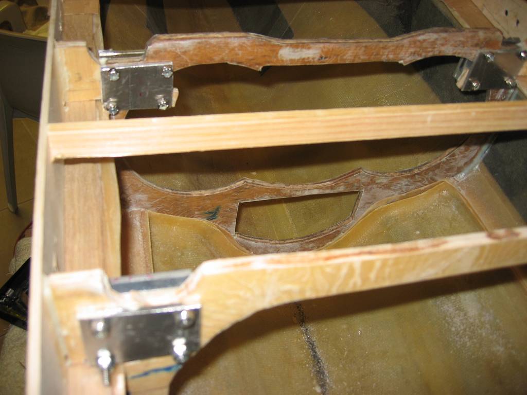

Now it is time for the wing spar receptacle installation. This was a bit tricky, the receptacles had to be in line and parallel to each other, it took awhile but I think it came out real well.

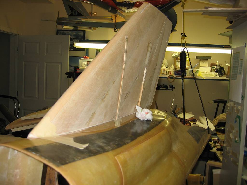

Now that the Spar box is made, I held the wing against the wing box and used the two dowel rods to line it up and marked the wing where it lined up with the spar hold downs. I them cut two slot in each wing to accept the spar box.
I turned the fuse on its side and inserted the two wing spars in to the hold downs and put slid the wing on two the wing spar box. Lined everything up, added epoxy and microballoon mixture and glued the wing to the wing spar box. repeated the same process for the other wing.

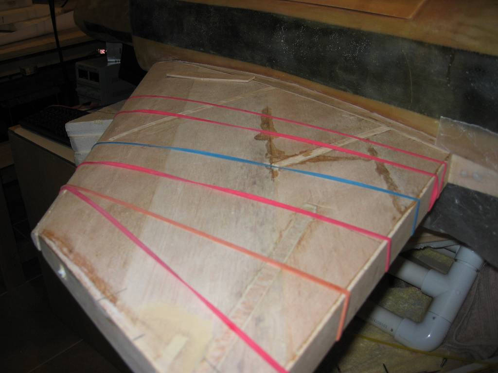

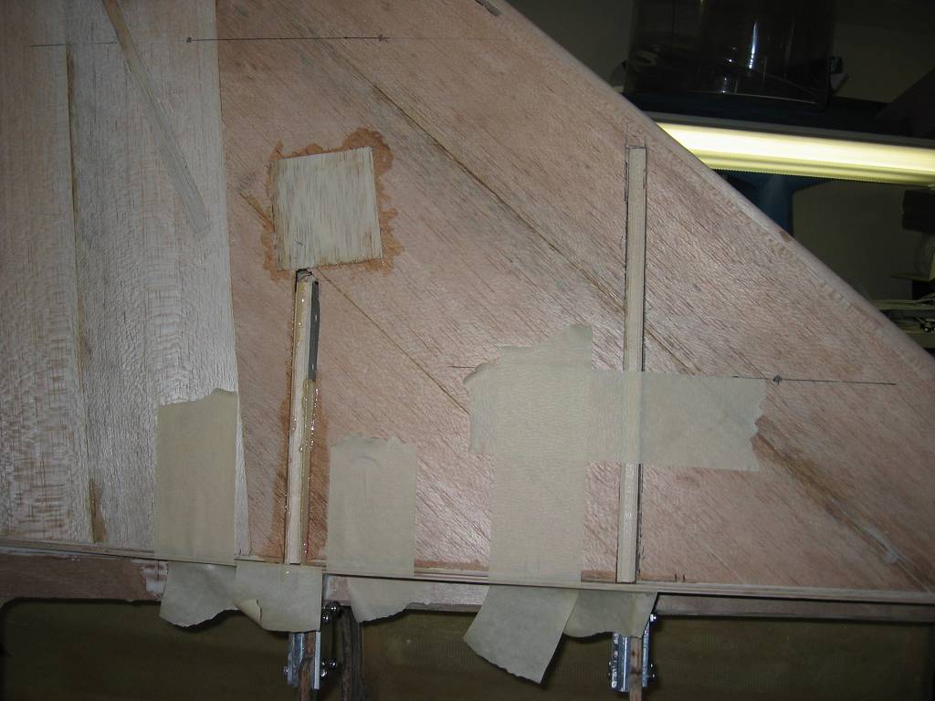

I cut the aileron/flap section of the wing and installed the 1/8 ply to cap the end of the exposed foam, a strong base for the hinges. Again, nothing but Gorilla Glue. I will leave the Aileron/Flap section in one piece till the very end. Things will line up better.

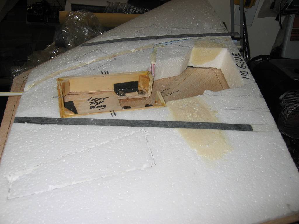

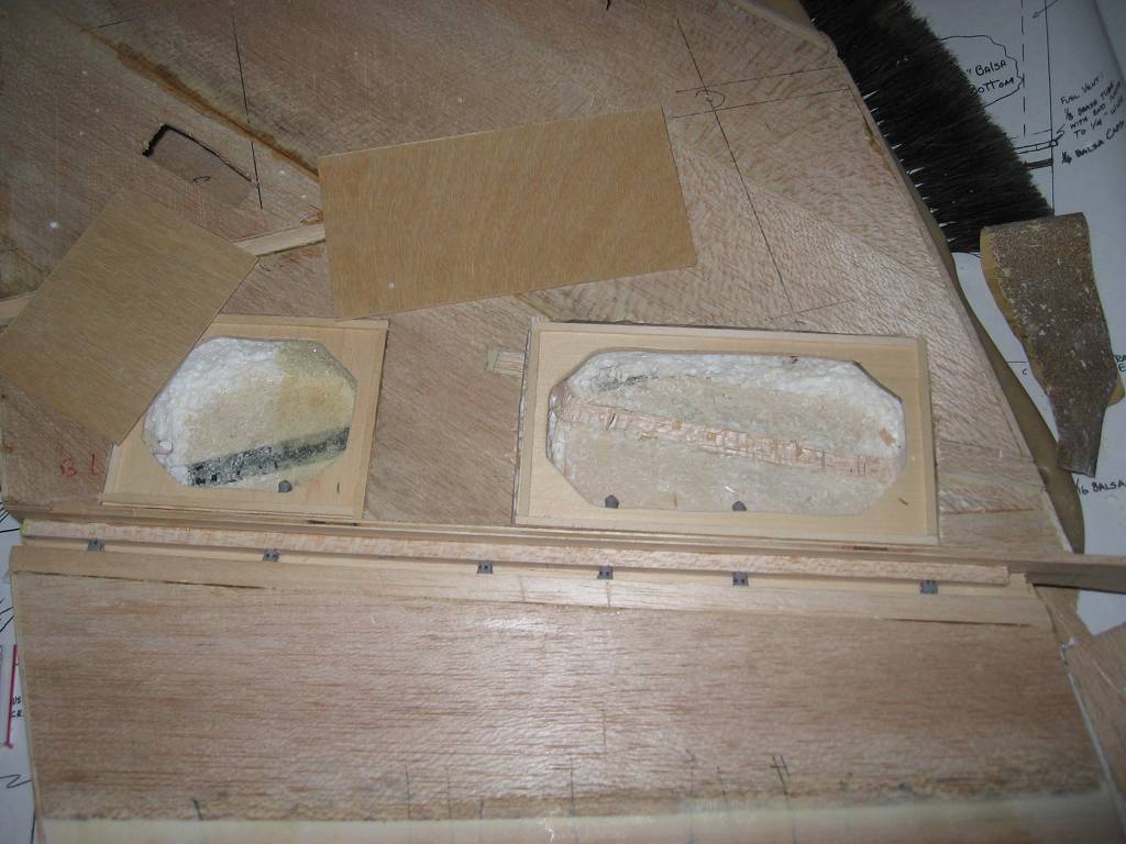

Next, it is time to cut the wing servo boxes. Again, this trick was learned on Bob Tube. I used 1/16 ply wood to build the servo cover and its box. Basically, the servo cover is built using 1/16" ply and caped with 1/16" ply pieces on top of a 1/8" ply with the center removed. I then installed the servo box cover on to the wing.

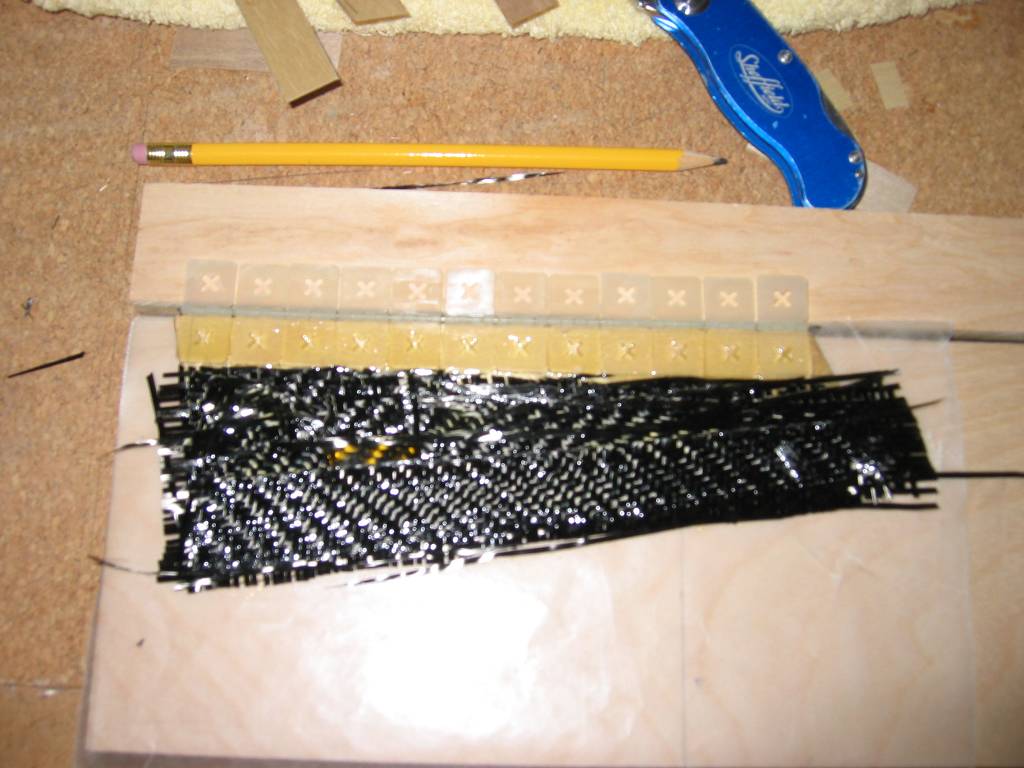

Oh, forgot about the hinges, sorry no pictures, but the wings and Flap/Ailerons are also hinged.

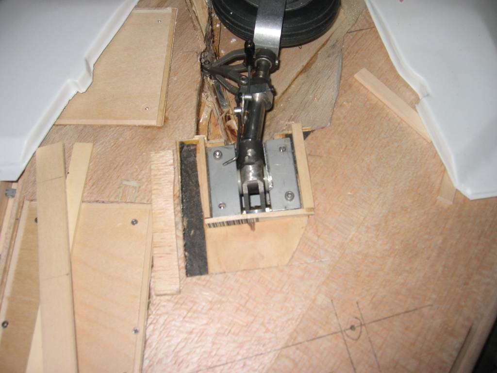

Next, I worked on setting the mains in place and building a box around the retract area for cover installation later, not sure how to do it yet, but will figure it out later. I also lined the retract well walls with 1/64 ply. The floor was decorated with a piece of CF.

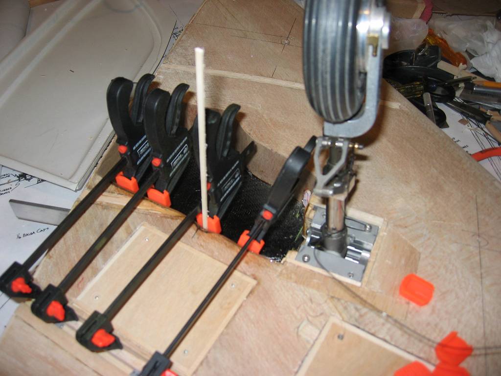

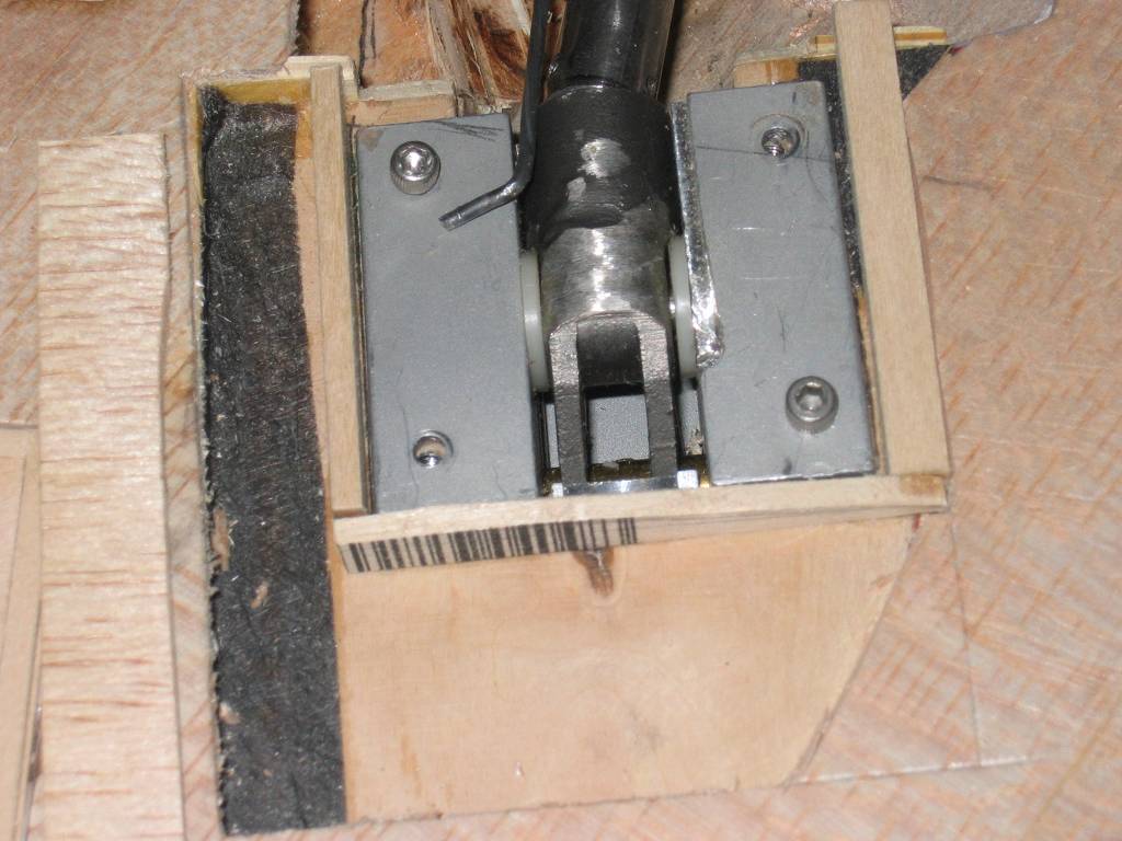

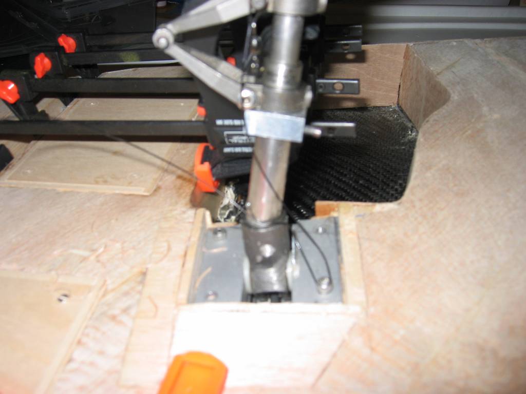

The mains do not fit inside the well, they are too long. There was a worn out mechanism to pull the mains and compress the spring as the legs were pulled in, but I think it was too cumbersome and may not let me install the wheel covers. So i used a 30Lb test fishing line leader to pull on the assembly as in is pulled in. I will have to test it later but so far it works. The picture shows the installation.

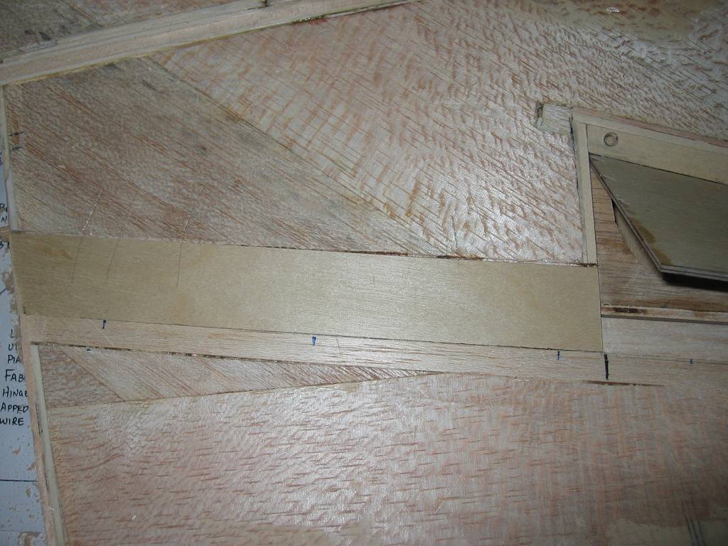

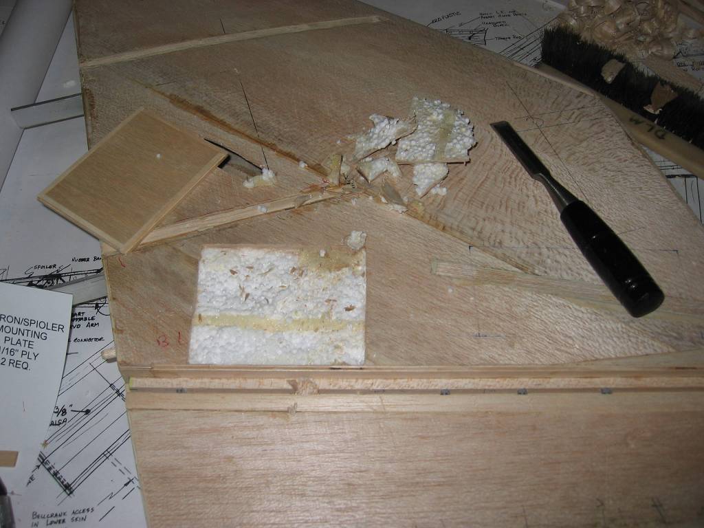

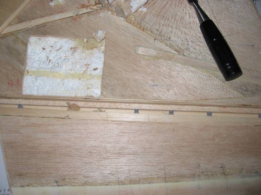

Next it is time to work on the spoilers, I cut the area per plan and removed the foam. The spoiler itself is made per plan using, ply woods, Carbon fiber and the plastic hinges. To begin with, I did not think it will be sturdy enough, but man o man it is pretty strong and no deflection.....

From: Woodstock, GA
Default RE: CJM F-4D Conversion and Build
Next, I installed the 1/32 ply covers on top and bottom per plan.

Next , I filled the holes and uneven surface with Hobbico's Hobbylite Filler, the stuff is pretty good and dries in 15 minutes. I also dry fit the outboard wing, that is going to bit hard to line up and epoxy in place, I will have to figure a way to do this and make sure it stays put during epoxy cure.

If anyone has a good idea as to how to attach the outboard wing to the main wing and maitain the correct washout, please chime in. The only way I can figure it is to lineup the front end and the back end and then sand/fill once the epoxy is cured.
Old 12-17-2011 | 02:20 PM
Carbon-Customs's Avatar
Joined: Sep 2004
Posts: 500
From: DENMARK
great jet your building, i dont understand your question about the outer wing part, cant you just place in on a table and messure the height?
PS. why does no one reply to these special threads, but are a person putting together another ARF and mounting servos, then people are replying wildly?
