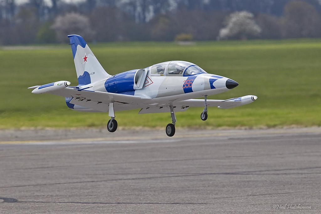

Hi Marc,
I won't say I'm a dab hand but I have successfully set up this system on my L39.
It can be quite daunting at first and requires that the instructions are read through multiple times before it all actually sinks in.
It may be easier to ask what exactly you have done to set them up at this stage.
I have nav and strobes switched on my side slider switch, off, nav at centre then nav and strobes on full movement. Landing lights are y'd into my powerbox flap channel and switch on automatically on take off or full flap and are off with no flaps. This way there is less to think about when setting up for landing.
Don't even think about connecting the lights to the board until you have the correct programming set up using the throttle channel,
