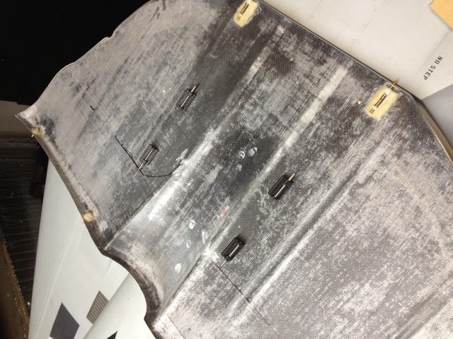

Old 06-21-2013 | 08:32 AM
  #151
Joined: Oct 2004
Posts: 334
From: Durham, NC
Default RE: Redesign/build FEJ

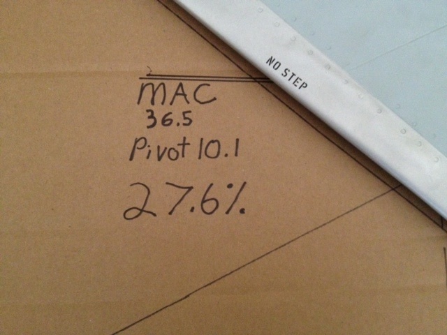

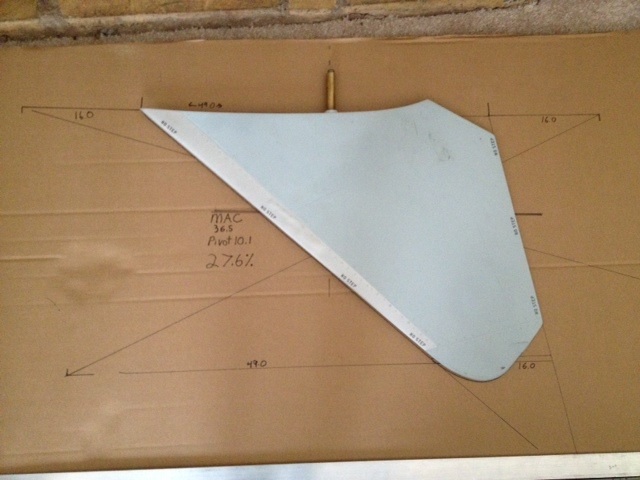

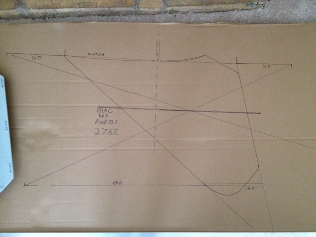

F-14 1/7 not that I need to say it but CAUTION ... MAC of pre honeycomb F-14 stab is 27.6% so glad my top speed was only 110-120mph as electric or I would have lost the plane.
ID:	1893821   Click image for larger version
ID:	1893822   Click image for larger version

So let me get this straight...the earlier versions of the FEJ F-14 had the pivot at 27.6% and when they moved it forward they went to 24%
Old 06-21-2013 | 11:39 AM
  #155
Joined: Oct 2004
Posts: 334
From: Durham, NC

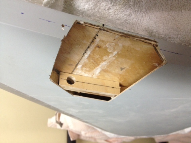

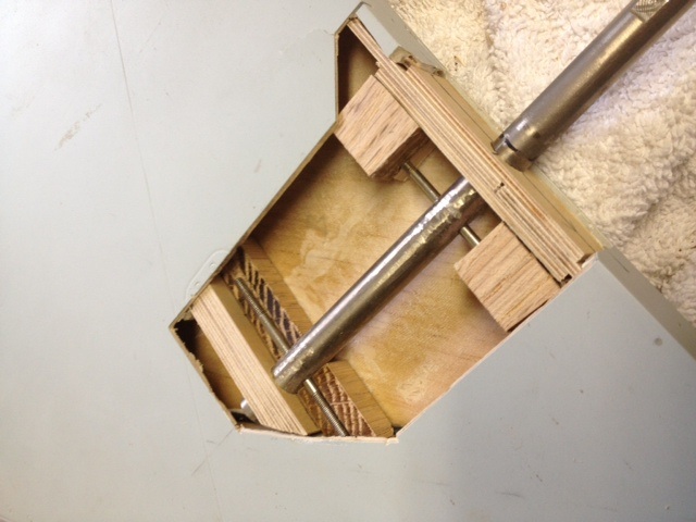

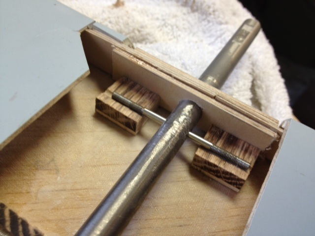

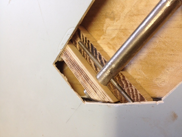

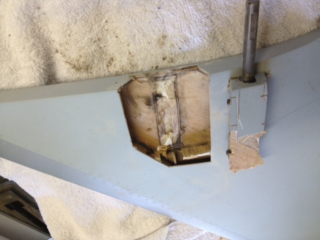

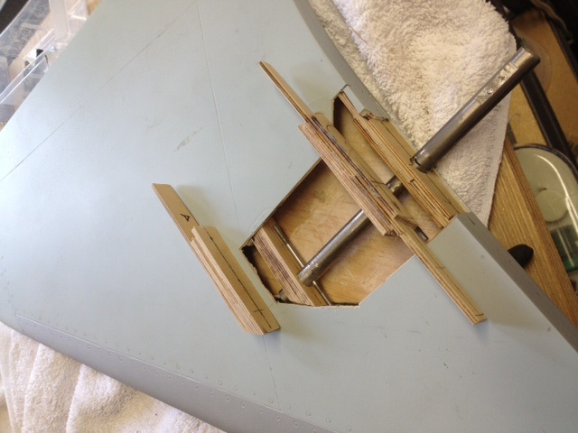

To get too 23% MAC the shaft needs to be moved forward 1/2" .. Or add 2.2" to the trailing edge to increase surface area aft of the pivot.
Old 06-21-2013 | 11:56 AM
  #156
Joined: May 2013
Posts: 68
From: Centre, AL
Better to just shift it 1/2 inch. Thanks for the info.

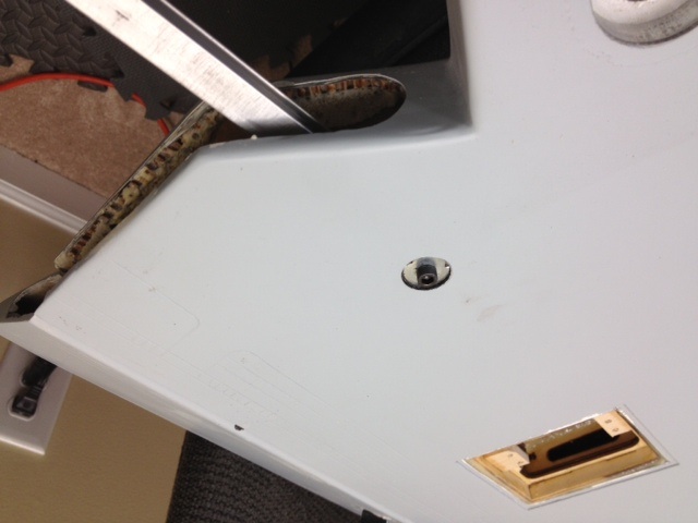

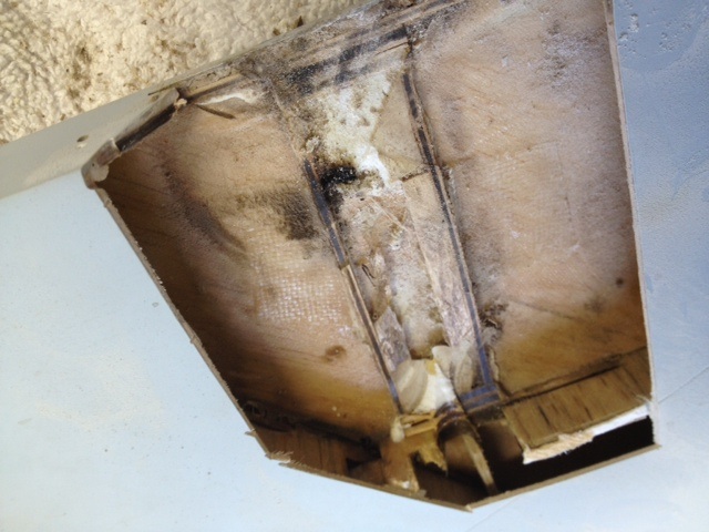

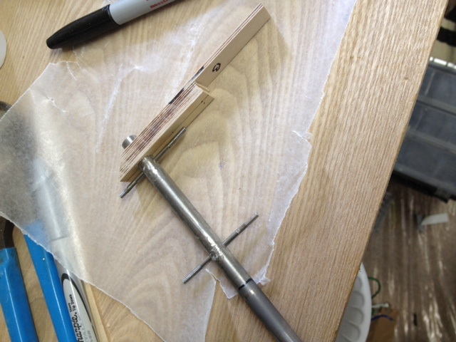

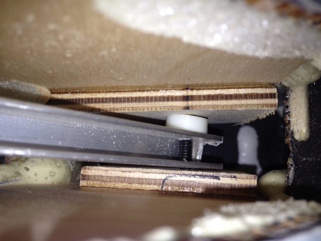

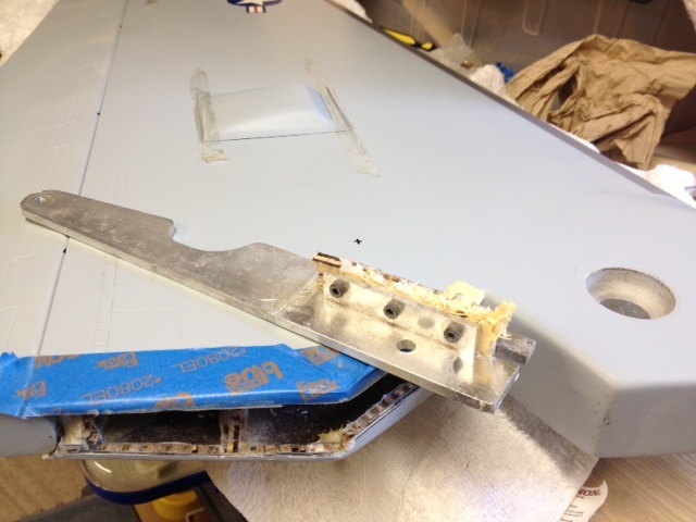

Old 06-25-2013 | 06:28 PM
  #157
Joined: Oct 2004
Posts: 334
From: Durham, NC

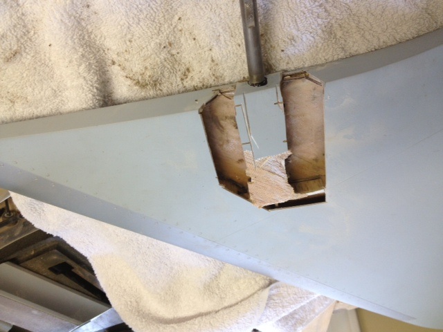

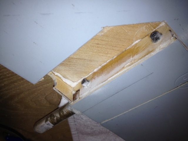

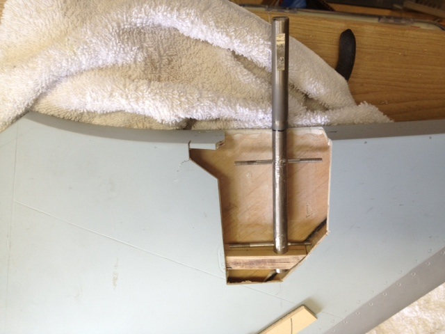

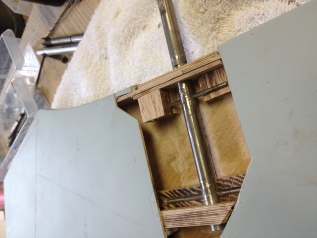

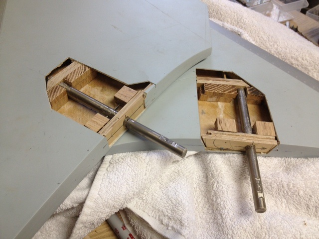

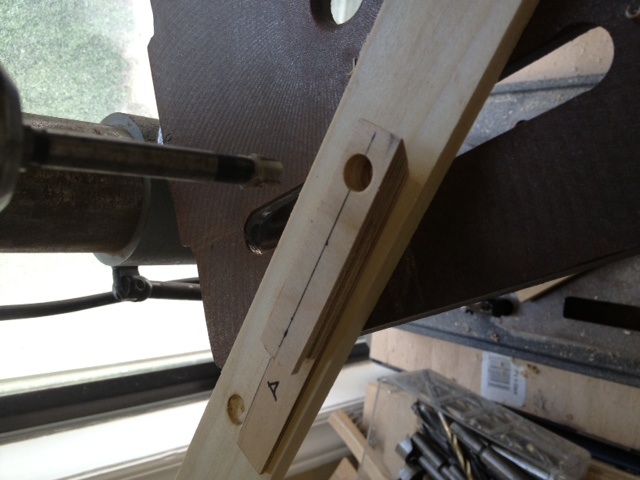

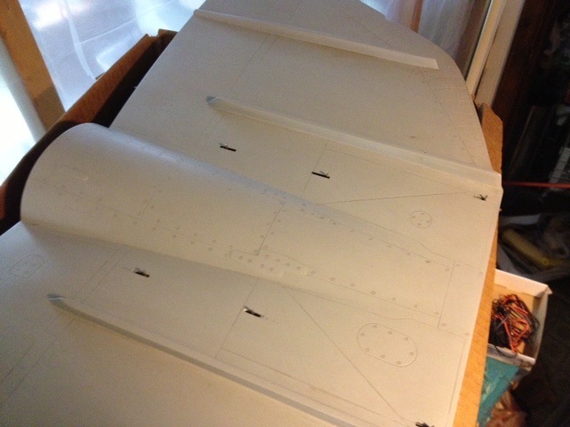

Never thought it would be so so so much work... I will not buy another FEJ ... Anyway moving the stab shafts fwd .5 inches from 27.6 MAC that they designed to 23% MAC where it should be.

Old 06-25-2013 | 07:53 PM
  #159
Joined: May 2013
Posts: 68
From: Centre, AL
That blows, I know someone who has one of these and he requested FEJ build him a new set with ply inside instead of the honeycomb and James response was not professional.  I hope all your hard work pays off.
Old 06-25-2013 | 08:04 PM
  #160
mr_matt's Avatar
My Feedback: (10)
Posts: 10,450
Received 13 Likes on 11 Posts
From: Oak Park, CA,
Great modeling. Are you going to have to move the bulkheads too in order to match the curvature of the stab root (or does it not matter)?
Old 06-25-2013 | 09:07 PM
  #161
Joined: Oct 2004
Posts: 334
From: Durham, NC
1/2 inch will not show much on the curve of the stabs

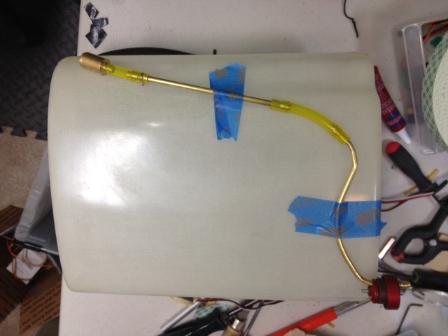

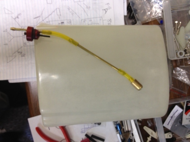

F-18F main fuel tank pickup

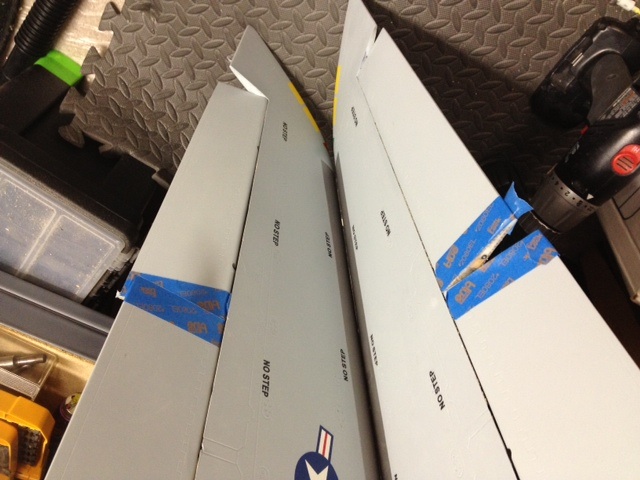

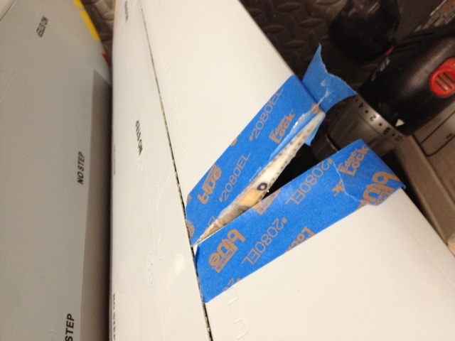

F-14 wing swing

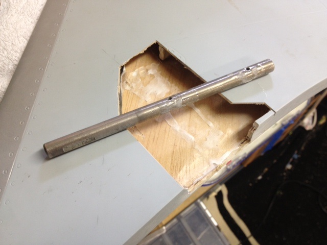

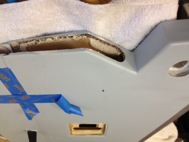

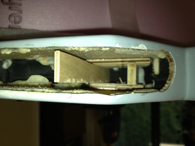

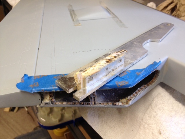

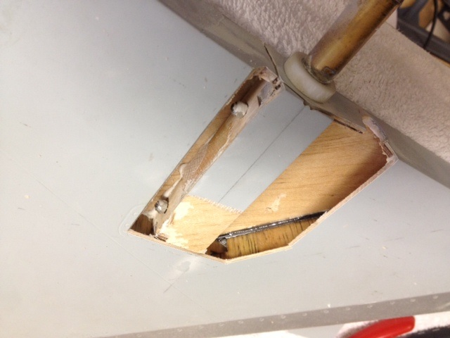

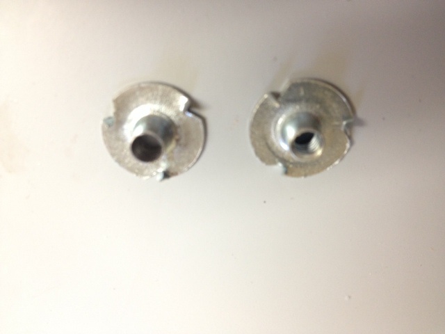

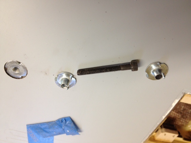

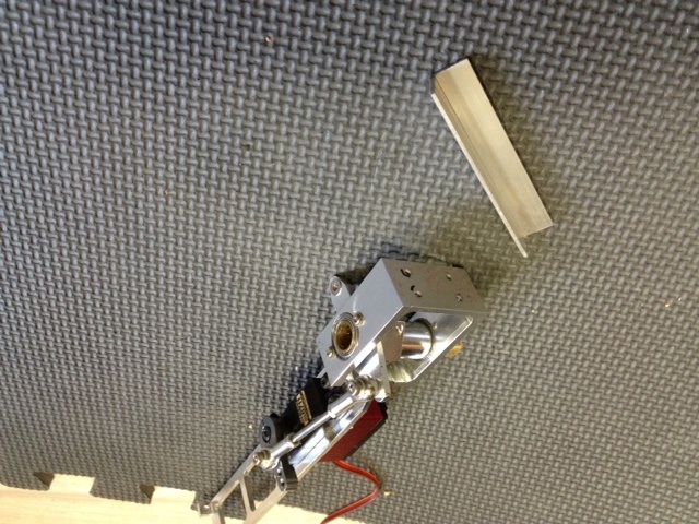

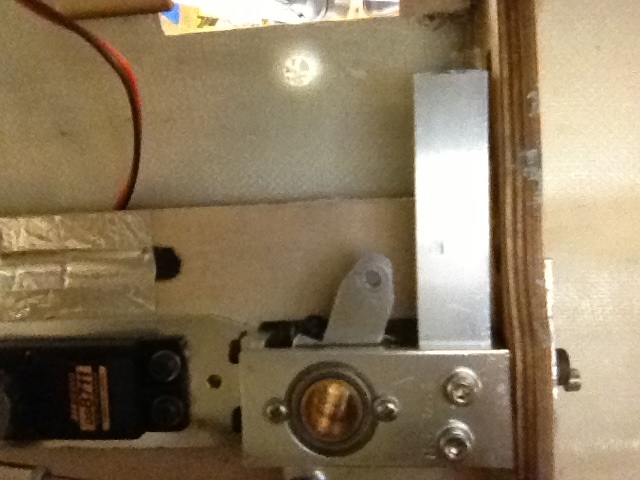

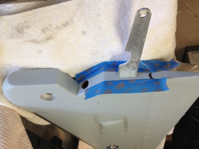

Stab fixes
ID:	1897420   Click image for larger version
ID:	1897421   Click image for larger version
ID:	1897422   Click image for larger version
ID:	1897423   Click image for larger version
ID:	1897424   Click image for larger version
ID:	1897425   Click image for larger version
ID:	1897426   Click image for larger version
ID:	1897428   Click image for larger version
ID:	1897429   Click image for larger version
ID:	1897430   Click image for larger version

Using flaps and ailerons for the F-14 .
ID:	1897434   Click image for larger version

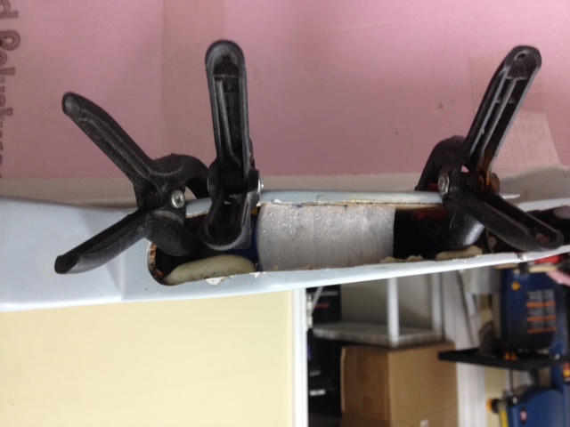

Still unpacking and resting from a great JOK and the successful failure that it was. Wanted to get this out right away though. My single engine skills are all dialed in and one thing that any F-14 should look at is the wing hatch cover. It's a huge area and I had one of the aft pins pop out of its hole on one flight with an engine failure.
Worst case is at high speed and have a dual flameout. The engines are sucking in a lot of air from the fuselage and with a flameout that suction stops and a big buildup of pressure happens under the wing hatch because of the high speed and intakes brining in a lot of air. Full bypass systems or added hatch latches or bolts are required I think.

I will be doing the hatch mod for sure, I had thought about this when I first got the model but after seeing the hatch push the latch out on flame out I would say its a highly recommended small easy mod. I was going to ask if you think adding another latch in the middle forward and back would be enough or should the latch be in the middle of the cover?

I would say at lest two .. Depends on the strength of the install.. Mine are hydrosol onto the bottom skin and one let go after only 7 flights. I think 2 bolts would work good or 4 latches if they are only glued on.

Would it help to add a couple front to back ply stiffeners? It seems to me the hatch has to bow or flex a bit in order to escape the latches. Get rid of the flex and the latches should hold better.
David S

Great idea will see what fits and how much flex there is..thanks

ORIGINAL: EDFJim
Moving the shaft 1/2" forward is not the proper fix, you need to also move the pivot bearings and bulkheads a 1/2" forward to maintain the lines of the aircraft. This is why it is not an easy fix and should be done by the factory.

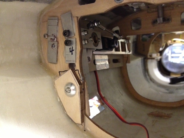

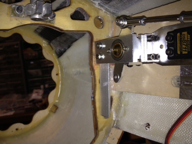

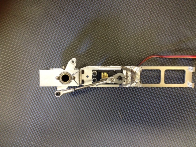

Default Stab control

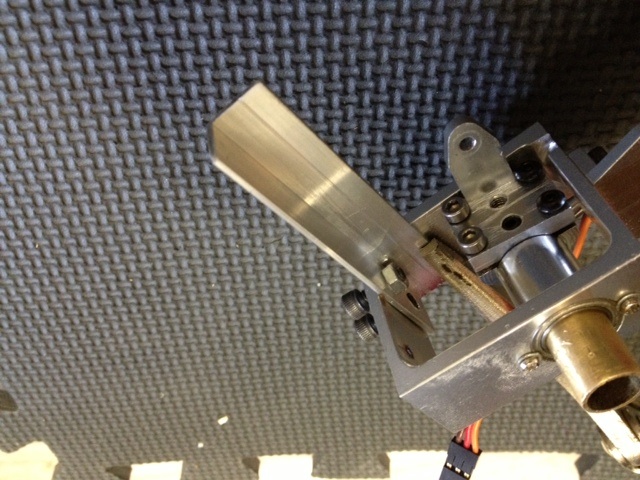

Forces on the linkage between the servo and stab arm were very high with this setup so I changed to a longer arm and small beam of aluminum. This setup has worked very well and had several good flights with perfect operation of the stabs.
