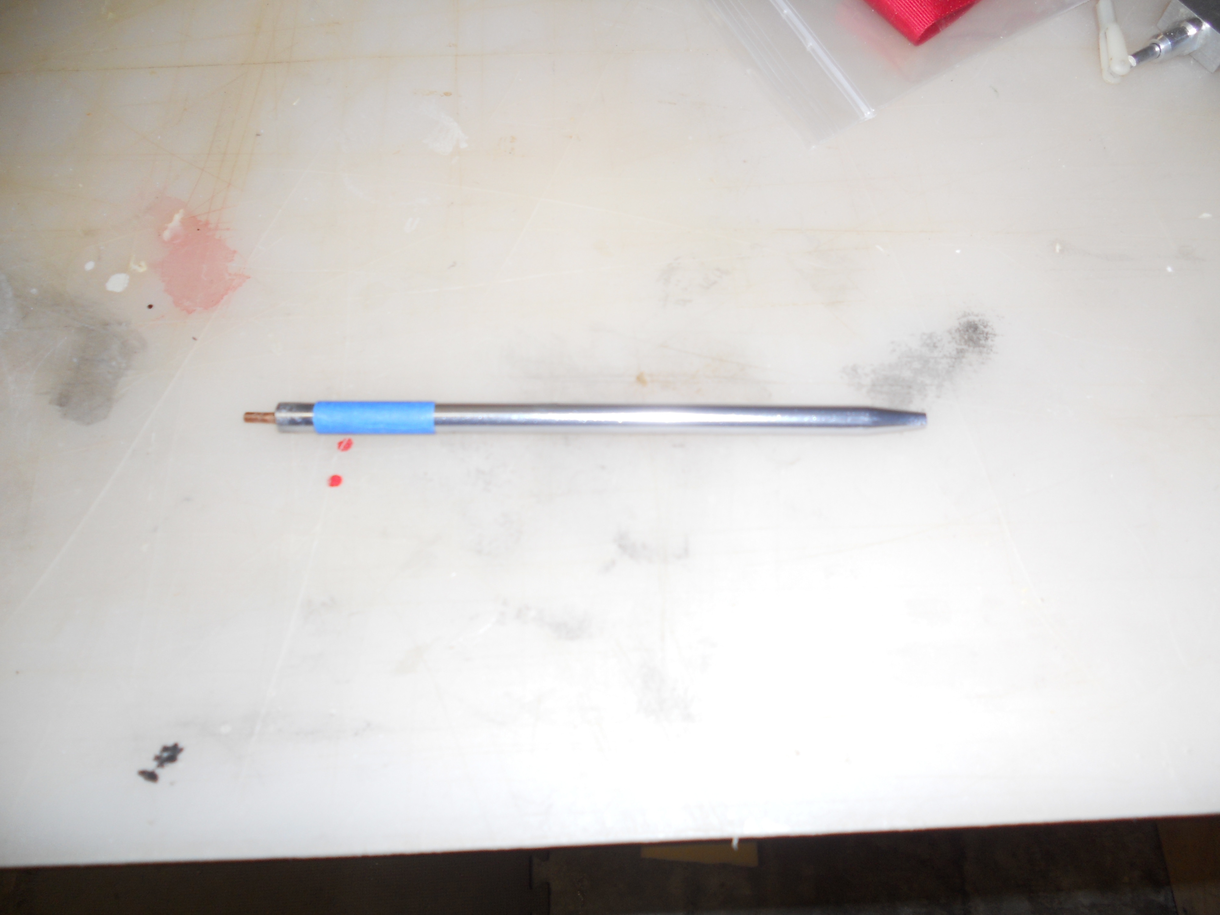

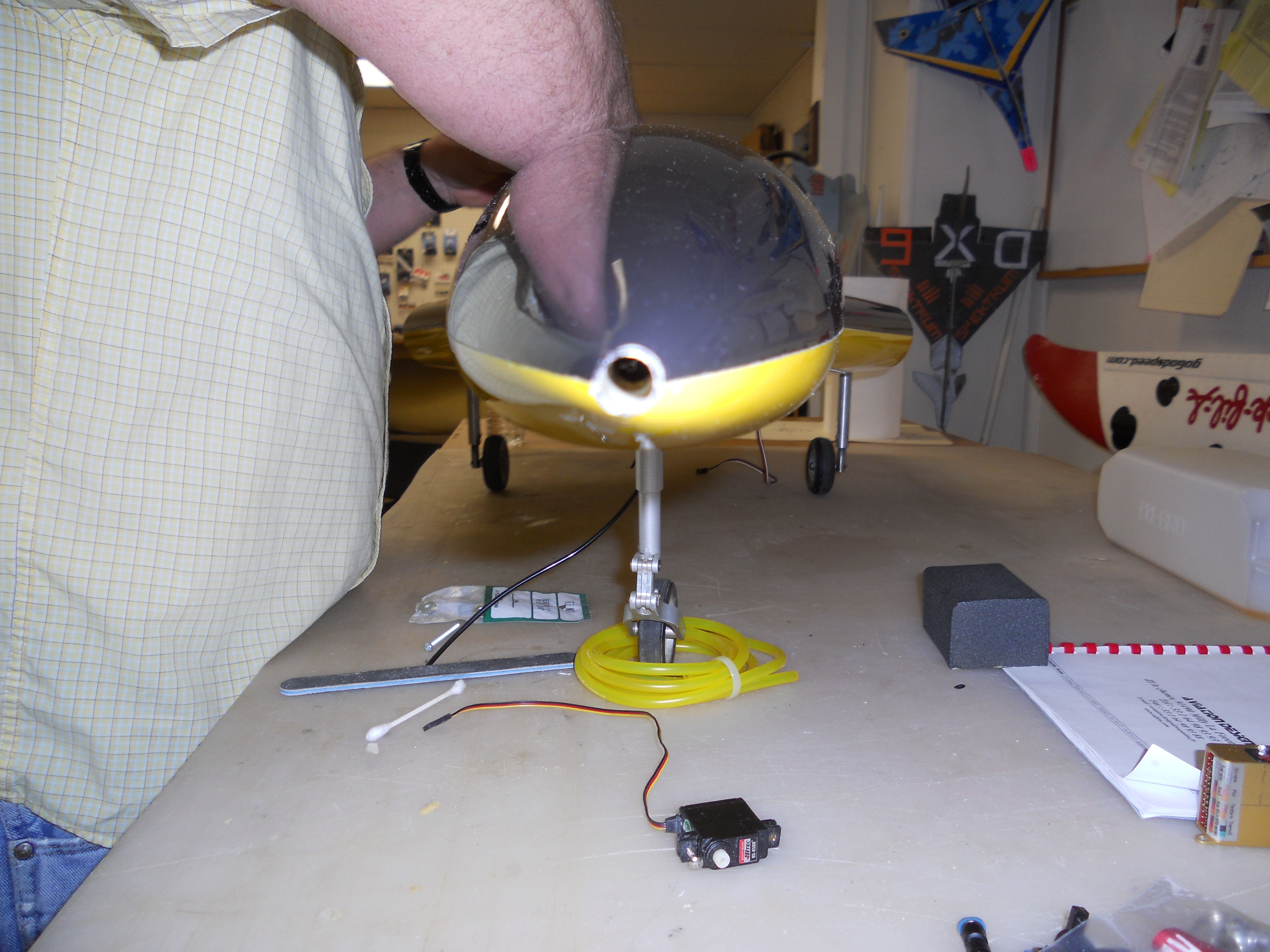

A friend of mine came up with the idea and installed it on all his jets. It is a crocheting needle bought from a craft store. They are hollow and come in different sizes. He drills a hole in the pointed end and cuts it off to the desired length. Then he drilles a hole for a brass tube a little bit bigger than the needle in the nose of the airplane and glues the brass tube into the nose. The brass tube is crimped on the inside end so the pitot tube will slide in from the front. That way it is removable for transport and replaceable in case it gets damaged. Then he solderes a smaller brass tube inside the back end of the pitot to hook the tubing to for the airspeed sensor. Then he wraps a little tape around the tube where it slides in the brass tube to make a nice snug fit and now you have a working pitot tube!

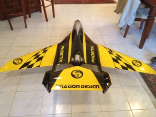

I will post some pictures of mine in few days, I am almost in the final stage, installed the original fuel tank comes from Aviation design, fits perfectly and the UAT tanks. Installed Merlin 90 kerostart and Jet1A landing gear which was on my Elan with little modication.

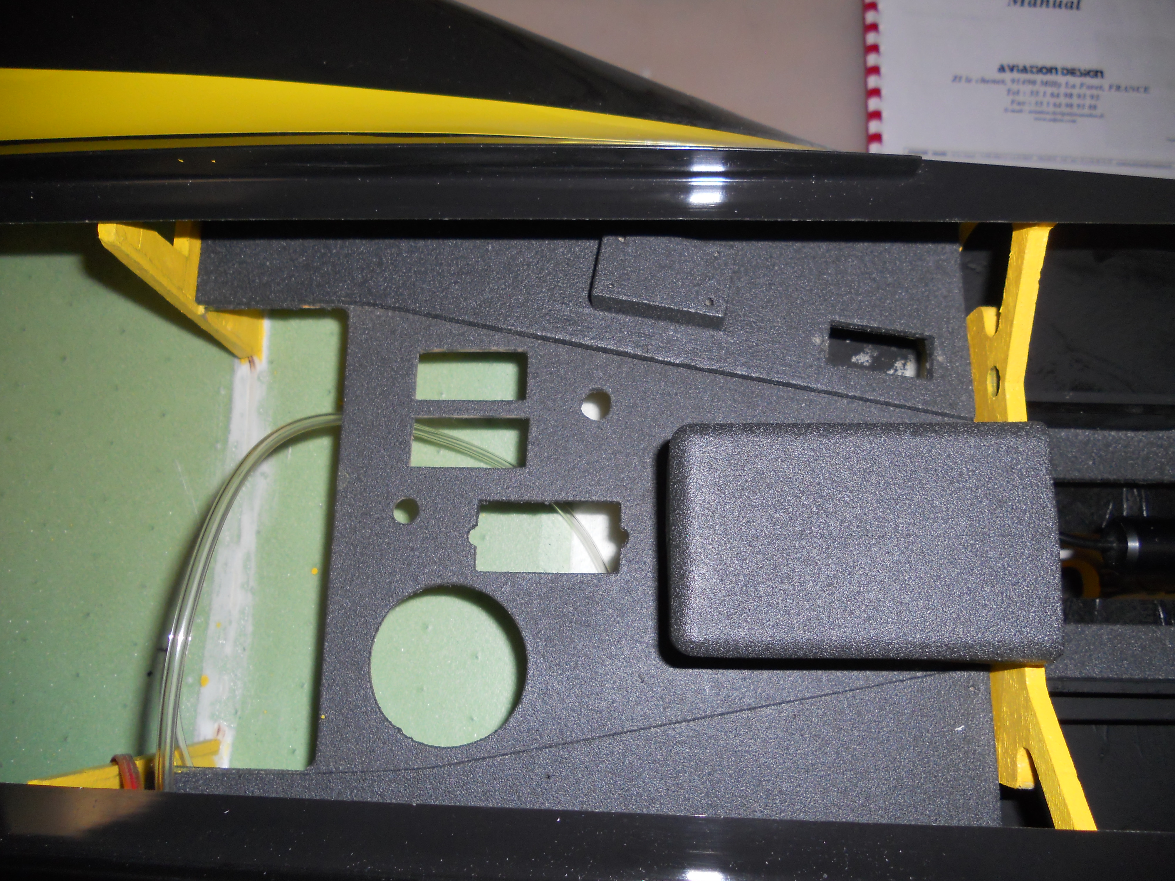

These are the pictures of the servo tray and nose mod and homemade pitot tube. We started the radio and electronics install after these were taken but I didn't get any pictures of it. Should be finishing up everything next weekend and then we will just be waiting on the struts for the retracts to arrive so we can get it ready for the maiden!

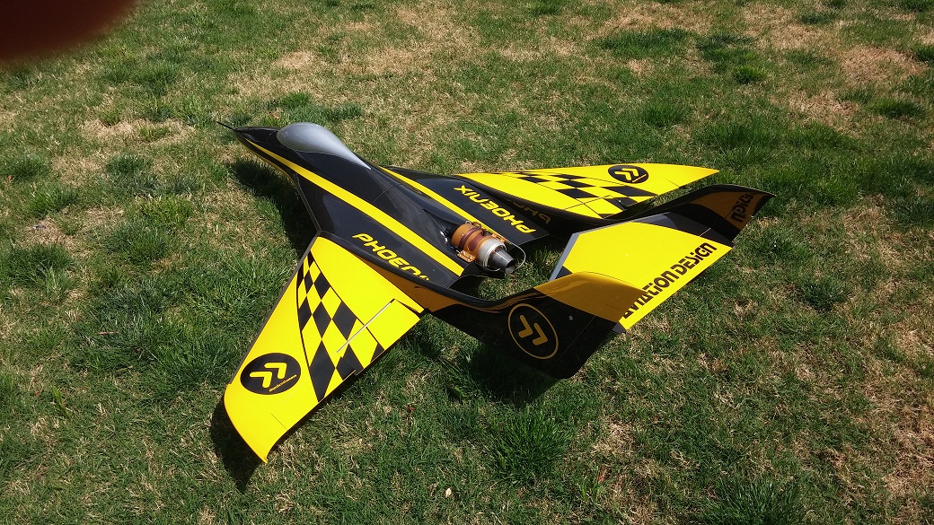

Here is my finished phoenix. One flight so far because i had a nose gear issue. Luckily the pitot tube was long enough to keep the fuse off the pavement and it didnt hurt the bottom of the airplane! One of the steering wires hung up so it didnt lock down. The airplane flew well but it sure wagged the tail! I may put a gyro on it to help that problem. Weighs 20 pounds dry with k80e for power. 100 oz. fuel and 48 oz. smoke.

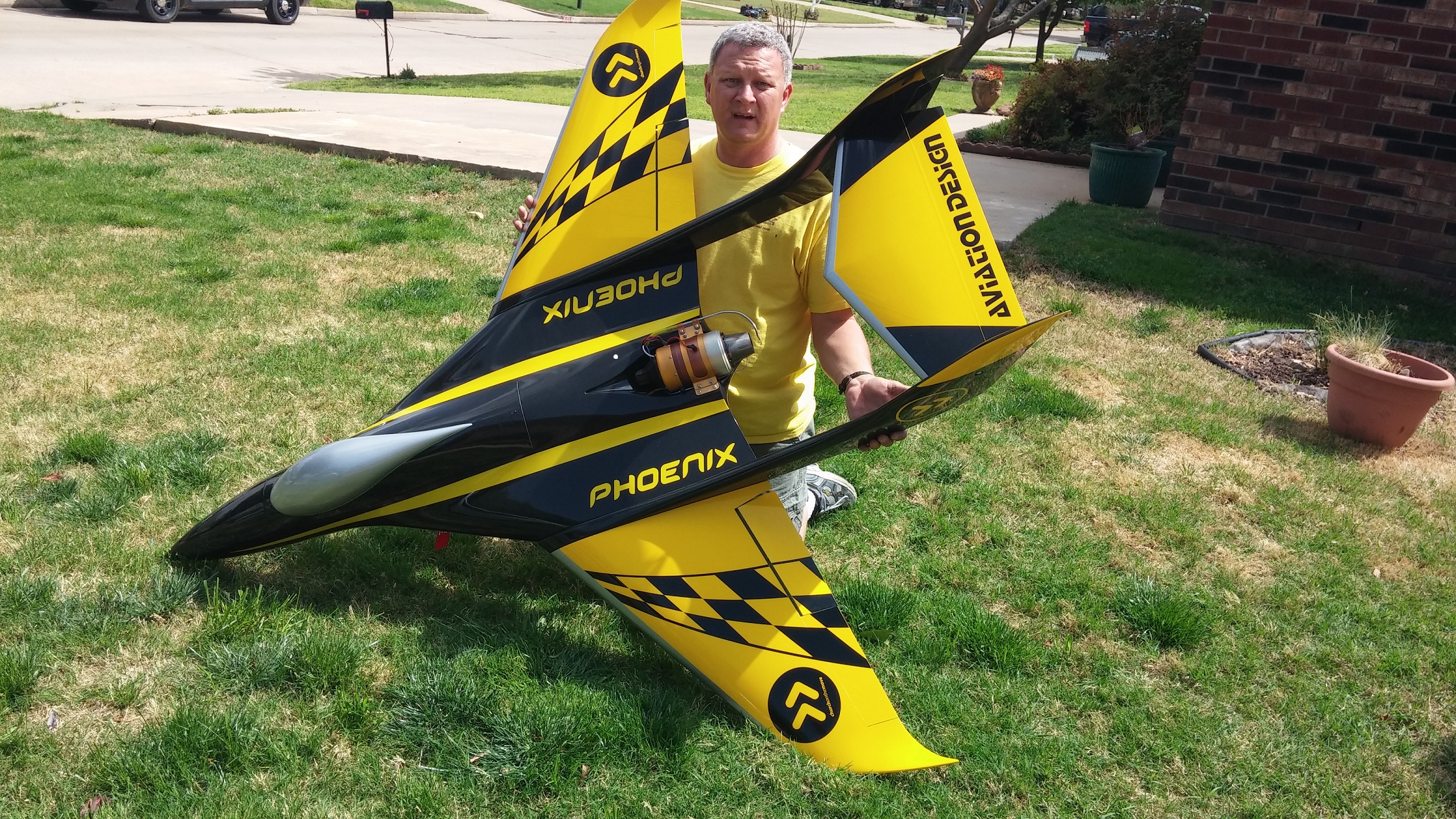

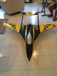

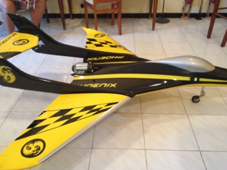

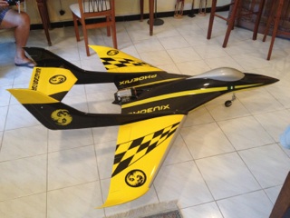

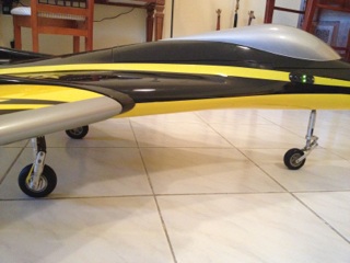

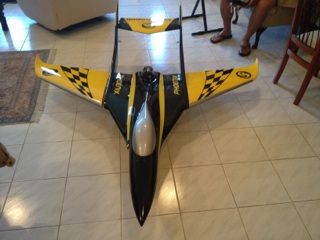

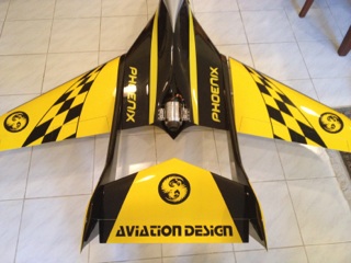

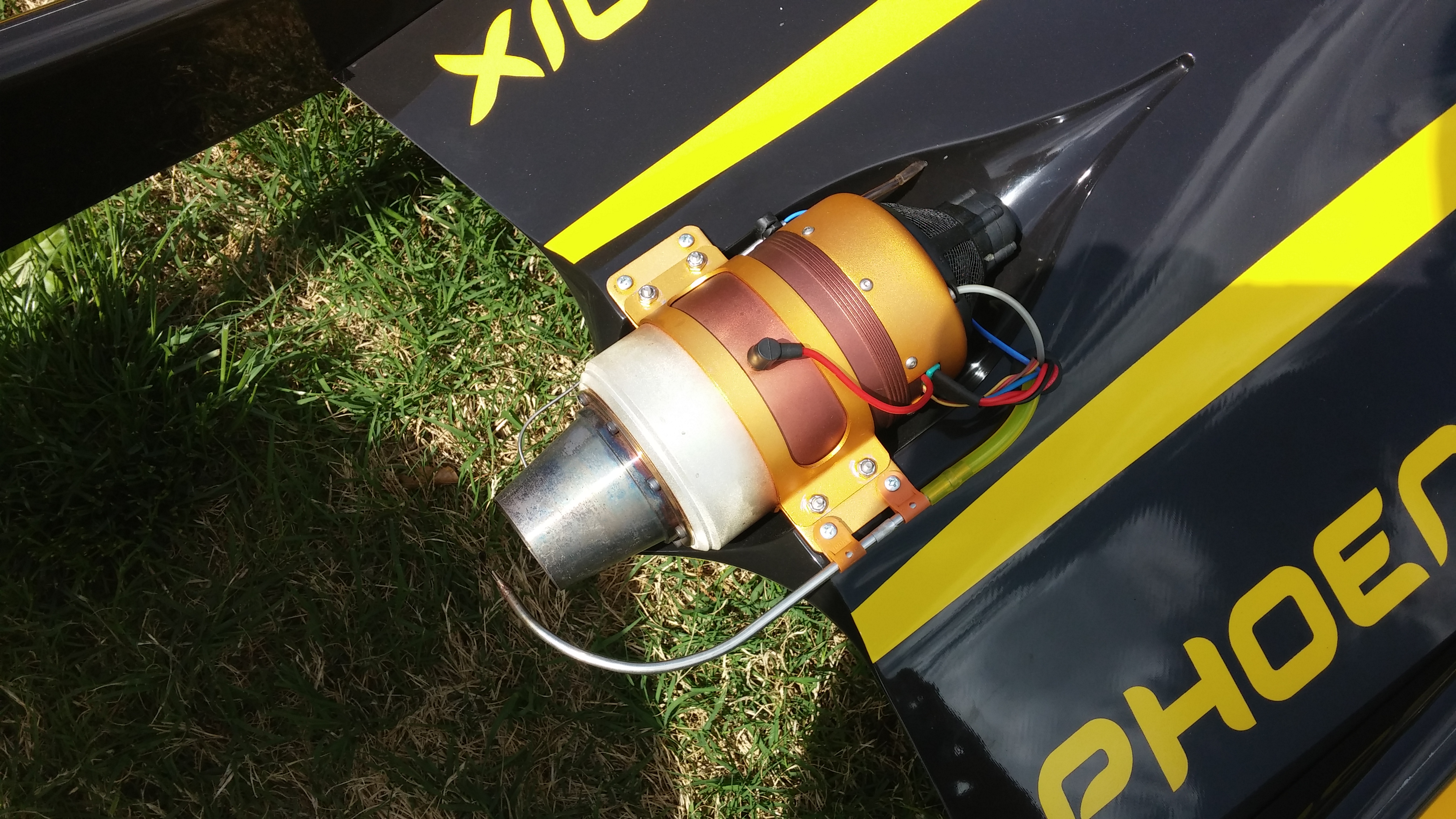

finally got it to work.
