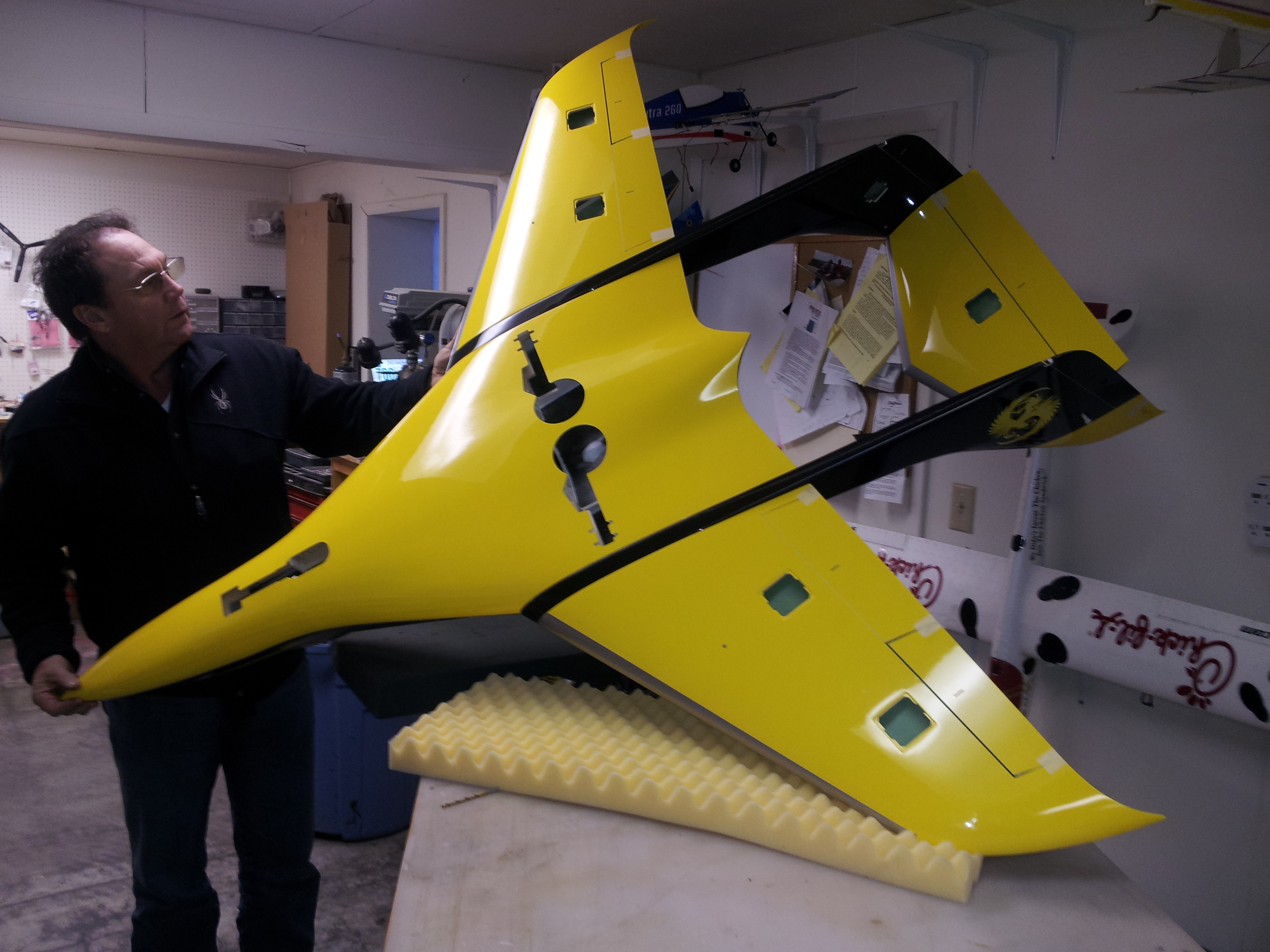

Just picked up mine from Fed-ex today. Here's a couple of unboxing pics! Looks like it got here without being damaged.
Last edited by chris1971; 01-03-2014 at 03:49 PM. Reason: tried to add pics but not working!
ID:	1955870   Click image for larger version
ID:	1955871   Click image for larger version

It really looks like the quality is awesome and boy are the parts light!

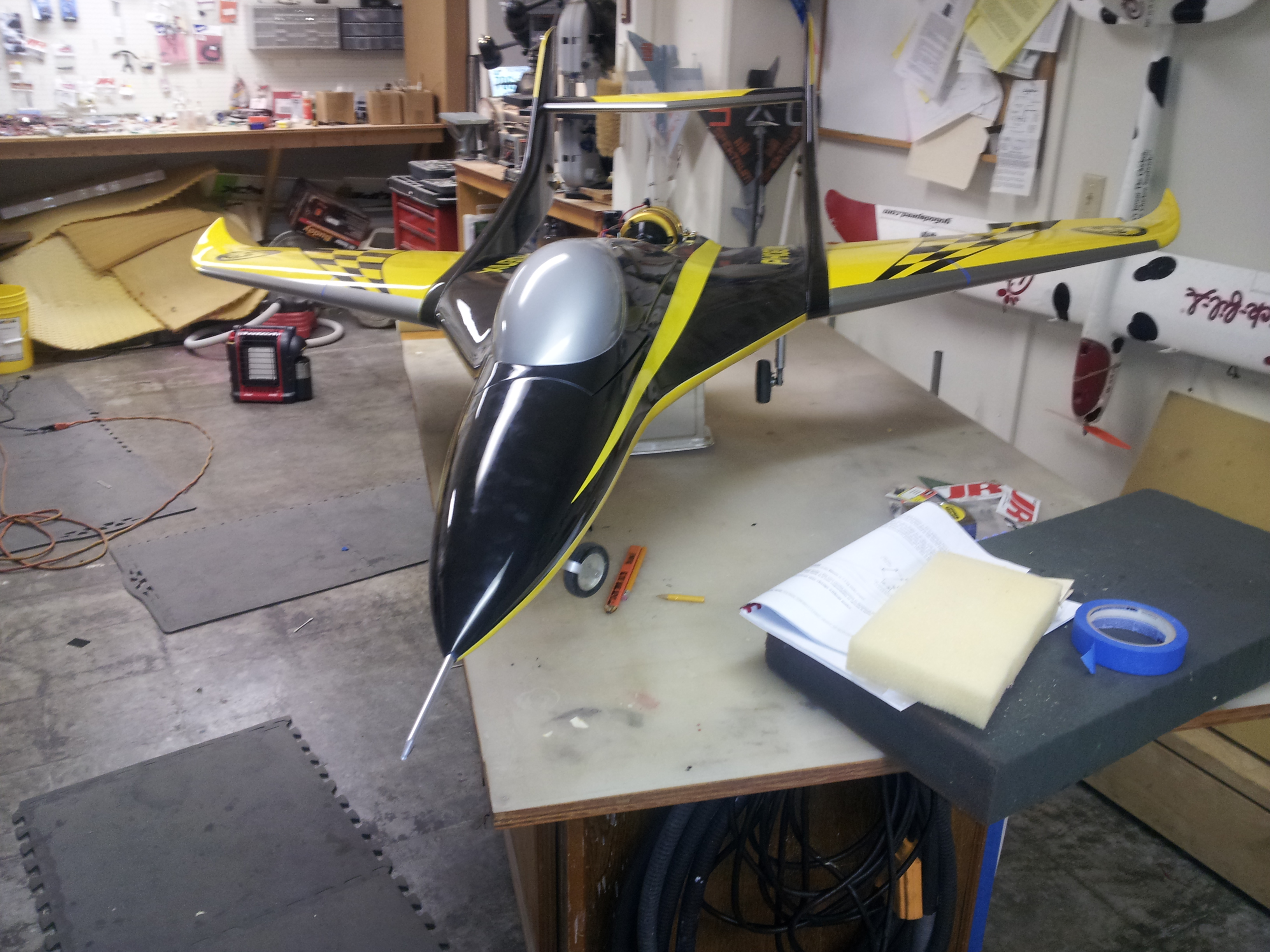

Some pictures of mine from this past weekend. Getting things wrapped up and hopefully going to maiden it soon!

Real working pitot tube hooked into spektrum telemetry! My friend modified the nose to install it.
Nice Chris!
Good luck with the maiden!
