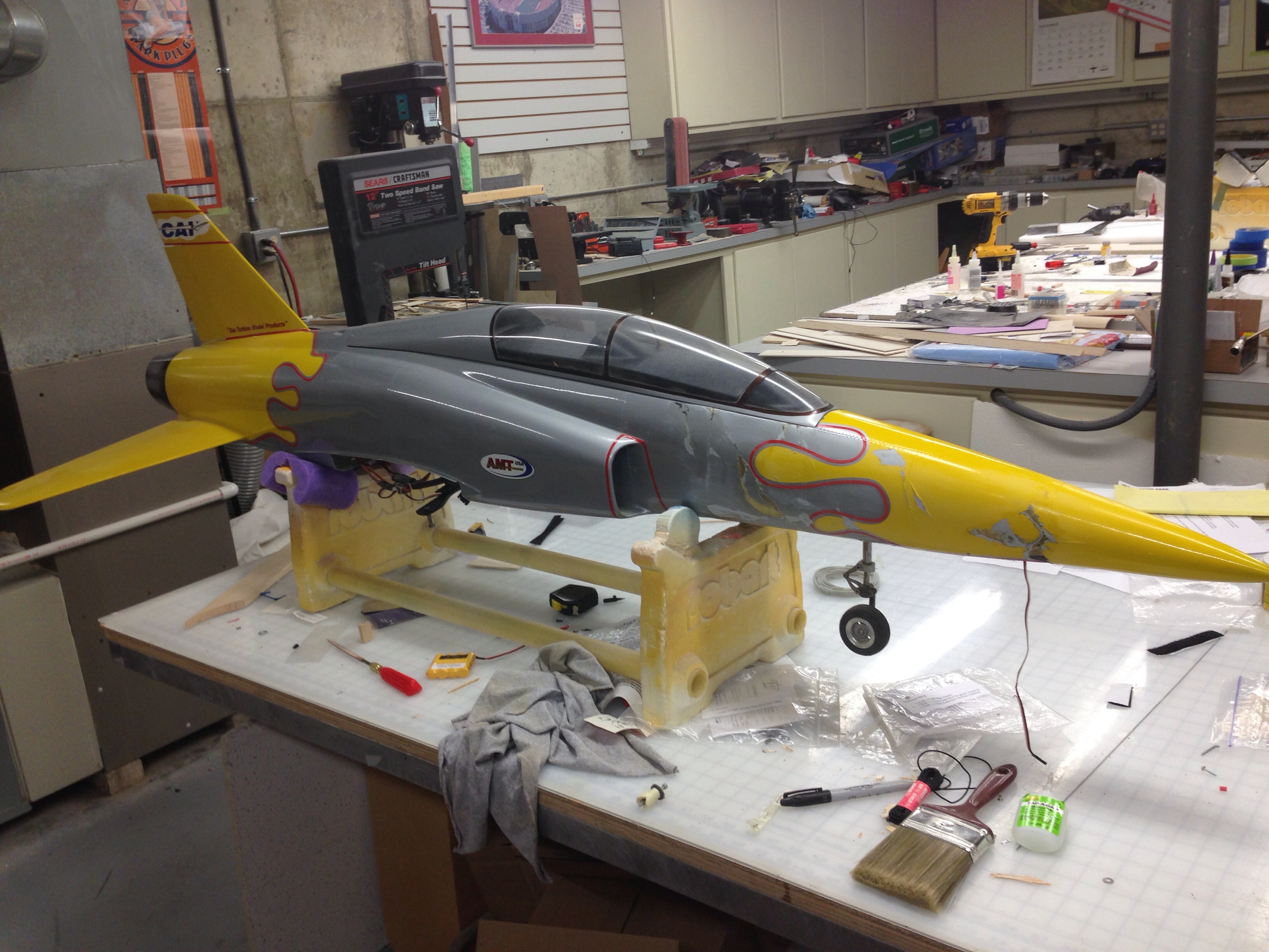

Hey guys lm looking for tips to help those who want to fly turbines off grassfields
I know it helps when your landing gear have the ability to pivot back to help from ripping out the retracts out the wings
I just flew my old CAI Razor today with an a 18 pound AMT turbine. Even with the 20% takeoff flaps it took almost the whole runway to get off the ground.
I will ill admit when full of fuel it seems hard to push by hand. But on the stand all the wheels seems to spin very freely
any other pointers?
One of my boys falcon has bearings on his wheels on his falcon 120 and it takes off 1/4 runway
thanks

The razor has small wheels for grass and does not come off overly quick even on pavement. I think my old razor probably took about 500' on pavement to rotate. I doubt you could put trailing links in a razor, the gear is very short, I doubt I could put them in my Raptor which is bigger than my razor was. I had a pst1300 in mine too putting out 28lbs of thrust. The biggest issue with the raptor and razor for takeoff is the forward fuel tank is really forward and quite large so the jet is very nose heavy on takeoff.

Agreed. If you can install a bigger tire, it will help. I built a little T-45, that originally was a 90mm EDF. SO... the stock tires were tiny. (1.75") But, knowing I was flying it off the grass... I installed 3" mains, and 2.5" on the nose. It looks a little goofy, but it works.

Since you have brass bushing in your wheels, its possible that the wheels are twisting sideways when rolling on the grass. With the plane inverted on the bench, apply force to the wheels from the front. If the wheels are twisting.. loosen your struts and turn till the wheels are straight and then tighten. I had this problem with my Prolinks that ARE trailing links. The bushings started to give and when taxing they acted like the brakes where on. It took a lot more effort to get in the air.

the Razor has very similar flight properties. The most important thing to get right on the Razor is the CG. If its too nose heavy, it will have a hard time breaking ground. At least this was my experience with the plane. Fun flying aircraft
