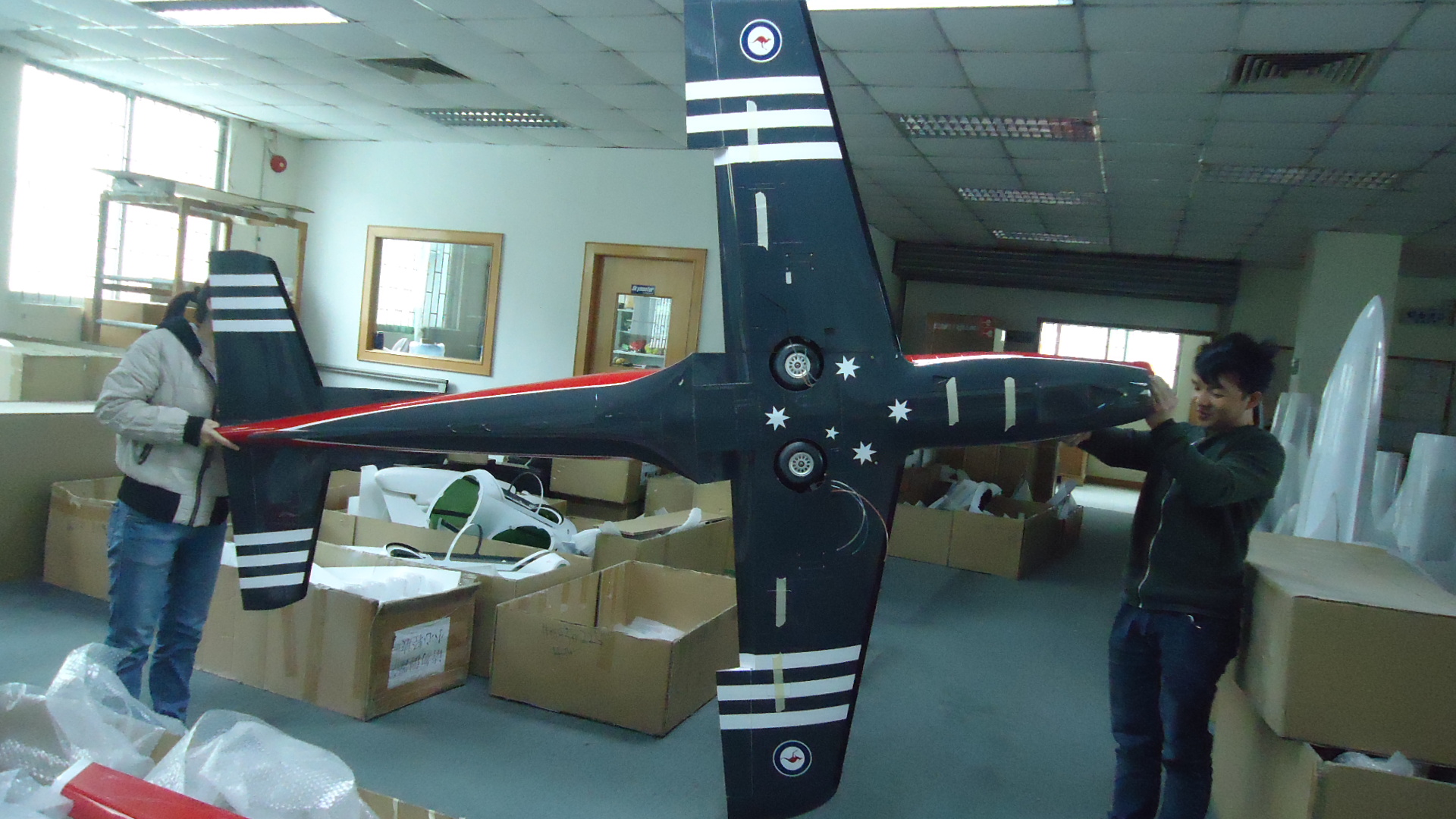

here is bottom scheme.,

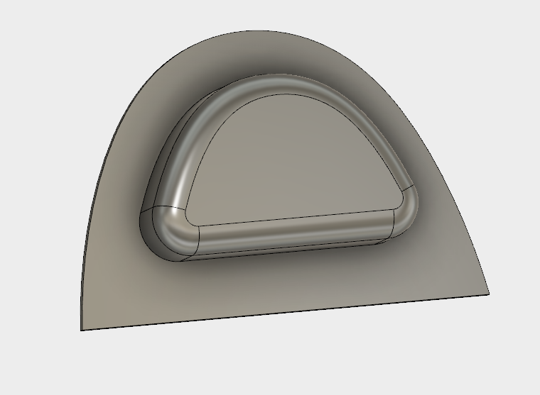

If any of you are into 3D printing, I designed this back of the canopy cover. I can send you the STL file if you want to print one. Tried to attach, wouldn't let me.

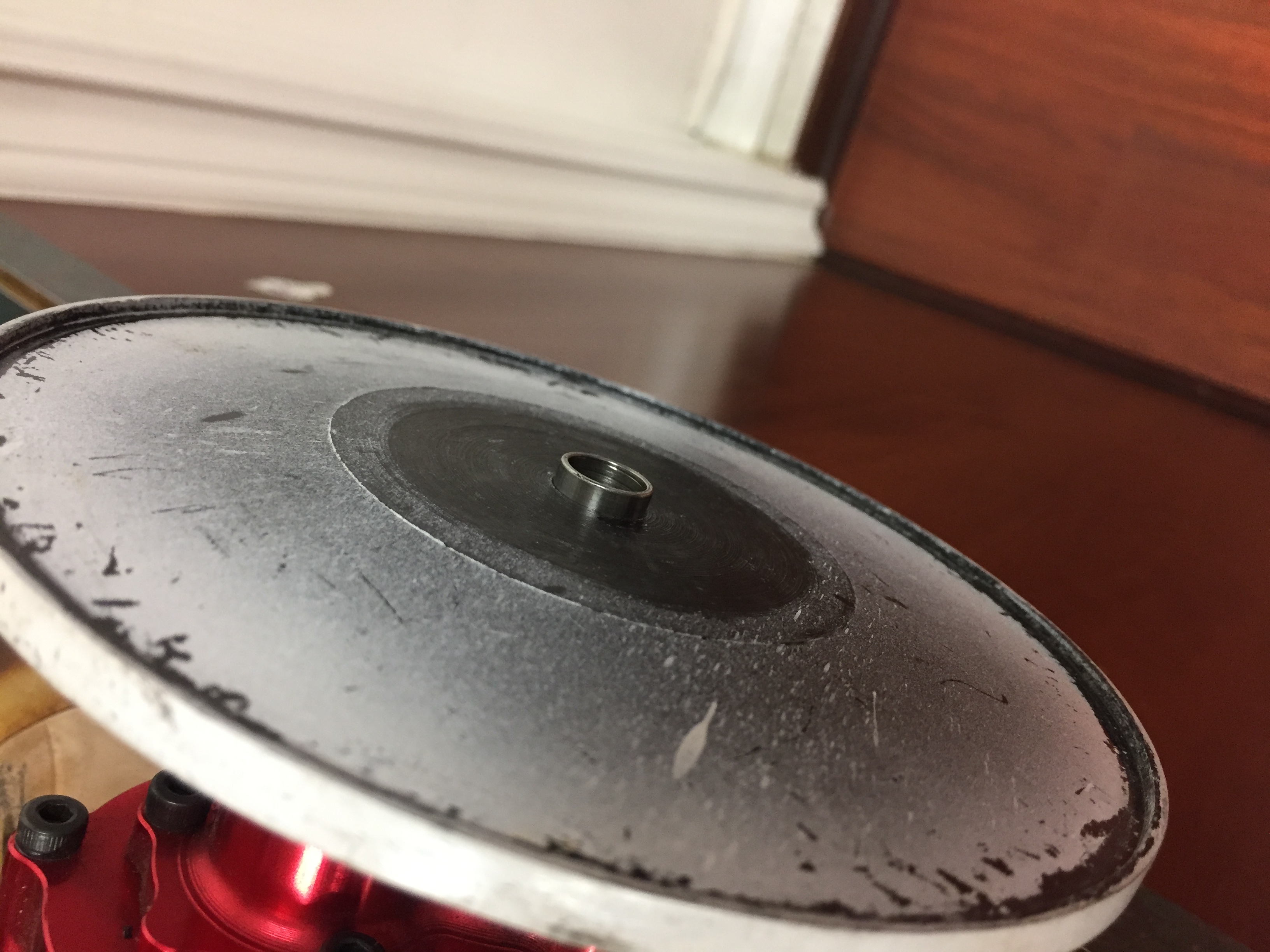

Hi guys I just picked up pc with a k60tp, the previous owner was flying it with a 3 blade carbon fiber prop without the spinner, personally I don't think it looks very good without the spinner. Question is I am trying to add the spinner with the skymaster 5 blade prop, but once I add the back plate there isn't much room left on the shaft for the prop to sit on securely. I am not very comfortable flying it like this, is this normal? Thank you

It is normal, and from my experience with the K-60 tp, it will not be a problem. Just make sure to drill the base of your propeller to fit snuggly on the shaft extention.

Hi Nickelup, From what I have seen, KT turbo prop comes with two bolts. You might have the shorter one. Make sure you have the long one.

Mine is the same way, seems to work fine. I had trouble tightening it though, piece of adhesive sandpaper on the back plate totally solved the problem. 5 blade sounds SOOOO COOOOL!

Hi Dr Scoles, Thanks i will try it and see. Do you have a smoke system installed in yours?
