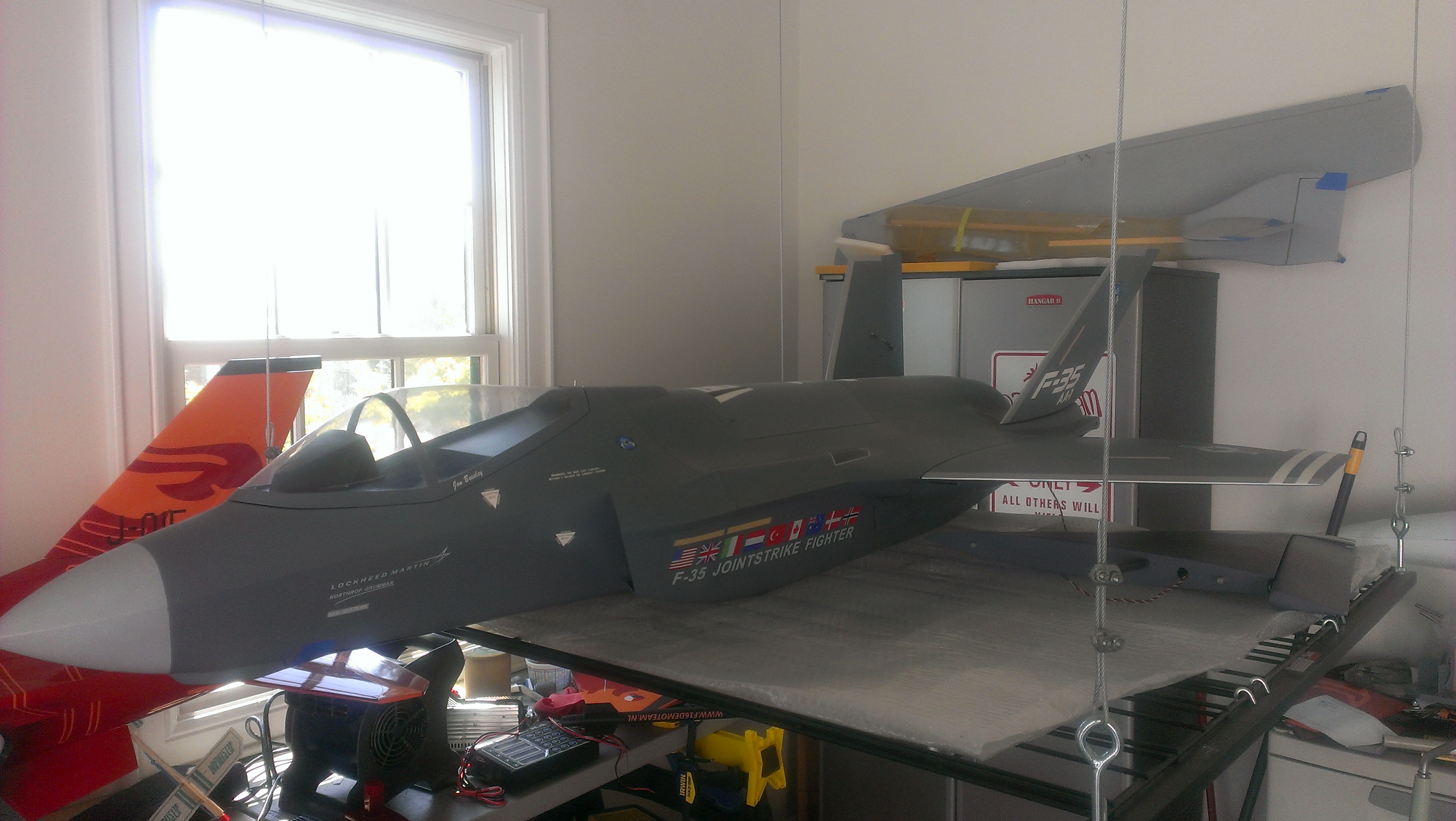

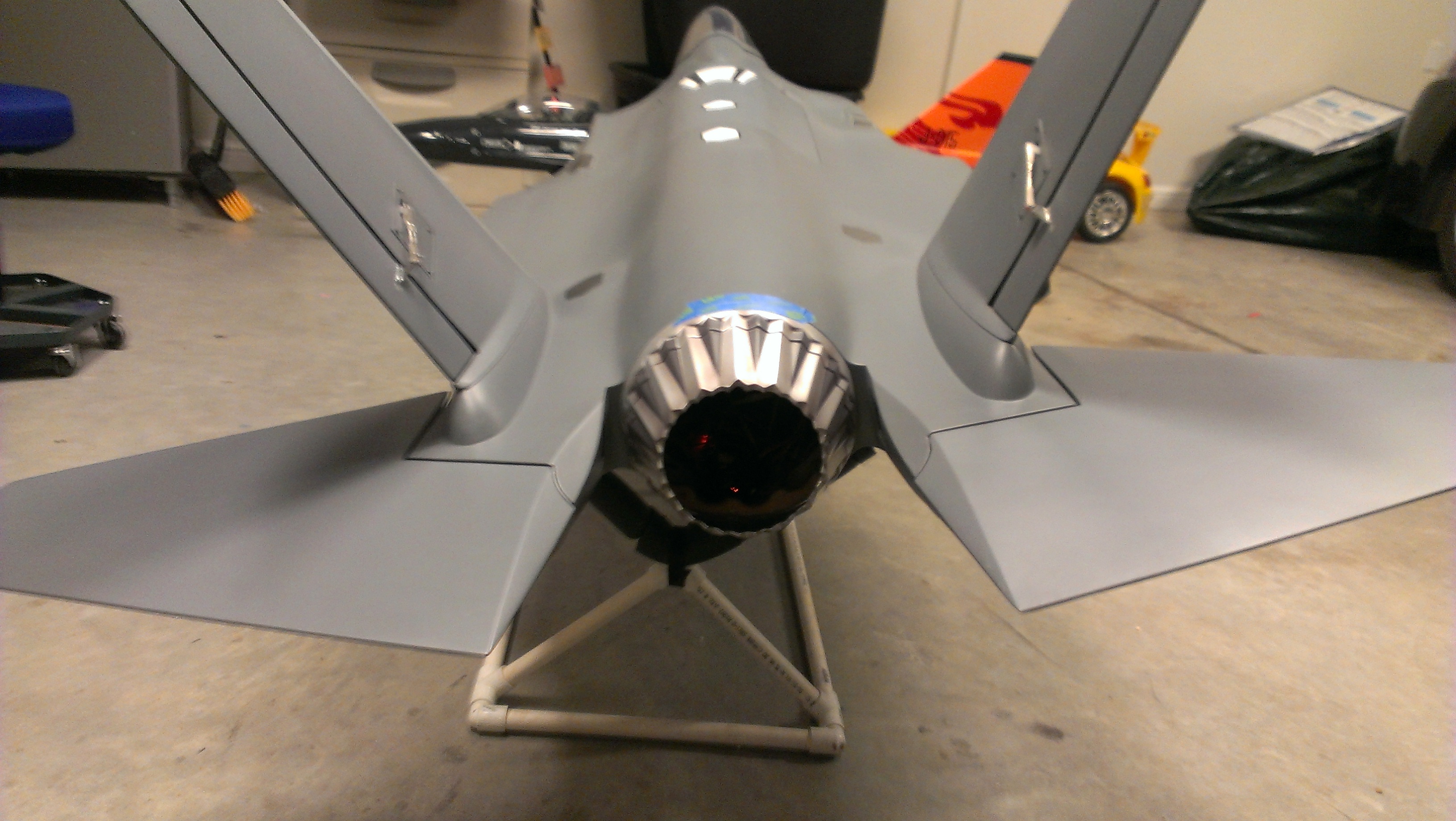

BTW, in case you were wondering.
ID:	2097319   Click image for larger version
