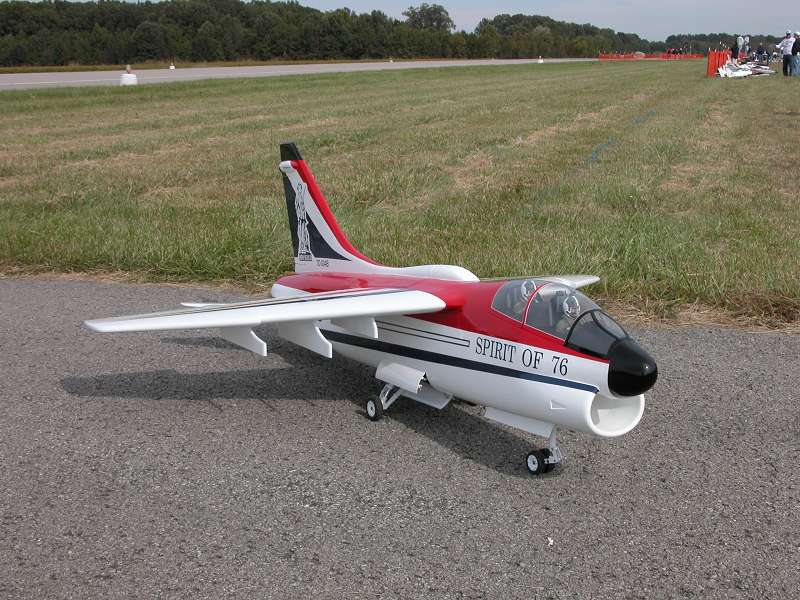

Ive seen that thread, unfortunately not a lof of building to show. I think by definition kits are for builders. Wish I knew exactly what is so hard about this particular kit. Does't seem too band. I have been told before that a 30 pounder is the magic number. Sluffs are just draggy airframes. I have friends who flew it for the ANG, and it was in fact temperamental. Engine was marginal at best, and lacked sufficient cooling.
This is the one I want to model it after.
