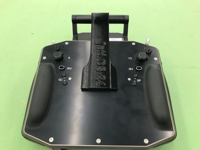

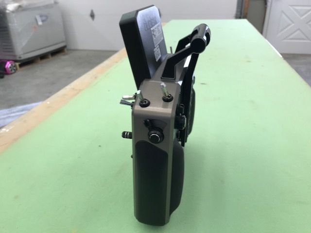

Here is my friends the latest revision of a DS-24 stand idea started by Edgar on post #562. It stands up the TX for easy view and programming on the bench and on ground prior to starting turbine. It folds flush against the back of the case and can easily remain on the Tx when in the case without damage to the foam padding.
The link to the design is posted on Thingverse.com.
https://www.thingiverse.com/thing:2886136
