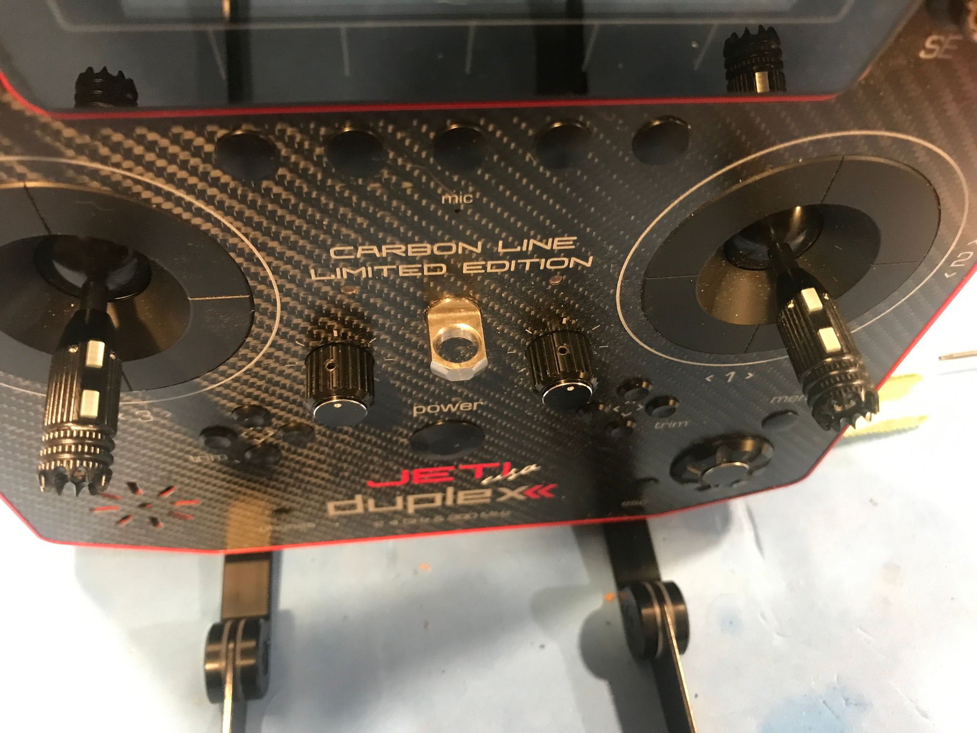

Ray I installed jeti stick switches a couple of years ago on my 24 and those made the stick height too tall for my taste. They probably work best for Europeans that like tall sticks. So I removed them and went back to normal sticks. A few months ago I came across a set called Wild Boar sticks that have two buttons. Wow these are amazing with them fitted you can adjust from 31 to 39mm. So I can not tell the difference in height to my old sticks. To set them up you go into the switch setup program. They are listed as sk and sl and you can click the drop down and select how you want them to operate. I set them up for a speed brake, top button speed brake up bottom button speed brake down. I will test tomorrow if you can set them up to work as a 3 position switch. Wild Boar Switch
Old 01-01-2022 | 03:13 AM
  #2027
Joined: Dec 2014
Posts: 61
Hi Airman thanks for the reply the switches look good,
Did you solder the wires from your new switches to the solder pads that are available on the small pc board next to the control sticks? or did you use the expansion board that Jeti
make?
Thanks for your help Happy flying and happy new year,Ray.

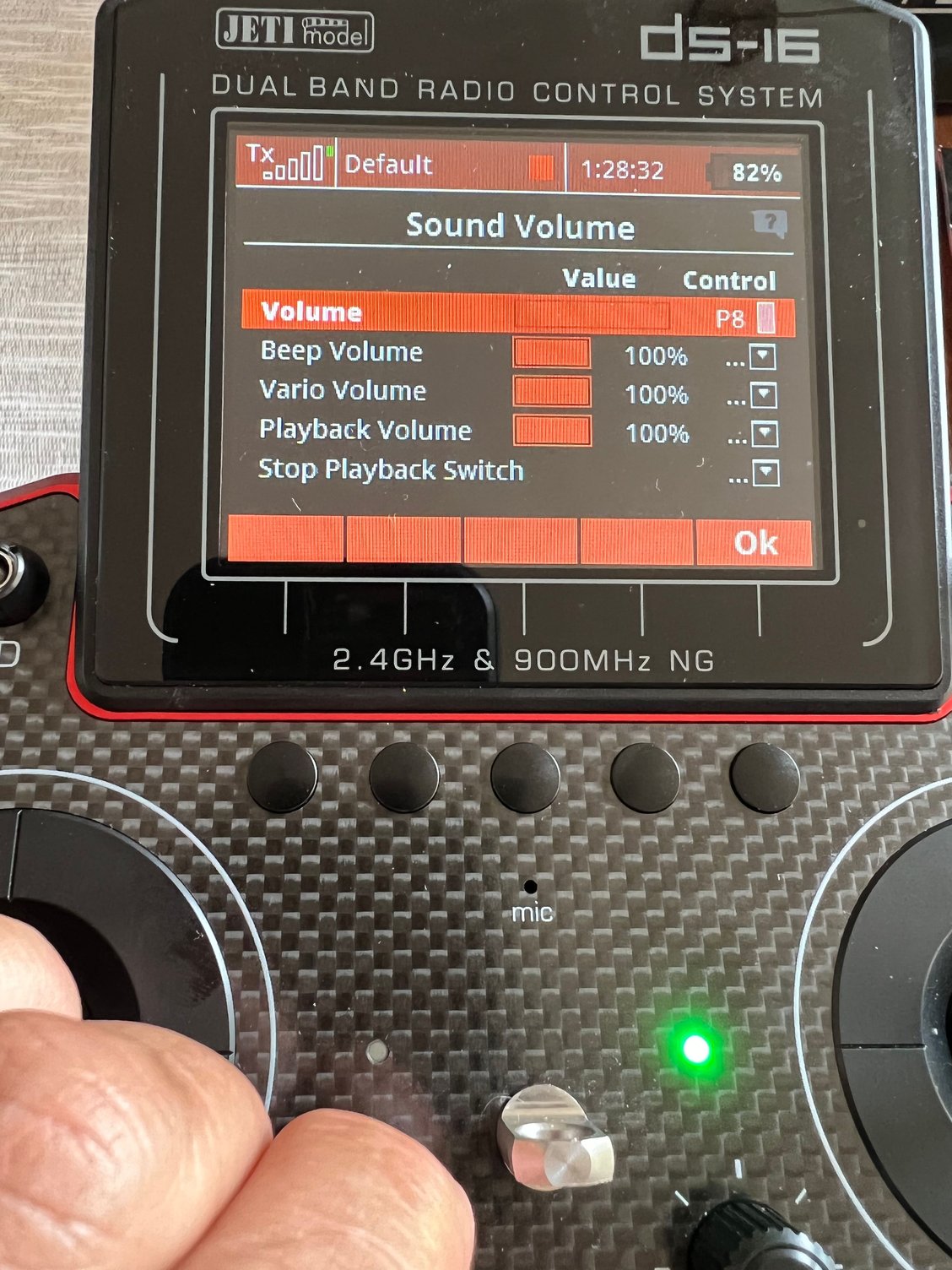

Hello I need some help, I have a brand new ds16g2 it was delivered to me yesterday…
the thing is that I can’t any sound from the speaker, NONE!
Wen I first turned it on I could hear the low voltage battery alarm beeps fine, but After i charged the battery and turned it on for the second time I got nothing… I haven’t touch a thing on the programing whatsoever… I also have a ds24 so i’m use jeti…
the strange thing is that if I connect headphones I can hear alarms and beeps FINE….
but as soon as I disconnect them the sounds and alamrs goes off…
Anyone else has experience this situation??
if so, what was the issue and solution or if anyone can throw me an idea of what must be happening I’ll really appreciate any imputs…
volumes are all 100%
Rgds!
Old 03-13-2022 | 12:06 PM
  #2038
Joined: Sep 2020
Posts: 54
Received 29 Likes on 19 Posts
Go to: SYSTEM --- CONFIGURATION --- SOUND PROFILE
It's probably in: "QUIET"
Should be in Voice and Beeps
Jack
Old 03-13-2022 | 12:29 PM
  #2039
Joined: Sep 2003
Posts: 441
Received 21 Likes on 19 Posts
Jack
thxs Jack, unfortunately it is on Voice and beeps…
i just made another update and nothing 😫

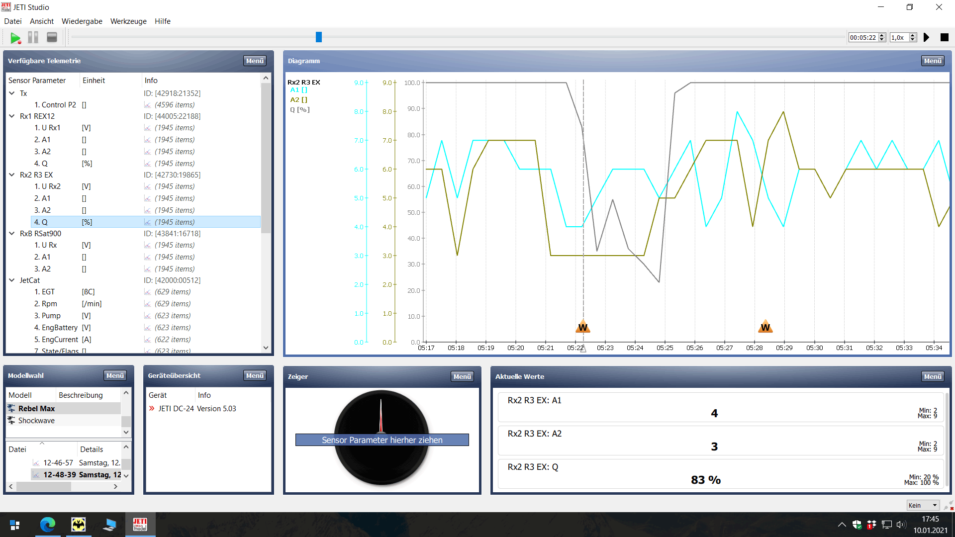

Originally Posted by bluelevel
In one of my jets I am using a CB220 with 3 receivers (RX1 is a Rex12, RX2 is a R3 2.4 and a 900Mhz used as a backup as RX3). During the first flights I heard a "Warning" alarm, but no further info as to what kind of alarm this actually was. This might be because I disabled morse codes, but not sure.
When checking the log files I found several entries "CBOX220: RX1 Timeout" (1 time) und "CBOX220: RX2 Timeout" (3 times) during that flight. Strange thing is that A1/A2/Q values seemed normal. BTW the "switchover strategy" in the config menu of the CB220 has not been changed, is still has the default setting of 150ms.
Any ideas as to what might be going on?
Post 1878 bluelevel
Did you ever get an answer on this question?
Just asking because I experienced the same warning 2 days ago...
