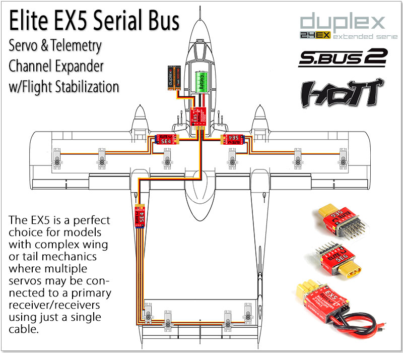

Another smart piece of technology from your friends at Esprit Tech.
Zb/Jeti USA
https://www.espritmodel.com/search.aspx?find=ex5
The Dual Input Servo Channel Expander EX5 is an intelligent bus manager compatible with several radio control systems. The device converts serial bus signal from up to two receivers to either standard PWM servo outputs, or configurable bus outputs. It offers up to five configurable and high-power servo ports with optional period and fail-safe setting.
The EX5 is a perfect choice for models with complex wing or tail mechanics where multiple servos may be connected to a primary receiver/receivers using just a single cable. In addition, if you are running out of receiver channels simply connect additional SE2/SE4/SE6 to the EX5 serial line/s and freely assign any channels.
The EX5 offers flight stabilization (Optional) using the integrated MEMS gyroscope/accelerometer. Up to three configurable flight modes can be used, each with different stabilization gains and settings. In connection with other devices from our production, such as SE4 or SE6, you can create a complex installation with just a few signal/power cables.
Specifications and Features
- Supported Protocols: Jeti EX, Multiplex M-LINK, Graupner HoTT, Futaba S.Bus/S.Bus2
- Small dimensions and high current throughput via the integrated MR30 power connectors.
- Telemetry (RC system dependent): Temperature, Voltage, G-Force (+/-30G), Attitude (Roll/Pitch/Yaw).
- Gyro-stabilized servo outputs, EX Bus, SRXL16ch. or S.Bus.
- Flight stabilization offering 3 configurable flight modes (Manual/Acro/Horizon).
- Automatic detection of serial data/telemetry after startup.
- Configuration through the transmitter or external terminal (JETIBOX/SMART-BOX).
- Firmware updates via USB interface.

Attachment 2270474
Attachment 2270475
Is this thing has a wireless switch?

It looks like, in some of the photos, that the servo connectors have clear heat shrink tubing on them at the connection to the EX5 or some of the other modules. Is this so???

I've been seeing the ads for the new Elite Serial Bus product line from Esprit.
https://www.espritmodel.com/elite-ex...ilization.aspx
One question though that I don't see answered.
The Elite EX5 Serial Bus Servo Expander is shown powered from a battery to ensure that it has enough current capacity for up to 5 servos. However, no switch is shown in any of the layouts.
Does the EX5 contain an electronic battery switch so when the model and primary receiver is switched off that the EX5 and connected servos are also powered down, or do you have to separately disconnect its battery also?
Paul
There is No switch. You can use pretty much anything for On/Off or nothing and just plug in your Rx pack.
T30/T60 w/R3 as wireless switch That's w/Telemetry
https://www.espritmodel.com/elite-te...ba-s-bus2.aspx
Sliding Switch
https://www.espritmodel.com/elite-po...placement.aspx
Jeti DSM w/R3 as wireless switch
https://www.espritmodel.com/jeti-ele...edundancy.aspx
