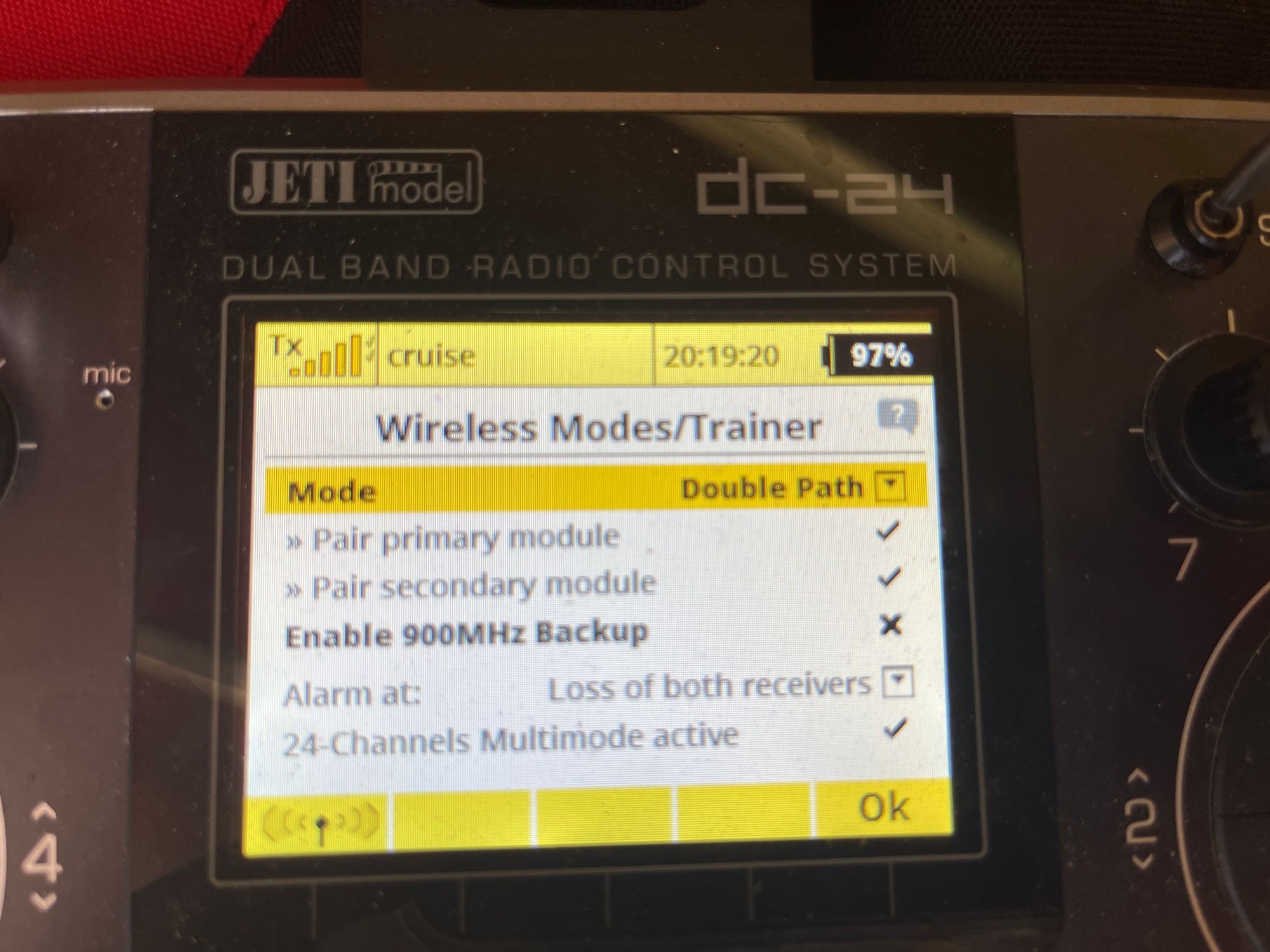

question?
I am using DC 24 with a CB 400 in a warbird that requires 17 functions
i can get the 16 to work except anything i plug into 17 thru 24 will not work.
In mY TX, when I go to the wireless mode / trainer, it is already set to 24 channels.
However, I cannot get anything out of channels 17 - 24 on the CB 400
Any advice?
thank you
Cam

Old 07-26-2021 | 12:06 PM
  #1988
Joined: Dec 2011
Posts: 1,047
Received 36 Likes on 31 Posts
From: shreveport, LA
NO, nothing works, no servos, lights, etc, if they are plugged into channel 17 thru 24
Old 07-26-2021 | 12:10 PM
  #1989
Joined: Dec 2011
Posts: 1,047
very interesting
this could be it
but, I am 100% certain I did this update
but let me go and see if it will let me do it
the Transmitter says 24 is active
when i go to the screen for wireless / trainer
but this could be it!

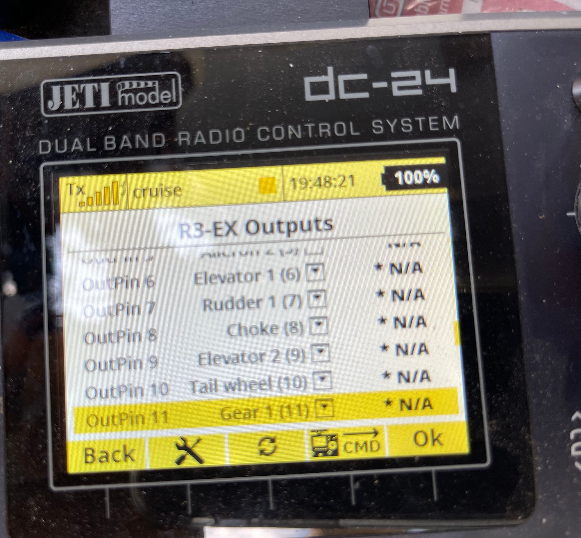

Old 07-26-2021 | 12:59 PM
  #1992
Joined: Dec 2011
Posts: 1,047
Originally Posted by Dansy
Your on ExBus ?
On the main page of the CB400 does it say ExBus ? for the RX?
yes,
but, I just got a call from Danny.
very nice guy.
No one has ever done that before!
What a guy.
He was able to guide me thru my Tx and we pulled up which version of the Rx is in there.
So, I will do update soon and report back.
If it works, then we will know that was the problem.
But, I also took these screen shots.
Tell me what you think....
this is the update that was on my laptop from last fall
I did not download this today.
ok, when i am in Device explorer. I hovered over Rx1 and clicked it.
then I hit the tool symbol, and this screen popped up:
this was programmed in by me, either on 2/12/2020 or, i believe more than likely, it was december 12, 2020.
so then, I went to device explorer again, and hovered over RX1 and looked at receiver output, and this is all it shows,
i scrolled and took pictures.
this shows output pins 1 thru 5
this shows pins 6 thru 11
this is the end of it, does not go beyond pin 16.
Old 07-26-2021 | 01:44 PM
  #1993
Joined: Dec 2011
Posts: 1,047
I did the update to 3.25
and now the lights work.
But If I go to receiver outputs, it only shows 16 max.
Old 07-26-2021 | 01:52 PM
