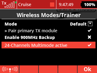

On ExBus you always have at least 16 channels Fully proportional, and if you select this under the wireless screen you can get 24 channels to answer the other question all channels are fully proportional.
ADDED The only restriction on how many channels you have on a giving receiver is the number of ports, the signal is always 16 channels minimum....so by connecting that on a distribution box (CB's) you can use the full channels.

that 16 or 24 channels that work as well with a simple R3 the reason most used to used 2 r3 and 1 more r3 as the switch....for the CB200/400 or any additional Jeti Switch (if it has a magnet switch it can be control by a R3)
One different thing about Jeti is......you can actually control proportionally ALL Servo's meaning all channel with a single stick or switch (of course thats not practical but demonstrate the flexibility of the system)

Warbird, here is how I understand it:
Your Jeti transmitter (DS/C-24 and 16) can output UPTO 24 channels. This gets sent via radio waves to a Jeti receiver and it has a proprietary designation called "Ex-bus". PPM, and other designations, can be shared with non Jeti receivers like powerboxes, etc...But lets stick to Jeti, because my knowledge of PPM has just been exhausted!
Now, your 7 channel rx you have in your hand, can only out put 7 channels if you are using that receiver to plug in your servos for your airplane. As far as how much telemetry, input, output, I'm still learning, but you can have as many telemetry outputs as you like (40 is the max?) as you can daisy chain different telemetry output thing-a-ma-bobbles (that's an official term by the way, kidding, its sarcasm) together.
Here is where "Ex-bus" can really shine. Remember, "EX-bus" is just a fancy word made up by Jeti to call their radio wave that is transmitting, UPTO 24, channels, if you want.
Your 7 channel rx (and yes, just about ANY jeti rx) can pick this "EX-bus" signal and pass it along to another rx (these are usually the CB200 or the CB400) and now these rx's can output MORE channels than the rx you are using to pick up the "EX-bus" signal!
Since a small RX (ie the Ex R3 which is a small 3 channel rx) can pick up the "EX-bus" signal put out by your Jeti Tx just as good and efficiently as a bigger Rx, (not to mention the smaller Rx is cheaper) then it makes more sense to use a smaller Rx, CONNECTED, to something like a CB200 or CB400, to take advantage of the 24 channels! Specifically, the CB200 can only output 15 channels, while the CB400 can output the full 24 channels capable by the DS/C-24&16.
What is great about Jeti, is that the Tx, can output (in PARALLEL) an "EX-bus" signal and can talk to upto 3, yes 3 (two 2.4 Ghz Rx's and one 900 MgHz as a back up), at a time if needed! (In all fairness, "at the same time" maybe incorrect information, its probably more like separated by milli/micro-seconds, REALLY fast though, faster than eye blinks or the time it takes you to think something and have your finger move)
You could just hook up your one 7 channel Rx into a CB400 and get all 24 channels, but then you would be missing out on the redundant safety transmission capabilities of the Jeti system! And for the price (both monetary, weight and spatial arrangement) of another small 3 channel Rx, you can have both redundancy in transmission and reception, but also, you can take advantage of having another Rx, placed in a WHOLE, different way, to take advantage of spatial reception redundancy!
Well, that's how I understand it anyways. And I'm a FNG with Jeti too.
