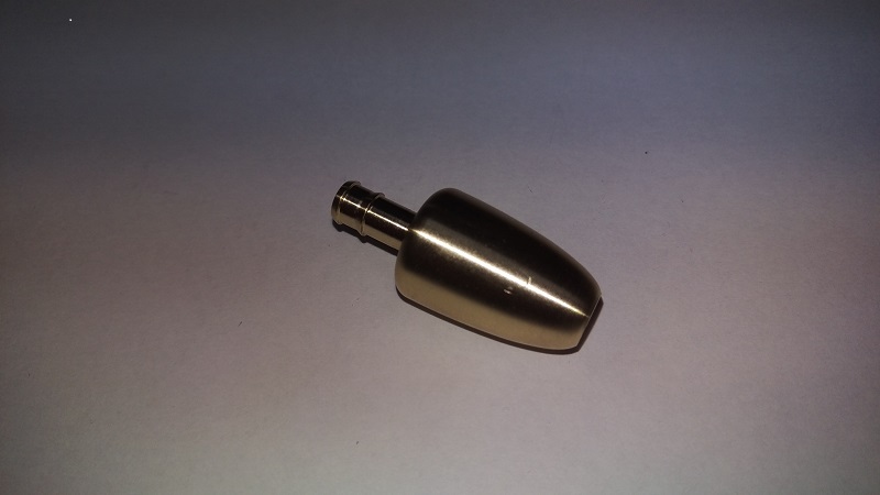

clunk is http://www.dreamworksrc.com/catalog/Bvm-High-Flow-Clunk
fuel tubing so far is http://www.dreamworksrc.com/catalog/...uel-Tubing-316

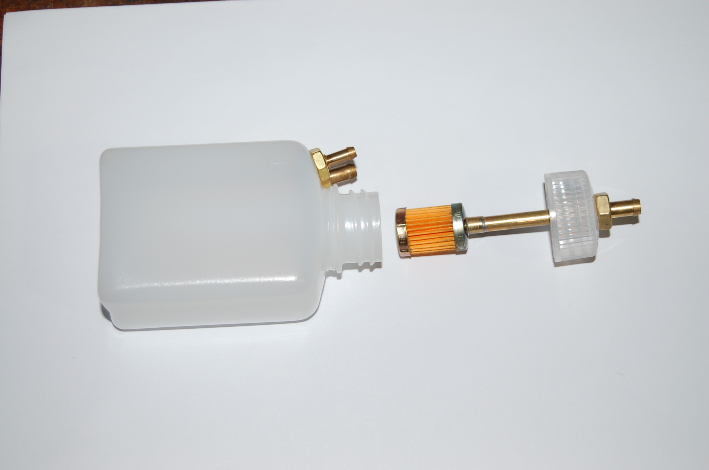

I use the MAP traps and they have std and Hi Flow versions. I use the Hi-Flow on any RXi JetCat and any turbine 180-250N
This is only part of it, clunk, clunk line and overflow fitting need to match the throughput!
Hard walled hopper tanks mask problems...not solve them! The daddy of composite tanks BV still uses a plastic hopper tank (they offer a high flow nipple version too) Don't you think if he thought hard walled was the way to go he would not have introduced one 10 years ago!!
This is a high flow MAP , the filler nipple is std size and feeds both 4.9mm

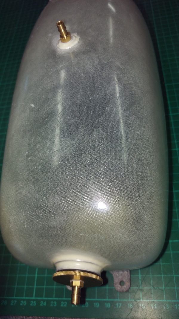

Let me give you guys some info on the BVM High Flow UAT and the associated parts of our High Flow fuel system.
We have addressed the problem and updated the UAT and the remainder of the fuel system to allow high flow by increasing the fitting and line sizes.
Read this: http://www.bvmjets.com/Pages/Catalog/HiFlow.htm
Here's the system diagram which can be applied to most other airframes:http://www.bvmjets.com/images/K7300-32_34.pdf
We used my Ultra Bandit as a test bed for the system validation. With the new system, the P200 was very happy, and did not suffer from fuel starvation. The side walls of the plastic bottle did not suck in during full thrust operation when the flow demand is the highest.

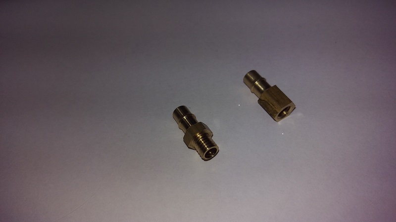

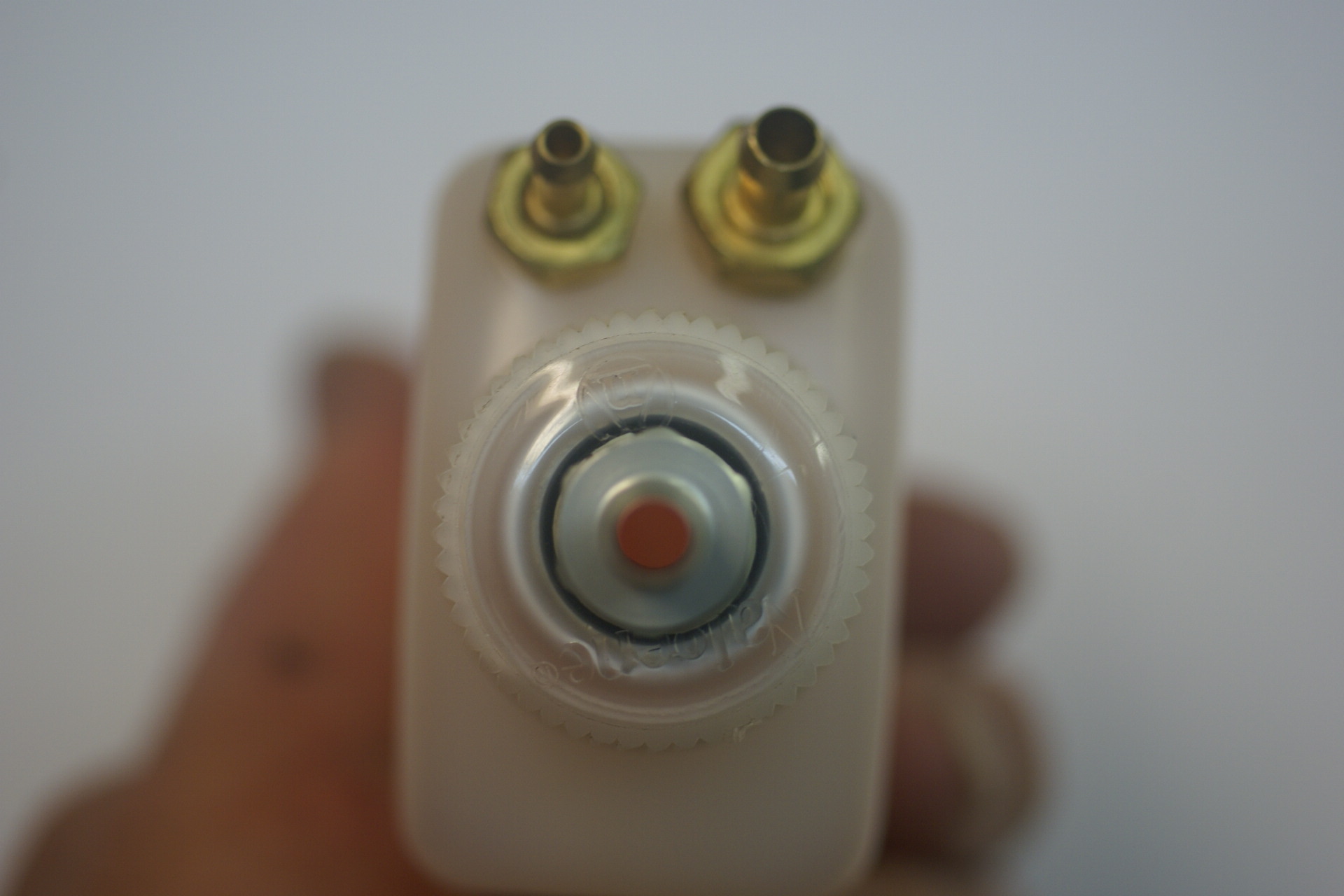

Harley, what is the internal setup of the High Flow BVM UAT? I have the regular one now and if it works then no need to upgrade it! LOL
Posts: 2,341
From: Longwood ,
FL

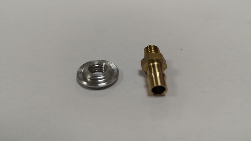

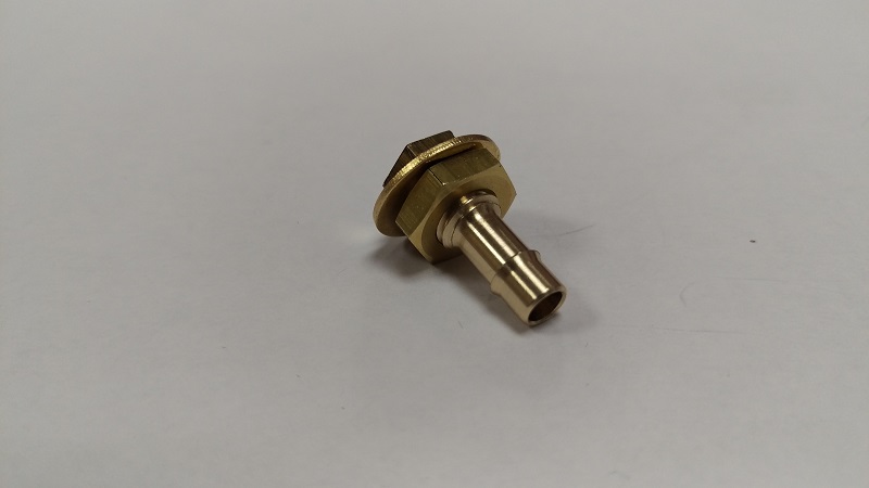

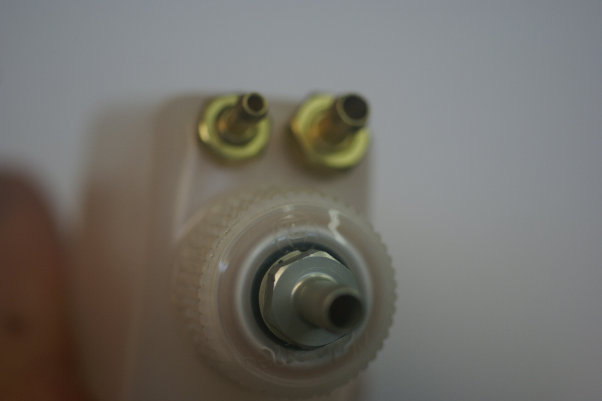

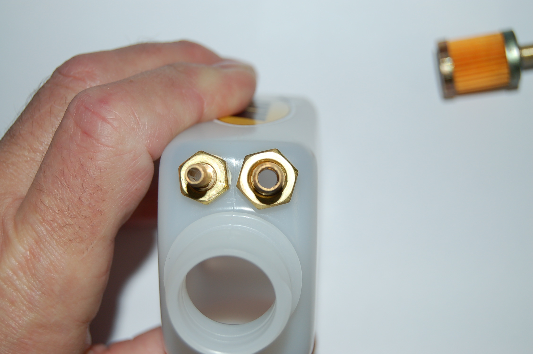

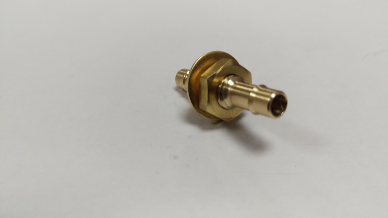

The internals were in no need of a change. The changes involved increasing the bore diameter of the feed and transfer fittings.
The feed fitting (The one on the UAT cap) was increased from .112 (2.84 mm) to .210 (5.33 mm) which is a 57% increase, and the bore diameter of the transfer fitting was increased from.102 to .175 (4.44 mm) which is a 52% increase. As shown in the photos, the feed fitting is now a barbed fitting. The filler fitting was not changed, for obvious reasons
