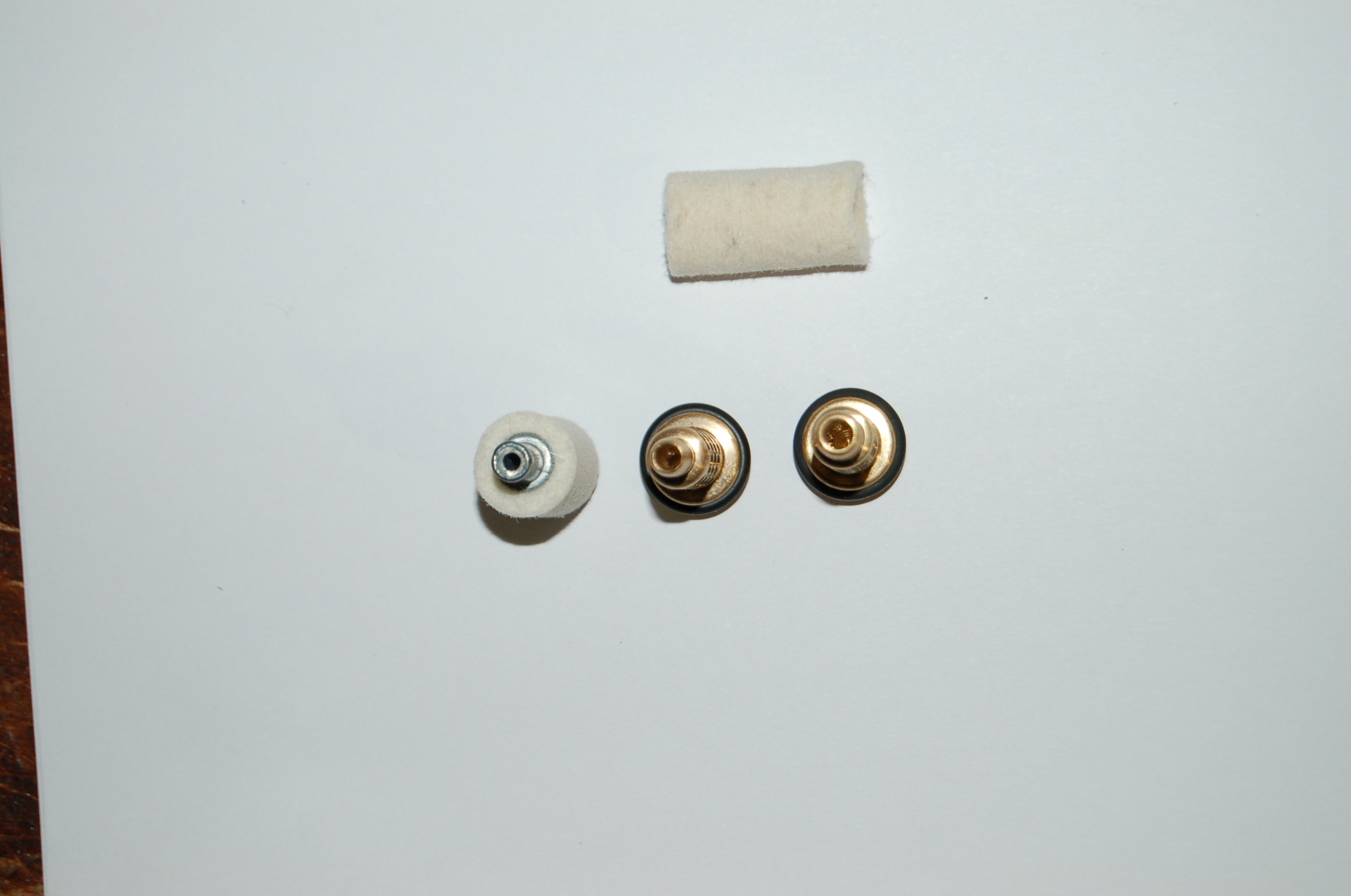

Here's what cavitation looks like. This is on a 200 size turbine with the pump running at full power. It is amazing how much flow is required to feed a thirsty turbine.
I had this set up with felt clunks in the saddle tank which added a lot to the flow resistance. I did have a flame out and dead stick landing which led to this test.
Got rid of the felt clunks and went to one of the new Intairco UAT's. Using the 6mm PU tubing. All problems solved.

[QUOTE=stevekott;12158368]Here's what cavitation looks like. This is on a 200 size turbine with the pump running at full power. It is amazing how much flow is required to feed a thirsty turbine.
There is nothing wrong with felt clunks...I use nothing else all the way through P-200RX's.
BUT, the std type supplied by many companies including CARF has a very small hole. (it can be drilled out) We had these inners made with 3.2 and 4.8mm id supplies and lots of perforations.
Pump voltage figures are very low and all the fuel gets used in all tank shapes.
stock felt on left and our two.

Well noted Dave, the felt clunks I used were EXACTLY the one on the left. They were the ones provided by Skymaster.

For some reason Tillotson reduced the hole size sometime ago, great in petrol models and 20-35N turbines, not much good on bigger. Some have a 2.2mm hole!
