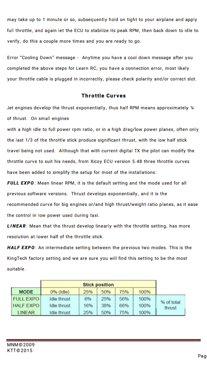

patrnfiyr is your throttle curve linear or half expo?

I've experienced something like that on my K80, this may be the reasons, step 10.
I got me my first Kingtech turbine and I'm still learning about them ( the brand ) one thing is for sure, support and the engine itself are excellent, I'm a happy owner.
