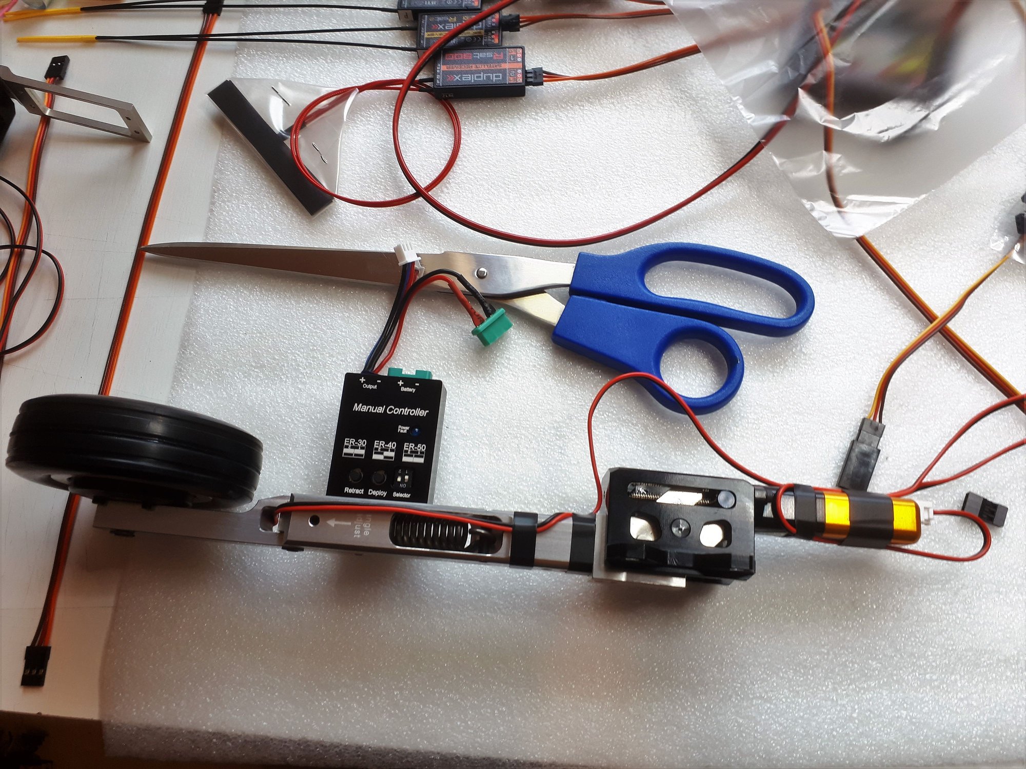

Friends, I have a set of er40 ( reversible) controlled by a GS200. One motor in one of the retracts went faulty and I ordered a new one. Its installed now, but a I face a strange problem in that retract. It is moving opposite to the other two. I have checked everything I the tr union is installed in the proper way. I did not find anyway option in GS200 to prevent this . Or to reverse one retract. Can anyone help?
You can solve the reverse operation of the aircraft's retractable landing gear by reversing the polarity of the JR servo connectors in your controller. Exactly as the guys say. ***winter***
You only have to reverse them (normally) if you reversed the retract from what how they were deliver, at least that’s my experience..
Hi Daniel,
yes, you need to do the mechanical adjustment first. I think the manufacturer supplies retractable gear set up to fit into the foam cutouts in the box.
The landing gear was delivered to me in a mechanical setup that could not be used for the T-1.
In the photo (above) is mechanically set reverse operation. That's fine for the T-1. Changing the settings is a matter of minutes. ***winter***
-This is why the polarity of the connectors must be reversed !-
