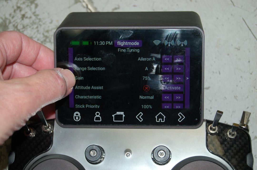

Here are some photos. I’m struggling for the time needed to list it all out, but with the iSat manual it makes sense! You need to double tap on the Rx widget, in this case RSSi was used and the Rx menu comes up. Touch the menu list (with Rx on) and it will scan find the Rx. Then it will show a screen with General settings where you change it to Fasttrack. Then use the two long bars at the extreme of each page to scroll.
This set up has the two ailerons in 2&7, 3&8 elevator etc. The gain channel ch5
One thing on the iSat Gyro when doing the stick limits, it’s important to hold the stick at the limit when you press the arrows and follow the left/right up/down prompt as it sets the direction from this.
I think for the small jets this is a game changer, 9ch Rx and an iSat in a Mini Xcalibur would make for a really easy install and light.

I don't know how to figure out the tow different gain settings in one flight? I guess it needs two flights? One for range A and one for range B?

It’s almost certainly the same! The only difference is the ‘heading’ hold (Attitude assist) on ailerons only when in Range B.
