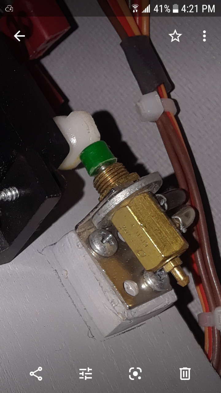

On the planes I used to use down elevator on I never used full down for brakes. Full brake was reached in about 1/4 down elevator and didn't make the wheels light or put much pressure on the nose. If the plane has trailing link gear they will squat with brakes anyway. While one or two of my jets may still have elevator mixed to brakes, I use a spring loaded switch on all of them and just pulse my finger if needed.
On my Flash, I still had elevator mixed with brakes even though I was using a push button for brakes. After not flying it for a while I made some tweaks and took her to the field a couple days. I noticed the wheels were worn more than I remembered. Well, after about three more flights the mains were almost down to the rims!! What the ?? Yep, somehow I changed my mix and it now had some brake applied with UP elevator. So every time I rotated for take off the brake was applied I wondered why I couldn't do wheelies any more

I never use a slider. I like the feel of a spring like real brakes where you apply and release. Thus the use of elevator or a spring switch.
