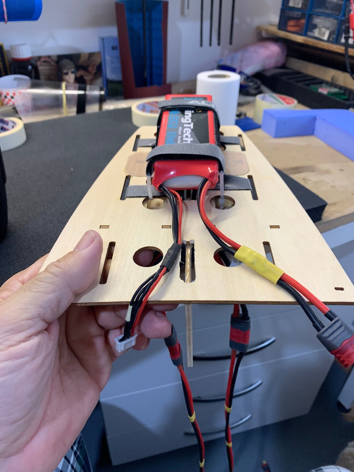

This kit seems quite good and cheap if compared with the other manufacturers same kits. There are some disadvantages;
First of all the composite quality is poor, I do not know whether it comes from a weak quality epoxy or?? , paint is not good, mean the left side and the right side of the paint job is not same; left side is shining well, smooth but right side is rough. When I try to clean the fuselage by soft cloth left side is good , well but the right side is impossible to clean by soft cloth because surface is not shiny ,like sand belt

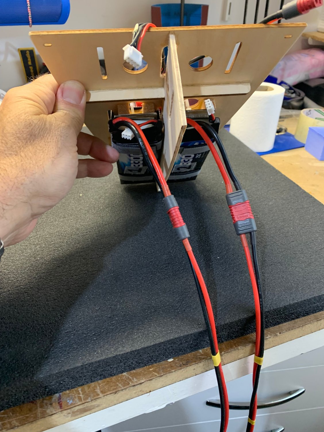

Also front side of the fuselage is week, the 1-1.5cm glass fiber strip on the side joint part of the fuselage comes out by cracking itself , I had to reinforce the inside as seen in the pictures because front /nose could not carry the battery tray with 3 ea battery(2 ea 3.300Mah LiPo and 1 ea 3.800 Mah LiFePo4 ECU battery), Also had to add 120-140 Gr weight on the nose to adjust the CG, also reinforced the stock battery tray as seen . Now every part is rock solid on the nose section and CG is set more easily , actually this bird needs a lot of nose weight.
JRDFA T14X4 Radio ,Kingtech K210 g2, JR8911 servos on rudder, elevon, canards, JR8477 on Vector thrusts , powerbox mercury srs etc. One of the good point is fuselage is 2 part and easy transport. Seems gorgeous on gorund and I am sure will be shinning when flying.
