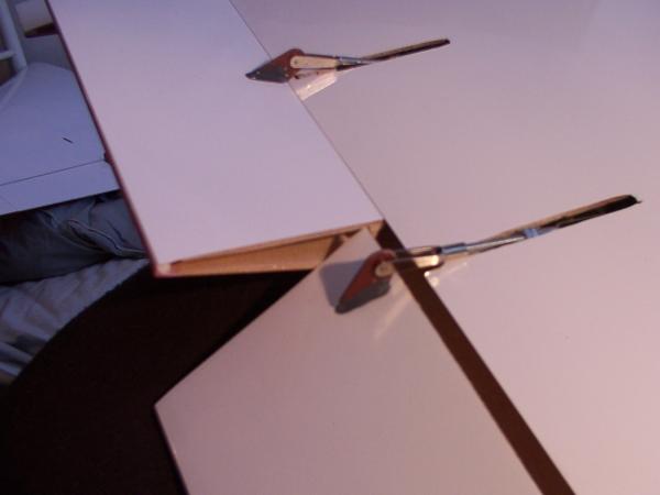

On the composite arf model the elevons and rudders are pre hinged. When you go to move them towards the hinge side...they work fine, But when you move them away from the hing they bind on the other side of the surface.
My question is. Should the not hinged side of the moving surface go above or below its other side. Take for instance the elevons.....i do believe that they are hing on the bottom side of the wing. When you move the surface down....it deflects fine. When you move the surface up it hits the trailing edge of the wing. Should the topside of the elevon go on top of the wing when deflected or should it go below the top of the wing when deflected. I am attaching a pic to better help explain myself
Sean

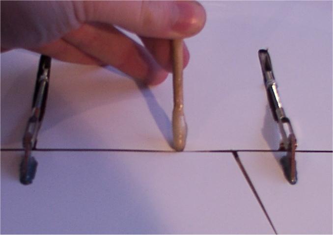

It`s supposed to tuck under.
I bougt some gap seal tape and taped it to the elevon. That would guide it under the TE of the wing.
Sorry, I havn`t got a pic of the tape installed.

I had to sand it back carefully in mine is some areas of ailerons and rudders, the gap must be enough for the aileron to go IN to the hinge area, otherwise the material on the aileron will break.

You can use heat gun and a credit card to slightly lift the hinge pocket, heat the area lightly (dont get it too hot) and slide the credit card between the elevon and the trailing wing skin and push the elevon up. Hold it there till the surface cools and then move down the wing the width of the card and do it again till youv'e covered the span of the wing. This will correct the gap....

I used clear tape on the elevon, I think it's the safest way. I have heard of models being lost due to surface lockup at high speed. The tape smooths the edge and stops any binding. It also looks OK if you use clear
