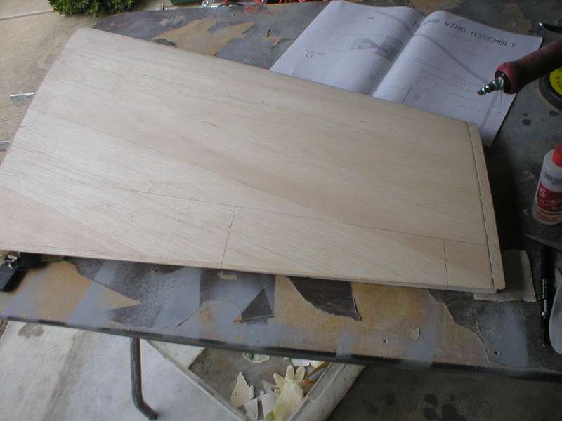

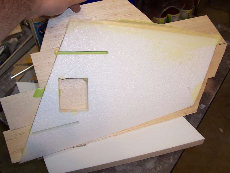

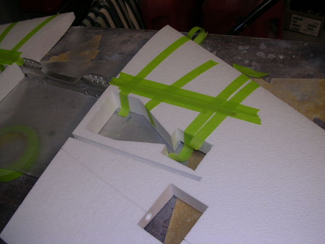

For those of you that have interest in this plane, I'm gonna run a build thread. Mr. Matt, when you get a chance could you pm me your phone number, I'd like to talk to you in depth about your hinging techniques as I want to use them to the extent that they can be used on this airplane.
In the mean time, I've got about 6 hours labor into what you'll see below. I'm almost to the stage on one wing to cut out the flaps and ailerons.
The foam cores come precut from the foam cutter for servos, spars, and retract wheel area. The guys at RPM have really done a good job taking a great flying airplane and making improvements.
I have no official affiliation with the guys at RPM other than great friends and beer drinking buddies so you'll get the straight dope from me on this jet if you have any questions.
First thing I did was line the spars up with the spar receiver on my "flat" table. I had capped the spars in 3/16" ply and then boxed all that with 1/32 ply. This gives a great adhesion to the foam core. Also lined up the spars into the foam such that the landing gear plate will allow all my "hard" landings to be taken by the spar. What an awesome design. I love it.
On my first isobar some of the absorption of landings had been tranferred to the wing skin on top of the wing and cracked my paint. I put a good layer of carbon fiber and west systems in this area to hopefully prevent that in this jet.

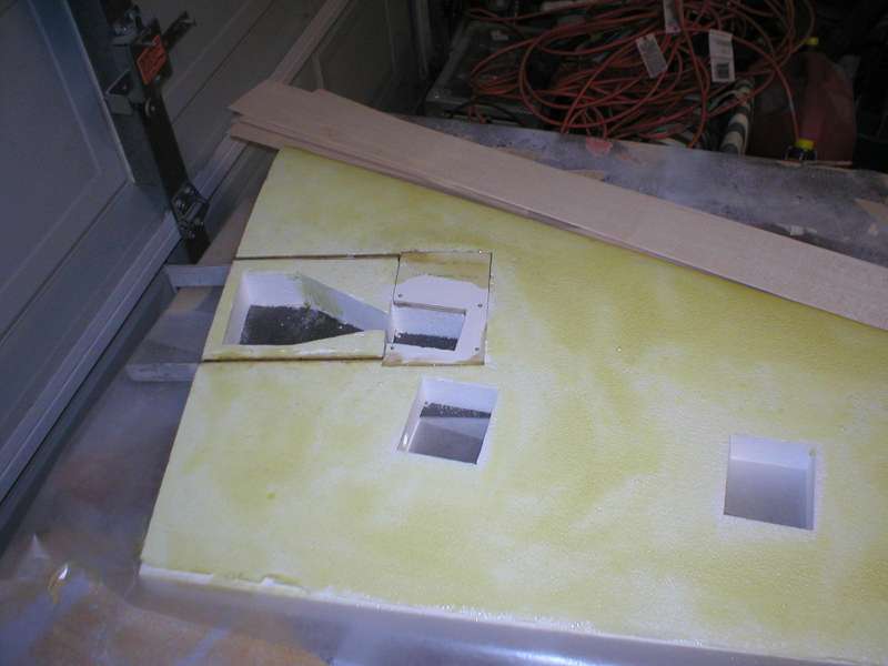

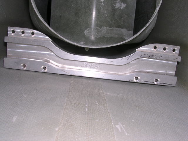

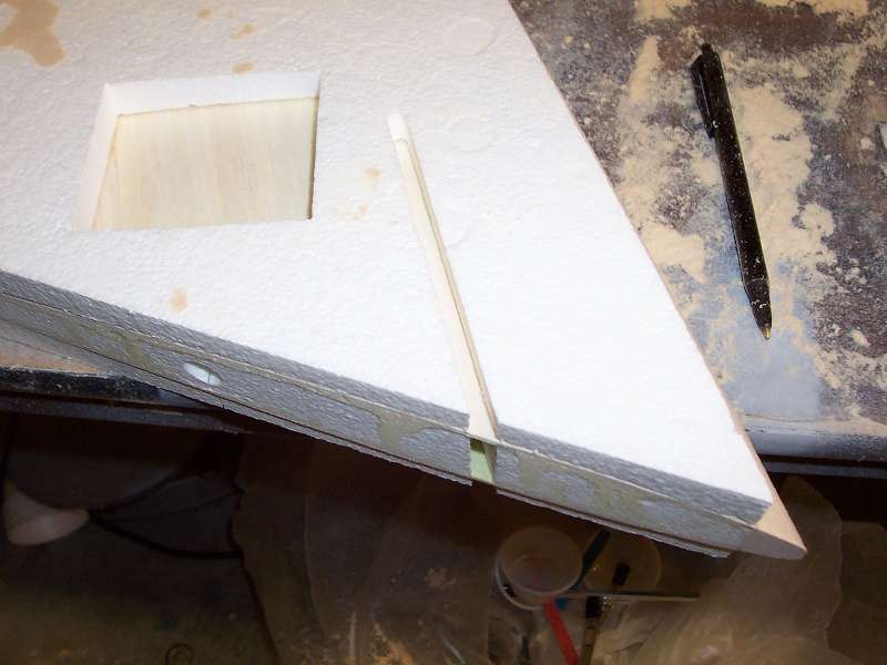

Next was to put the landing gear plate in. The landing gear system is well thought out with a flex plate. Four bolts to take out takes the gear out and you can make your own flex plates at home!! I never broke one before, until the demise of the jet. But it was nice to know it was there.
I also put a piece of light ply on the leading edge. Anything is over kill there as it will get a balsa leading edge, but someday I'm gonna hit a full scale landing light at one of these events, and it's a small price in weight to pay for a little more protection.

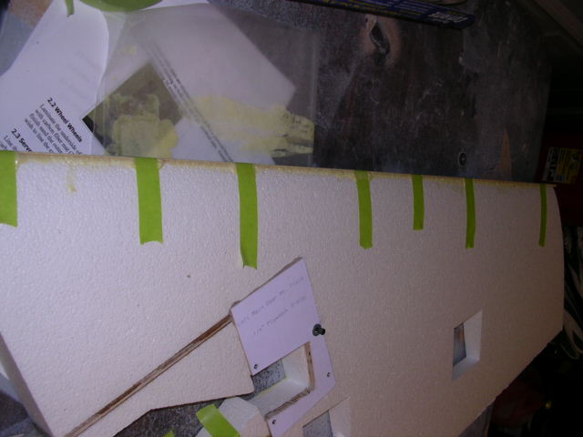

Some misc sheeting pictures. Poly glue was used. Some balsa cap strips etc. Nothing scary here. Near ready to cut out ailerons and flaps.

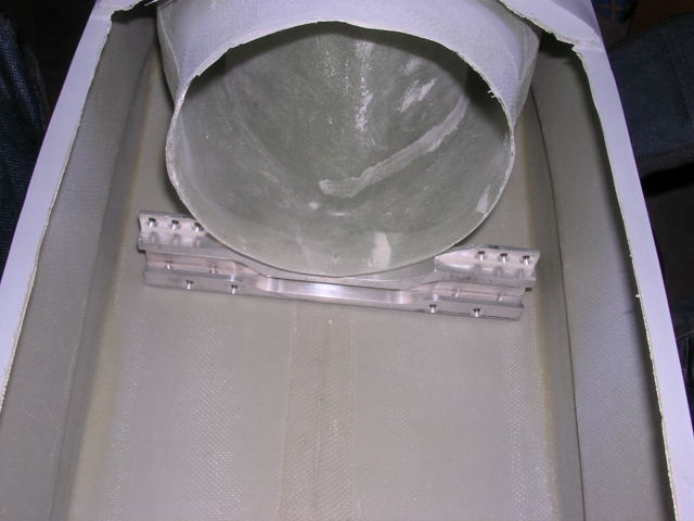

some pictures of the inlet installation. Basically you ream out the holes for the inlet. Slide it into place. Cut off excess and get to your fill material. I used west systems, microballons, bondo, K38 mixed with microballoons. I'm still not crazy about the job I did and just puttied up some more to sand off later just last night. I'm totally unafraid of body work and don't mind adding and sanding 100 times if that's what it takes to get something smooth. The end result is always acceptable to me even if someone else could have done better.
The spar receiver is shown to make sure that you don't get the wrong angle on the intake. Someone installed theirs and had to redo it cause the bypass wouldn't fit between the spar receiver and the intake. Whoops.

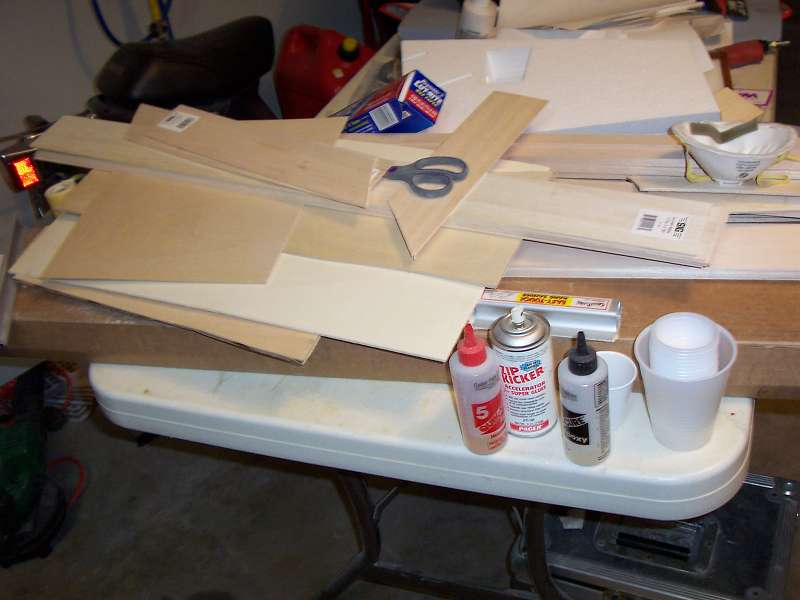

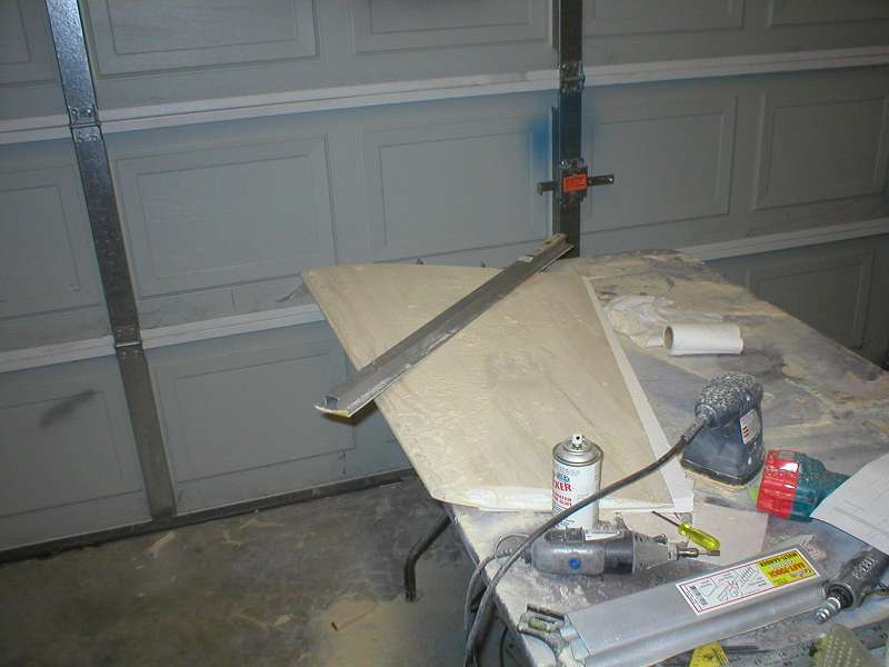

Nothing Fancy, but here's the slop of sheeting for those that havn't seen enough of it.

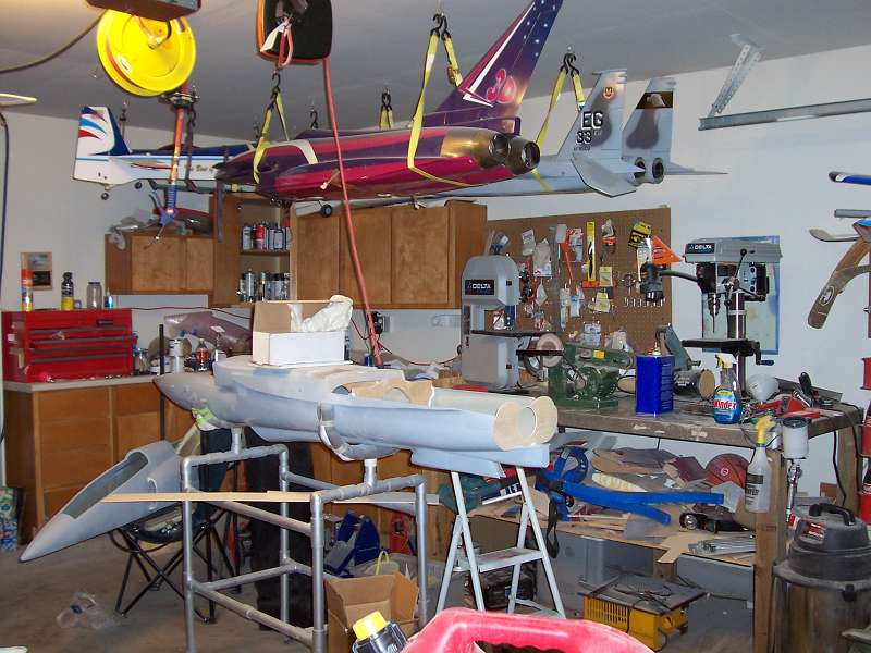

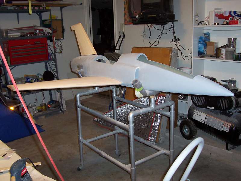

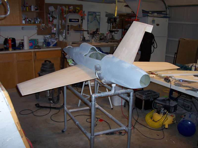

Cool Picture!! And plenty of Mexican cokes!! These are the kind with real Cane Sugar, not corn syrup.

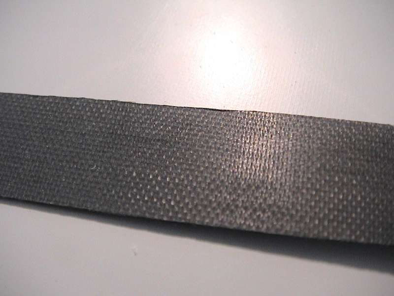

The only thing I would change is the plywood material I used for the "cuff".
When I came up with this technique, I always used unidirectional carbon fiber laminates (the 1/2" wide, .014" thick, rigid stuff that several people sell). These work OK, but are only strong in the long axis, so they would crack pretty easily handling the plane without the surface installed (which is half the reason for doing it, so you can get the plane all the way apart for painting AFTER you have hinged it)
Anyway, I tried that 1/64 plywood. It works OK (and very cheap), but it is not as temperature stable as I would like. Depending on your finish technique and paint color, the plywood cuff might get wavy in the heat.
The new stuff I am using is from Art's Hobbies. If you look at it, it has a bidirectional surface coat to it. This makes it very resistant to cracking. This stuff is perfect for this application, and I am using it on my new Super Bandit with excellent results. Everything else is the same as I posted.

Yeah I called them a "cap" in posts 28 and 29. Just use this stuff from Arts. Beware that this stuff is harder than the wood, so you will need to be careful to get it level with the wood routing slot, as it will not sand as easily as the wood, so it will leave a ridge if you are not careful when you do your finish sanding (post 30)
"Gluit" is a highly sandable white glue, made by Pica. Any whilte glue would work, it's just Gluit is my favorite white glue and if you get any on the wood it sands easily. It is great for joining anything on wood covered foam wings (like leading edges, trailing edges, etc)
"Model Magic" is just wood filler, it used to be made by Carl Goldberg. It is just that standard latex based stuff, balsa filler.
On a composite wing however, I use "Split Second"....that is my new favorite polyester filler. That is too hard for balsa and will not sand well in this wood wing application.

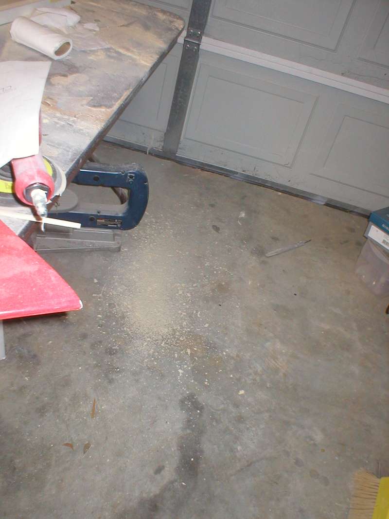

A shot of the new drawing that comes for wing layout. This is a significant improvement over what has been available in the past.
Anyone want to come over and have a balsa dust party? I've breathed more of this muck than I care to muddle over. YUCK.

Make sure that I'm lined up with where the vertical stab aft spar goes and tape everything in place and zip it through the band saw!
One control surface cut out. Little late on getting started, but once you get it cut out, things really start rolling.

Couple of pics, put the main spar receiver in last night to start jigging it in position. Euro's on hold a couple of days figuring out some cylinder issues, fill time with ISOBAR!
