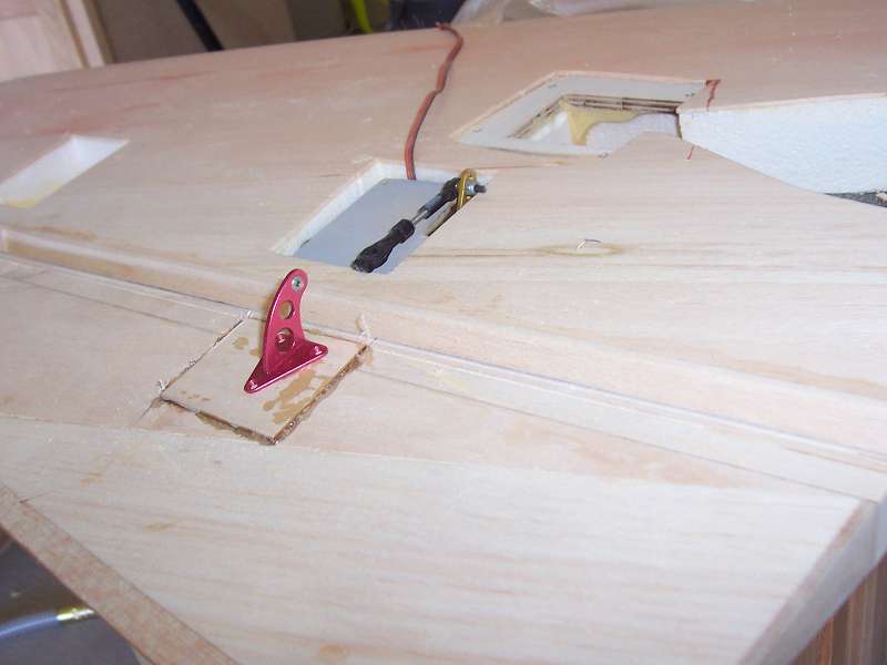

One wing is one sided glassed, you can see where I placed ply wood in the control surface for the anodized control horn which is a ZERO slop mechanism.

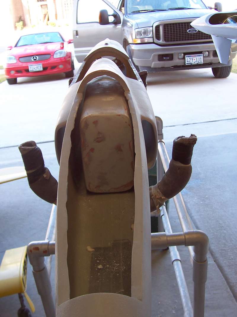

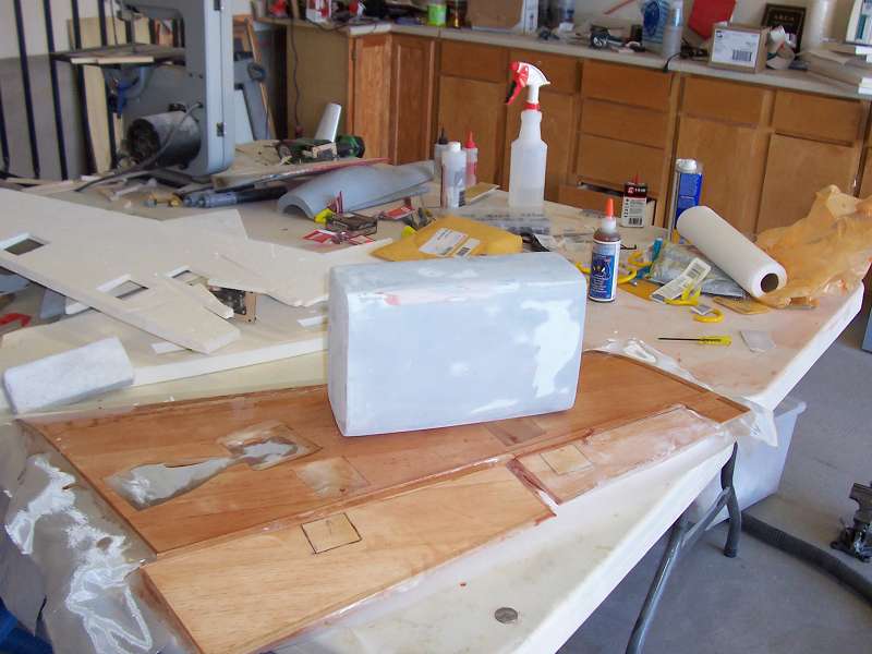

I installed the spar support (basically tacked it in with aeropoxy and will put some carbon fiber tow in later. A neat picture of Tom A's pipe support he and a buddy came up with and he was kind enough to give one two me. Just in for show right now and to get an idea as to how it will look.
I started making a plug for a fiberglass fuel tank mold. Holds well over a gallon of fuel, about 180 ounces.

Hey Sean.. The plane looks great but are you building a new fuel tank because you want to..
The Standard tank had 140 oz and ~7-8 lbs.. I don't think 10 lbs of fuel is really needed.
Eddie Weeks

Roger doesn't come on here and I want to fly longer than he can, this is going to be a surprise to him and he'll have to fork over a beer to take a look.
I'm really doing it for two reasons, flying longer than Rog, and I started building a plug for a sport jet and want to start the molding process on something easy to get my feet wet so to speak, working with Tooling resins and such. Once I've got that figured out, I plan to make up a totally composite wing with live hinging for the isobar. And what I learn there will follow over to my sport jet.
Ya, it's just because I want to, no other reason, I have the standard fuel tank as well, if weight becomes a significant issue, I can always switch it out.
