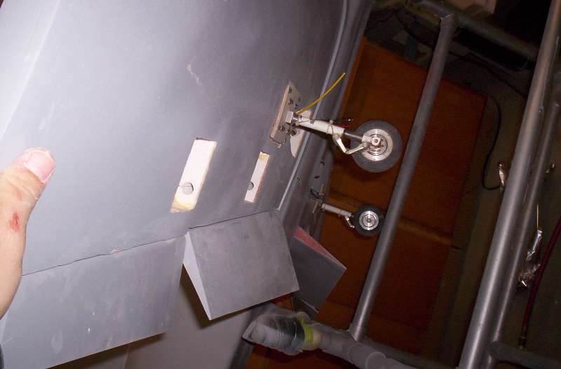

Some primer pics and showing an installed anodized control horn into the wood piece I glued in.

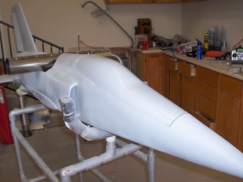

Ok, so I skipped documenting a couple of steps, show me some love!

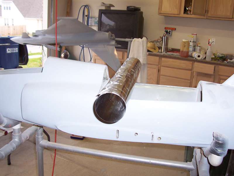

Sean,
Are you using a single wall pipe or a double wall pipe?
Old 03-22-2005 | 12:00 PM
  #58
seanreit's Avatar
My Feedback: (60)
Posts: 7,434
Received 7 Likes on 3 Posts
From: Cedar Park, TX
Default RE: Isobar Build Thread
I built it as a single, but I'm not entirely done with it yet. For one thing it came out a little oblong because I overlapped too far. I have to take it back apart and make the overlap about 3/8" according to Eddie. I just ordered some safety wire from Todd so I'll aluminum foil the pipe and safety wire it later this week. (I always used nichrome wire for safety wire on fuel tubing, but thought this pipe should have something more heavy duty than nichrome).

George wanted a couple pics of the pipe. Coming together in the final stretch now. "Bag of Protoplasm". Geez Oh Man, I hate to admit this, but I've holed myself in my garage for 5 hours a night every night for the past month to get where I am.

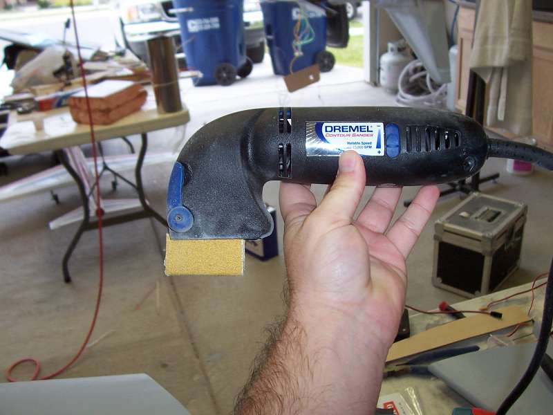

Bought this contour sander the other day. This is a wing or tail fillet machine! It comes with many different ends you can put in it for different radius!

Oh, and this is what the rolled stainless steel looks like that you cut the pipe material from. Zip Tied to hold it together. Beware, when you cut this stuff it gets sharp! Hearing me wocketman?
Mike, in the circle pics below, looking from the Turbine Aft, does the lap joint on the pipe need to resemble the top picture or the bottom? I believe it's the top but not sure.

looking at the front of your turbine, if it rotates clockwise, then the top is correct.

I confirmed the turbine spins clockwise and so I built it right! The pipe has a 5% taper to the ass to sqeeze a little more go go juice

Dude... Turn those bolt around so the head is inside the pipe...
Then cut the bolts off flush with the nuts.... Then hit the cut bolt with the grinder real hard
and it will kind of weld the nut to the bolt... and next time make the holes strait...
Other than that... Looks good.. BTW... Cop car Isobar just turned 6 years old !! who knows
