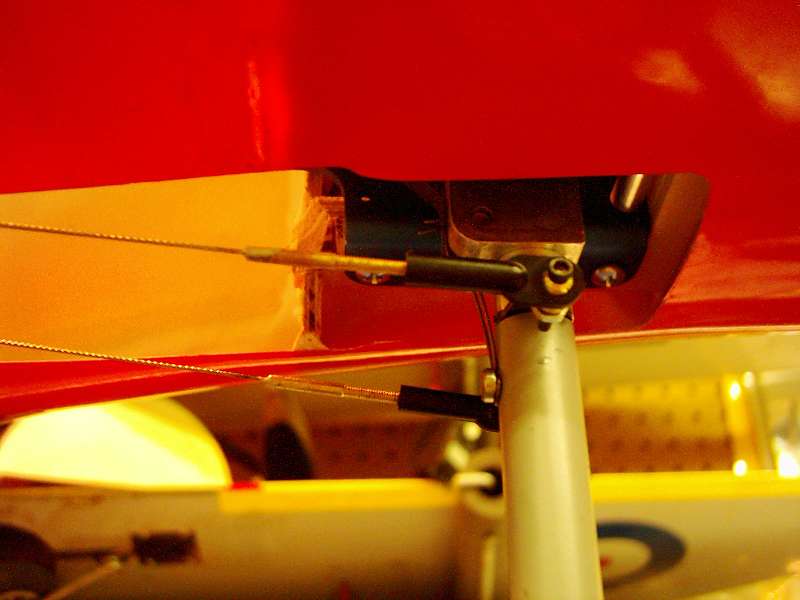

This is how I set up my Roo. Still building it so I can't say how it will work in the real world but it works sweet on the bench. [8D]

Looks like a nice setup, but I would be tempted to put a washer on the outside of both ball links. I've seen them pop off, once they get a little worn.

Gary, Good idea. Have to remember to do that before I fly it. Thanks.[8D]
