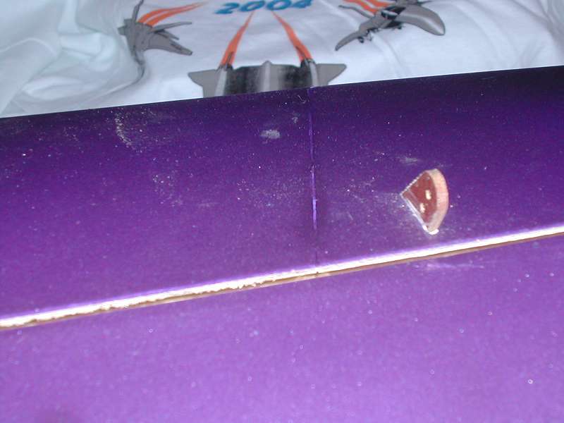

Some time ago I purchased a used Hotspot complete minus receiver. I am now setting everything up with a JR PCM 9 channel receiver.
The Hotspot has split elevons using 4 servos.
I have connected each pair of servos via a Y lead to the aileron & elevator ports on the receiver as per the instruction manual. The wing setting is for delta in the transmitter.
The problem I have is, when operating the ailerons or elevator, one half of each elevon goes up & the other down, same on the other wing. Reversing elevon & aileron only reverses the split movement. If I juggle the four leads around I can get elevons ok or ailerons, but not both.
I can only assume one servo in each wing is reversed. Unfortunately to get at them means some surgery & as the plane is so nicely painted I want to avoid this if possible.
I have seen the plane fly, so there must be a solution. I wish I knew what it was?

Hi Jascat100,
What about using two of the JR matchboxes, one each side that way you can reverse the backwards running servo and adjust the end points to each servo so they both are the same
Thats if you can get to the Y lead inside the wings?
cheers Pete
cheers Pete

Jascat100, just swop the leads into the receiver - elevator and aileron and then try again and it should come right if you are using a y-lead to join the 2 servos in each wing

Negative....the Y lead on your "AILERONS" is the problem. By matching those 2 servos together, they don't work "INDEPENDENTELY" and therefore, the radio can't work them separately so that one goes up and the other goes down. Yes, you CAN use a matchbox to reverse the throw on one of them, but then you cancel out many mixing features you can use on your computer radio. The aileron servos must be connected individually to different slots on your receiver. With my setup, slot 1 gets one aileron and slot 6 gets the other, thus controlling each independentely. From there, you can reverse any one as needed right from the transmitter. Hope this helps...let me know if you still need help.
possible correction.....the Hotspot control surfaces....as i'm not familiar with this model, does it use only 2 control surfaces both acting as elevator AND aileron? Or are there 4, 2 in the middle for elevator and 2 outboard for ailerons? If you have 4, the above explanation applies...if only 2, let me know, i'll tell you how to set it up.

The best way to sort your problem is to use 4 channels on your receiver then you can mix them how you want , ie the inboard can be used as elevator and the outer as ailerons, or you can mix them as elevons , this way you have some chance of getting back in one if a servo goes down.And also you can set up crow breaking

I would test the setup by taking one wing at a time and plug it into an unmixed channel. Make sure that both servos move the same direction. If they do the problem is with your mixing. if they don't then either one servo is upside down or you have a strange 'y' harness.
Once you have determined that the surfaces on each wing panel move in the same sense it is a simple task of plugging the 'y' lead in the correct channel and activating the elevon mix.
It is fairly common to have each surface plugged into it's own dedicated channel. If the above test shows that with a 'y' plugged into an unmixed channel the surfaces move in opposite directions then this may be the easiest option.

This issue is getting seriously clouded by all the advice you are getting, if I understand (and I will clarify what I read in your post) correctly I think I may be able to help you here.
First, you have split elevons on both wings, 2 servos per side. Each side is y'd together (left side y'd together and right side y'd together) and one side is in channel 1 and the other in channel 2, am I correct in this assumption?
And this is the problem you are having.....you move the elevator the elevons on each wing goes in an opposite direction(example: left wing outboard elevon goes up, inboard elevon goes down) and same for right side and same for aileron control.
Here is what your problem is, if everything I said above is correct. Your servos are facing different directions in the wing (example one is facing the root and the other the tip)
Solution...get 2 matchboxes so you can get them working together, or use 4 channels on your receiver, or if possible, change the way one servo faces in each wing so that they each wings servos are facing the same direction. All of this has been said her but just not clearly I think. The easiest and cheapest solution solution would be to use 4 independent channels but am not sure if you have the free channels available to use. If not go with the matchbox.
There is possibly one other problem here as well which is a longshot but possible, the servos are programmable and the owner reversed one on each side for some odd reason. Hey, I said it was a longshot but yet very possible.
I hoped this helped you.
