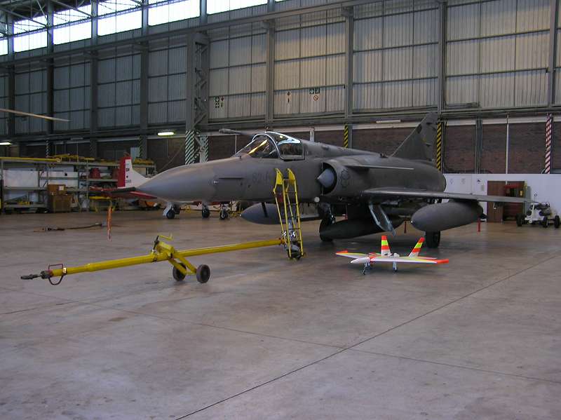

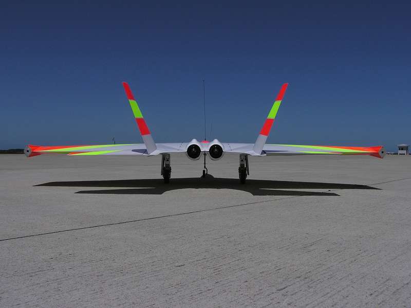

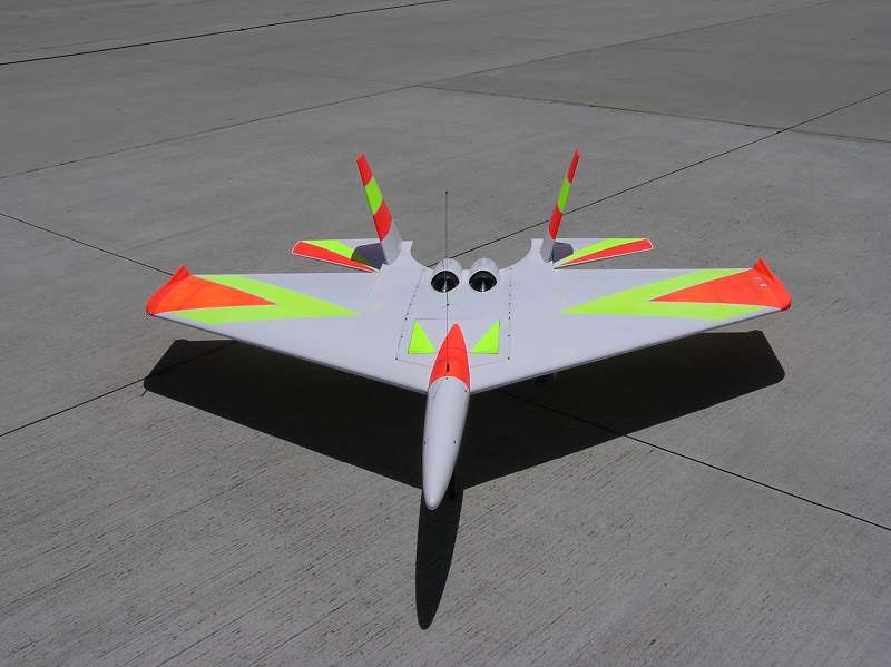

It depends on on what you define as low cost. Our target cost per unit is about $100K ea and 5K/day operating cost. Compared to our nearest competition (for mach 0.5+ LOW altitude (20 - 50M ASL) type targets) is $1m/unit and 200K/day operating cost. Ou UAV is cleared to fly in military airspace under test conditions and have full autonomous autopilot and flightplan and safety recovery footprint GPS hardware. Our target is specifically designed for SAM defence for ships against incoming Exocet class missiles.
AUW = 30Kg and takeoff weight incl 38l Jeta1 60Kg. Power is by 2 x 200KS engines for a top speed of 500 - 600 kph.
Contruction is all carbon nomex composite and moulded mostly in one part using CNC milled moulds. Vacuum bagged and oven cured.

How on earth do you get 38 liters of fuel in to that thin thing? Wet wings?

What can I say.....but.....wwwwwooooooooowwwwww
How big is that UAV.....It looks cool...

SAP2000, the wings have quite a bit of volume. 80% of each wing has a skin to skin fuel tank with 4 cells each devided into 4 again for a total of 32 cells. Because the wing has no spar or ribs the tank also helps the structure a bit as it is bonded to the inner skin of the nomex/carbon layer. 4 fuel pumps in total manage the fuel system via 2l header tanks, one for each engine.
The UAV is quite big with a 2.3m span and 1.2m chord and 9% laminar flow wing about 95mm thick at the root. About 2,5 msq of wing. Amazingly the fuel does not move the CG near as much as you would think.
